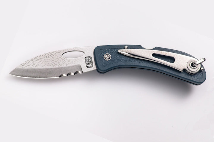

As for MOST rolex? Maybe this:
Tungsten Carbide Platinum Mamba
