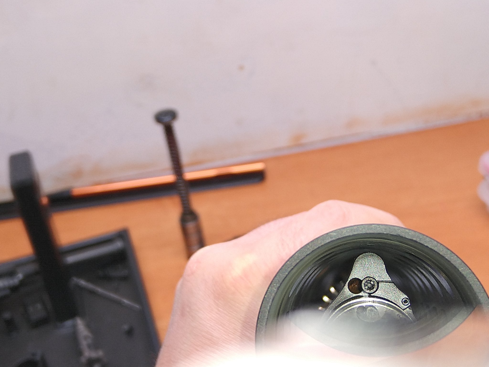

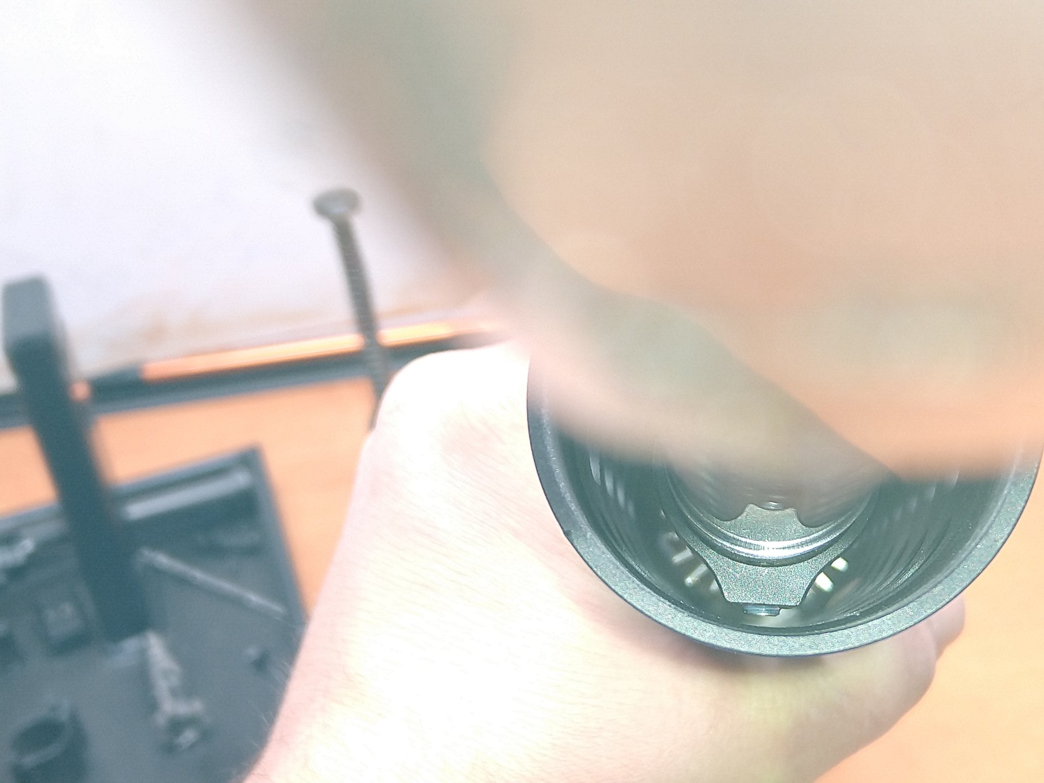

I had the SLR Sentry 9 clamp with JP 22" barrel and 17.25" RC handguard and it barely fit. Matter of fact I installed the Superlative setscrew 0.936" version today and there is little more room vs Sentry 9. If JP made their detent adjust version in 0.936 I would get that without thinking twice just for the side adjustment. Both SA and Sentry 9 are annoying to adjust from the front.
Pics of clearance with SA 0.936" setscrew

View attachment 7508680View attachment 7508681
The issue I found with the JP block I originally bought for a build was the set screw didn’t not line up with an access point in the hand guard so it made adjusting impossible without its removal. I went with the superlative and haven’t looked back.
