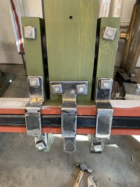

Axle bands. For two carriages, had to make four of these. These are 3/8" strap that was v-grooved and heated to cherry red then bent to 90 degrees. The top piece will later be welded in to make the bands an exact (and very tight) fit between the cheeks and axles. 12 separate parts to make the four bands!

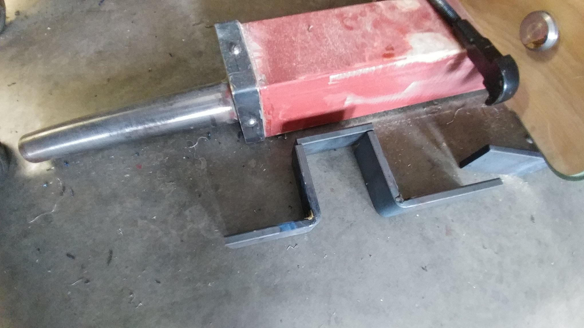

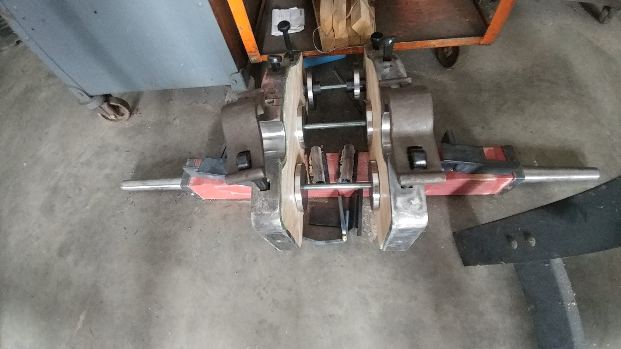

Also had to make two of these:
These go between the trail and the axle. Same principle as the other axle bands, except this has a T-piece that has to be welded on. Again, all will be tacked and final welded to ensure the axle is tight on the cheeks!

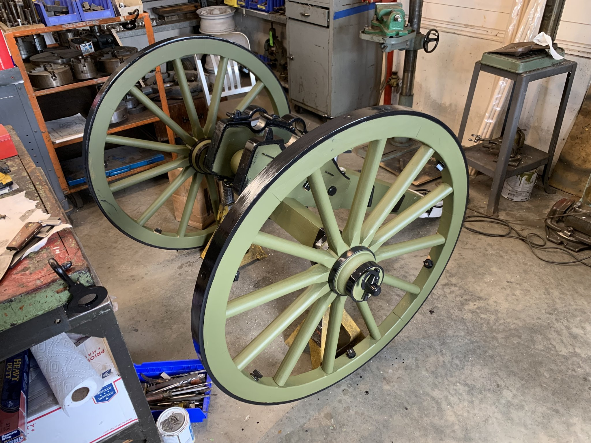

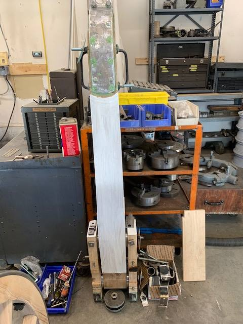

This is one of the carriages with its machined rondelles in place. Turned bolt heads in place. Irons ready to be fitted/welded. And the rear rondelles fitted with their recoil lugs. A lot of machining and blacksmithing this weekend.

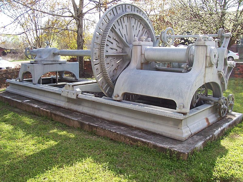

Later, I am going to try and see if I can find some more pictures of old plants and old manufacturing. Amazingly, there is not a lot out that I've initially found. I did find that Watervliet Arsenal Museum is undergoing a major refurbishment and is likely to re-open to the public. That's good news! Lots of history there.

Interesting, I would have thought there would be a plethora of images.

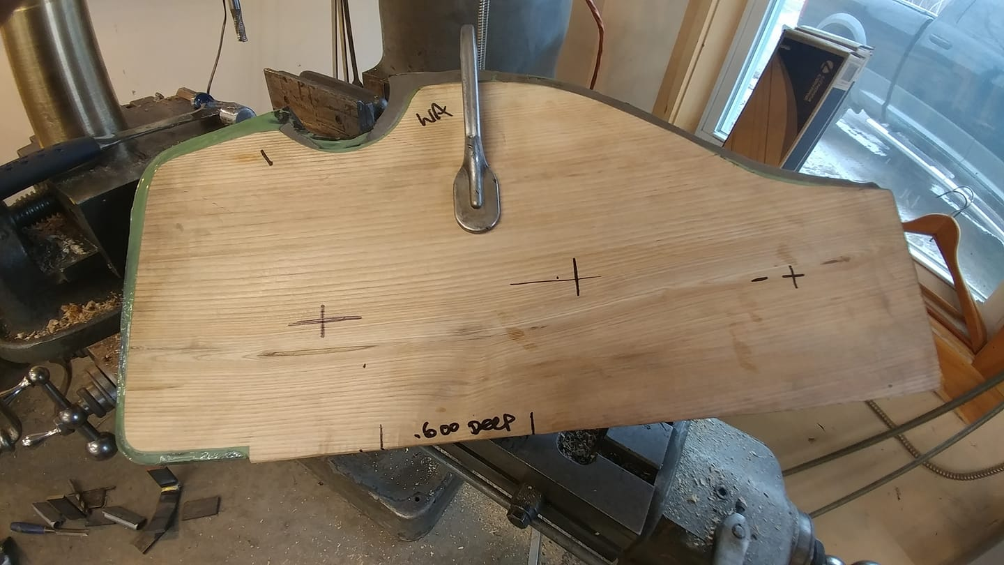

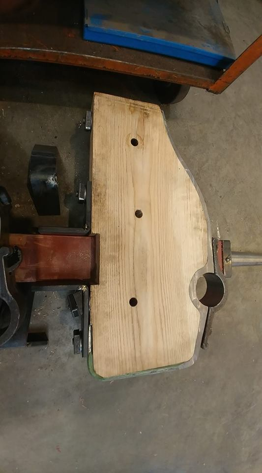

Got the cheeks for one carriage finished... the trail is being milled this weekend for both carriages! Woo hoo!
This bit doesn't look like a lot of work, but getting the angled hole drilled... and the four cross bolts for each cheek done for one carriage (two cheeks) was a full, non-stop 8 hour day. Note the hand-made nuts at the bottom and the wedge. Also that the trunnion irons are now locked together and matched in pairs.
Here is the second cheek... ready for cross-drilling, milling and through-bolts tomorrow. With luck, since I have all my set-ups and techniques down... I can get this whole one done (including milling the bottoms) in one day. Lots of chisel work here, too.

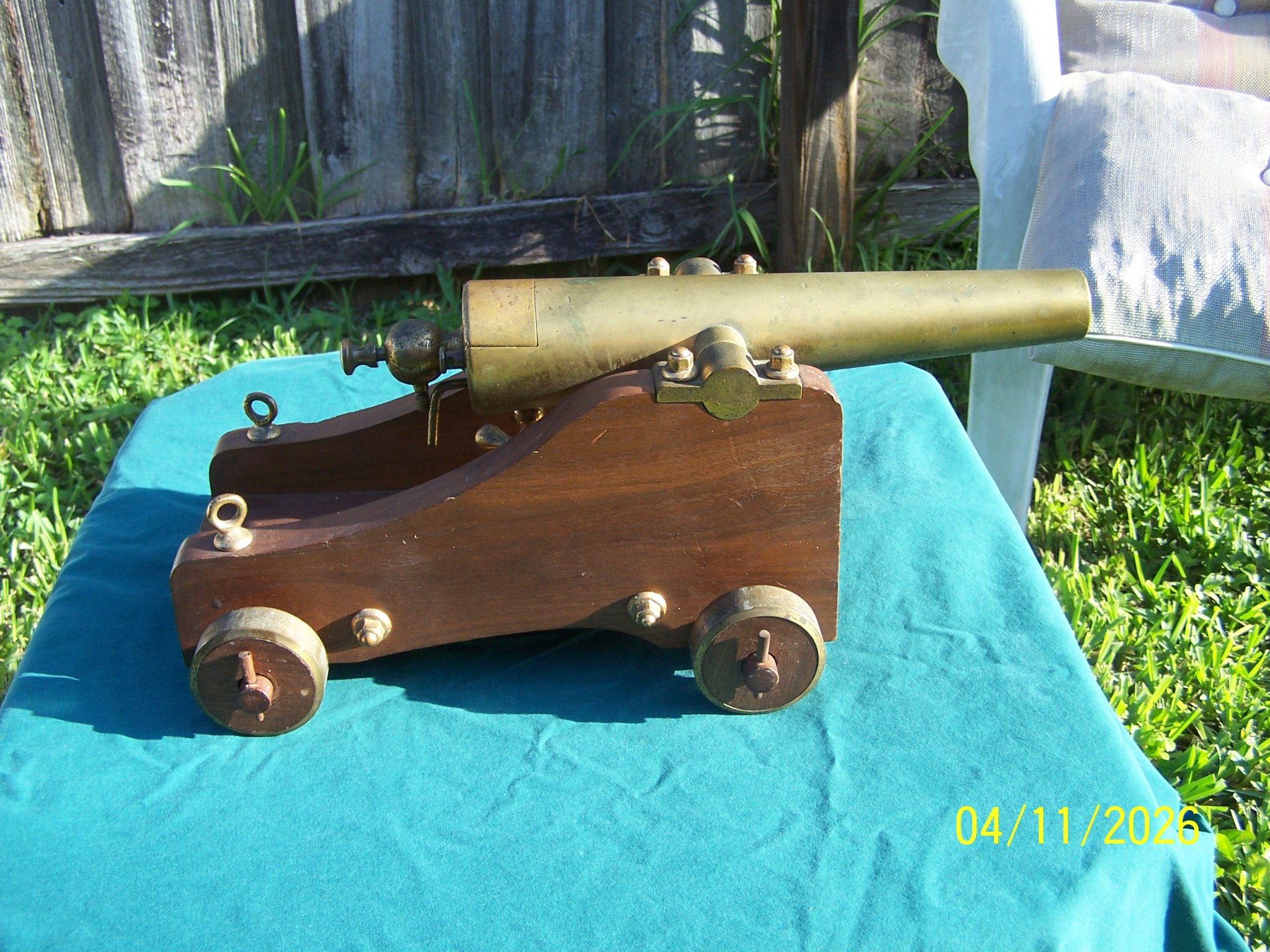

Wrapping up farm work before a motorcycle trip.... But decided to take the day off for a 'real' little weekend project.
Restored a Strong yachting/salute cannon. Was missing its firing mechanism. The extractor was broken. And the firing pin was bent like a banana. Made all new parts. Restored completely and gave a 'gentle' polish to keep up some of the original patina.
Lovely piece from c. 1880's. Identical to the one on the opening of Magnum P.I. but smaller. From the Strong/Snow company of Ct.
Ready for another 140 years of BANG!!!
Fixing things is fun...

I just sold one of these last year on eBay. Mine was 10 gauge. They are a thing of beauty .

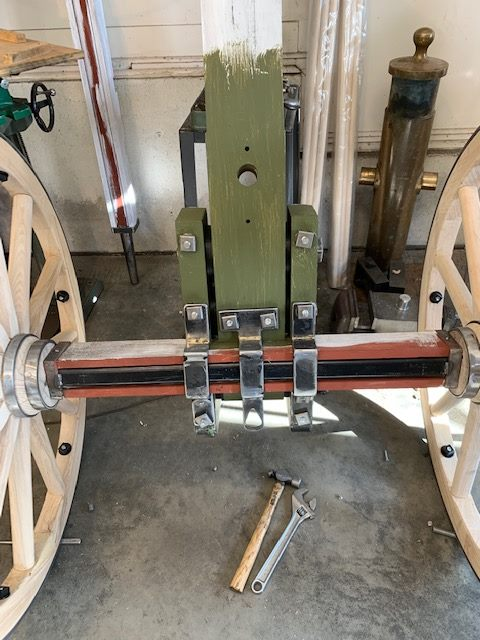

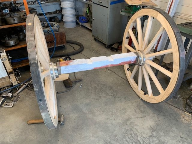

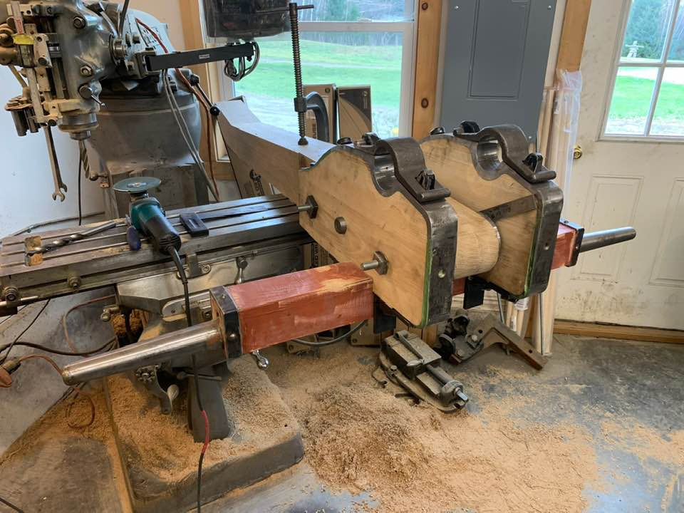

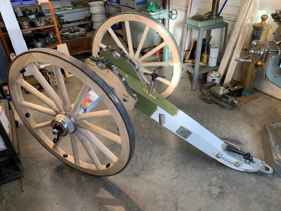

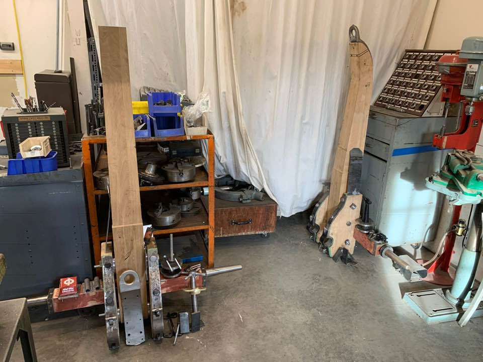

So for some reason didn't sleep for $#!+ last night... and ended up getting up and going to the shop at 4am... and spending the next 11 hours getting a ton done....
Fitted the axles, cheeks and trail together for the first time on both carriages. This is critical as it includes aligning the trunnion irons so that the barrel will drop in. Both carriages... my woodwork was so close that they required zero adjustment... One of the benefits of making these things on a milling machine... rather than with a chisel. I was a bit amazed... having not touched either of these carriages since spring. But both went together remarkably easily. Once fitted and clamped, the cross bolt holes were drilled through the trail.
Same carriage... other side. Next weekend, I'll fit the wheels, one remaining Lunette and start drilling the trail for all the little gee-gaws that go on it. But by the end of next weekend (if it's raining... still got one more weekend of farm work to do before winter..) the wheels should be on with their retainers. Then everything comes apart one more time for welding straps, painting, etc.

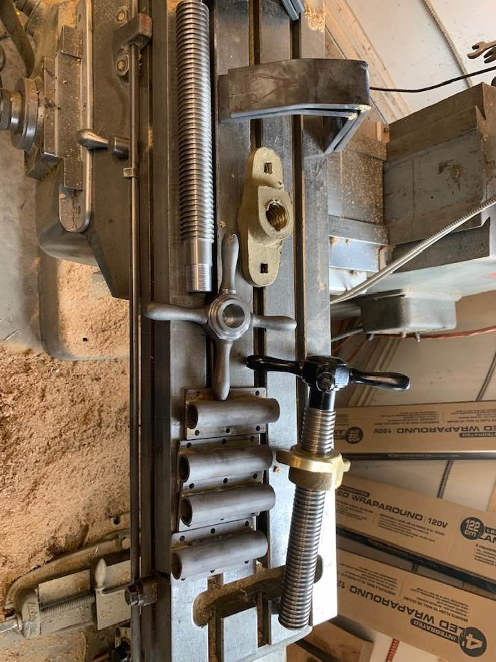

I still have some fettling/finishing to do on some of the iron pieces. Here is part of today's work getting the second elevation screw adjustor machined and ready to fit. The other one was done some months ago.
The elevation adjustors (no, I did not turn the Acme thread...bought it!) And the Linstock holders. Some of the irons. I still need to cut some holes and weld them together.
Two carriages awaiting final Trail components to be fitted and wheel fitting. Part of that may be next weekend. Certainly the weekend after. Then comes deer season.... but I expect to have both of these finished over Christmas. I think that I may welcome Santa with a barrage!
Here's roughly what the Mountain Howitzer will look like when done.... It's getting close!

After two years of off-and-on work... the first of two carriages got assembled this weekend. This one is for the Napoleon. Next weekend, I'll get the Mountain Howitzer carriage together!
Still some small parts to make, but they are all 'added'... some of the chained-on trunnion keepers, etc. The core is done and ready for paint. Next weekend 2!
After this, two Field Carriages... these are just little First Model Prairie carriages... babies!
Trail for the Mountain Howitzer... but it is the same as the one for the Napoleon. Box of parts is what I started with this morning for the Napoleon. Had to do some final mill work... a few holes drilled. Some last grinding, etc. I can still taste metal filings. Fillings hurt.
Bare axle, ready to accept the trail and cheeks. Everything is milled out to within about 1/32nd of an inch in order to be a tight fit side to side. The 'notches' are a slip fit. Can't get a piece of paper between the joints. No, not metalworking. But to metalworking tolerances! The metalworking was making all the metal components!
The complexity of the bracing... all these are long bolts with round heads, and big square nuts, each individually cut from 1" square stock, drilled, threaded and Chamfered. Some of these holes for the long bolts are drilled at angles... 14" long! And have to be dead straight through the cheeks! This is a close-up of the underside.
Longer shot of all the irons and the big nuts, etc. and the axle(s). Since you can see the second axle in the background along with the Mountain Howitzer barrel!
Just need to make some small parts (wedges, trail handle, etc) which are add on parts... and paint... and this one is ready for its barrel. Next weekend, I'll have the second one in the same stage. Then it will be just some small machine shop bits!

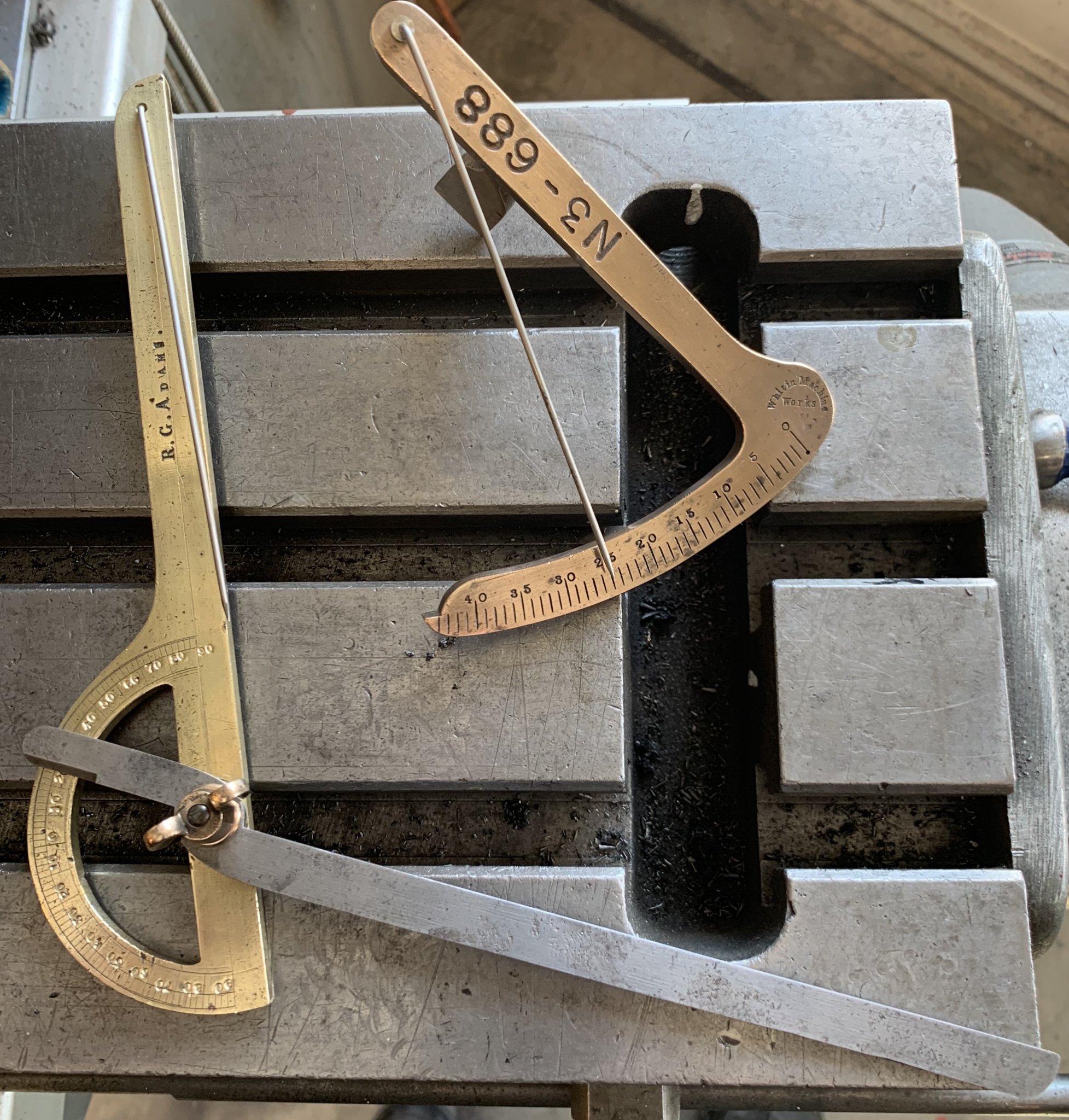

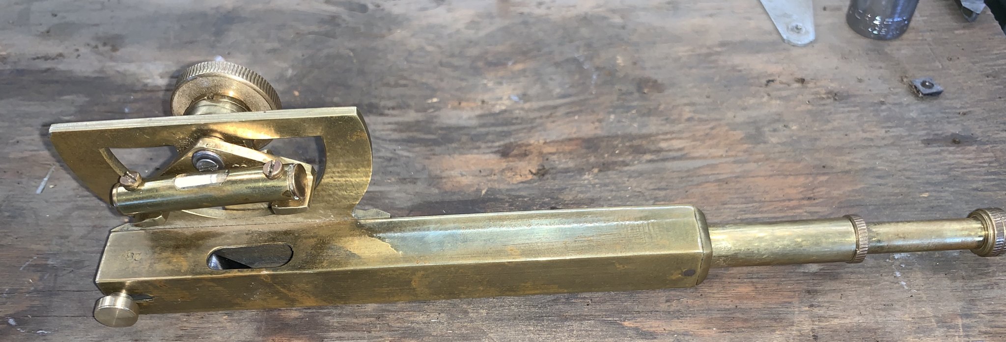

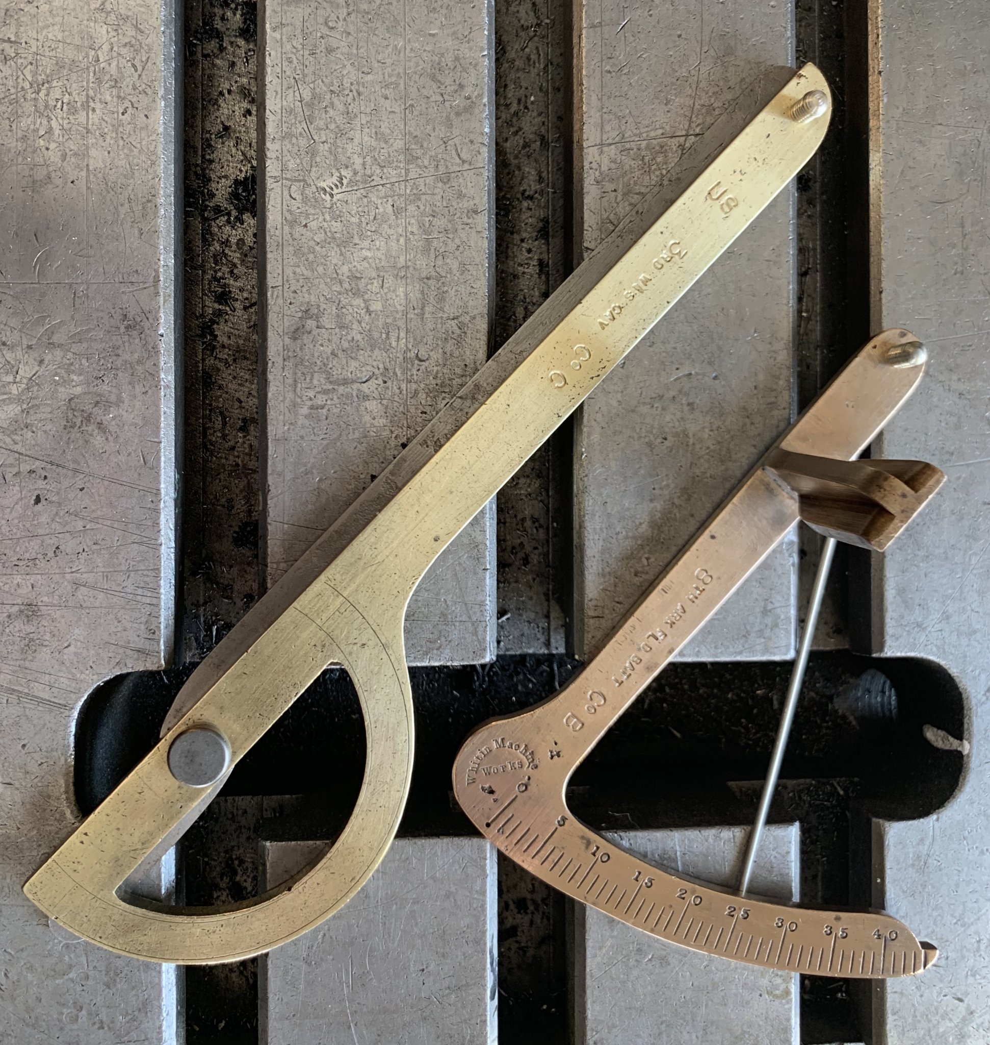

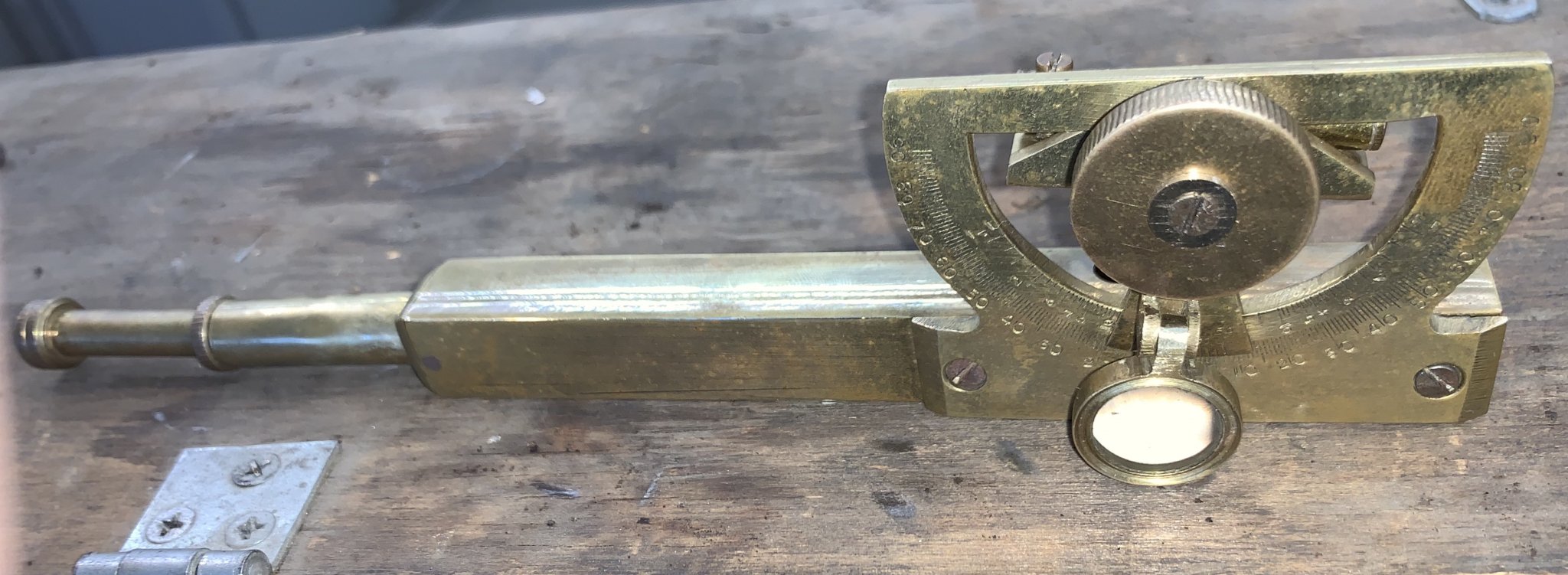

So making some of the tools and accessories.
Needed a couple of pendulum hause sights. But originals are unobtanium and belong in museums and the repros are not all that nice for the $$$, I decided to do my own.
Went to eBay and bought some old brass protractors. With a little creativity and some stamping... very creditable pair of pendulum hause sights.
Both discreetly marked ‘fake’ with an electric pencil to stop charlatans in the future from selling as real.
Unit markings are from ‘real’ units. Cheers, Sirhr
