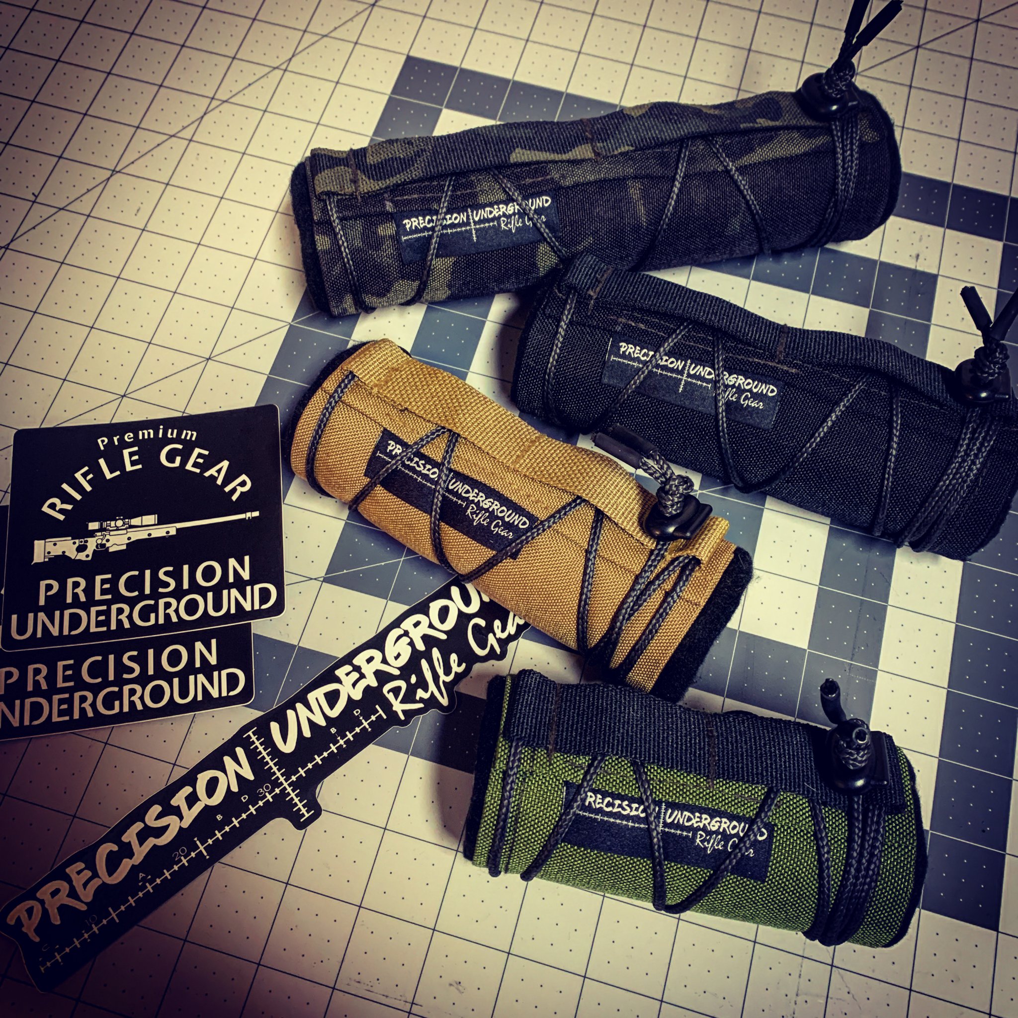

Check out one of our covers. Send it back if you don’t think it’s the best out there.

We make them all to order. Typical turnaround is 24-48 hours. They are $109 for standard size. This cover slides on and kevlar cord cinches behind the barrel in 10 seconds.

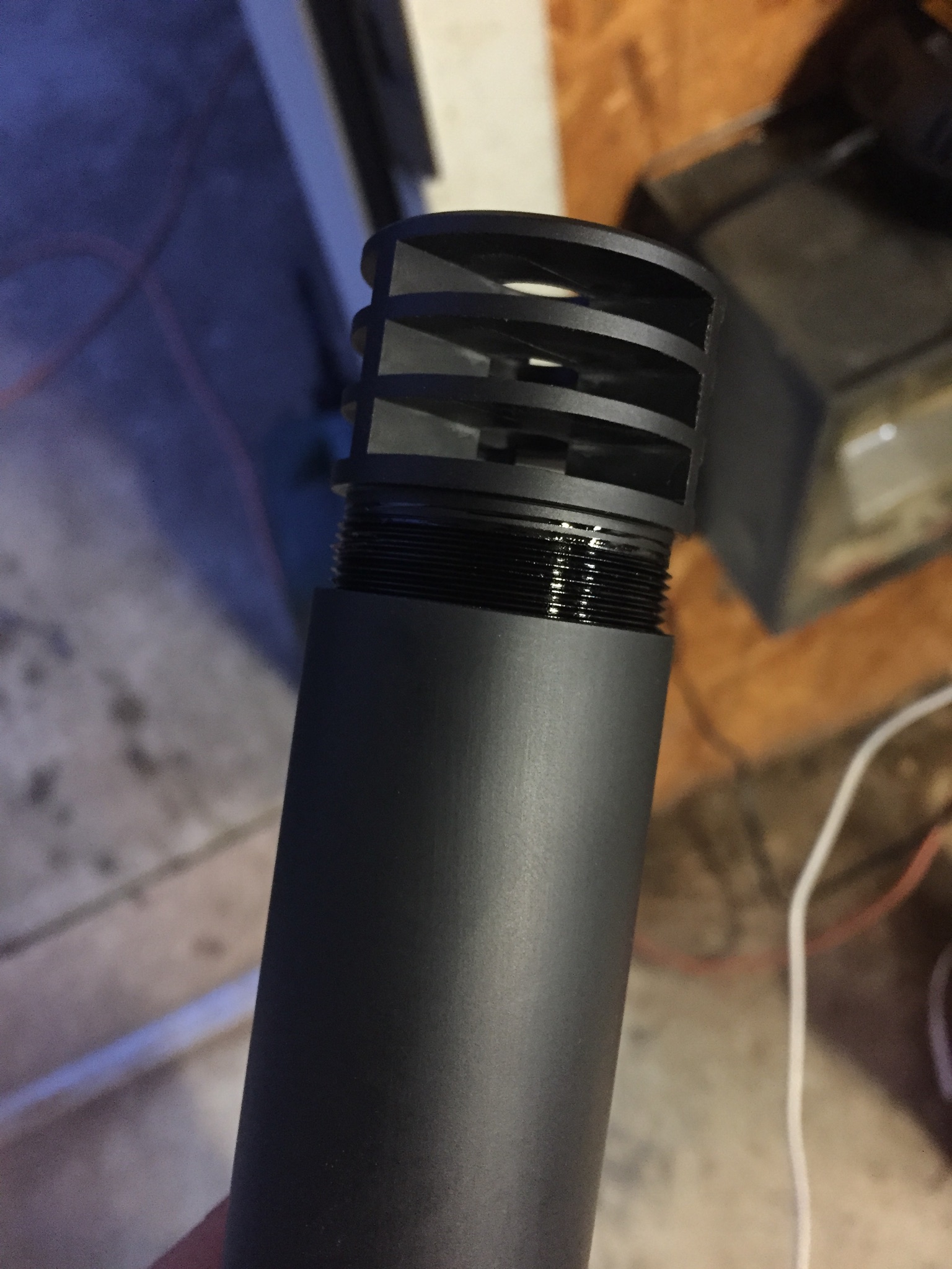

mine is for some reason.
Well I can’t say I ever seen or heard of that ... I better check mine out... not sure if that’s good or notmine is for some reason.
I have one and the brake end is threaded too.Lol unless they changed the design the original ones I thought were glued on haha might wanna check on that
Is yours a 30 or a big bore 338? I know for a fact the big bores is not supposed to be. I live near silencerco and have been over there many a time to beg them to give me a flat end cap while I am swapping parts or having shit fixed lol.I don’t think it supposed to, but it has been like that since new.
Mine looks to be glued or has some sort of sealer on that side, yours might be the one that slipped bymine is a 300, not the big bore. It’s not supposed to, but for some reason it does. It has never come loose shooting, but can be unscrewed by hand.
