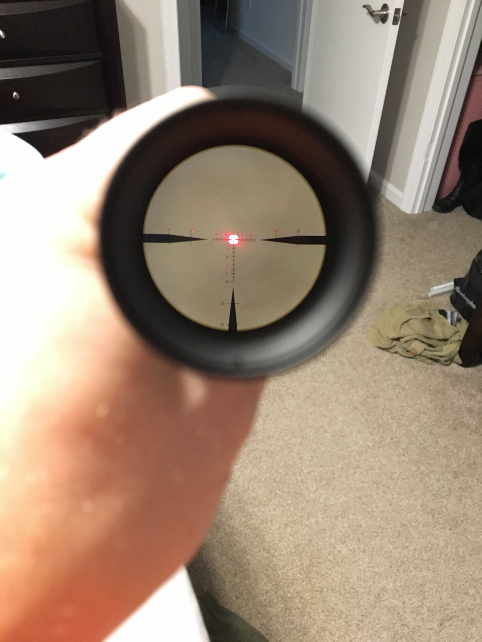

Anyone notice on the NX8 when dialed up 6-8x and you turn the illumination to 6 or up that the illumination bleeds through the mil numbers. But it’s not lighting up the whole number it’s super blotchy almost like spots?
Here’s a picture to my post above. If you zoom in your can see. The picture is good to how it looks on person.
Every single illuminated scope does this when the illumination is higher than appropriate for the ambient lighting conditions. If you turn it down or go to a bright area, this becomes undetectable.
I understand it bleeds through. But it comes in as dots on the numbers. Not just red throughout the whole number
Etched reticles are given a surface treatment to cause the illumination to precisely reflect to the shooter's eye. Untreated reticle features like numbers won't reflect this light with the same even presentation as those with a surface treatment.
Reactions: Prxr88
Are you serious with this?? It’s a by product of the extremely bright illumination the scope is capable of. That is FAR brighter than you would ever use the illumination. And yes, I have an NX8, AND an ATACR 1-8 that I could probably get to do that..... but, as stated before....who cares?? Just turn the illumination down.
It’s a bonafide non issue.
I am serious and I do care? I bought a $1800 product and want it to be correct. I turned illumination up in the picture so you can actually see it. In person I can also see it dialed down to 3-4. Instead of acting like I’m dumb why not provide a picture where yours does the same at a reasonable illumination level. NF customer service didn’t think it was a right or a non issue.
I do have an NX8 that looks exactly like yours with the illumination turned up. I don't have a loose reticle and microscope to show the difference between the center portion that properly reflects the light vs the other portions that don't.
If you're concerned enough to have NF CS look at it, I'm confident they will be happy to check it out. I'm glad to have folks like them to make sure everything is right.
Thank you. That’s kinda what I was looking for. After taking it outside I notice it much less. I just kinda thought the red light coming through as red dots on the numbers was off instead of filling the whole number.

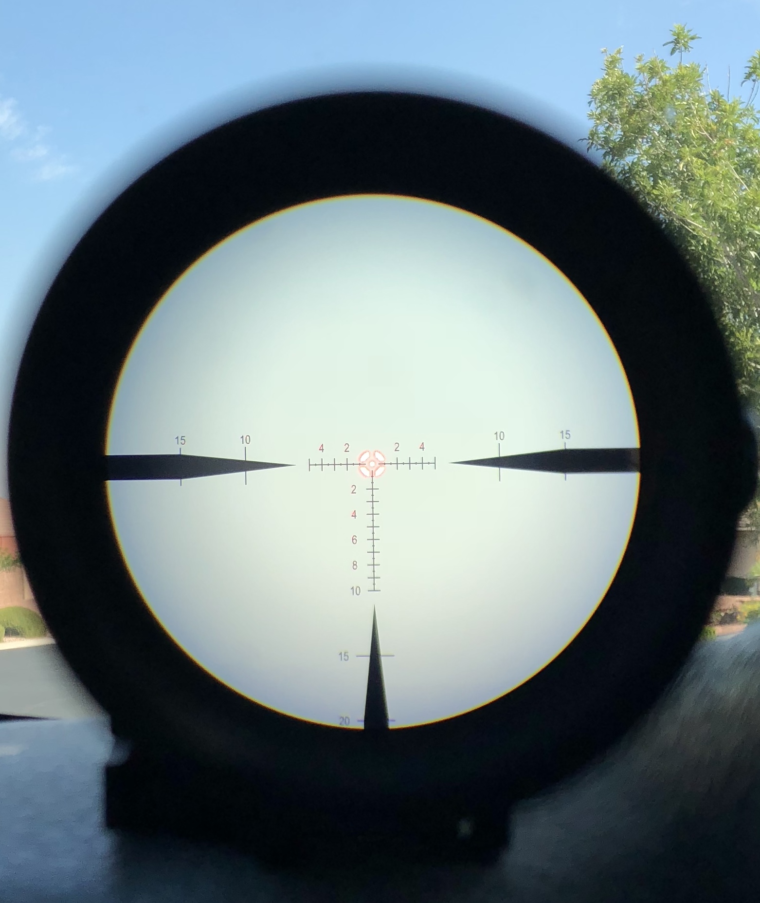

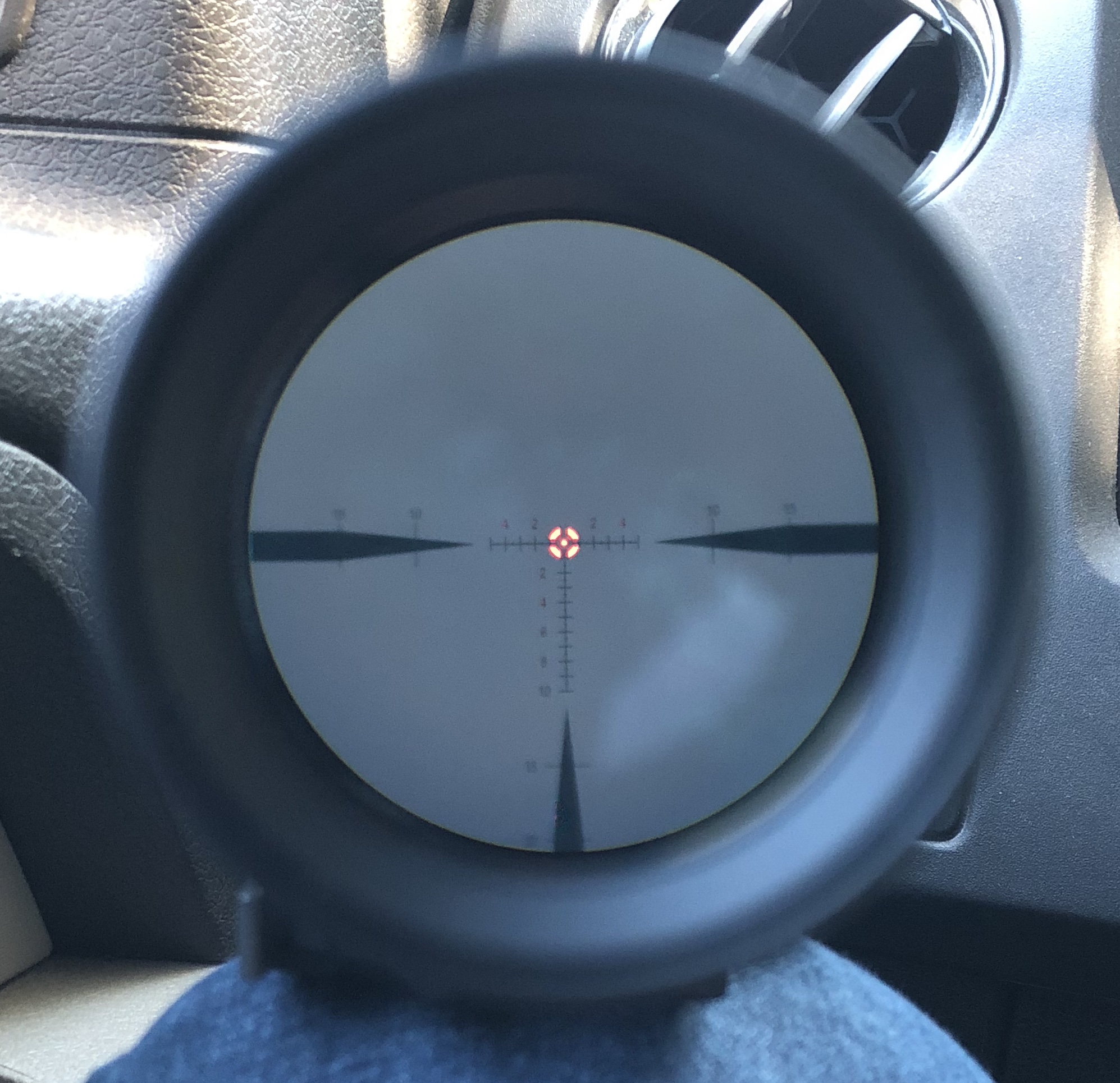

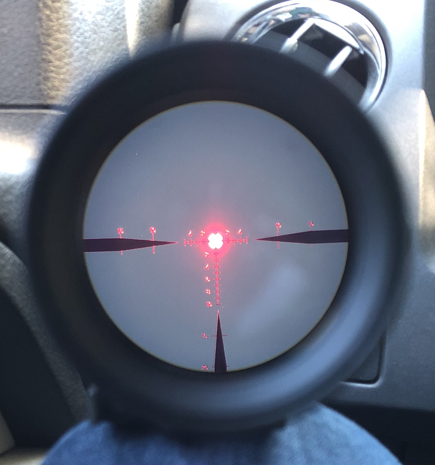

Here you go.
Illum level 9, which is still overkill for that lighting. 8x mag.
Illum level 9, 8x, even darker conditions.
Illum level 3, 8x, same dark conditions.
As it was already explained to you, all reticles will have bleed through when you’re using more illum than necessary for the ambient lighting. You bought an $1,800 product THAT IS FUNCTIONING CORRECTLY. You might want to spend more time learning how to use your optic and less time on the forum arguing with people that have already given you the correct answer, like this one:
