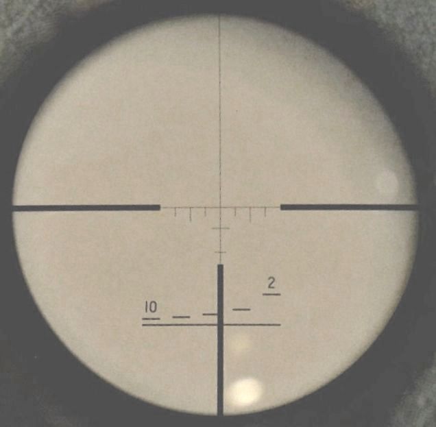

I have been looking to buy another Kahles or Swarovski ZF series scope (ZF69, ZF84, or ZF95) with the rangefinding reticle and BDC turrets, but I have been unable to locate one. I found the above optic, but am hesitant to buy it for a couple of reasons. First, since it is not labeled "Kahles" or "Swarovski", neither of those companies will work on it if there is an issue. Secondly, I don't know whether these Photonic optics are of the same quality and ruggedness/durability as the original Kahles/Swaro ZF optics.

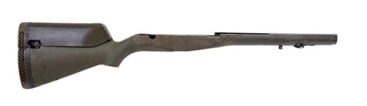

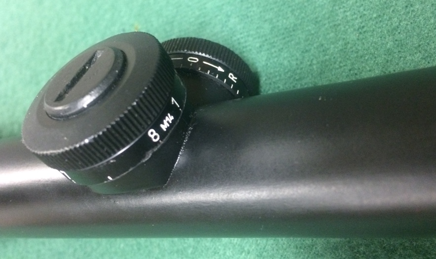

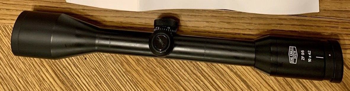

Glass is usually very good, and they usually have an M14 BDC turret. Downside is the tube is the old European standard 26mm diameter, too large for 1" rings; the IDF mount is really high, and requires a stock with a 2" cheek riser. See examples of IDF M14 sniper stock and their huge cheekrest. I sold my 6x42 scope to a buddy and I ended up buying an ZF95 (10x w/ Mil-Dot reticle) to use on an SSG-69 one day. (last pic)

Photonics is a subdivision of Kahles. They don't work on them because they are old: 25+ years.
They are identical to the ZF95, and are good German glass.
