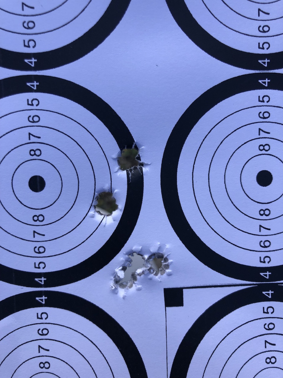

90-94gr of Rs-80 1gr int. 250atip and 300nm 28” lothar barrel
854-901 m/s with 93 starting to have light sticky bolt. 93 and 94 are the high ones out of the group.
84-88gr were one big hole but speeds were too low 830ish m/s but they fall in the same general space as on this pic the three lowest 90-92 loads.
Action after using it for a while with 338 barrel is smooth works like a charm. Im really happy with it. Next is match test in december in Poland to see how it does in sand…
