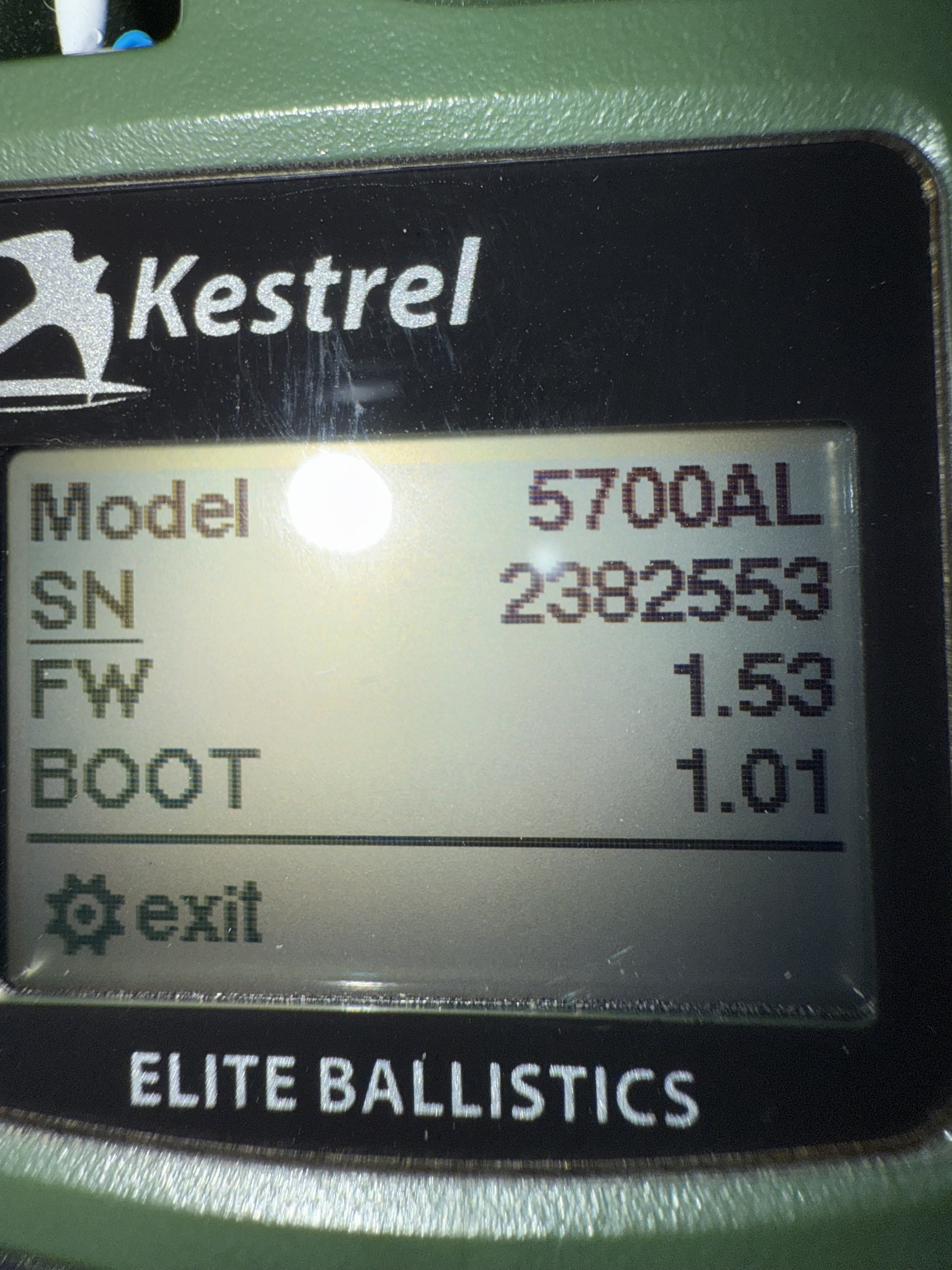

Currently installed is 1.53

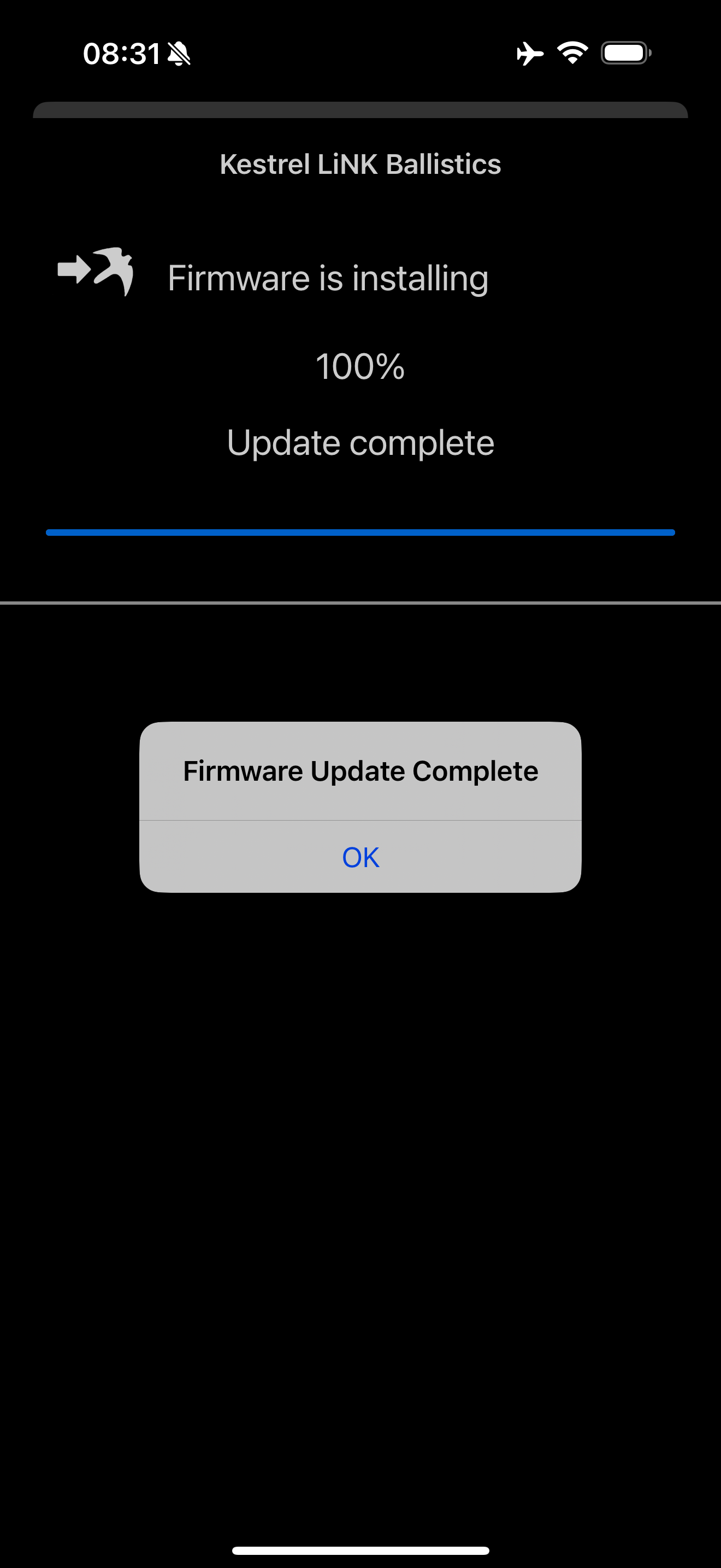

When I open the Kestrel Link Ballistic App it prompts me to install version 1.57
I’ve done it 3 times now, it always says ‘Download Complete” cycles off, then back on and the App confirms the firmware install is complete… but it’s still showing 1.53, not 1.57.

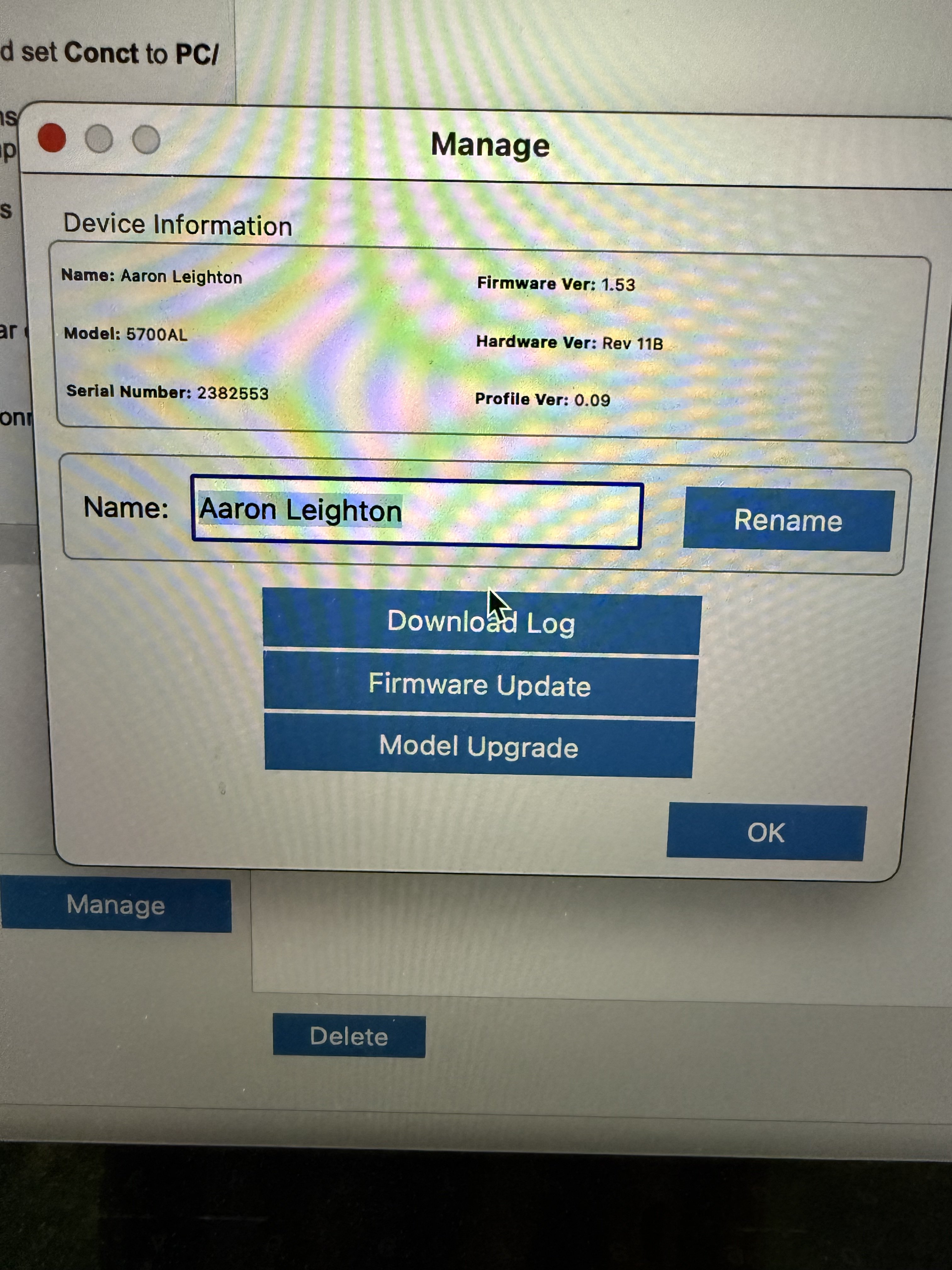

When connecting to Kestrel Link (Mac Desktop Version) it says "no suitable update found" when checking for firmware updates.
When connecting to Kestrel Link (Mac Desktop Version) it says "no suitable update found" when checking for firmware updates.View attachment 8739295
If the macOS updater suffers from the same issue the Windows tool does they basically no longer update it because it can't differentiate between the latest hardware revs.
You must use the Android or iOS app now.
I was less than pleased by the back and forth I had with Kestrel support about it at the start of the year. I also prefer to use the USB/optical cable to update.

Funny thing is the Mac software says “no suitable update” where as the iPhone kestrel link app say 1.57 is available but after downloading multiple times and it going through the cycle is boots up with 1.53
I went through this with a friend and his iPhone and a new 5700x.
The possible "jiggle the handle" method to try; place the iPhone in airplane mode then turn on the Bluetooth radio only. Try to stay away from your car or anything else it may try and connect to. During the update process do not let the phone screen go to sleep. This last part hoses firmware updates on Android as well.
The app has already downloaded the firmware on your previous attempt(s) so it shouldn't need internet to finish it.
