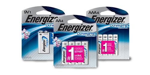

    Just so we are on the same page, is it these batteries we are talking about?:
    First you are totally expressing your anger at the wrong company. Much the same as when a ammo problem damages a gun. You need to man up and own that you are misdirecting your anger.
    Next I want to see pics of batteries. While I am sure it is possible for a lithium to leak I would say it is exceedingly rare. As in you might have better odds of winning the lottery in a couple days. lithium is a proven technology, your scopes more than likely use CR2032 batteries which are and have always been lithium. Your range finder probably uses a CR123 which again has always been lithium.
    I am pretty sure that even if lithium batteries leak it is not corrosive. Alkaline batteries are just that, filled with a Alkali material. Alkali is the opposite of acid and can be just as corrosive. Think of your car battery, opposite chemicals but same result with corrosion.
    It is a known fact that when Alkaline batteries get below a certain voltage the Alkali goes almost "super nova" creating pressure and eating the battery case. It also a known fact that kestrels have a voltage draw even when turned of.
    lithium batteries are used in pretty much every device known to man. As I type this I have 8 lithium operated devices with in 24" of me. Lithium's issue is that it can hold so much energy and dump it so fast that they catch fire.
    I agree in the anger being directed at the wrong company but if he says they are lithium then id assume they are. Lets hold off on calling him a liar on the lithium's until we see this picture.

    Even as battery technology has evolved, battery leaks are still a problem today. Many brands of batteries can still corrode and damage devices after being fully used.
    Energizer® is different. Our batteries are designed to prevent damaging leaks or we will replace your device.
    So when it comes to toys, digital cameras and other valuable devices, you can feel confident knowing you have the long-lasting power and protection you'd expect from Energizer®.
    So, There you have it. Energizer Guarantees that their batteries won't leak, or they will replace your electronics. you should have saved them Batteries.
