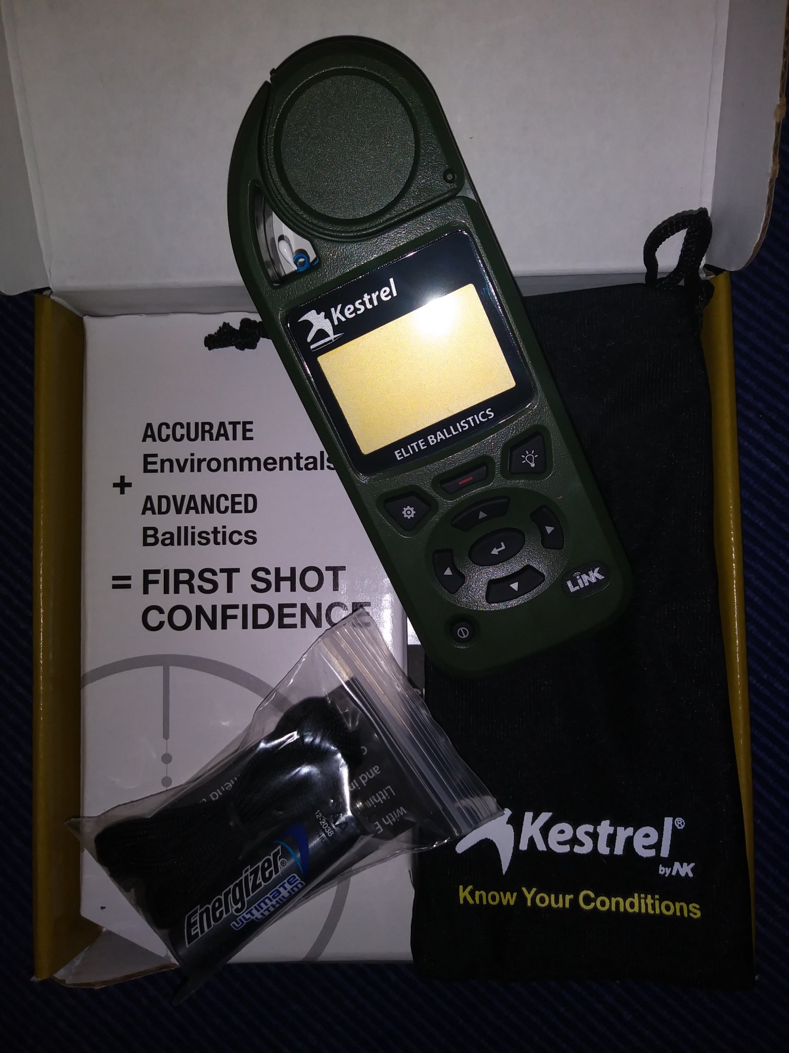

The 5700 Elite with Applied Ballistics/Link just arrived. The evening is booked with work prep for tomorrow....so immense will-power must be summoned to resist loading the battery and starting the setup/data entry.
If the weekend allows for testing the precise muzzle velocity, the rest of the data will be simple. As advised by you, I'll carefully consider settings to preserve battery function as well as great shooting insights.
Interestingly, the model does not say "Applied Ballistics" as shown elsewhere...but shows "Elite Ballistics." Hmmmm, go figure???

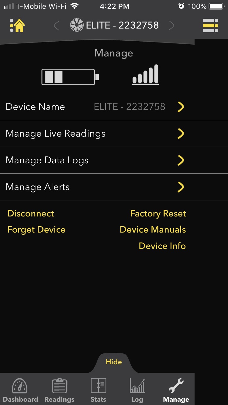

Try this, connect Kestrel to Kestrel link app (not the Kestrel Ballistics app, you may need to download if not on your phone) , and rename the kestrel and then close the Link app (be sure to close it and break the connection with the Kestrel). Then try the ballistics app again. Please post your results.

I downloaded the Kestrel app and was able to connect to my 5700, but when it instructs me to rename my device, I enter a different name and I hit submit, it takes me to Kestrel registration. I am already a registered user. It gives me a choice to "skip" or be "done". Either choice just sends me back to "rename device" -- an infinite loop!
Sorry about all of this. Please try this: try a soft reboot of kestrel, take battery out and hold down the power key for 30 seconds. Then put the battery back in and see if it will connect with the Kestrel Ballistics App. You will need to calibrate the compass before shooting again, but hopefully the new name will register with the ballistic app. Again, let me know the results.
Also, you say your iPhone X operating system upgraded and that was the beginning of this problem?
