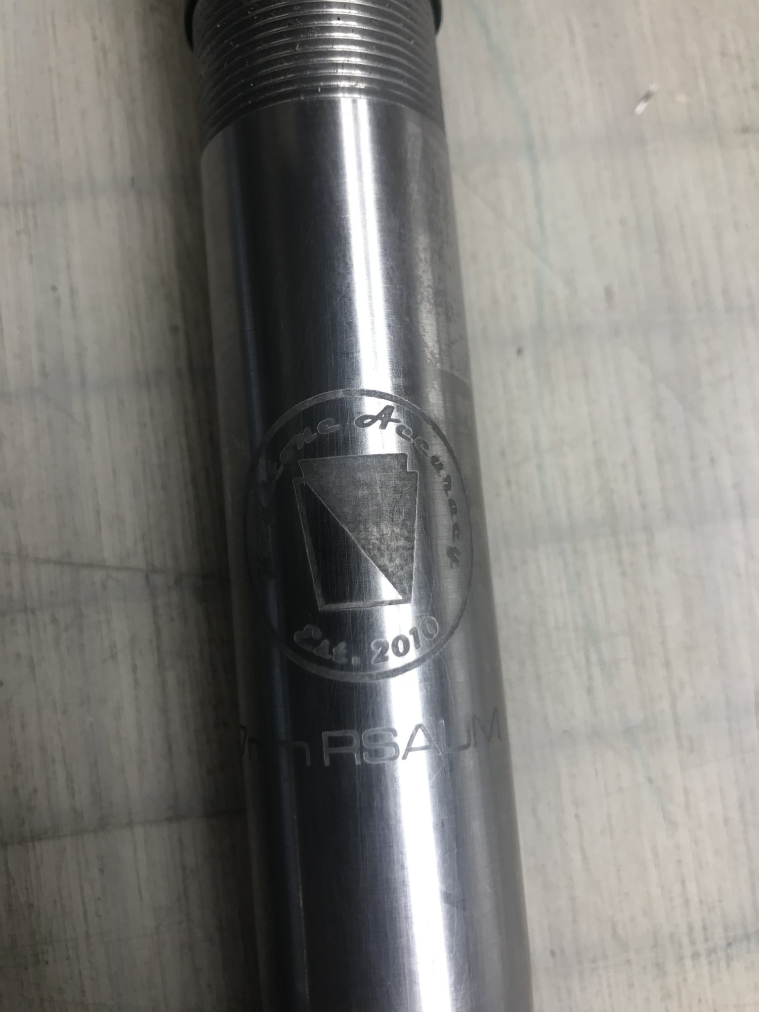

Was shooting the Berger 168 hunters in my 7 saum barrel I got from keystone last year on Sunday.
A fairly mild load and a pleasure to shoot that still smoked my 260 performance.

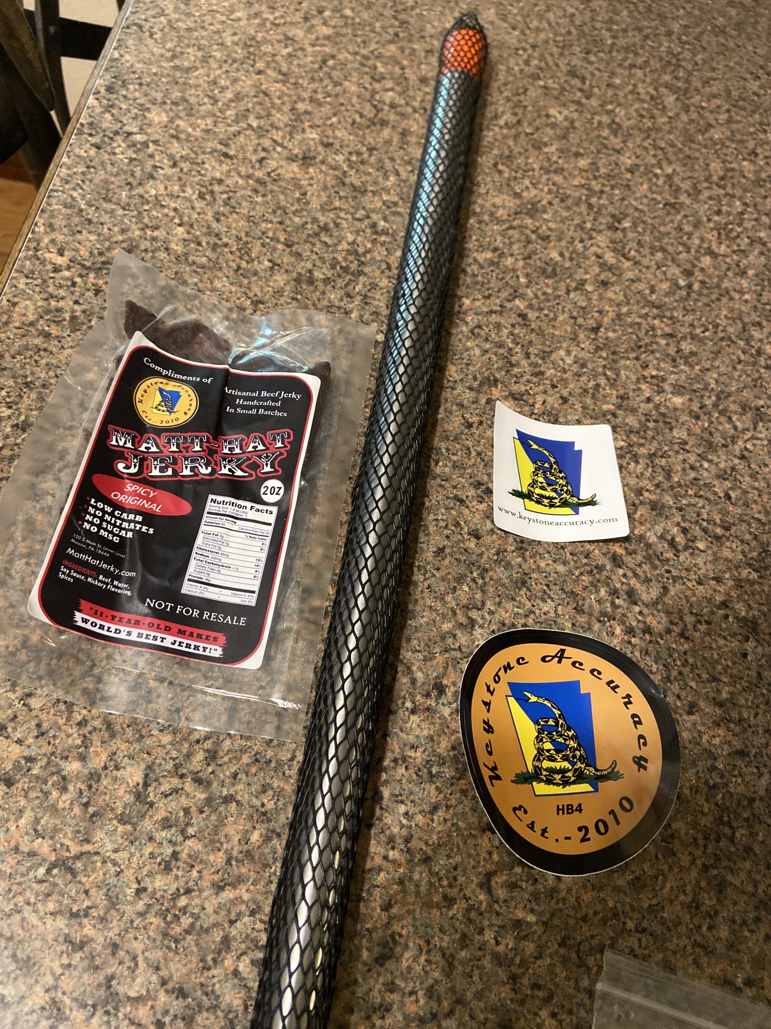

That’s some pretty interesting beef jerky
Plenty tasty without going overboard on the spices.

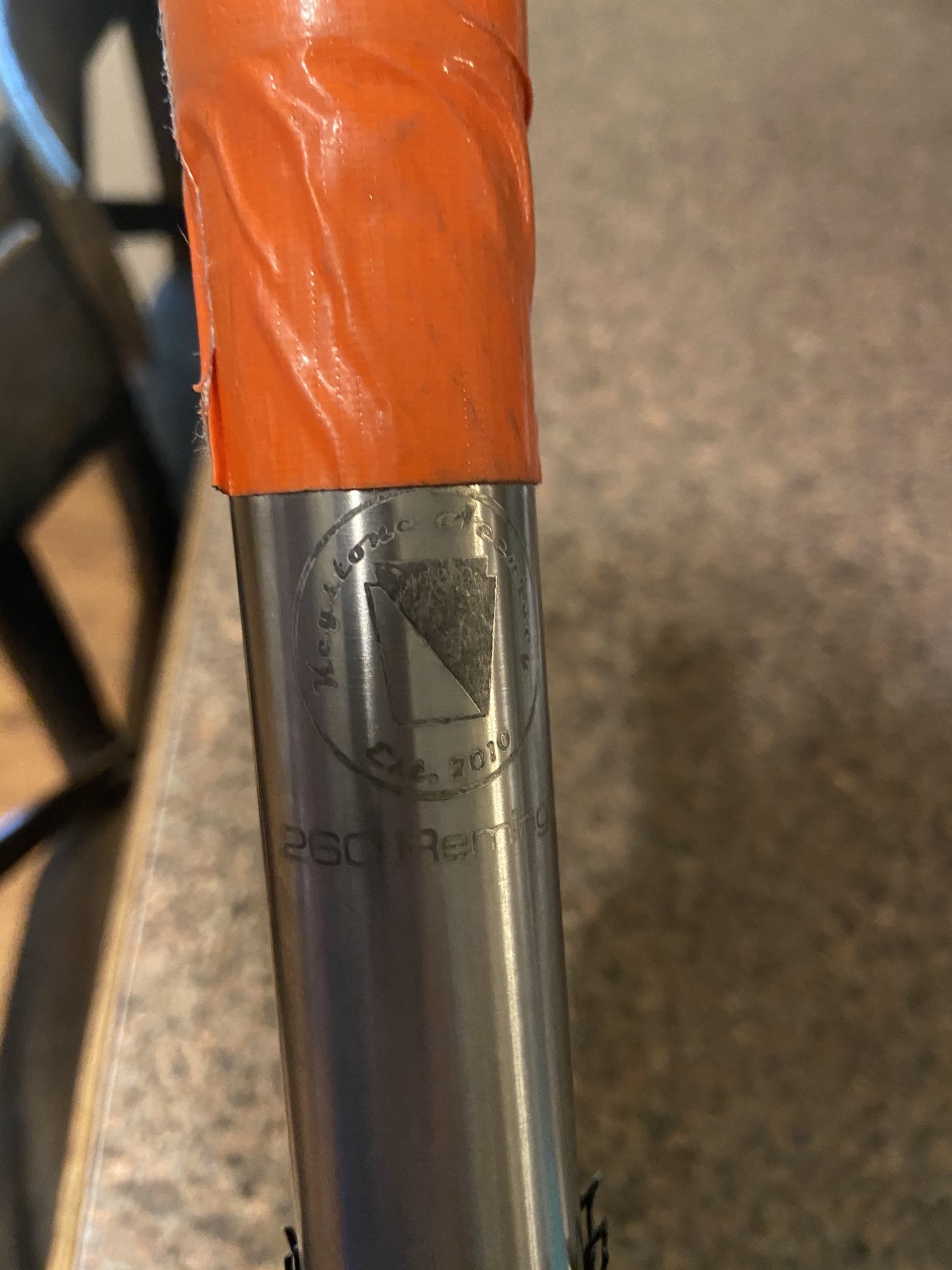

When do you typically pull your 260 barrels? I’m at 2k on my factory barrel and still capable of shooting 1/2 minute out to 800.
Borescoped the new barrel yesterday. Sexy af
I’ve gotten 3000+ on my last two.
They lost a good bit of speed and you had to clean them on a regular schedule as they started to foul.
Both of them still held moa if you kept them clean.
I bore scoped my first brux, flawless!
That’s about what I was figuring. I’ll run it the rest of the year then swap it.
7 mm Magical pony magnum
Aka 7mm midget magnum
Aka 7 saum
Haha, nice. Hope it shoots magic pony fart pills real good. I'm thinking that might be a good caliber in my bighorn origin short action once I get my other barrels done.
I have a Krieger 6GT barrel that should be shipping next week for it.

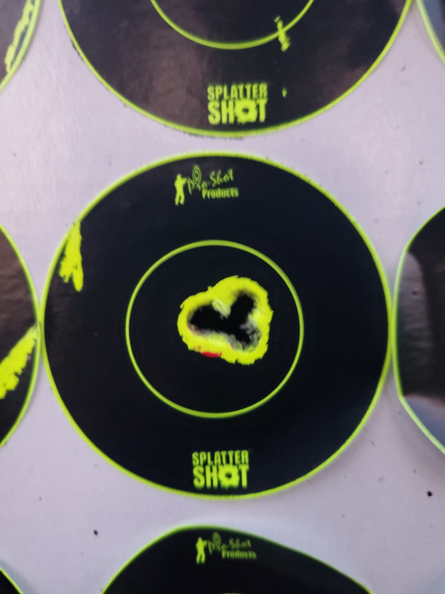

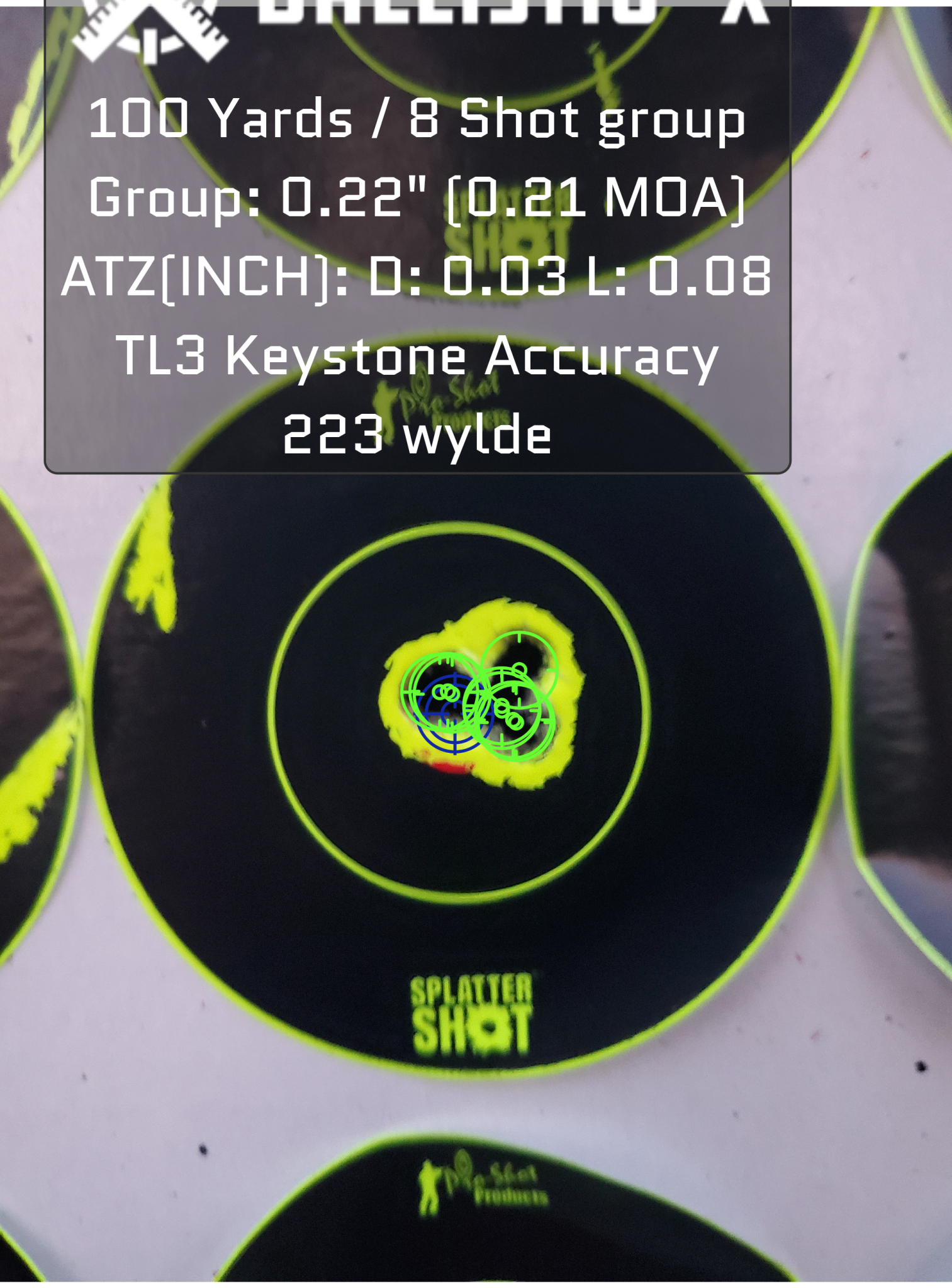

Just a follow up to the KA barrel I bought. Finally got around to working up a load for it. Tried 75eldms without much luck and moved on to Berger Fullbores. 23.5gr Varget 5 thousands off the lands. My previous best group was a 10 shot just over .3 with my old Dasher. Shot this 8 shot group tonight.
