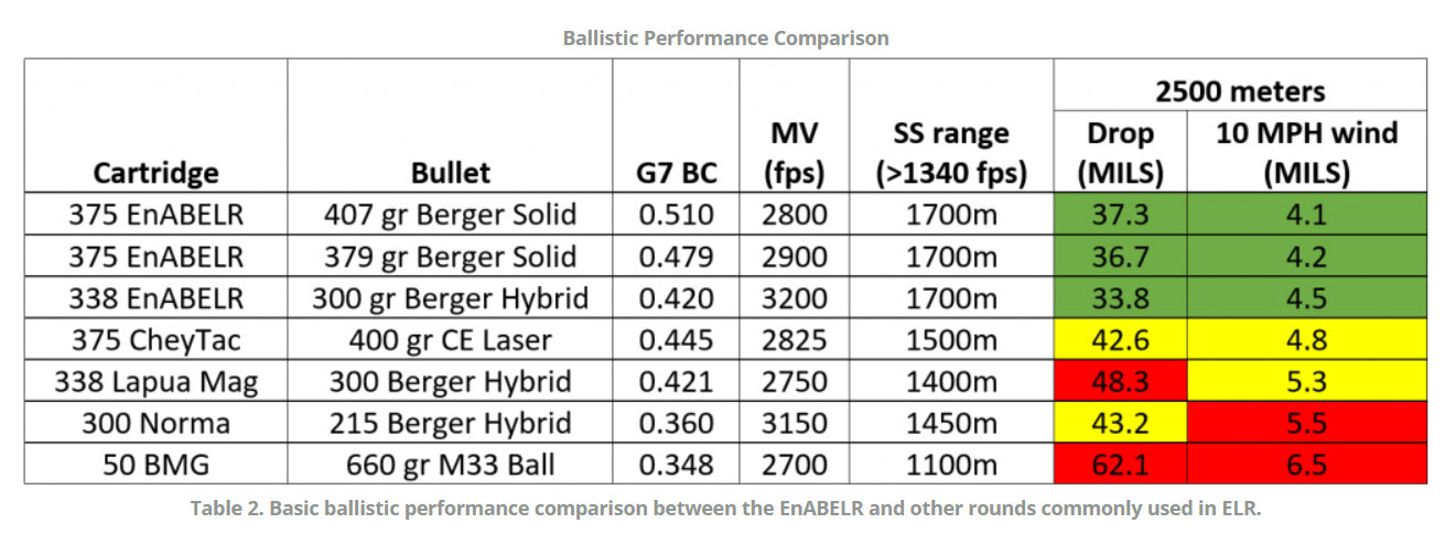

1 - You are firing a 350-400 grain bullet in the .375 EnABLER versus firing a 650-750 grain in the .50 BMG. That significant increase in bullet weight either gives you the ability to have a larger "payload" in the bullet, or it can allow the bullet to do more damage when it impacts. If my mission is antimaterial, and that was a primary mission for the .50, I would rather have the ability to be hitting my target with twice the bullet weight, or a specialized payload (Mk 211). Also, if I was a bad guy hiding behind "cover", I would be a lot more worried if someone was firing an armor piercing or explosive .50 BMG round at me, versus some type of a .375 "match round" which is most likely just going to break up on impact with a hard surface. Until someone is actually producing .375 bullets with comparable .50 BMG bullet payloads, it is not even close to being a fair comparison.
2 - As called out by a number of people, the bullets used in the comparisons have been absolutely ridiculous! Per the chart below created by AB, they have been using the M33 Ball as the baseline comparison for the .50 BMG, while using the highest BC Bullets available for the .375 EnABLER. in comparison, M33 Ball = 0.348 versus 750 AMAX = 0.486, there are also .50s that have a BC that exceeds 0.500 like Cutting Edge.
View attachment 8429372Once again, trying to compare the capabilities of something coming out of the Extreme Long Range Sniper Rifle (ELR-SR) to the existing .50 BMG rifles is not anywhere close to a fair comparison. Humping/maneuvering with a M107 is a bitch, but the amount of carnage/damage that you can inflict with one is not going to be currently matched by anything coming out of the ELR-SR solicitation!

Shady and disingenuous? Why not that's what most companies do when marketing a product it's called liberal math. Also known as Hornady math .There’s nothing wrong with comparing apples to oranges. Discretize, categorize, and normalize. We do it all the time in statistics and data science.
But, the bullet comparison was shady and disingenuous.
