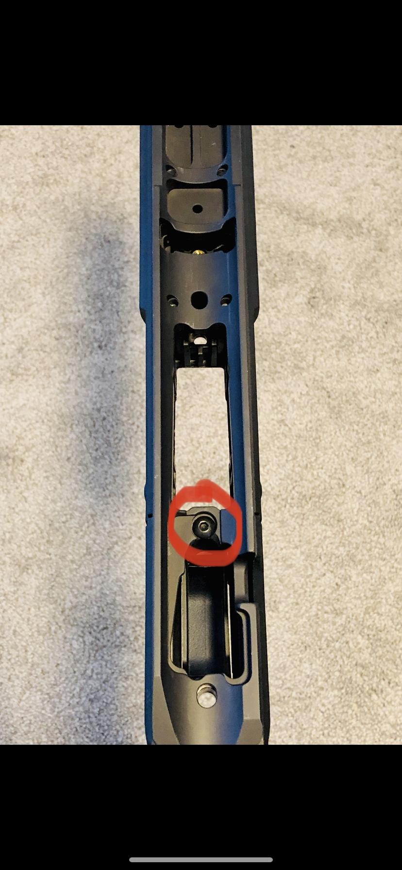

I have a Bravo stock that is paired up with an ARC Nucleus in long action. I am using Accurate 300WM mags in CIP length. The bolt is riding over the round unless I push on the bottom of the mag.
Anyone else run into these issues?
You can adjust the trigger guard forward and aft as well as the front hand guard to slide the mag up into the catch better. See if that helps? Have the same set up and I had to play with it a bit to get it to seat right.
I also had the same problem just with a SA. I contacted KRG and they fired an email right back with the solution.
As @alfmoonspace said. I was not familiar with which screw was used to adjust the trigger guard. The picture below is from KRG.
