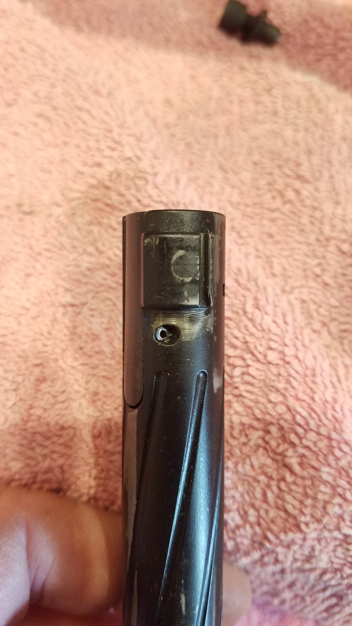

Here's one from a friend's rifle a year ago.
His bolt would lock in but always felt a little wrong.
Here's the mark on the bottom lug:

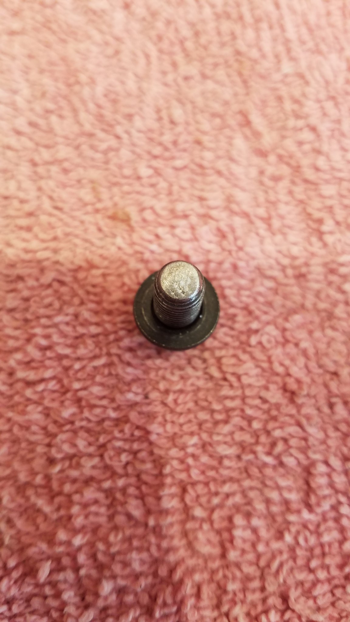

The offending screw:

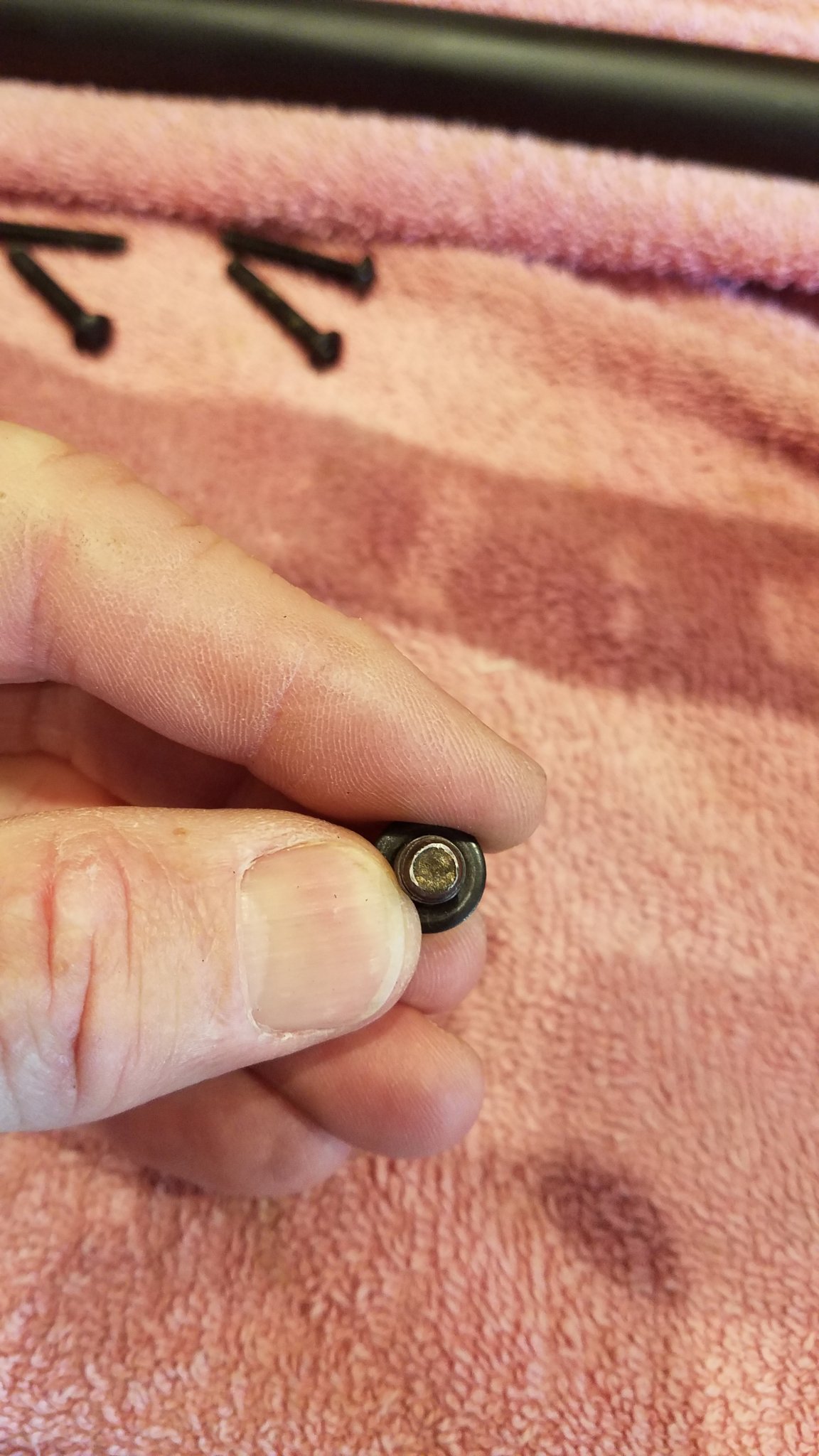

A few strokes with a file to fix it:
Yours could be fixed with the proper washers or by shortening the action screw.
Make sure your bottom metal fits and functions properly before you decide which is the proper fix.
