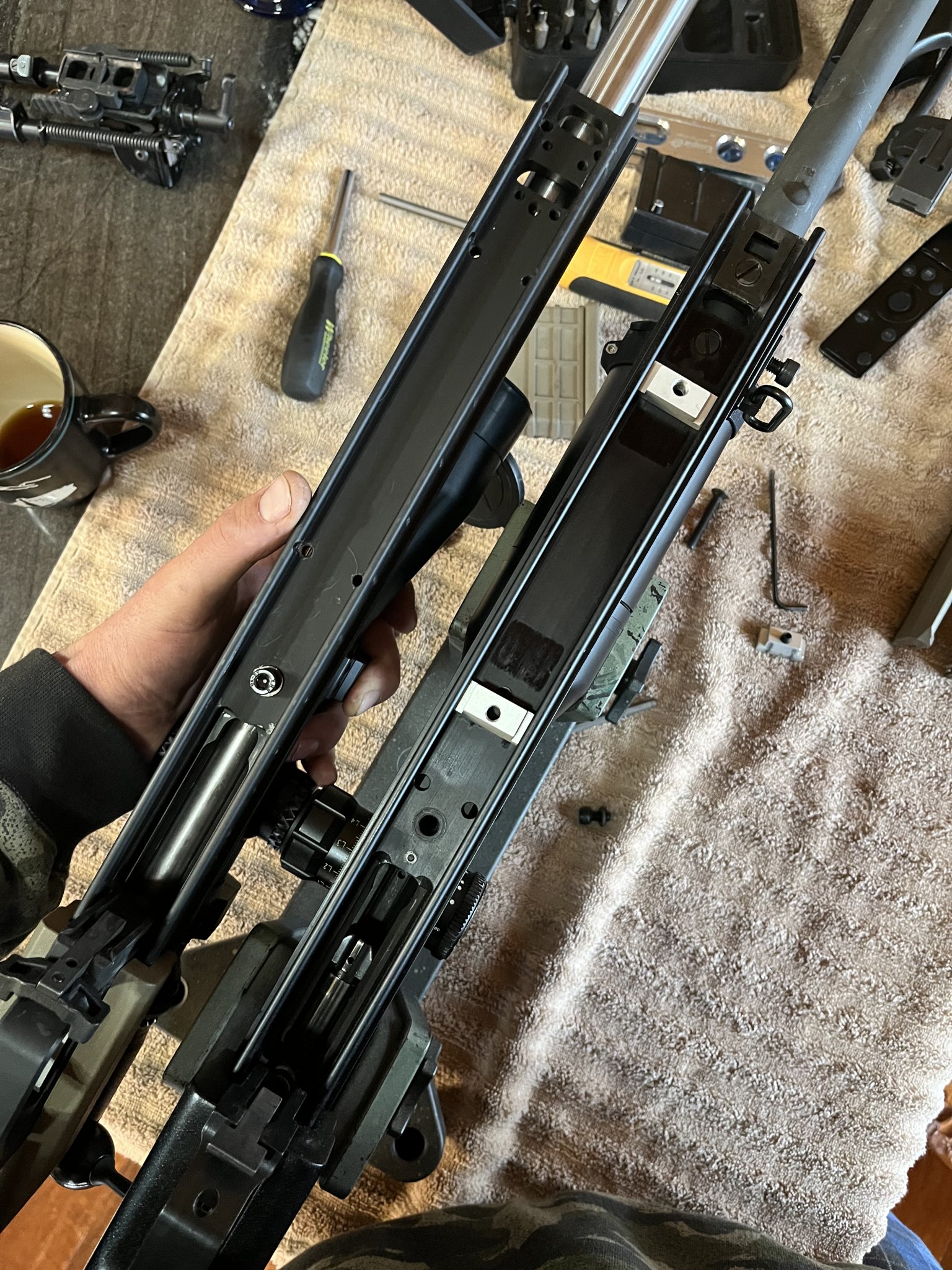

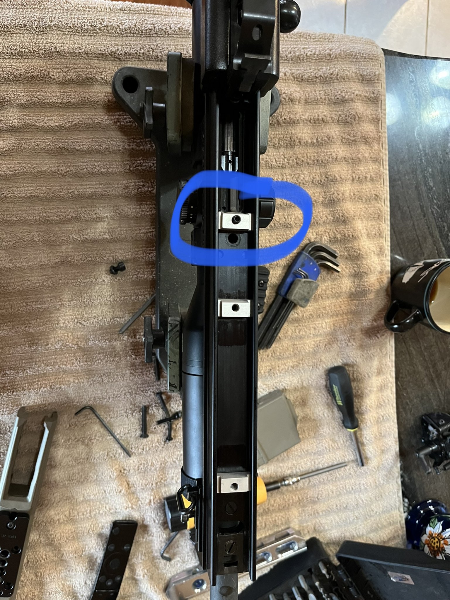

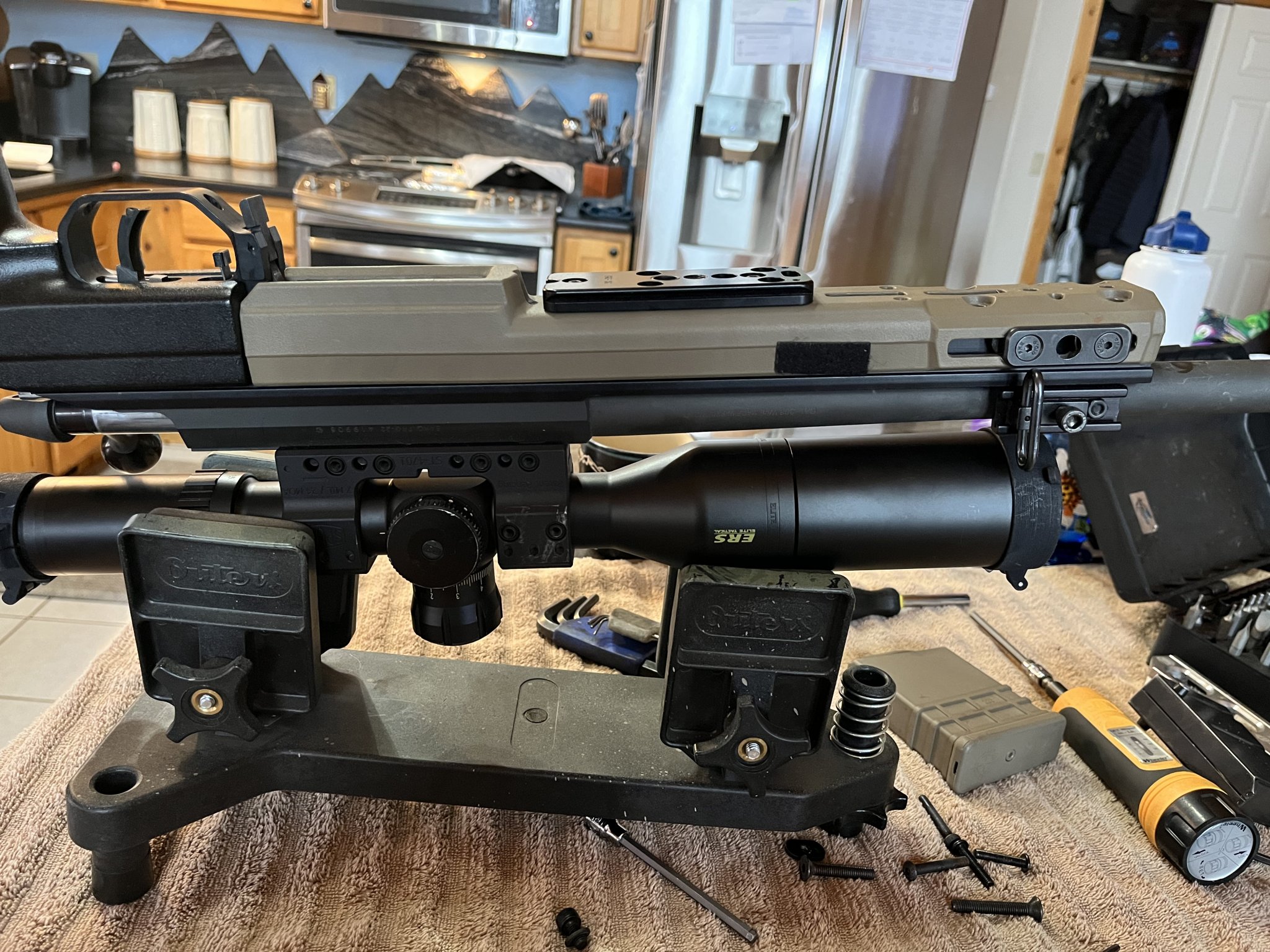

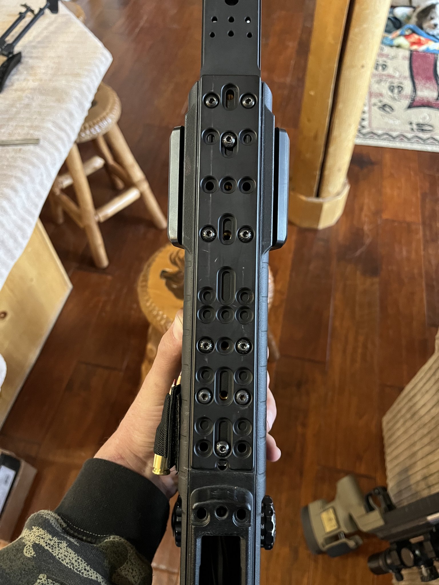

So I pulled my trg and my tikka bravo apart. The bravo forend physically fits on the trg backbone once you remove the front magazine “guide or support” on the trg. I circled it in the below picture.
My thoughts were that you would be able to drill and tap the trg backbone to match the krg backbone/forend but it appears the trg backbone is very thin in those areas so that would not work. I measured .120” for the trg and the krg backbone on my tikka is around .290 where it’s threaded.

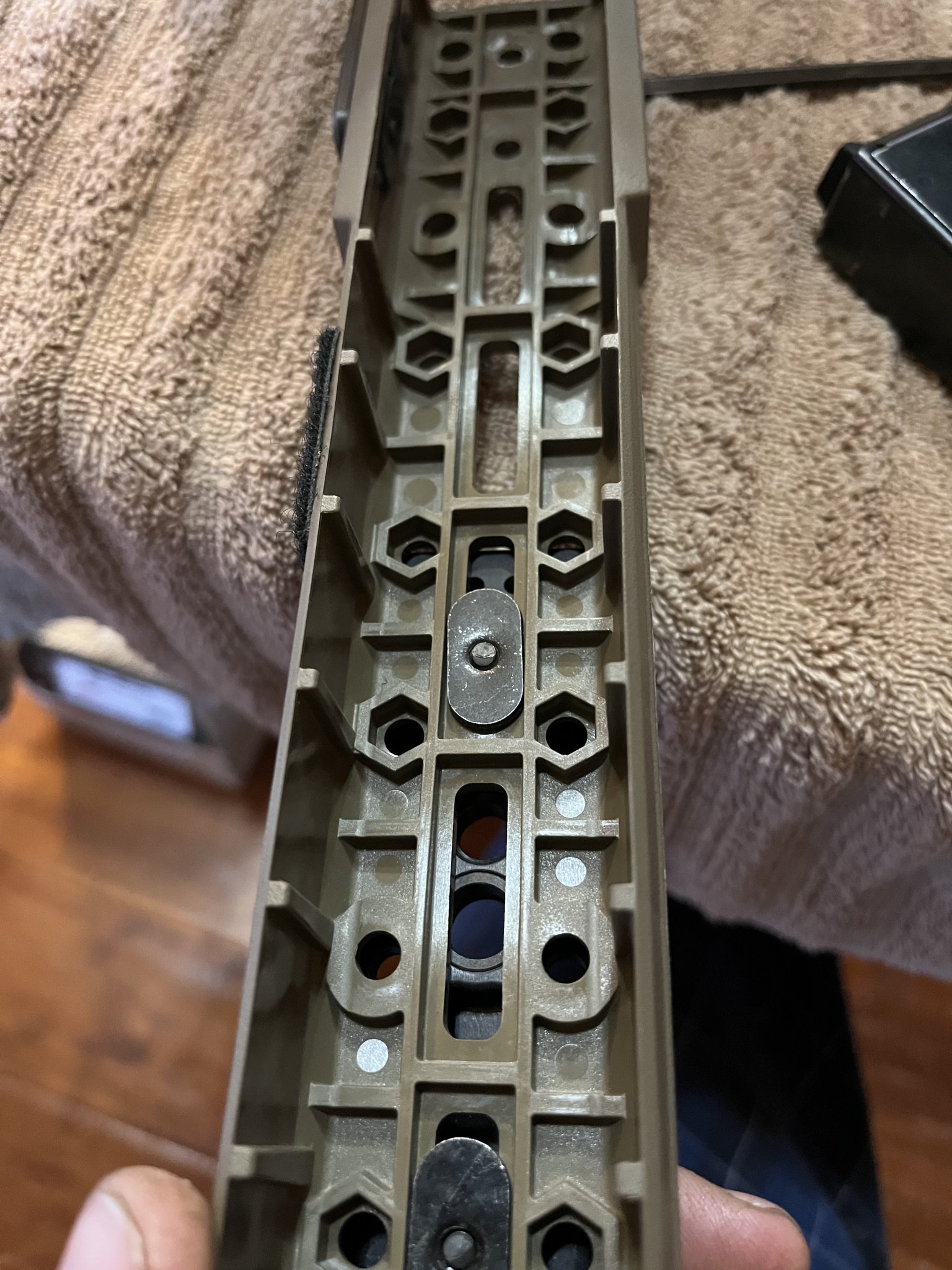

So next option would be mount the krg forend in the center using the trg mounting blocks. This could work but atleast the plastic forend I have had mlok slots down the center and the back side is recessed for the mlok threaded inserts leaving only .1” of material. You could throw a bolt and washer to spread the load and be able to crank it down but would be ugly. If you use the krg arca rail it already has holes drilled and counter sunk down the center so you could move and adjust the trg mounting blocks to line up with 2 of those holes and make it work.
Last option, just buy the krg whiskey 3 chassis for the trg. Then in theory the enclosed forend would mount right up and all you would have to do in theory is machine out the magwell to match the trg mag. Obviously call and verify with KRG that the whiskey chassis for the trg uses the same forend mounting pattern.

What I was most worried about was if there are any interference between the enclosed forend and TRG backbone. If there is none, then milling a couple of aluminium blocks (like the pieces circled in blue) but with better fit and more material for more holes would be simple.
