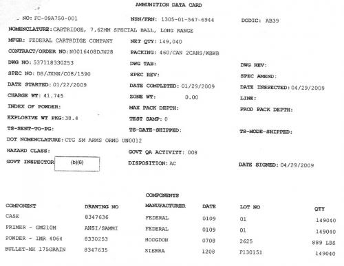

Mk316 = 41.7 gr of 4064, FGMM primer, 175 SMK.

Is that LC LR brass for the Mk316 clone with 4064?
No. Lake City LR brass was used in the M118LR. Mk136 is a different round made by Federal. The military mk316 and commercial 7.62 GMM load uses an FC Case with 2-digit year on the headstamp.
