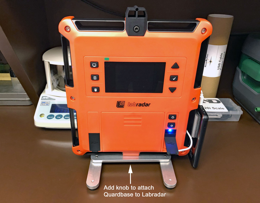

Arkco Machine Products Quadbase – Nice product for those like myself that shoot from the bench. Arkco states that it can be left installed while stored in the soft case, but Labradar must have made the latest soft cases smaller because that combination will not work now.

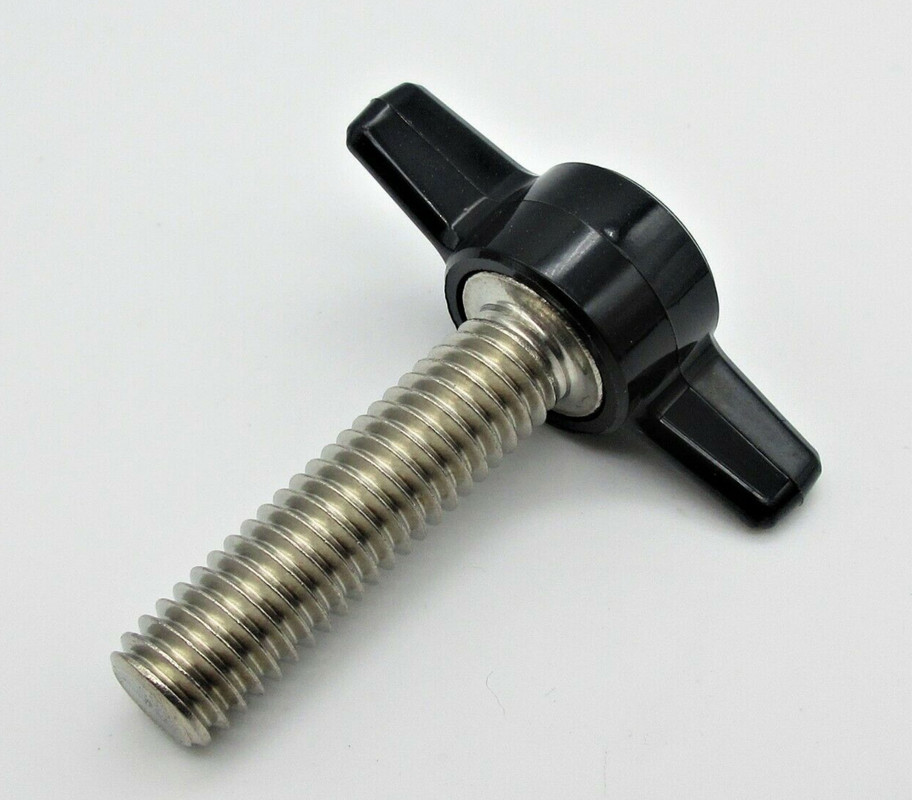

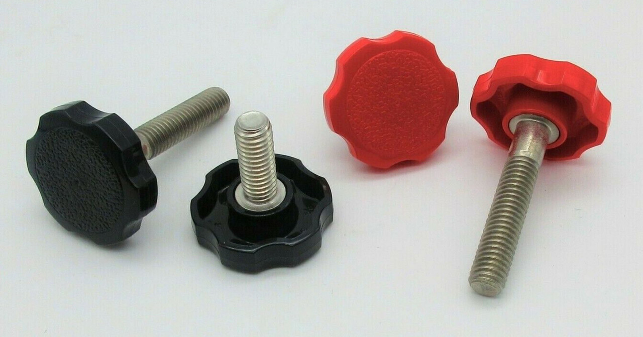

This is not a big issue for me since I don't mind packing it in one of my other bags when I go to the range. What I would like to do is store the Quadbase with the legs extended and install it on the Labrador at the range. Does anyone know of any way to epoxy a plastic knob on the attachment cap screw so I don't have to bring a dedicated Allen wrench along to the range? See attached examples of knobs. I think there is enough room for clearance underneath.

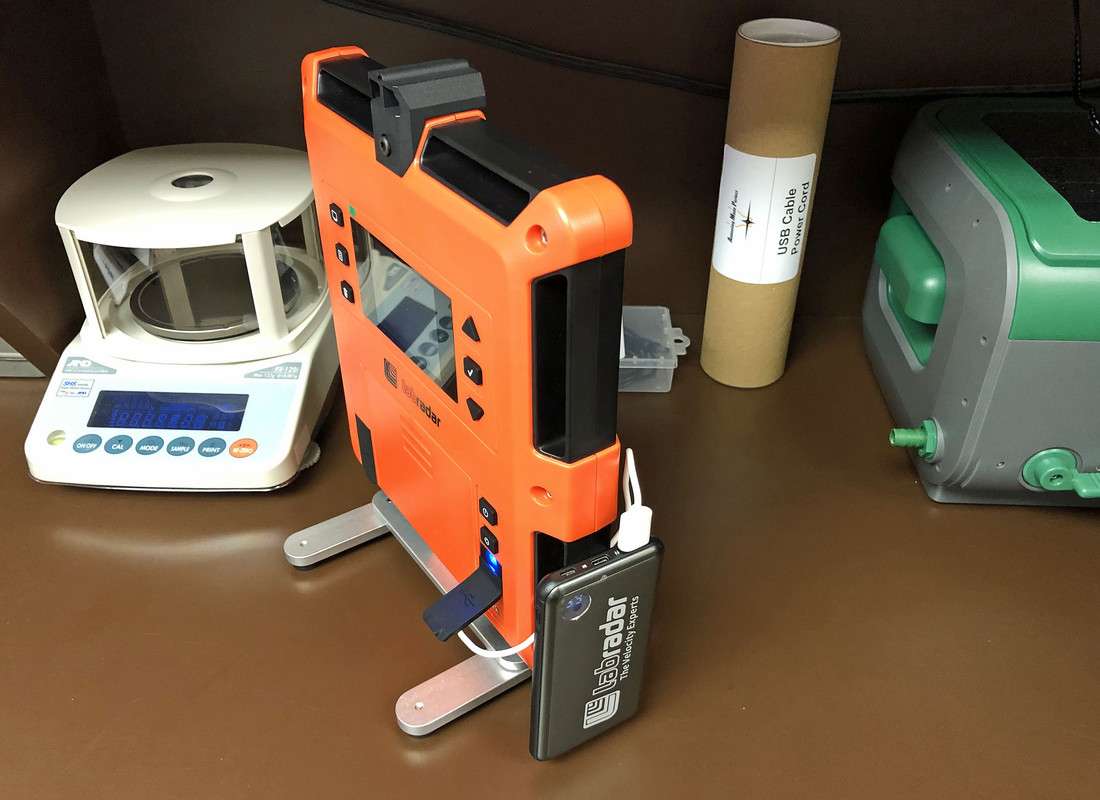

Labradar External Battery – How are others using an external battery with the Labradar? When used with the Arkco Machine Products Quadbase I find I have to install the battery upside down due to the USB cable not clearing the bench surface in the opposite orientation. Since the battery has to be removed and unplugged before packing the Labradar away I wonder if it would be more convenient to just plug it in and leave it lose on the bench while in operation.

I run their external power pack also. I no longer even try to use the Velcro to stick it on the unit after it falling off numerous time and finally bending the shit out of the mini USB of the supplied white cable. I just have a longer cable and lay the pack on bench or ground.
If I turn the unit off, then try to turn it back on after some minutes it won’t come on because the power bank went to sleep. If this happens to you, just press the button on the side of the bank and the display will come on and the unit will power up.

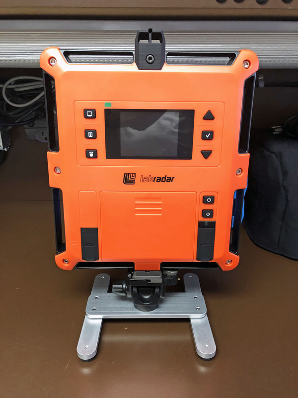

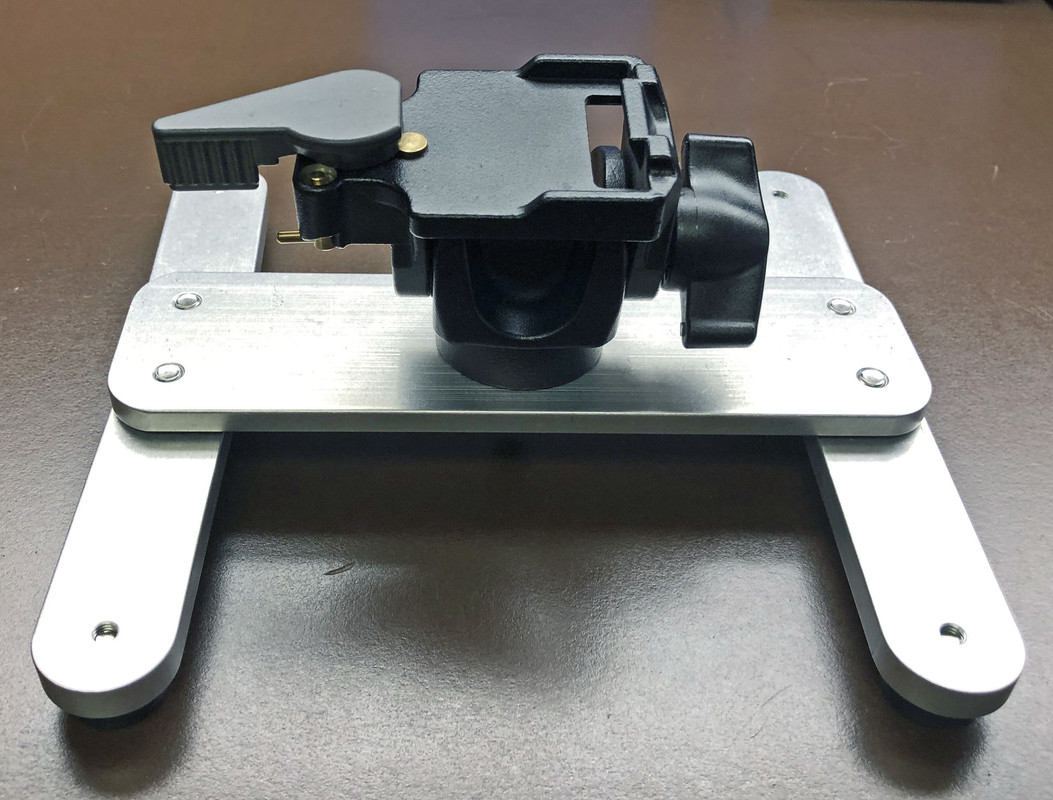

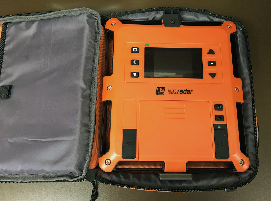

Over the weekend in an e-mail to me Matt from ARK Machine recommended a QD mount. It was then I remembered I had a tilt QD head on a Manfrotto carbon fiber monopod I have not used in years and it works perfect. See attached photos. The Labradar just squeezes in the soft case with the MK Machining Labradar sight and Manfrotto QG plate installed.
If anyone is interested the tilt head is a Manfrotto 234RC.
