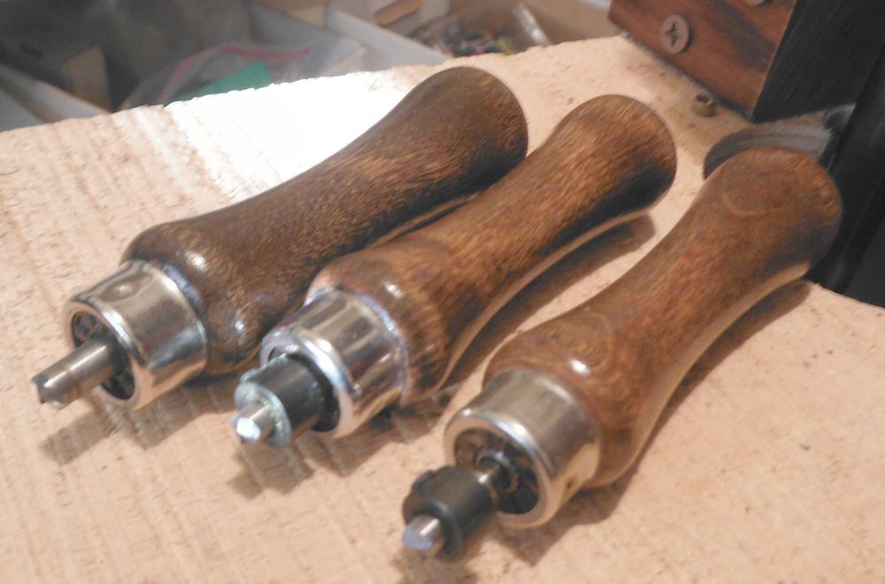

I got a Lyman pocket uniformer ~ 12 years ago for S&B 7.62x54r brass that did not have a small radius at the bottom of the primer pocket and made the primers stand up proud.
I then switched to Lapua brass.
But over the years, the pocket uniformer has been great to have around.
Lyman Products Your Primary Source for Reloading Equipment
Lyman Primer Pocket Uniformer Tool

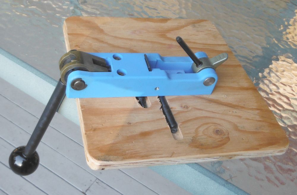

Super Swage 600: Case Preparation Equipment Super Swage 600 Dillon 7-8-2014.jpgLyman pocket uniformers b 7-8-2014.jpg
The Dillon super swage is for the orifice of the primer pocket, not the bottom.
That is a great tool.
+1 for the Dillon Swage. I've had one for years, and have used it pretty religiously on new (i.e., once fired) military brass, AFTER depriming with a Lee universal decapping die. It's a bit of a nuisance when you get 1000 fresh cases, but you only have to do it once, and after you get a rhythm it goes pretty quickly. The key is to have the unswaged cases where it's easy to pick one up with one hand, and have someplace to dump the just-swaged case after you pull it off the support shaft with the other hand, so you don't have to do any careful handling of it during the run. I don't recall having any high primer problems with the military cases I've swaged over the years, either 308 or 223. (Some of the Lake City Match 308 case got their primer pockets uniformed, but most 308s didn't, and none of the 223s did.)
another one for the lyman pocket uniformer. i bought the kit a few years back and have never had a primer pocket that i couldn't ream out or make the pocket spec deep with the uniformers. comes with large and small primer pocket reamers and uniformers and camphor/deburr tools also and primer pocket cleaners that i never use.
