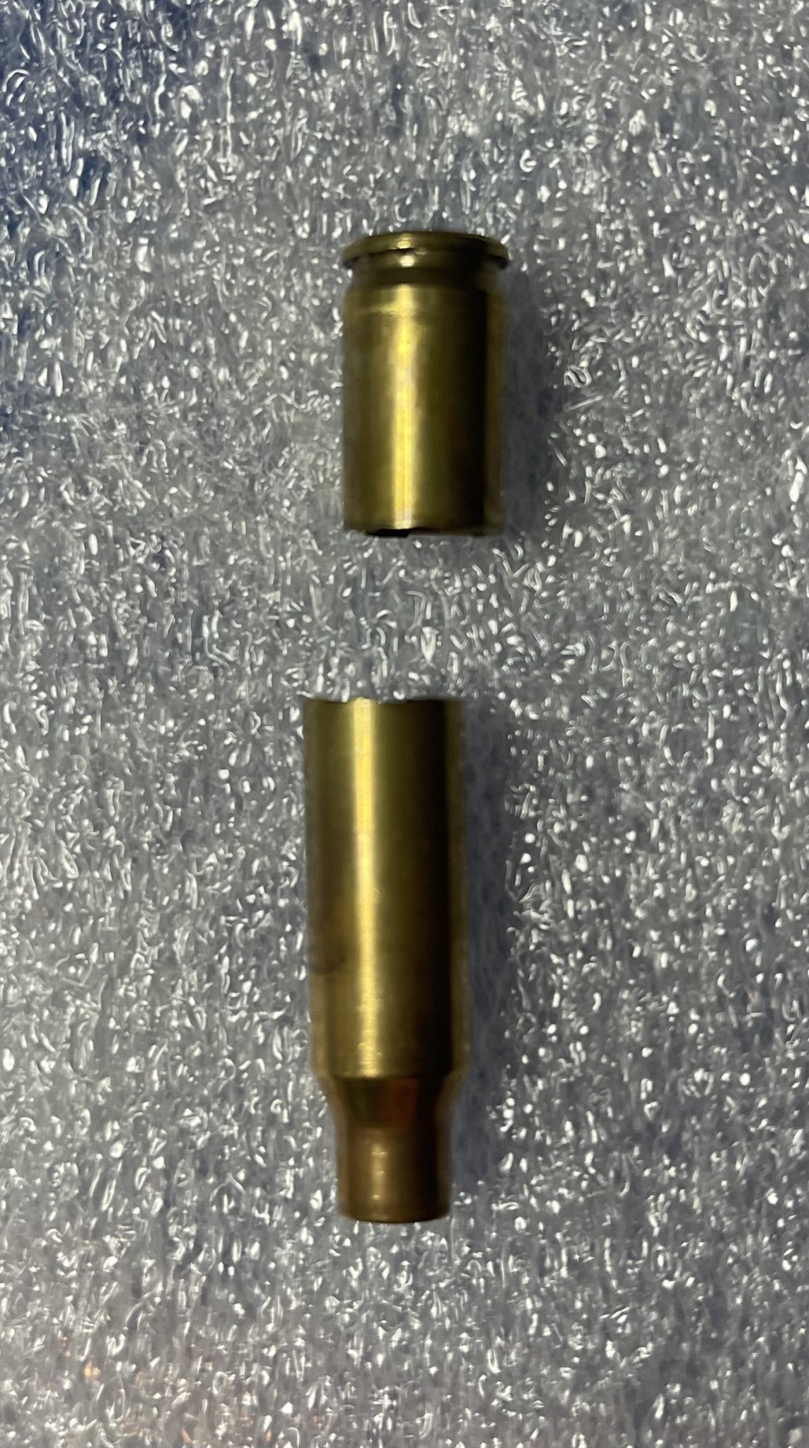

Wondering if anyone has encountered a situation like this...
I bought some Lapua brass for my .223. I have reloaded this brass 5 times. My reloading process includes, de-prime, anneal, wet tumble, full resize, mandrel, prime, and load. After the 5th firing, I found one of my brass broke in half in the wet tumble. Later, when i got to the mandrel stage, i found four of my brass collapsing at the shoulder. At this point, i retired the whole batch of 50 Lapua Brass due to safety concerns.
As for the loads themselves, I am running 24.3gr of IMR 8208 in order to push 80gr Berger VLDs at 2940fps. My barrel is a 1:7 twist at 28" bull barrel. I observe my brass after each firing and have never seen any signs of over pressure. When the brass is ejected after firing, it is barely warm at all.
I have other brass from Lapua and Peterson for my 6.5 creedmoor. I am able to get up to 10 loads from each. But for my .223 Lapua Brass, it seems i am lucky to get 5 reloads.
Any thoughts?

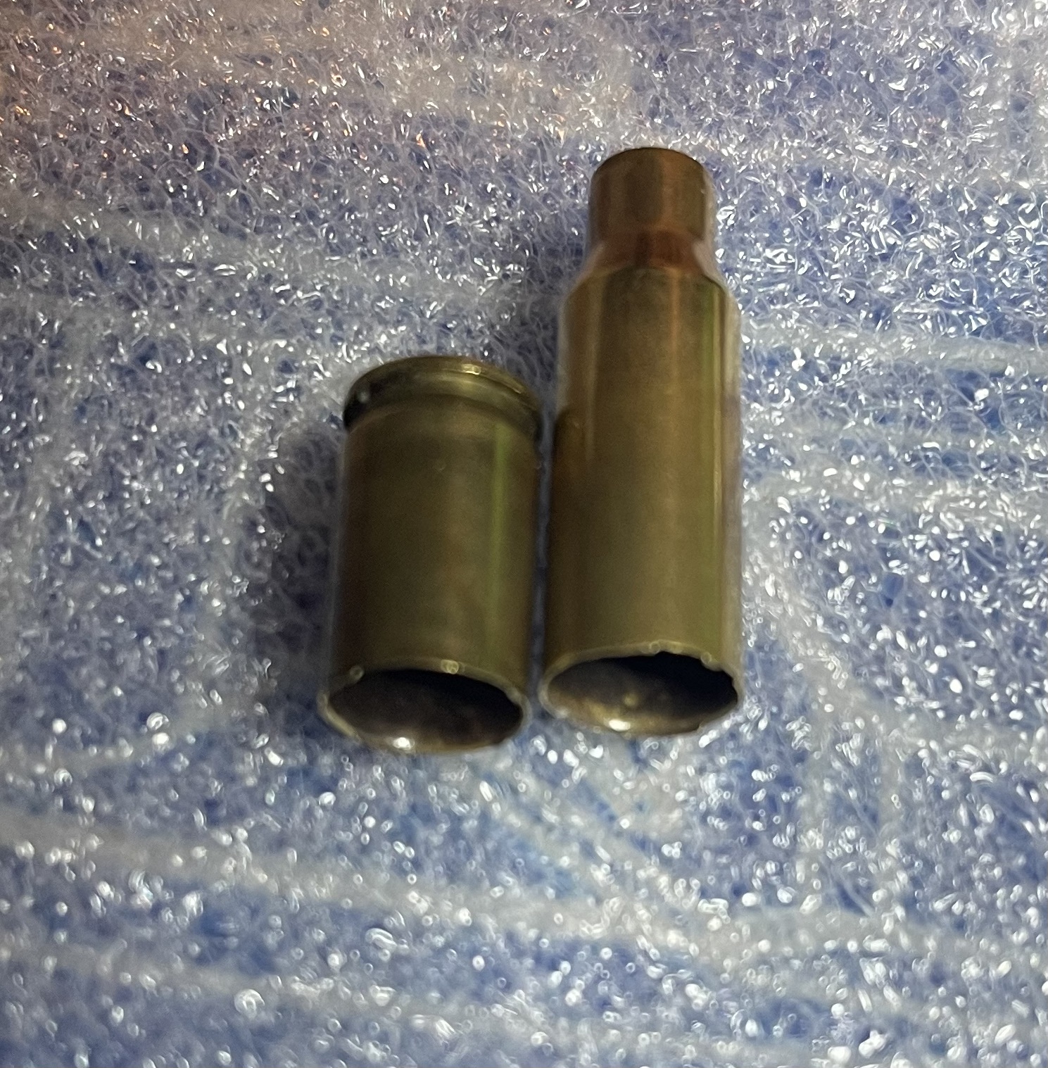

View attachment 8286496View attachment 8286497
You are setting the shoulder back too far, causing the case to stretch and thin. Here are 2 commercial cartridge gauges one 308 and one 6 5 Creedmoor with a go gauge inserted to see how they compare to the chamber and the reamer that actually cut the chamber....notice the cartridge gauges are off +.002" and the other -.002" for .004" difference...some will be closer. But when using gauges to drop the cartridges in ya gotta know where it is in comparison to the chamber.

Once again, OP - I would strongly recommend you check the overall case length of any cases that you have fired and wish to reload. You have been shooting very hot loads and knocking the shoulder back repeatedly, in a rifle that may not have the headspace set correctly. As you are aware, this has thinned the brass out, and the repeated resizings have moved the brass material out of the case sides and into the shoulder and neck, lengthening the case overall length. (You do not mention checking and trimming case length as part of your reloading regimen.) If you were not getting serious pressure signs with this same load on prior loadings, yet separated a case, I would strongly suspect, as mentioned above, that you have pinched a bullet and case neck into the area of your chamber that has not been cut for the full neck diameter. As well as checking case lengths, it might also be useful to chamber your longest empty case and look at where the end of the neck is positioned in the chamber with a borescope. I do not mean to disparage your reloading methods or talk down to you, but checking case length after each firing, especially with hot loads, is a mundane and boring exercise, but can be critically important and can prevent serious issues.

Thought experiment: imagine that new cases are exactly chamber size in all dimensions. You load 'em up and shoot. Suppose your load is very hot - high pressure. The pressure will push forward on the chamber shoulder and back on the case head and stretch the chamber. At most shooting pressures, the brass is soft like butter so when the chamber under pressure gets longer, the case stretches a little, usually at the weakest spot somewhere in the middle of the case wall. When the pressure drops the case is forced back to "cold" size. That thin-crush cycle creates an unstable area in the case wall - kind of a crunched ring. If you fire that case several times the case will eventually fail at that ring.
Now take the same case and push the shoulder back ten thou. When the firing pin hits the primer it shoves the brass forward until the case shoulder hits the chamber shoulder then the primer fires and the powder flashes. The case walls grab onto the chamber walls but the pressure is also pushing the case base toward the bolt face. The base moves ten thou - the length that you bumped the shoulder. And that thin spot gets a lot thinner. When you size the case, you shove the base and shoulder back together - wrap a sheet of paper around a can, wrap your hands around ends of the can then push your hands together. The brass will behave a little like that. Note we didn't need to overcharge the ammo, just excessive shoulder bump. High pressure creates more stretch so makes it worse.
The point of minimal shoulder bump is to reduce the thin-crush cycle and, thereby, increase brass life. You can probably bump shoulders by fifteen thou and load them really hot - the military does something like that. But after one firing the brass is damaged. You have the evidence in your hand. Deep shoulder bump makes the brass tolerate a dirty environment better - more room for crud. Imagine you are getting shot at, I don't know about you but I'm not digging around for my brass so I don't care if I get only shot. But if that brass was expensive and you are picking it up and giving it tender loving care, minimize the shoulder bump. It will still fail eventually but you get to use it longer.
I do spot check my cases as part of normal reloading. To be sure, i just checked my fresh fired cases in a case gauge and they fit fine in every way. I will check again for length once they are resized.

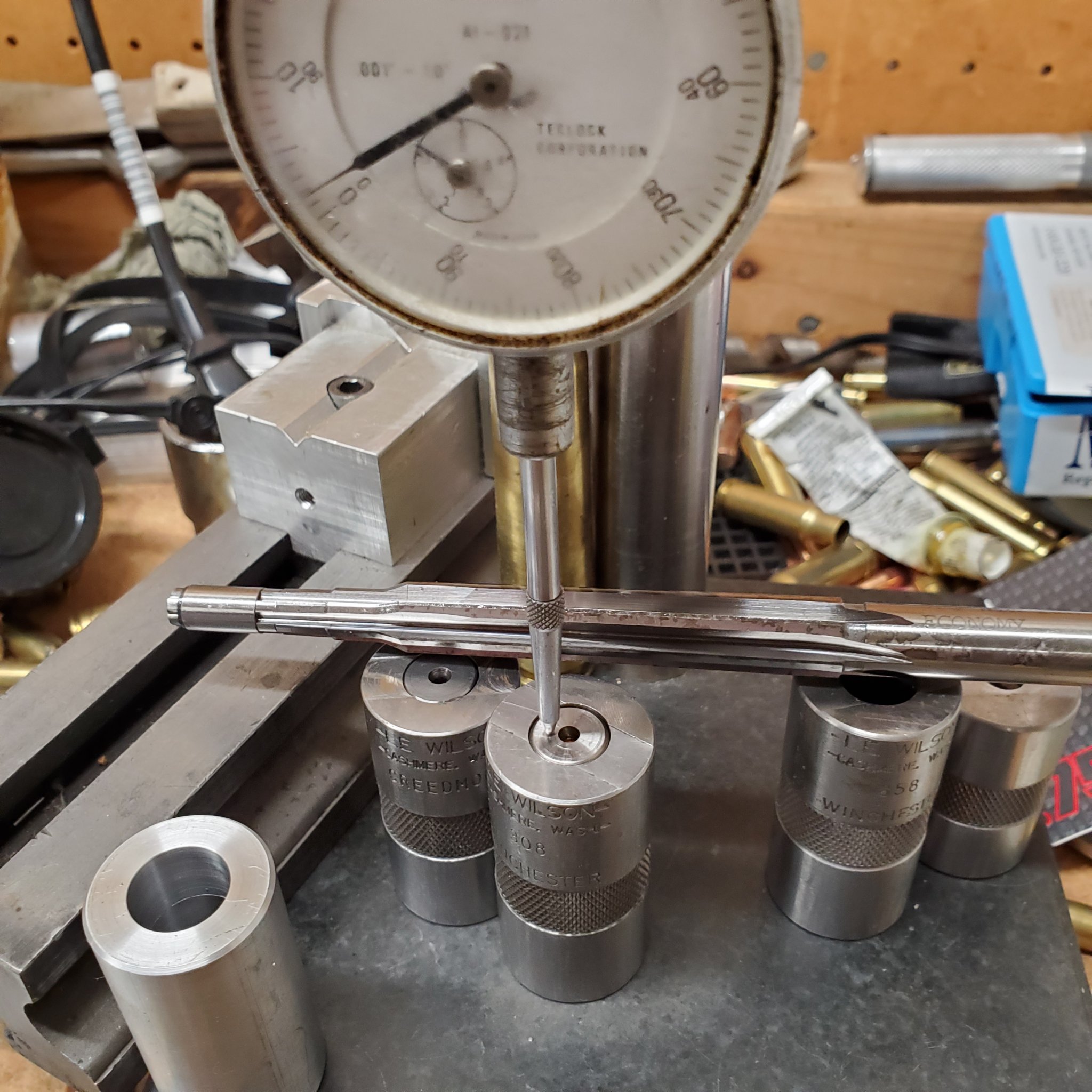

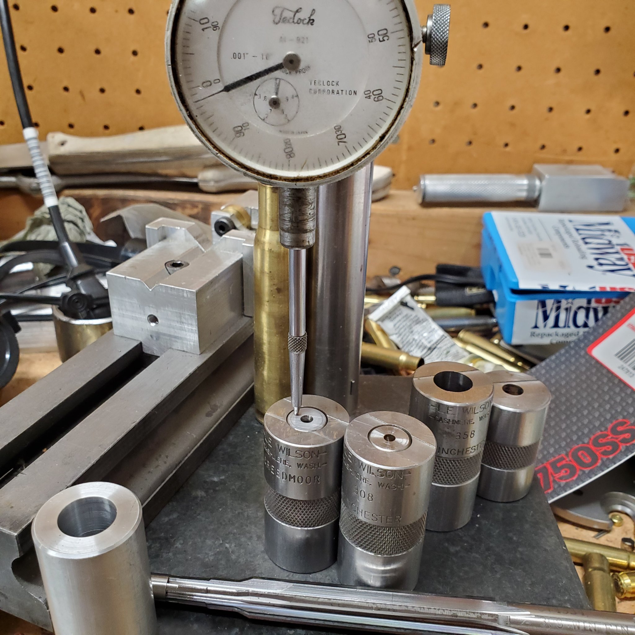

So a quick update... i received my comparator and took some measurements. I was really surprised at the results.
Lapua Cases for .223
new=1.413
fired=1.419
resized=1.408
IMI Cases for .223
fired=1.415
Bottom line is that with my resizing die configured to contact the case holder, headspace of the resized brass is shorter than fresh new brass. WOW! i would not have expected that.
I did an experiment and FL resize the LP brass to 1.419 and test fit in my chamber. There was slight resistance when closing the bolt and after removing my brass, i rechecked headspace and it read 1.417. I did not expect that so i repeated the experiment again and had the same results. So now i realize what the actual headspace of my chamber is.
Going forward, i am setting my headspace to .001 less than my chamber... which is 1.416.
This was a great exercise.

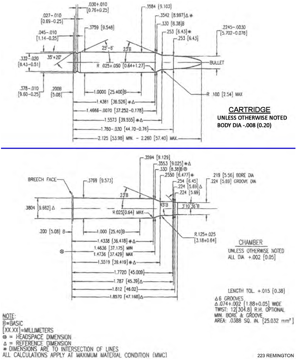

Gunny,
The SAAMI specs for 223 are not the best. They leave a 10 mil range for the chamber datum length, and the largest ammo may not fit the smallest chamber. For example, a 1.467 round will not clear a chamber at 1.464 without yielding, so brass and ammo tends to run shorter than the max to be on the safe side. As a result, it often has a long way to grow on factory chambers that may run as long as 1.474"
Just a suggestion.

That’s just stretched out brass that’s been loaded to many times. Has nothing to do with shoulder depth. Resize dies cannot push a shoulder far enough to create that kind of damage. Even if you could push the shoulder past oem specs with any die it wouldn’t chamber anyway.
Reactions: Doom
So you're saying a piece of lapua brass thats been loaded 5x has just been loaded too many times? No, sorry.
I have many sizing dies that will go well below a go gauge, and if adjusted improperly, will destroy case life. I also have a few batches of Lapua brass that have north of 30 firings on them, and going strong because they’ve only ever been bumped .001-.002.

Can you think of any reasons why a dude hand loading for one rifle with one lot of brass in one sizer might be different from your commercial loading?
Absolutely. Experience. For the last 25 years the only reason we have seen this exact separation happened is from thin over shot brass. He can claim it’s only fired “5 times” and that’s fine. Might have been 5 times. Im not here to argue that. I’m not here to say you can shoot brass 3 times or 30 times. I’m just simply saying it’s from being shot to much. If you think all pieces of brass are the same then you probably shouldn’t be loading. Some fail at 3,(is it Likely at 3? No but does happen) some fail at 50. People stick together on these threads and put out bad info simply because they don’t really know. There isn’t a reputable company that makes a resize die that will ever be able to “shorten the shoulder” to create that exact case separation. Just email them, hornady, Dillion, Lee, Lyman etc etc etc. they will tell you. You can get mad, they can get mad. Just stating experience. The guy posting a meme above proves that not everyone on here knows what they are doing. I would never give advise. Only facts from experience.
You were correct on the thin part but not due to being “overshot” due to overworking the brass.
We hash out this exact issue on this site regularly, the remedy is always the same, less bump. The Op was bumping shoulders back .011”. His results were entirely predictable, no case will stand up to that for long.
Obviously the brass manufacturers will specify some small number of firings, their lawyers tell them to say that because inevitably someone like the OP comes along and does it wrong and has issues. The potential hazards are obvious. Meanwhile, the precision/match community is out here routinely getting dozens of firings on their cases with annealing and minimal sizing. In fact they probably get tossed for primer pockets before separations. I cant remember the last time I separated a case, I think it was some time in the mid 90’s, when I didn't understand sizing or chamber relationships. Your production ammo shouldn't be compared with rifle specific hand loaded match ammo.
