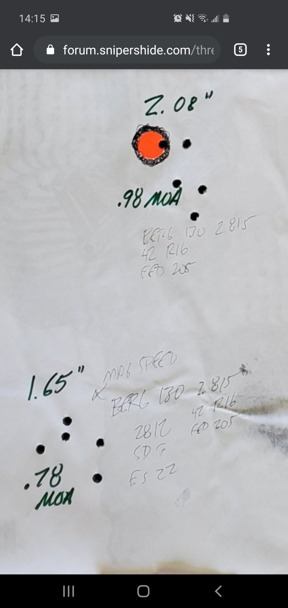

Ok. Did standard Federal 205 primers in 1x Lapua 6.5 Creedmoor brass, 42 grains Reloder 16, neck sized only.
203 yards....
Top group is no magnetospeed mounted, bottom group is with magnetospeed mounted.
Factory Berger 130 ammo did 2810, SD 13, ES 39, and a 10 shot .75 MOA group.
Looks like I've duplicated factory performance. Load development is done on that bullet :)
