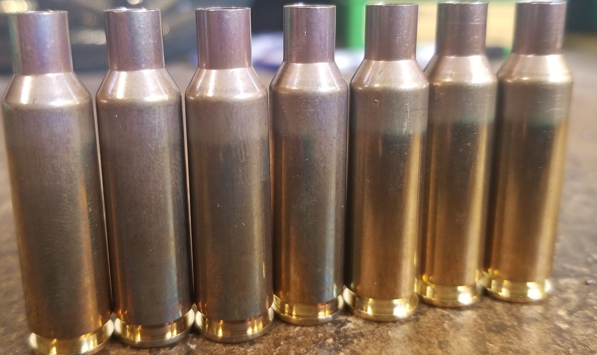

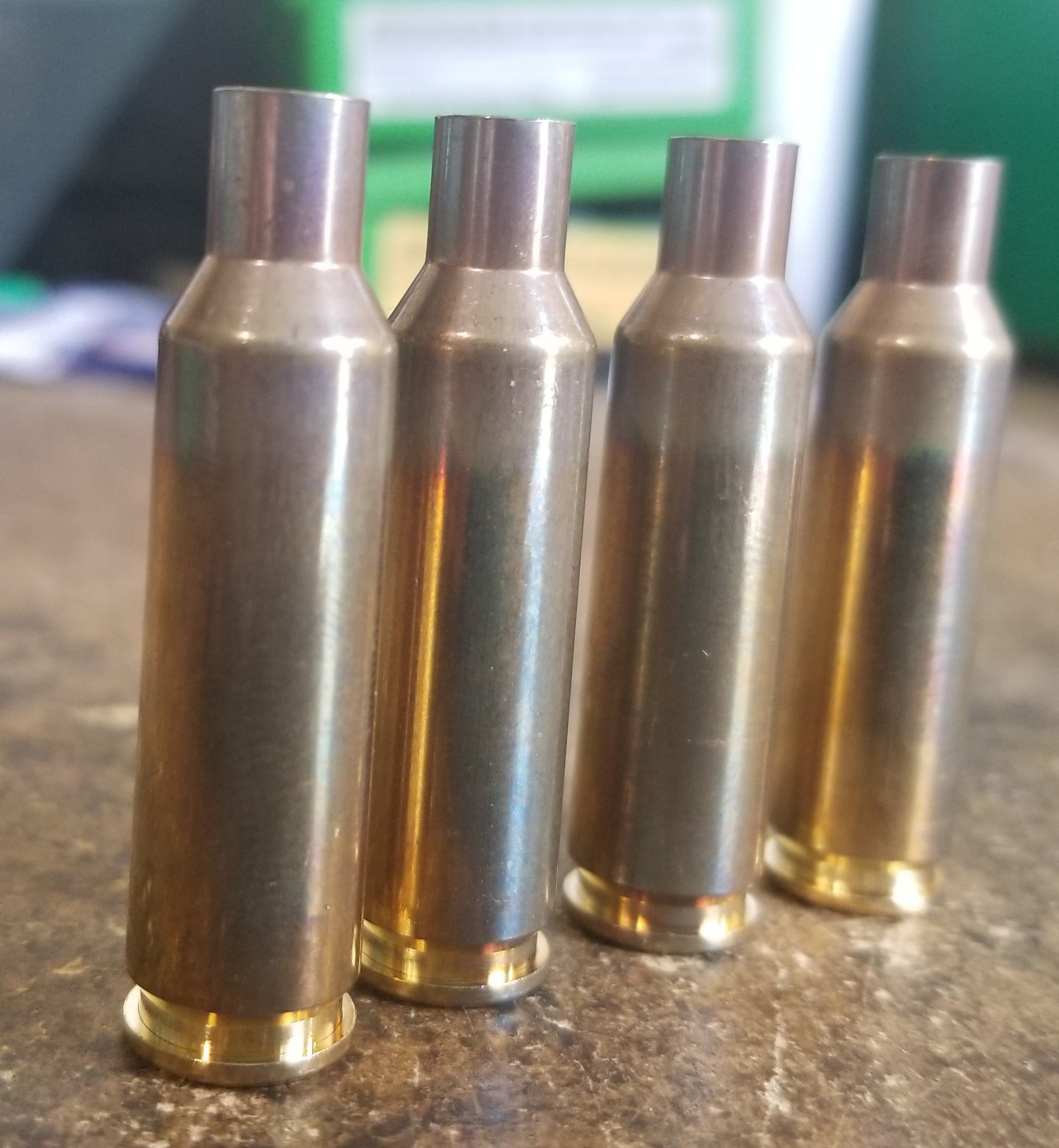

Anyone seen this before with Lapua? Four of the cases from this lot came out of the box with blue annealing stain down one "side" of the case. Hard to see in the pic, but they are discolored blue. My gut feeling is they're safe but I'm curious if anyone here has ran across this and what the outcome was.
Next to three normal cases for comparison.

I’ve seen this discoloration before. I shot them with with no issue. You might want to sacrifice one and take a pair of pliers, crush the neck which should be easy, and just above the extraction groove which should be more difficult.
They're loaded and ready to go at this point. If they blow up, they're taking a Tempest with them.

As much as everyone seems to love Lapua brass I have found their annealing lacking at best. My last batch of Lapua brass I ended up reannealing and sizing all of it because of how inconsistent neck tension was. Frankly OP, I'd tumble off the annealing line and reanneal it before doing anything. That's just me though, I'm sure some will disagree.
I haven’t seen a piece of new brass yet the doesn’t need some work on the neck.
Always way too much tension and once you run a mandrel through it it’s neck tension becomes a lot more consistent.

No, it was inconsistent annealing or hardness of the necks. The cases were properly chamfered, mandrel neck sized, and lubed with graphite and seating pressure was still inconsistent. That wasn't the first time either with this issue either. At any rate, I'm an advocate of treating new brass as if none of it is clean, annealed, chamfered, or trimmed. Don't assume that just because you bought high end brass it is prepared correctly. In other words, OP's pictures don't matter, tumble off the marks and get to work.

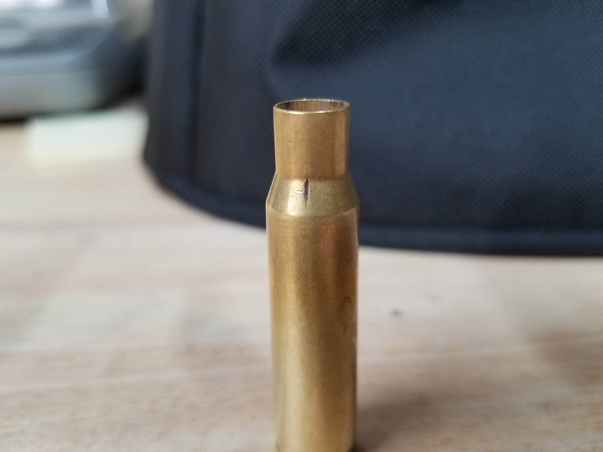

From said Lapua lot with questionable annealing.
Exactly. Man that shit pisses me off. It's not the $1.05. Its staring at a new box of brass with 90~some thing pieces in it. They should be better than this. I have about 500-600 sticks if Peterson and a hundred ADG and the QC of each piece is certainly better.
