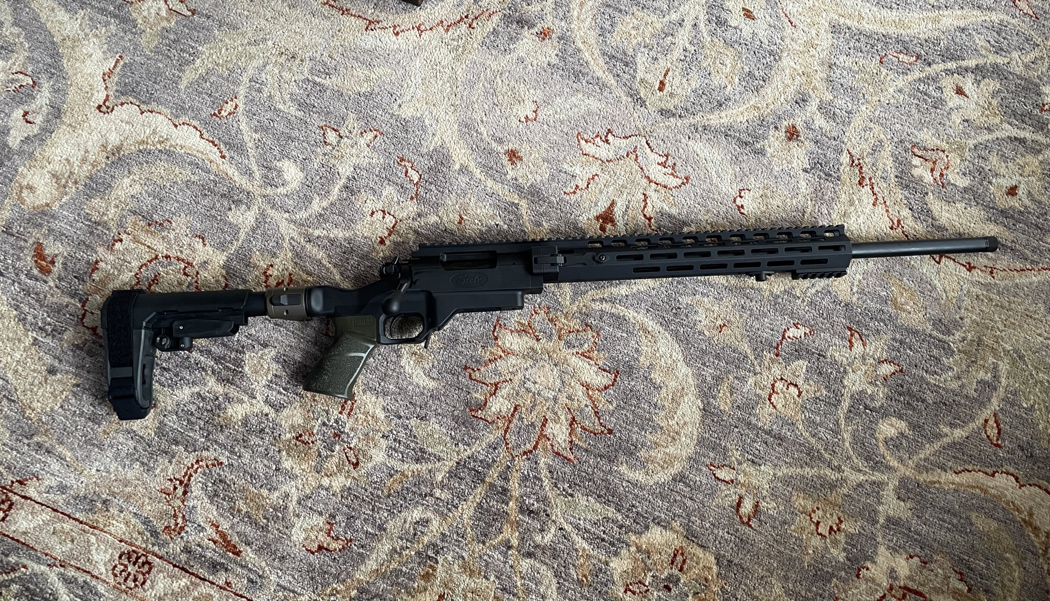

I picked up my Siete today and will offer my thoughts below. For background, my other centerfire bolt guns include AI's (AXSA and an AX50ELR), A couple of Sako TRGs, a DT SRS-A1 and a Tikka T3.
What I like:
1) It looks good. Better in person.
2) The barrels are NOT proprietary. As you can tell, I'm a big fan of switch barrel bolt guns, and I like to have options.
3) The Cheek Riser is good! I was concerned about it. It looks a little weird, but it's solid. I'll be adding a Wiebad mini stock pad to it like I have to the AIs.
4) The tools and kit are great.
5) It ships in separate boxes and the stock ships separately from the rifle. Depending on what ultimately happens with FATF's most recent rule, this may or may not be important. I was sure to put a pistol brace on it initially so it was firstly a pistol and intended to be fired as such before it was ever a rifle.
6) The folding mechanism is well done and looks to be bombproof (see #4 below, though).
7) The build quality is overall good.
What I don't like:
1) The Trigger Guard. Yes, this surprised me, too. There's not enough vertical room between the bottom of the trigger and the trigger guard below it. My natural finger placement causes me to drag along the trigger guard. As we know, any unnecessary input onto the rifle is bad input.
2) The "tinniness" of the trigger when it breaks. This is hard to describe - and probably doesn't ultimately matter - but since there's not "insulation" in this rifle, the break of the trigger (dry firing) makes the whole rifle make a noise - somewhere between a "cling" and a "clang".
3) Consider the source (I'm a trigger snob and dislike single stage triggers). I'll definitely be changing out this trigger.
4) The folder folds the "wrong" way. I'm guessing he couldn't do the "shortcut" (but good) stock solution and make it fold into the bolt, which is why it folds that way. But my AIs and the MRAD before them folded "to the right". Maybe I'll name this rifle Turtle McConnell since it folds to the Left (lol, I kill me).
5) The bolt's smoothness is underwhelming. It's on par with my Tikka.
What surprised me a little:
1) The Barrel profiles are light!!! I didn't put a mic on them yet, but I'd guess they're 1/3 again smaller (so 2/3 as much as) my AI barrels. More in line with an AR barrel than a bolt gun barrel.
I hope to get out this week with some hand loads and report back as to accuracy and velocity. FWIW, I chose the (20" - no other option) .308 barrel as my secondary.
ETA: I'm going to get feelers from some barrel smiths about having an 8.6BLK barrel made.

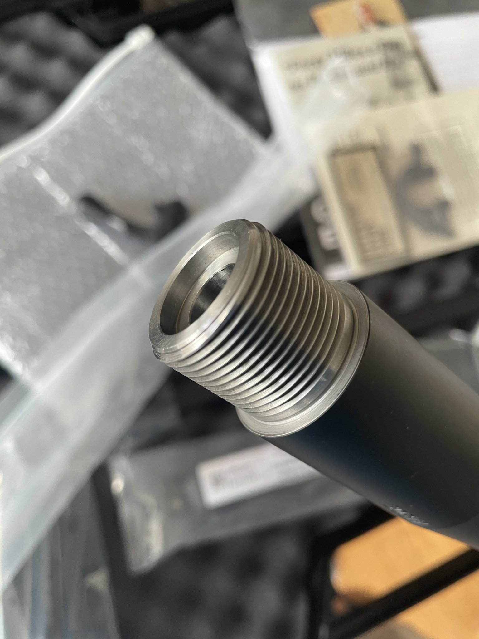

I doubt anyone was thinking that a threaded barrel was proprietary, but does it take known prefits? That’s what ppl would be concerned with. Why get a LaRue barrel when there are many others that are far better.
There are a whole lot of (IMHO, very confused) people who think that a Larue Rifle should have a Larue Barrel, and don't trust any other barrel manufacturer. Same goes for the PredatOBR.
The only other threaded barrel I had to compare the LaRue barrels to was the AI barrel (Desert Tech and MRAD having proprietary extensions, of course). I'm not a Model 70 barrel expert (actually, a novice), but here's what the extension looks like up close.

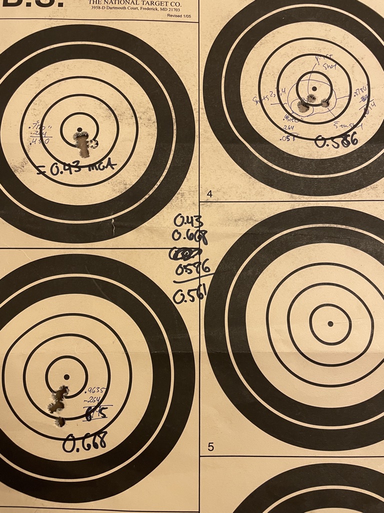

As far as a shooting update: It does a good job! I shot a fairly hurried 3x5 shot series of groups. Rifle was configured as shown in the video (Calvin elite, Elite Iron Bipod) and with an ATACR 5-25. TBAC Ultra 9 6.5 Silencer. I was getting a CRAP ton of mirage off the can . . . was super strange for the temps, but it was a significant distraction. Because I was a little pressed for time, I shot through the mirage. I ended up with the below (again 5-shot groups) averaging .561.
In terms of more BS excuses, I also switched batches of bullets (140 Berger Hybrids) in the middle of the second group (the lower left one), which *may* account for the vertical dispersion. In the third group, shots 2, 3, and 4, all went through that same hole, which would have been a 0.051" group. That's not a typo. I'm looking forward to getting it out again to see if I can do any better.
Oh, and my break in procedure was as follows: shot it to fire-form brass. Didn't clean it. Reloaded the brass. Shot it again. In other words, there was no break in procedure, because barrel break ins are nothing more than unnecessarily wearing out your barrel.
So, my conclusion - and I'm sure Mark would hate this, but I think this is a really solid first effort. With a couple of changes and refinements - trigger, grip, fixing the stock so it folds the other direction and over the bolt. It shoots well enough, and the form factor is really what I paid for anyway.
It wouldn't take much to make this a hell of a rifle. As it sits now, it has some problems. I'd be hard pressed to recommend it over a Tikka Tac-A1 (unless someone wanted the switch-barrel capability), but if they fixed the trigger, stock and grip, I'd recommend it 10/10 times over the Tikka independent of the barrel-switching capability.
