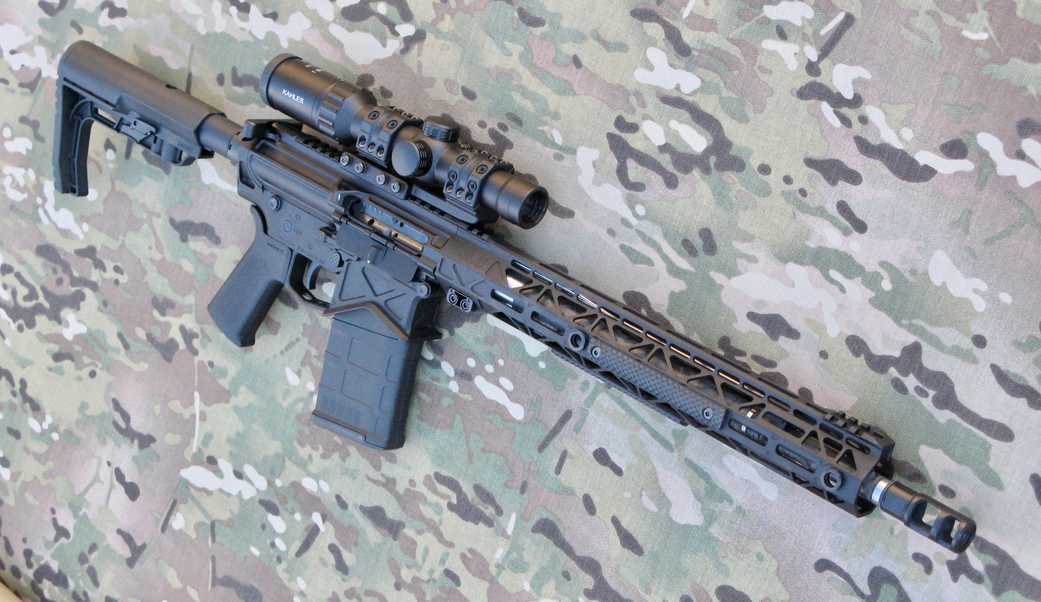

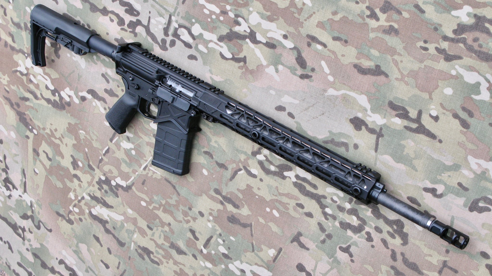

View attachment 7243639View attachment 7243640View attachment 7243641
Those are great looking builds! What's the build sheet on the middle rifle?
To answer your question:
A 7 pound even dry weight .308 built around a Proof Research 16" CFW barrel with intermediate length gas system, JP LMOS bolt carrier with high pressure bolt, SLR adjustable gas block, and V Seven titanium Furion brake. All housed inside the new Battle Arms Development billet 7.62 receiver set with matching 15" forend. LaRue MBT trigger, Vltor lower receiver extension, Heavy Buffers recoil spring, and normal H2 buffer round out the innards. All small parts in titanium from V Seven. MFT stock works amazingly well and weighs next to nothing. Great glass in the form of the Kahles K16i, riding in the bulletproof Spuhr SP-3026 mount. Recoil is amazingly light, plus accuracy is quite acceptable, especially considering the rifle's 7 pound weight.
