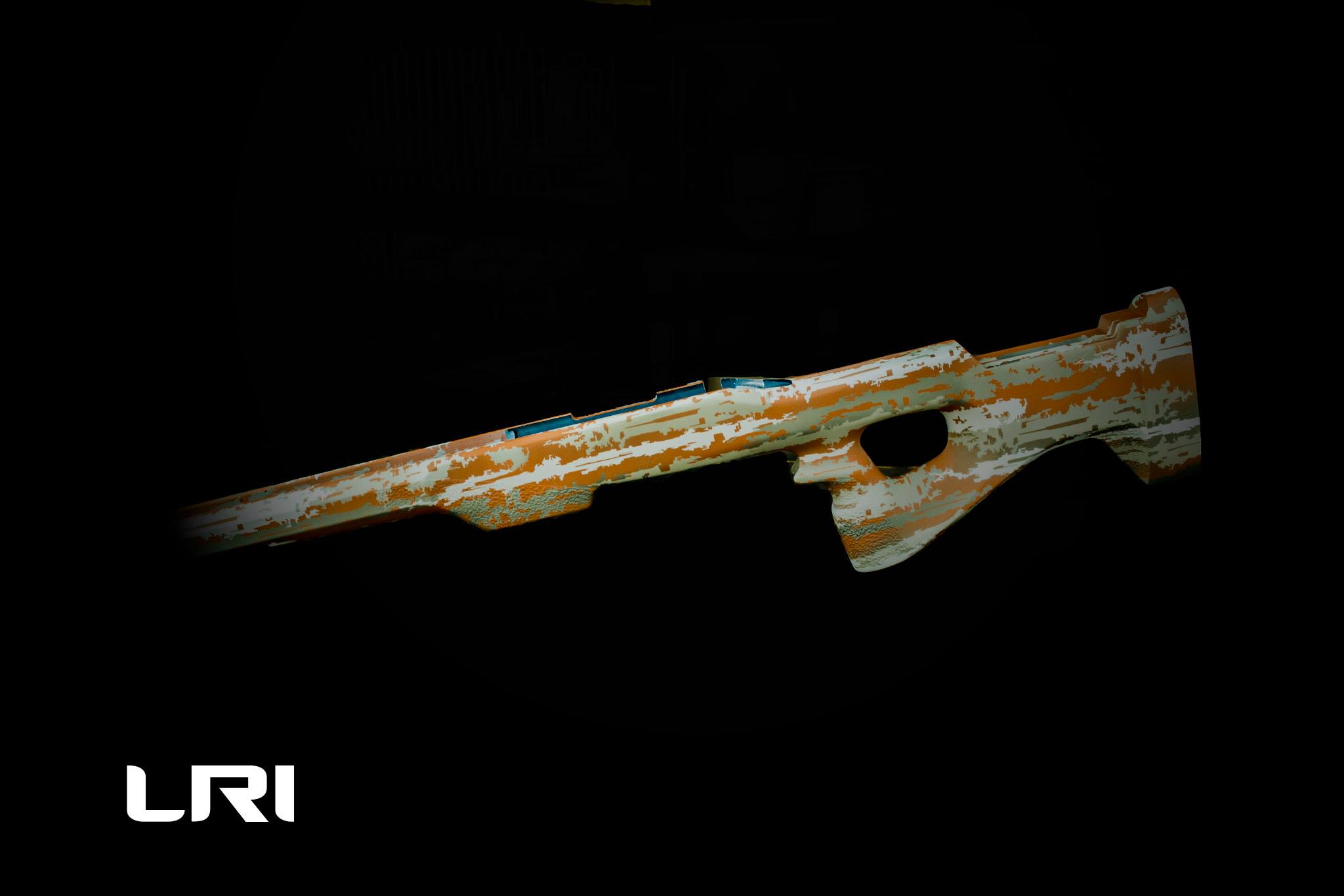

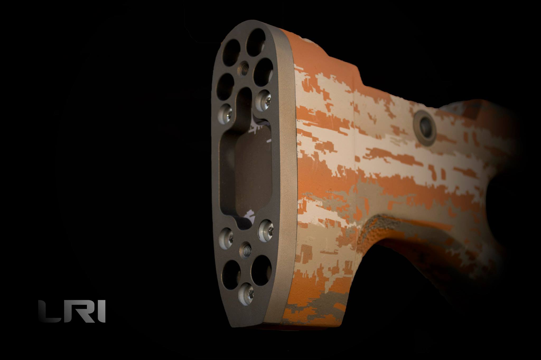

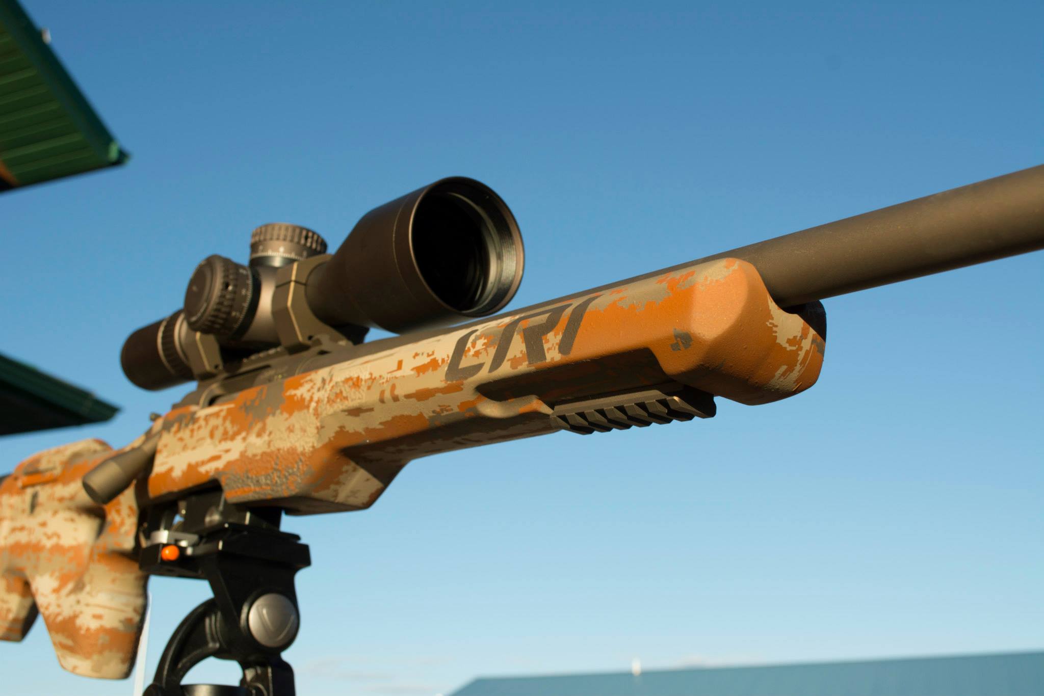

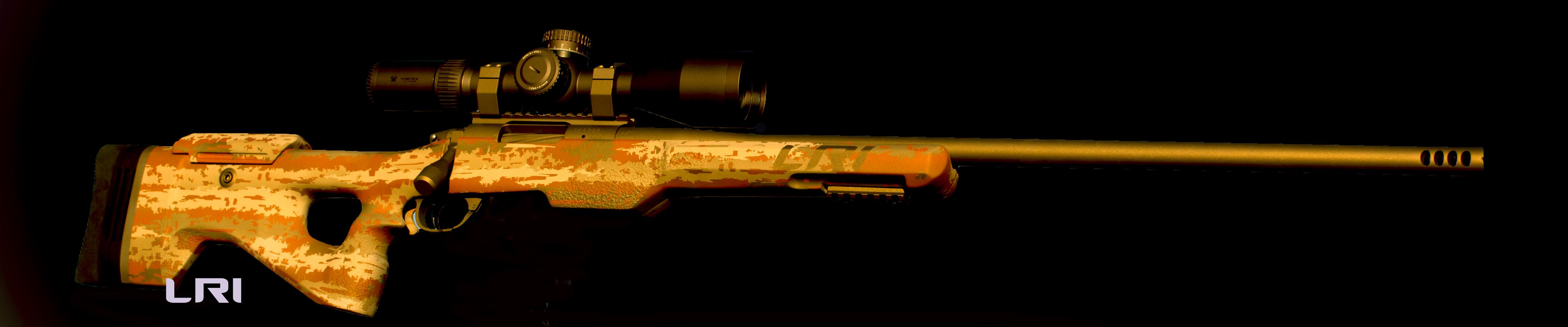

    Out the door this afternoon is a 6.5mm SAUM based on the stellar Bighorn piece from AJ Goddard and Mark Chanlynn.
    Fitted up here with a Sentinel stock, our brake, and an APA floor metal. Glass is by Vortex.
    Took a little different tract on the paint. Customer's wife really likes orange. So we handled it. Custom blend of Cerakote to get the tones right. Reminds me of a "Gaghdad" sandstorm...
    Perty neat rifle. Trying to learn the Photoshop stuff a little better. These were taken in RAW format, edited slightly, and then changed over to high res JPEGS. Tried to link them this way to avoid lengthy downloads of the thread for those with "geological bandwidth." Last photo is unedited. Straight from the camera to show the true colors.
    Hell, that ain't bad at all, I'm an outside the box type anyway. I dig the release of the APA bottom metal, seems I always snag the damn release tab on the "conventional" DBM. Keep'em comin' Chad.

    Here are the rifle specs:
    Bighorn TL2 AW cut action, 308 & mag bf
    Bart 8.5tw med palma cut to 26" 6.5 SAUM .2962nk .081fb
    Bart 8tw med palma cut to 26" & threaded 5/8-24 6 Creed...Yea Baby it's a switch barrel
    Terry Cross KMW Sentinel stock
    Chad's 2.4 UL cheek hardware
    Adj LOP
    APA Bottom metal
    CG Tac trigger 12oz 1st stage, 12 oz 2nd
    Razor Gen II 4.5-27 EBR-2C mrad
    Seekins med rings
    For anyone wondering about the paint, my wife loves the University of Tennessee, so naturally she loves orange
