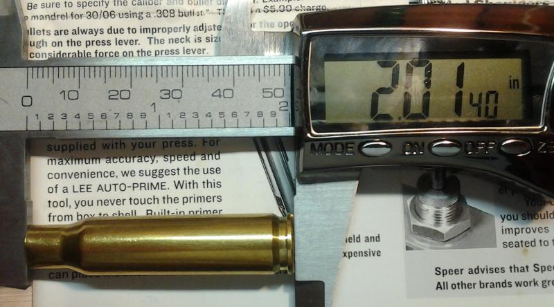

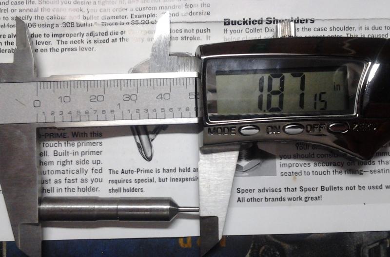

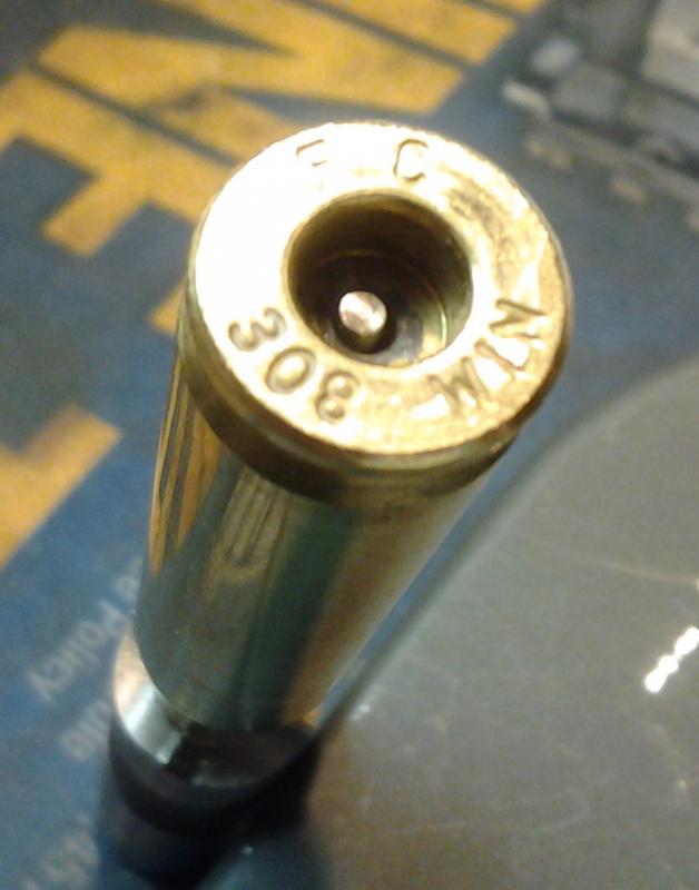

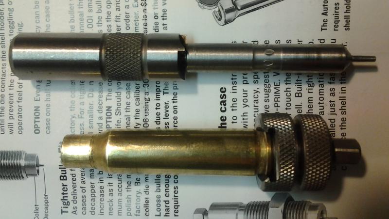

Not sure if I am using this tool right or if my gauge is short but my results have not been what I have expected. I am under the assumption the generally accepted case length for a 308 is around 2.0 (give or take). I took apart a factory FGM round and measured the case length and it came out to 2.014.
I then took a once fired Fed 308 case ran it through the Full Length Sizing die and it measured 2.017 after being resized. I put the resized case into the Lee shell holder and used my Lee Case Length sizing tool to trim the case to its proper length, and while doing so I felt like too much material was being taken off so I stopped and measure the case. The case measured 1.9935,too short? I then reviewed my Lee reloading book which said the Lee Case length tool is supposed to stop when it bottoms out (as it passes through the flash hole) on the case holder, leaving the case at the proper length. I noted that when I stopped trimming my case the end of the resizing tool was little better that flush with the flash hole and not touching the case holder. It appears to me my gauge is either broken or just short, I measured it at 1.8715. Do any of you use this tool? Could you measure the length of the gauge so I can compare mine?

Ok, just a little follow up; I measured my Lee 30 06 case trimmer. It is labeled as 30/06 and measures 2.485, and trims to that length. I doubled checked my Lee 308 trimmer and it is labeled 300s and measures 1.8715. SO it looks like I was sent the wrong tool in a 308 Winchester package. I wonder what 300s is?

Mine says 308, nothing else, measures to approximately 2.002" and cuts to that length. I would guess the 308 s is the 308 Savage, but I don't have one. My old Speer #9 reloading manual lists the nominal case length of the 300 Savage as 1.871", so you appear to have made a good guess for what you received.

I got another one on order, dont recall where I bought this one from. Guess I'll keep it in case someone needs a 300 Savage gauge. Thanks for the info.

Another little follow up: Got my case trimming ironed out, stayed with the Lee Case trimmer and all is working well. I am still trying to develop a load that will replicate my zero with FGM, but I have obtained some pretty good results so far. I am loading for the Ogive length at 2.33, 42gr of RL 15, 168 SMK. So far I am getting consistent 1/4 MOA at 200 yards. My groups are at .5 inches (four shots) and my max groups are a little lager around .6. I am still working my charge up- highest I have loaded so far is 42.7 gr. I am having to add 1/2 MOA to my vertical adjustment to get her on the center of the target- so I haven't found the right charge yet, but accuracy is there. I was loading 175 Burgers and tried them at 100 yards. They were basically hole in hole, but decided to save them for later.
