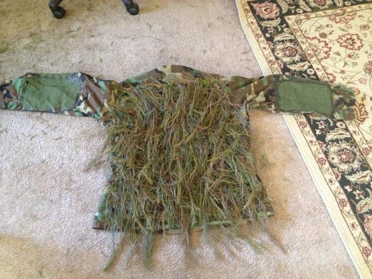

My humble attempt from a cross the pond (so far)...
Issued MTP smock with..
Front zip removed
Crawl pad added on the front. Used fabric padding instead of foam
Shooting non slip shoulder section
Mesh sections added to the rear for ventilation
Elastic loops on for veg on the upper arms, hood and back
I've added mossie mesh to the hood as a face vale so it's like an emergency/extra ghille hat
Thumb loops on the sleeves
I've added zips in the sides to help getting it on and off.
Not in this picture, it was added afterwards, a crotch flap that goes from the back of the smock, under ya groin and secures at the front. Stops the smock riding up when crawling backwards.
The smock already has zipped arm pits for hot days and lower fleece hand warmer pockets for those cold days.

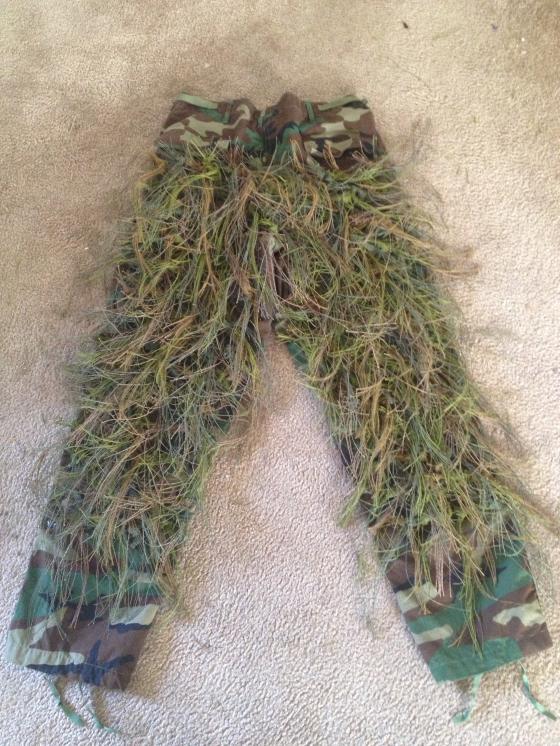

Trousers done too, same kinda style.
I've learnt a lot in this thread and going to...
Add netting to the rear of the smock and the back of the trouser legs
Add more elastic
Completely re make my hat with netting, elastic bands and cutting the crown out.
To scrim this up I have a very lightweight shroud that I've adapted so it attaches to the smock itself. Not sure if I prefer this or not but the shroud is small enough to crush up and be taken for use as and when.
I'll add pics shortly of the rest.

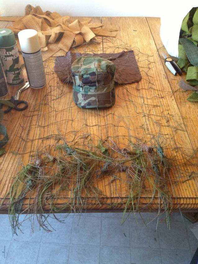

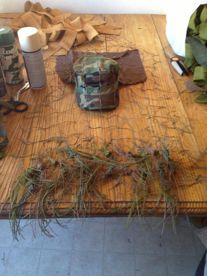

Let's see your ghillie and maybe a description of how you made it.
First image is a ground blind using commercial fishing net and synthetic dyed jute "store bought".
Second image is a hat/veil made of a boonie hat with the same netting glued to it, hand dyed garden jute twine, dyed strips of a burlap coffee sack and dyed denim.
