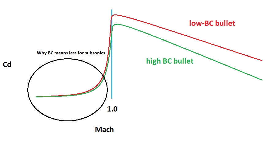

More or less, this is why BC doesn't play a huge part for subsonic use. It's also why BC changes over velocity, and why most G1/G7 calculators kinda suck when you try to use them for subs. The calculators are trying to use data from the right side of Mach 1.0.

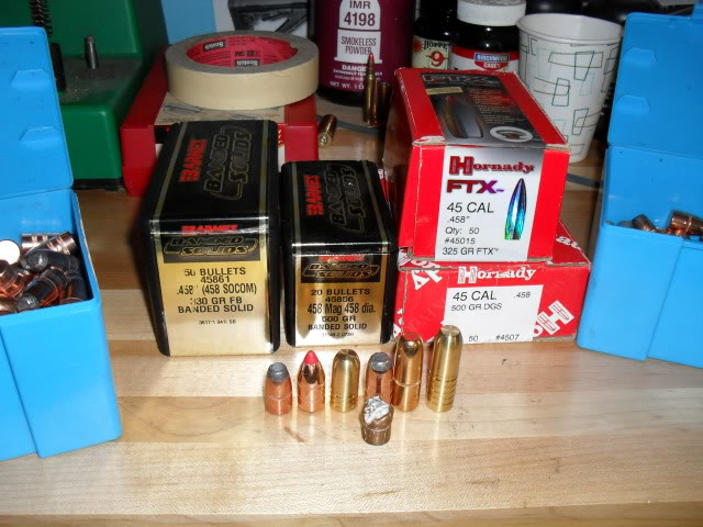

I run 500gr subs out of the .458 socom. Cycles in an AR-15, 40rd mags hold about 13 rounds single-stacked. After about 150 yards it drops out of the sky like nothing else.

Once you get into rifle bullets, stepping up in BC doesn't make a big difference...
