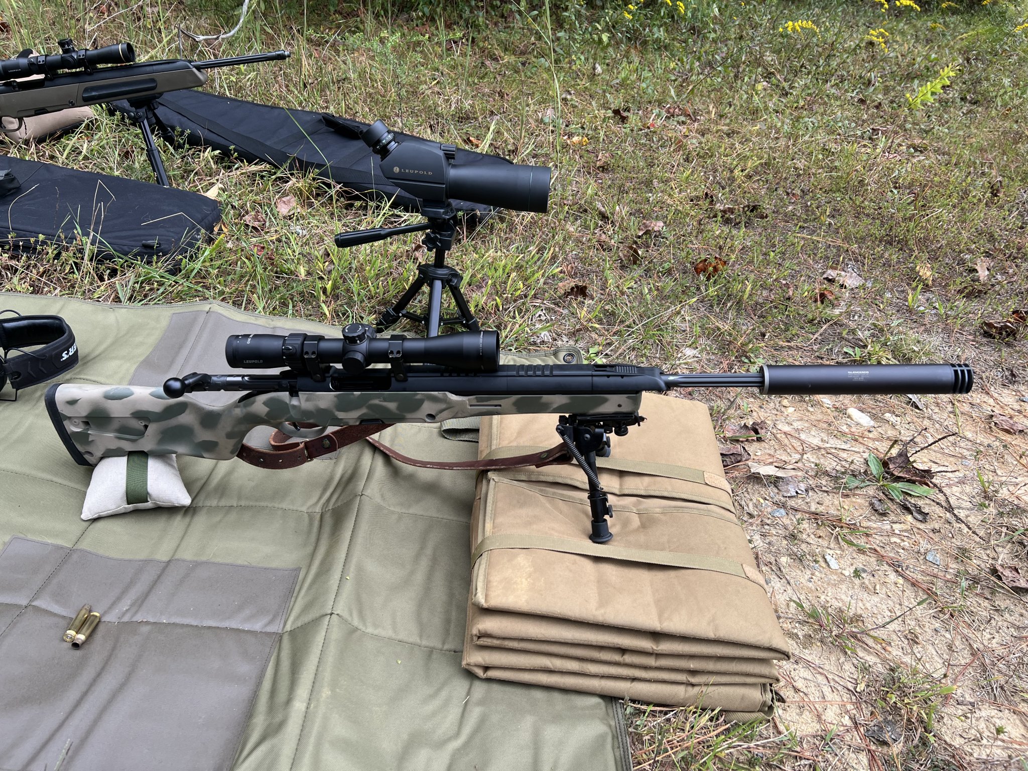

Here it is… 8 pounds, 13 ounces including sling, scope, bipod and suppressor.

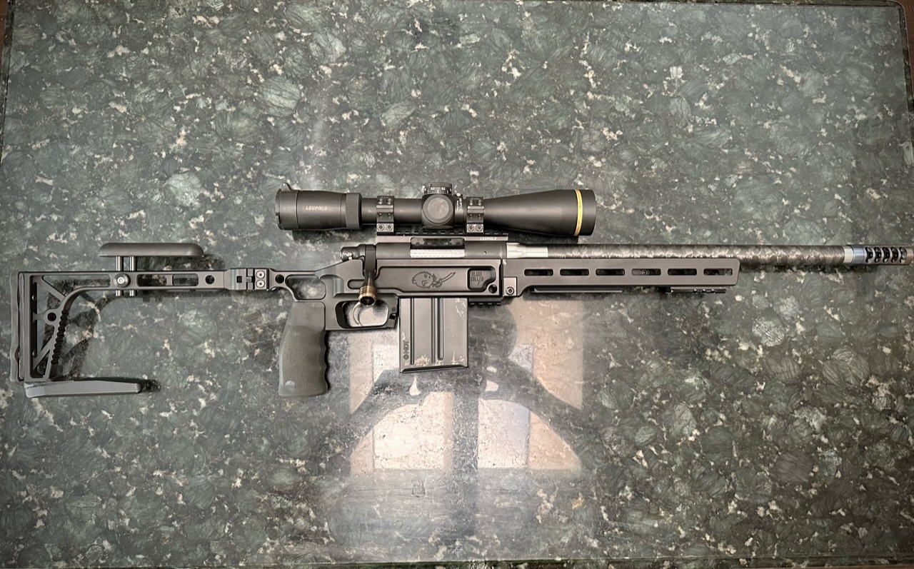

Yeah that’s why you should get the vx5hd. Like 19oz and has all the features you need for long range. Here it is on my 17 inch saum hunting rifle. Rifle weights under 8lbs and will kill anything out to 1400 yards

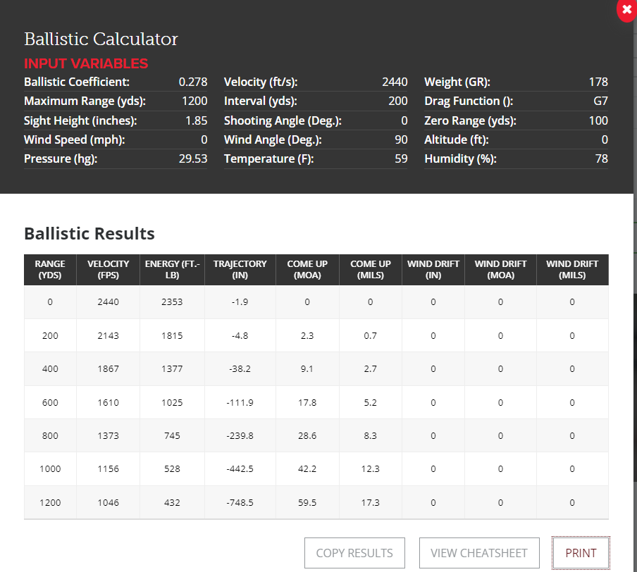

So have you looked at your ballistics to see how much Moa or mil come up you will need for the distance you want to shoot? 1000 yards might be able to be done depending what you are shooting. I think the dial max on that is what 6 mils. Takes me about 7 mils to get to 1000 with my short-barreled rifle. That means I could do it by using a holdover in the scope. Or if you zeroed at say 200 yards or something.

That's actually a great suggestion. 1000 yards would require 12.3 mils of elevation with the 100 yard zero (assuming the table is correct and I know they often are not). With a 200 yard zero, it is 11.6. Combine that and that could work out to 1000. Barely and not ideal, but it could work.
