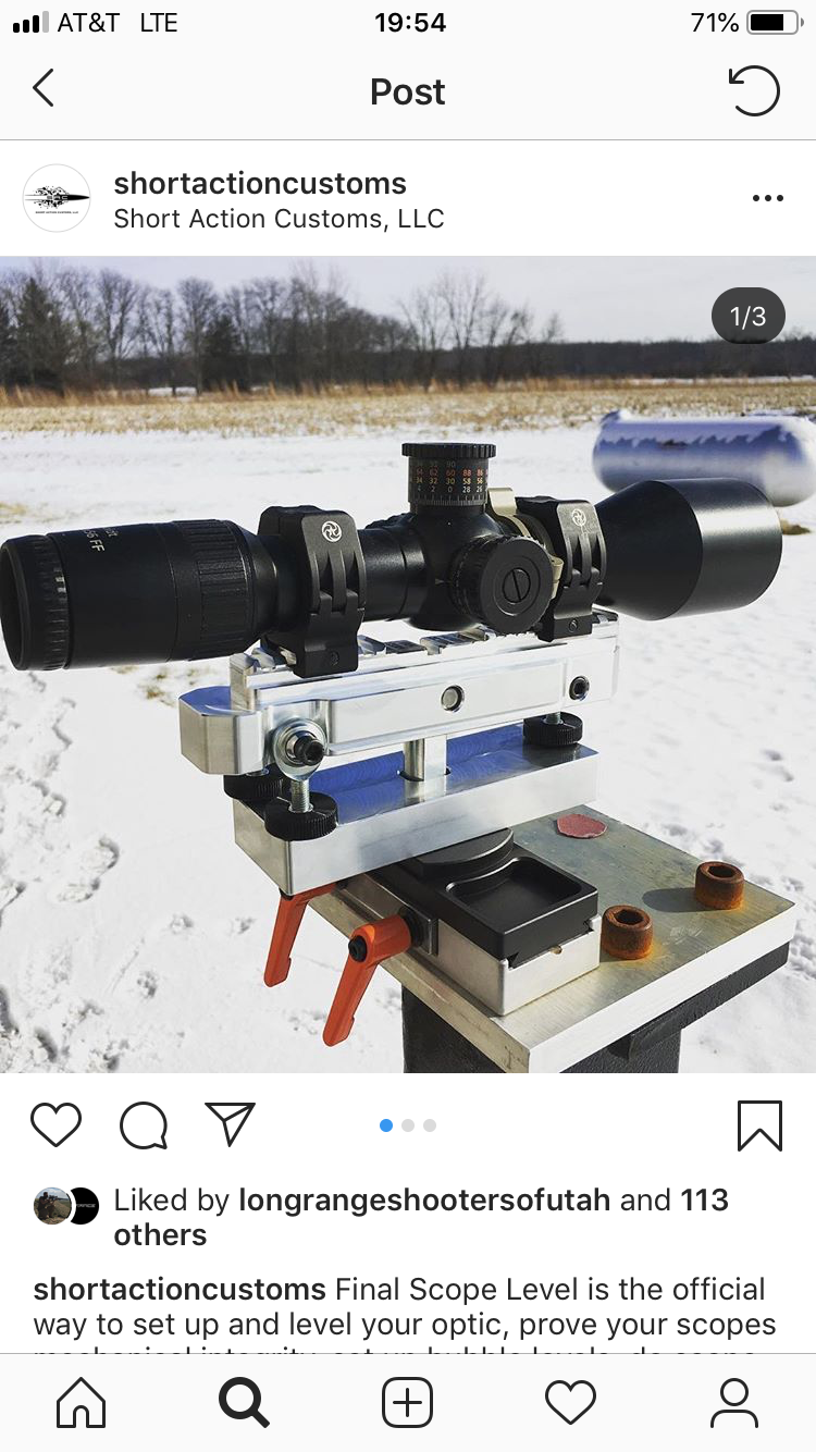

    Lots of threads lately on how to mount and make sure your scope is level.
    I’ll start off by saying this, who cares if your scope is level, it’s the reticle that matters. Obviously we don’t want a 45 degree offset between the turret and the reticle, but a degree or two is no biggie. This gets discussed on the hide a lot and to save everyone the trouble, please see this recent thread
    https://www.snipershide.com/shooting/threads/scope-reticle-level-confirmation.6925084/#post-7508011
    In addition, there are a few tools to aid in this process that are pricey but worth it. You will have a better more enjoyable shooting and learning experience if you invests in good tools as well as good equipment.
    Badger makes an awesome tool (I use it)
    http://www.badgerordnance.com/gunsmithing-tools/dead-level.html
    Targets USA makes a beast of a jig for mounting and turret tracking
    http://www.targetsusa.com/scope-tools.html

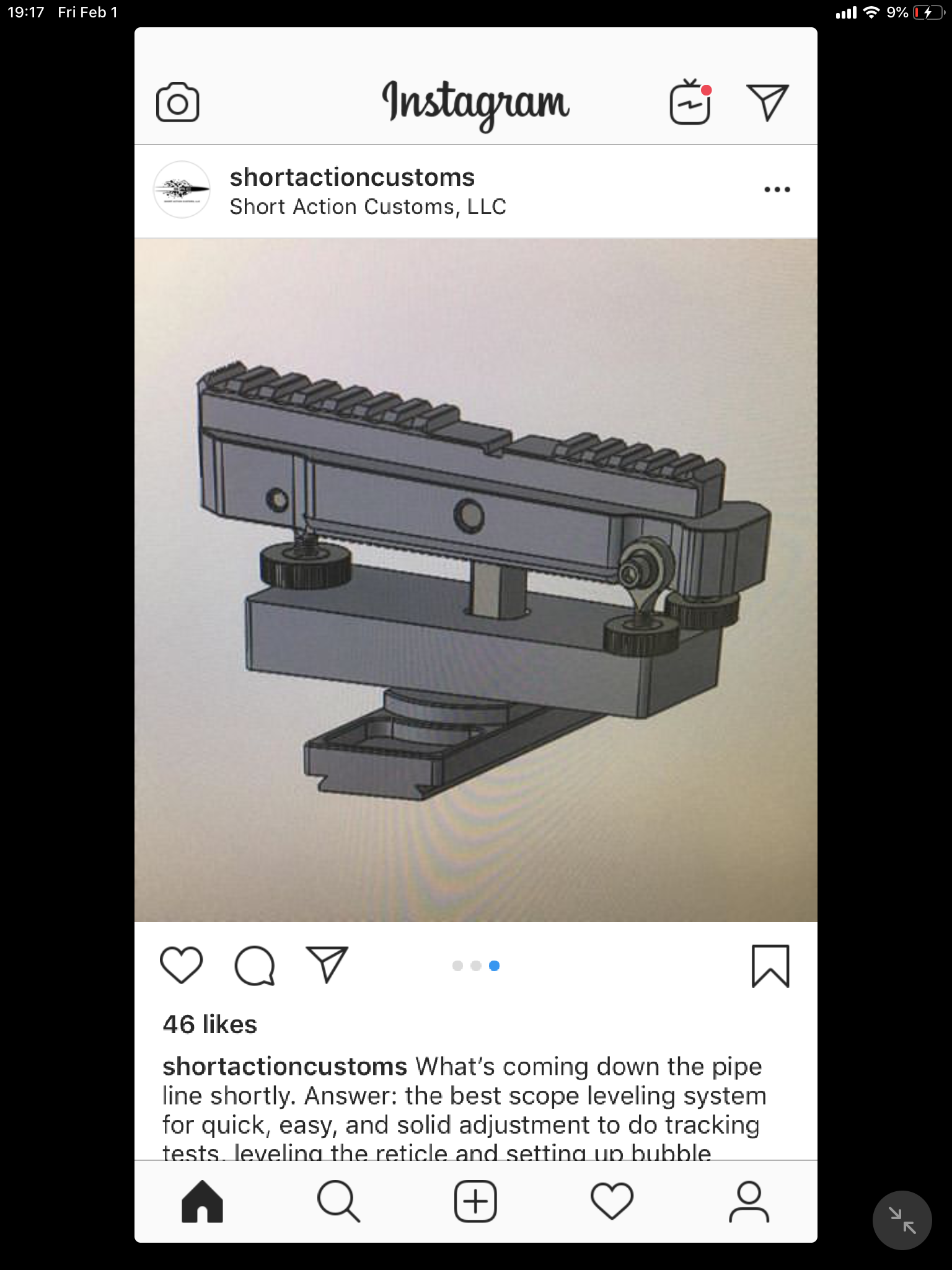

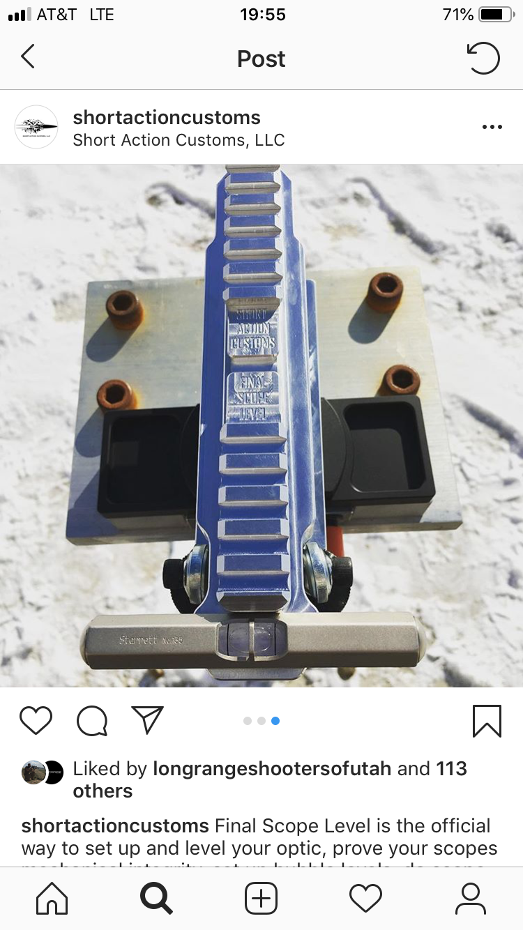

    And finally Short Action Customs just released this a few minutes ago. I have no other details other than this from instagram
    So before we start another thread on this, look around. The information you seek is already available.

    Hmmm. Looks like the SAC attaches via arca.
    Wonder if it will have enough weight to do a tracking test, or will you be having to weigh down the tripod or mount?
    If it’s anywhere close in price to the one Frank had (can’t think of the name, USA something) made, I think that product is a better buy. You really need the weight for tracking tests.
