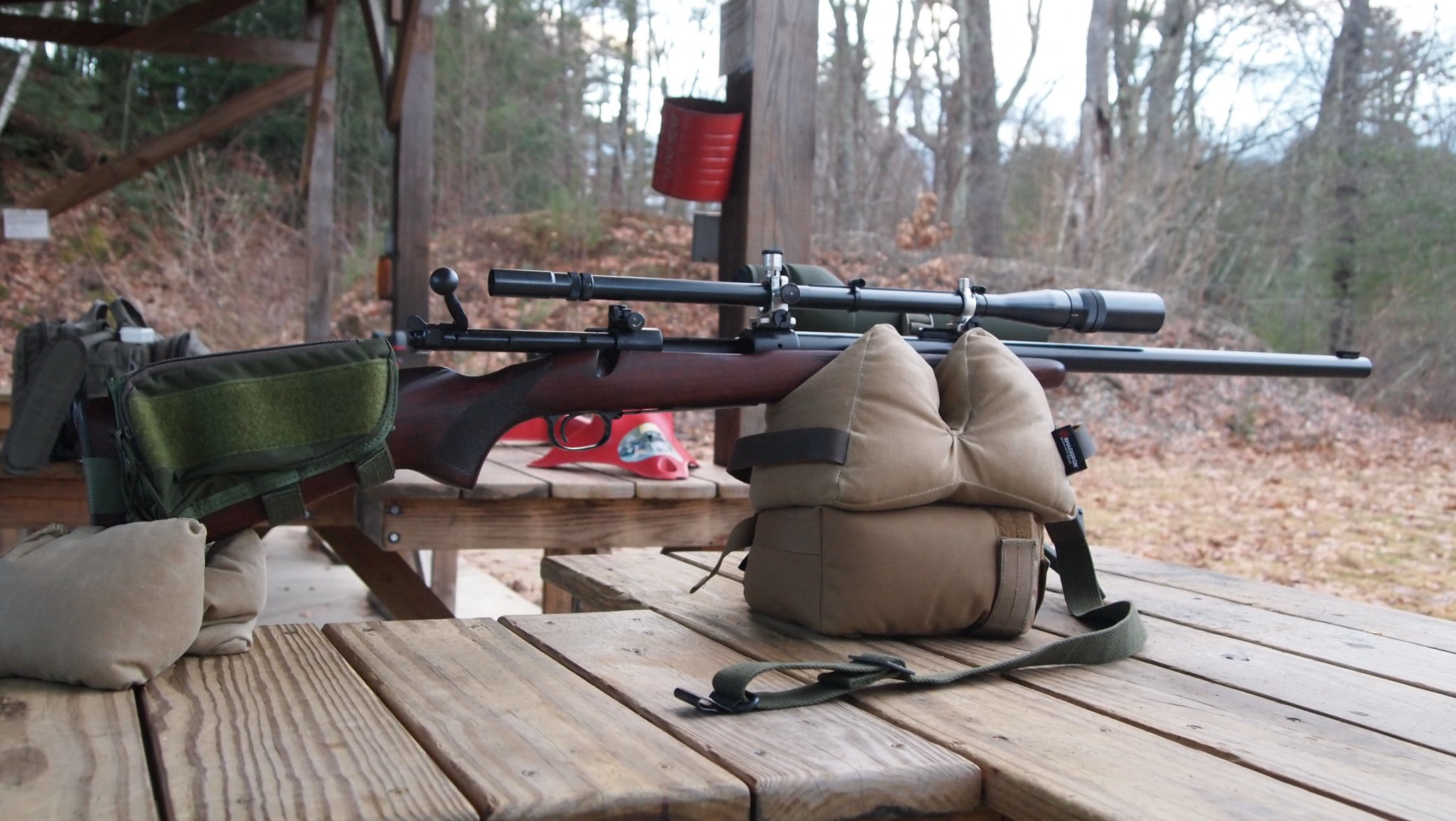

I solved the high rings issue on my Model 70 with a stock pack.

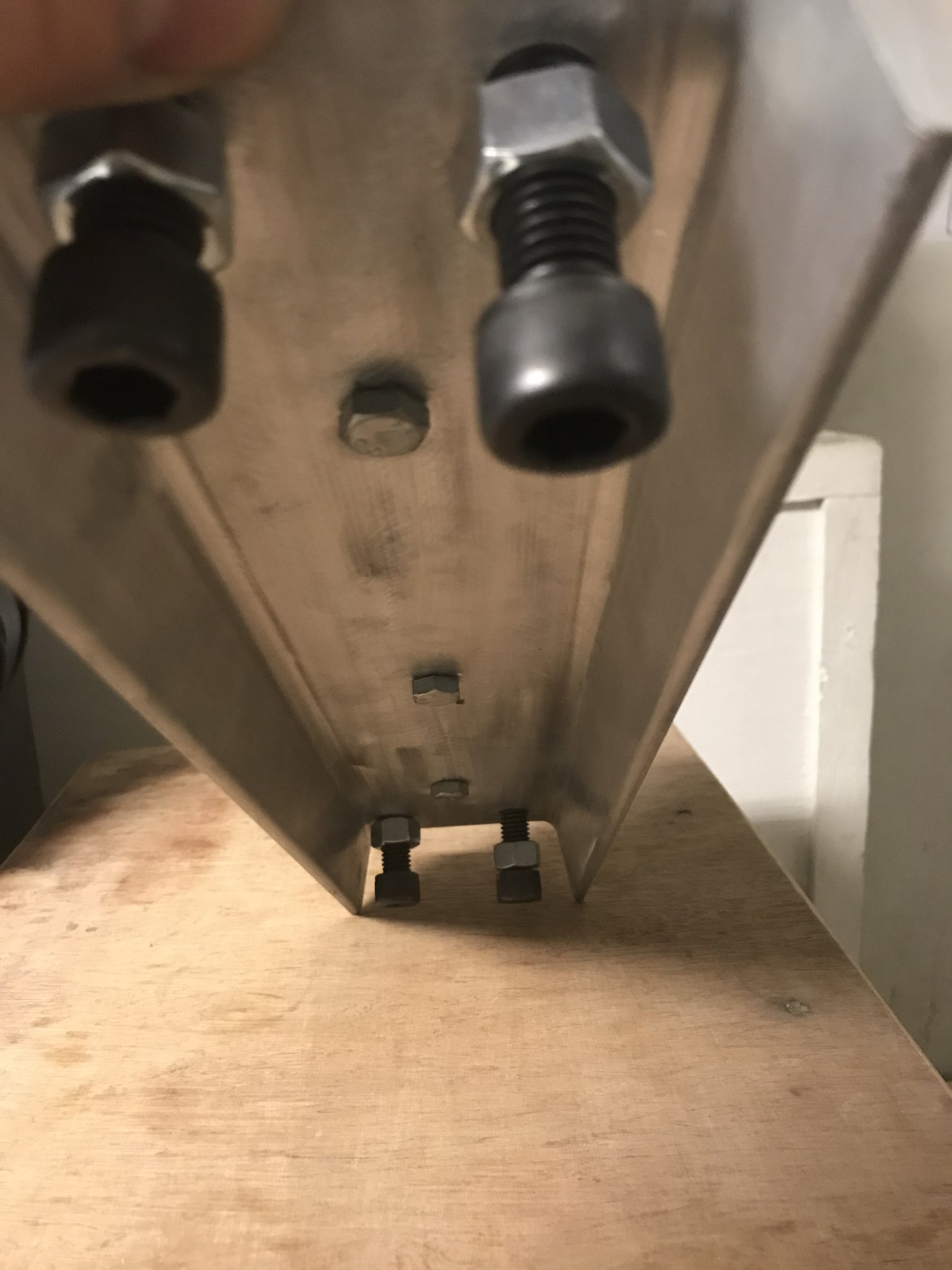

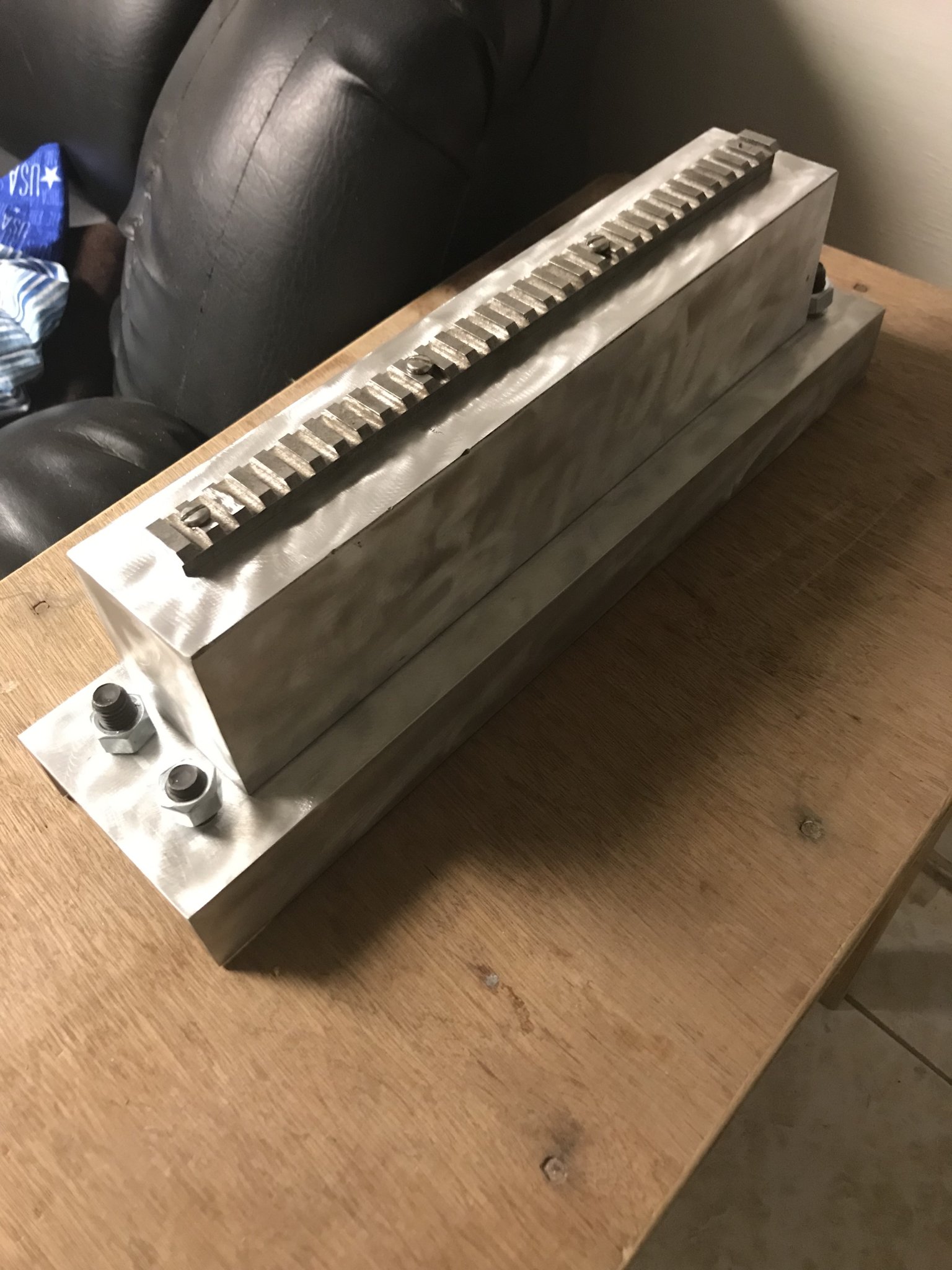

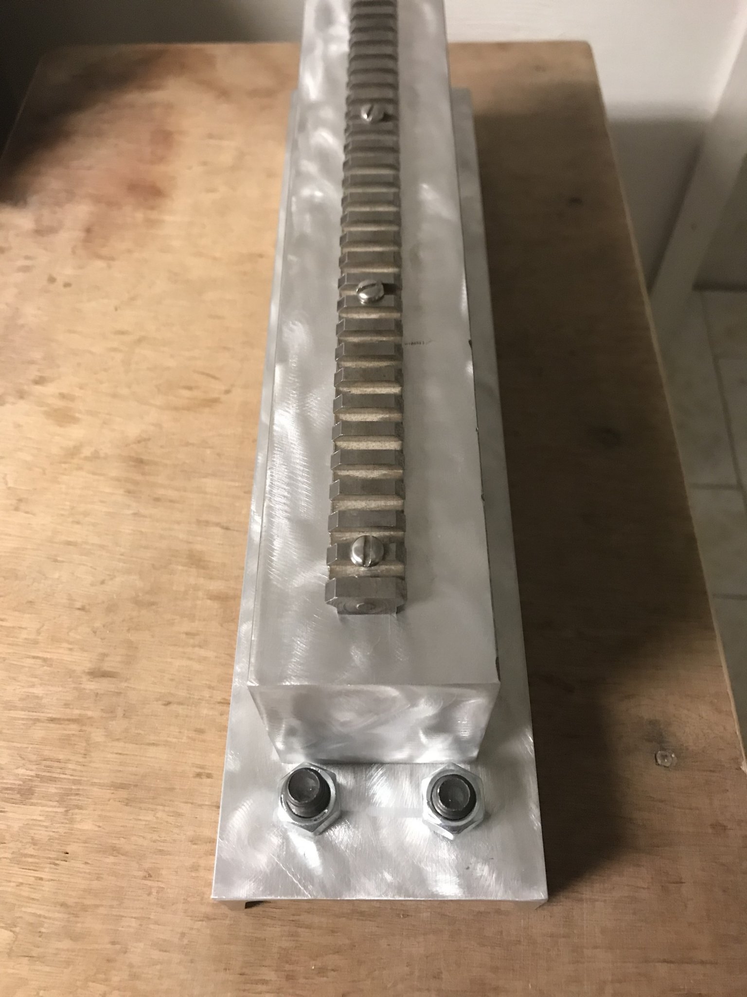

Built a leveling device today, it came out ok. I figure once I get back home I will go to Lowes and look for Better leveling legs and screws that will sit flush on the rail. My neighbor is a cerakoter so I may have him hook it up. Now I just have to figure out how to get it home, ( I am out of the country)
