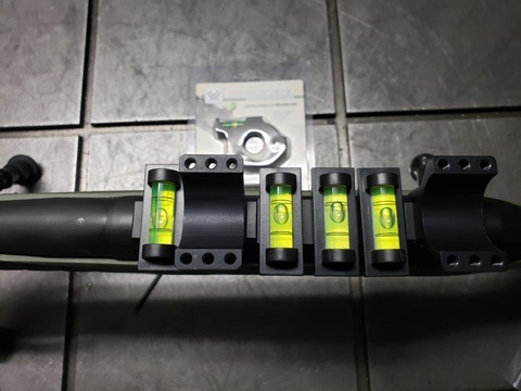

Ok, have read the various ways to level scopes posted here.
The fundamental flaw I see as a machinist, is you need to know the bubble level itself is actually level when mounted or the tool you use is actually level
So I have a granite surface plate, its level within .0005 in 10 inches using a Starrett master level
I bought 2 US Optics scope cant levels (which BTW really suck and wont use them), 1 is fixed, the other swings out.
One was close, the other way off. The scope on my rifle was done by a pretty good gunsmith I'm told. He told me to level by the top turret, and thats making an assumption that point is even level. (and reading here says it may not be)
Using top of turret, its not level either (now I havent done the plumb bob verification yet)
So heres my question, I can lay my machinist level across the top of the rail, and level to that, but then thats making an assumption its level to the rail wedges themselves.
Or do I care if they differ, as long as reticle with a plumb bob aligns? And scope mounted bubble level is zero'd as well
TIA
Level the scope using the plumb bob, and then match the bubble level to your reticle. Don't worry if the bubble doesn't match level to the rifle etc. You're hardly ever have your rifle perfectly level anyway.

Don't level to the top of the scope turret. Level to the bottom bottom of the turret housing. That's what manufacturers level the reticle to. Once done, confirm with a plumb bob. As long as you rifle level (send it, bubble level etc) is level to the reticle (and the reticle track true) you should be good to go.

I level the rail on the rifle with it in a vice....and yes, this assumes that the level used is reasonably accurate. I then put a Wheeler level on the barrel and adjust until it shows level...now I can move the rifle and still know rifle level.
Then I level the scope in the rings....if I have enough room below the erector housing to use Arisaka leveling kit...this:
Just because I'm a belt and suspenders kind of guy, I've leveled the scope via the erector housing bottom with a level on the top of the turret and found a number of levels that match.
As a machinist, you probably have feeler gauges or similar which can be used but I'm just a home hobbyist the Arisaka kit works for me.
Then confirm with flashlight and plumb bob in my home.
Then I forget about all that crap and don't worry about any very small errors that may still be present.
And as alluded to by a poster above, canting the rifle/scope combo introduces much more error down range than the reticle just being a few degrees off. Its posted somewhere here...oops, I found it. See attached.
Different people have different ways to skin this particular cat...this is mine.

That's what I use. I first level the rifle off the pic rail using a Starret 1-3/4 Inch Base Diameter, 1 Circle, Plastic Bull's Eye Circular Level.
Then I place the scope in the rings and use the feeler gauge to level the scope off the bottom of the turret housing & the top of the Pic rail.
I confirm level using the circular level on top of the elevation knob, and also use a plumb bob to check the reticle, just to make sure.

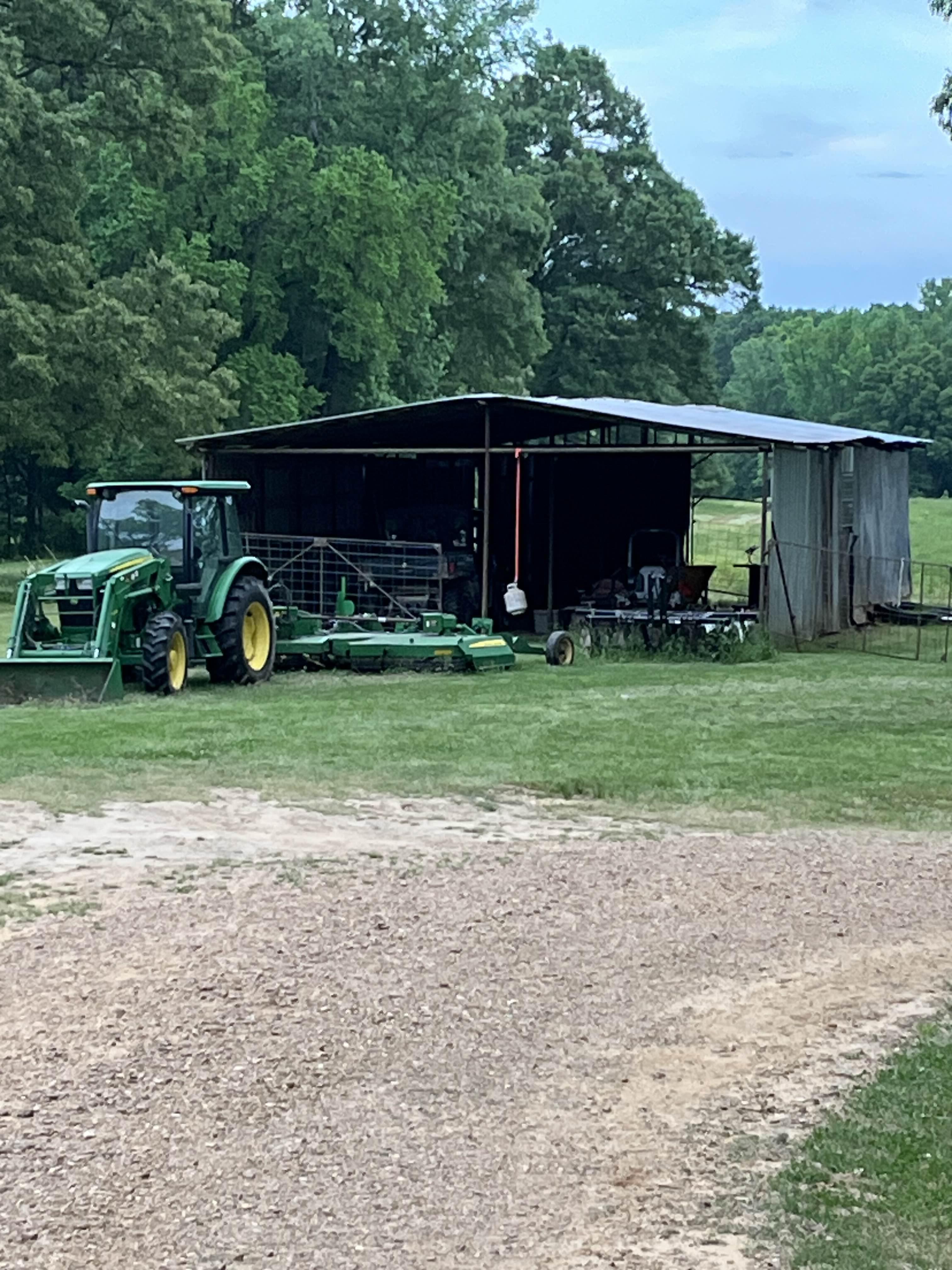

I prefer a laser level and like to do it indoors where wind can't move the plumb bob. The nice bright red line is really easy to line up with the reticle.
Wait, I was a builder for 25 years. Are you telling me I can only use a pumb bob outside?
I have a heavy large brass plumb bob on a red line. In a pinch, I’ve tied a rock to a length of green paracord at the range.
