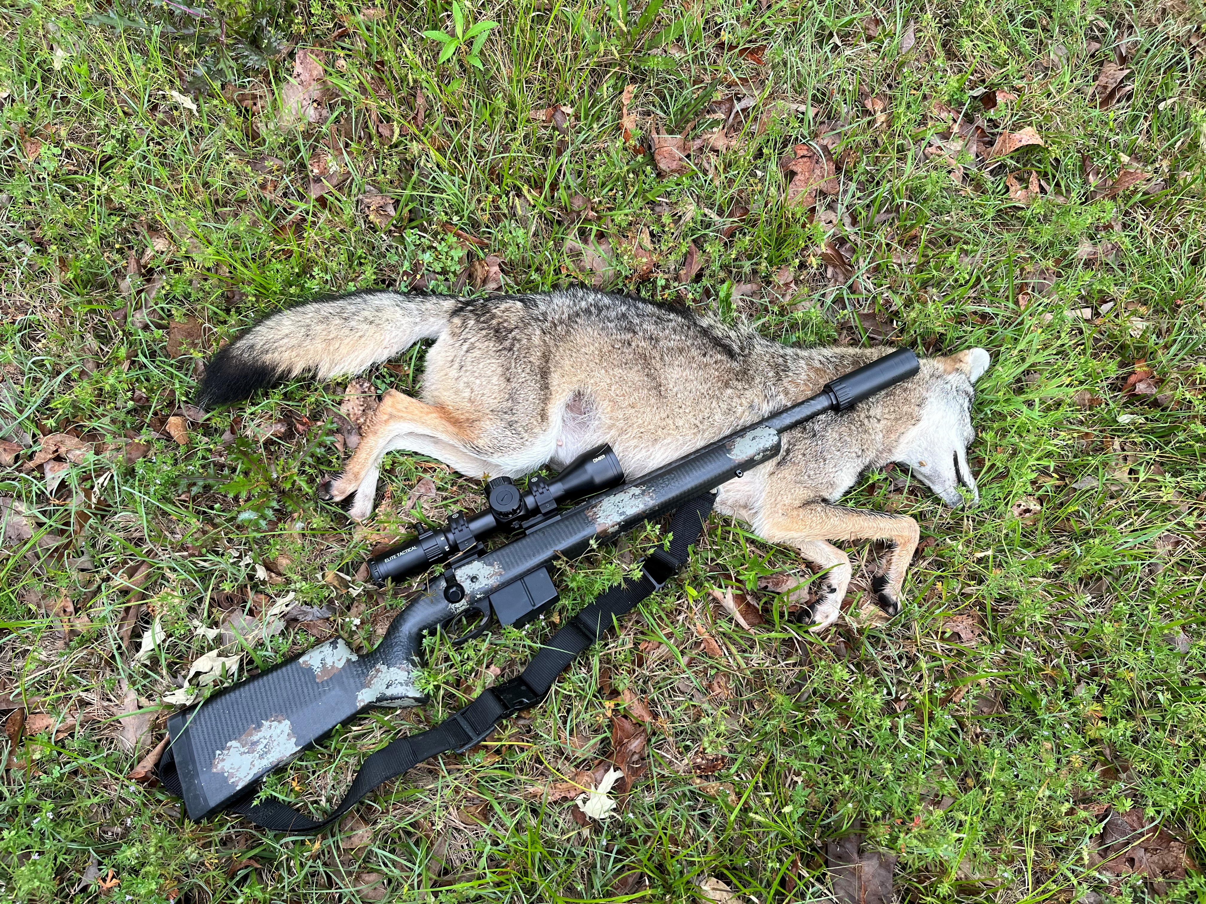

I built this exact setup for what you're wanting a couple years ago and absolutely loved it. I killed a pile of stuff around the farm with it, and it was a joy to handle and shoot. 16" proof chambered by Altus on an Impact NBK. I had it feeding from AW's fairly consistently but not good enough I'd run it in a match. Don't remember the chrono numbers off hand, but I do not remember being disappointed with factory 108's.
