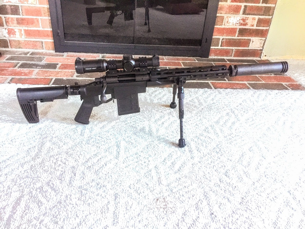

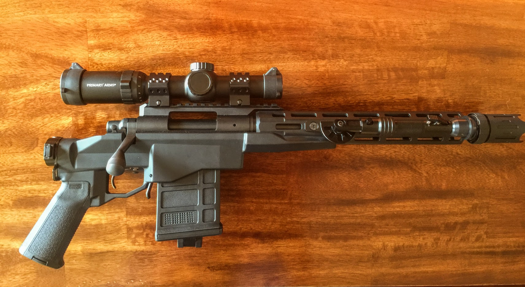

Around 6 lbs, folds and fits in a backpack. .308Win out to 200-300 meters can achieve MOA accuracy with the right ammo. Most of the shots taken in New England are less than 100 yards through dense woods. Works for me!

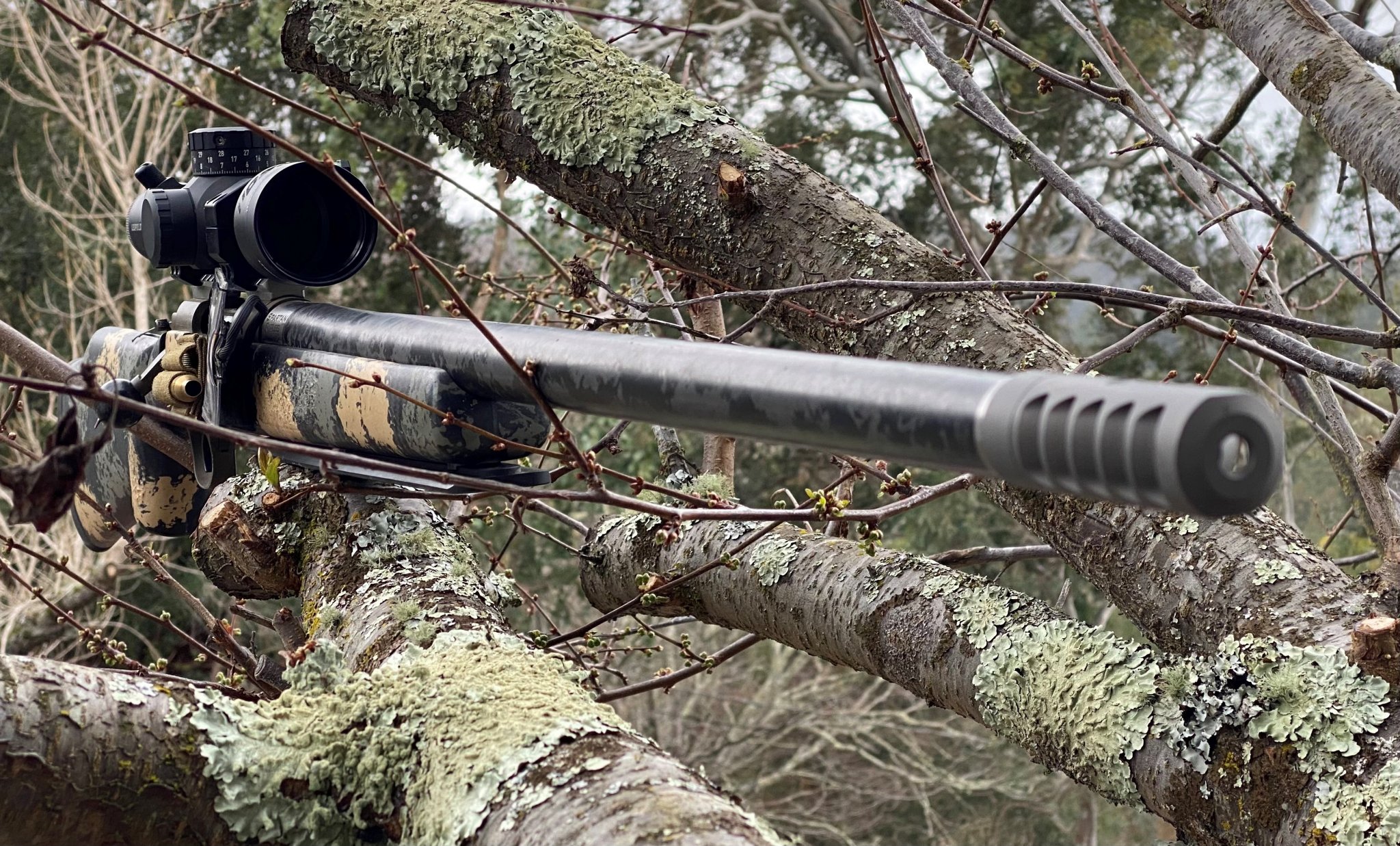

Here is one of my hunting guns it's a magnum for Elk, in general, magnum rifles with their longer action and longer barrels tend to have higher base weights, I'll share my compromises: I added weight in these areas, I am running a big Ti brake at 1.3oz, 26oz FFP with illuminated reticle, Ti action rails vs hard mount, a longer carbon barrel (more weight). 3oz 10" 1.5 Dovetail (shooters better off a backpack and of course is tripod ready, 2 oz Sidewinder dope card, 1.5oz SAP 2 round holder (this is not always used), more robust scope rings. The Manners Carbon Elite came in below (lighter) than specs, the carbon bold knob, skeletonized bolt, and fluted bolt save only maybe 2oz, and most was in the bolt knob over my badger. I find that between my rifle that sits at 7.8lbs in the same caliber with a shorter pencil barrel, no brake, and this one at 8lbs-14oz. One I can shoot ragged holes, see animal flesh move when hit, and the other I can barely practice with. Both guns seem equally heavy when tired, one gun inspires confidence the other I need someone to tell me where I hit, especially if off a tripod. I added a lot of features for that 1 pound penalty. My pack choice alone gained me back that and then some, just as my rain gear and other items do. It's the full system you want to consider. It's my entire system that lets me carry lighter than a lot of people, even though my preferred rifle choice is not Uber light, However, it is very light for what it is.
