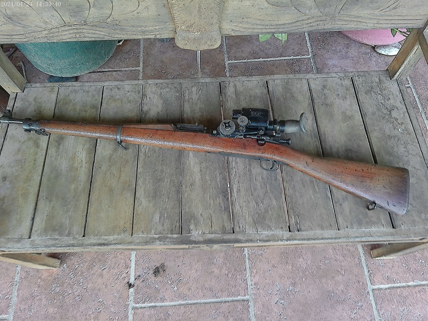

I have only ever seen one Warner Swasey in either the M1908 or M1913 variation (in person), that was real and wasn't a restoration. They are extremely rare as most had their mounts removed or were destroyed by the early 1930's.
This is one from the last block made in July 1918. It is in the 932xxx serial range. I think the only reason this one survived is it went to a National Guard unit and probably someone took it home at some point. Or Ordnance did sell some in the early 1920's , so that is a possibility.
At one time this one did have a Maxim Silencer on it. There are distinct marks on the barrel where one had been.
