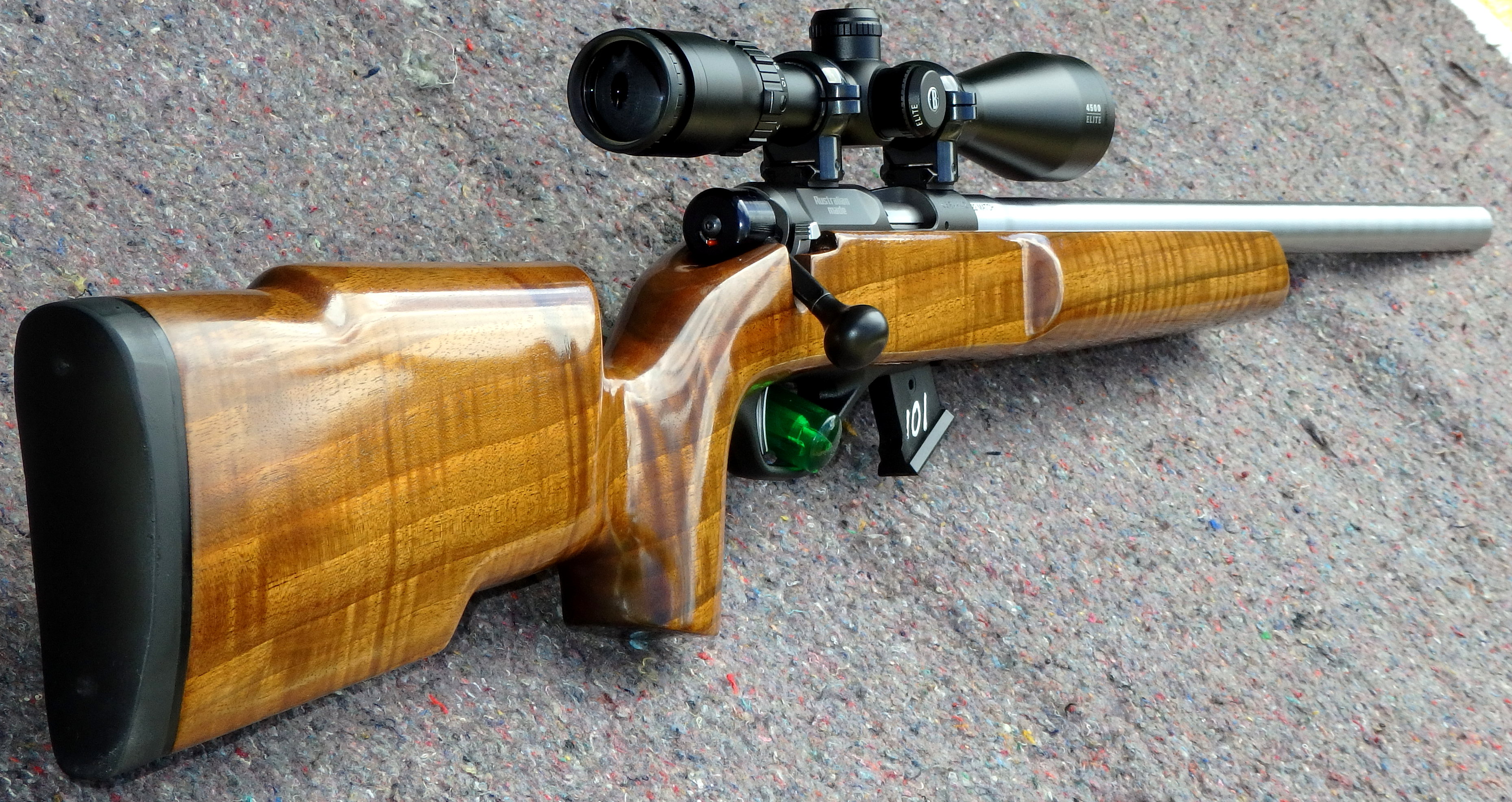

Lithgow LA101 with a few mods.
allan harris
Nov 23, 2010
80
121
76

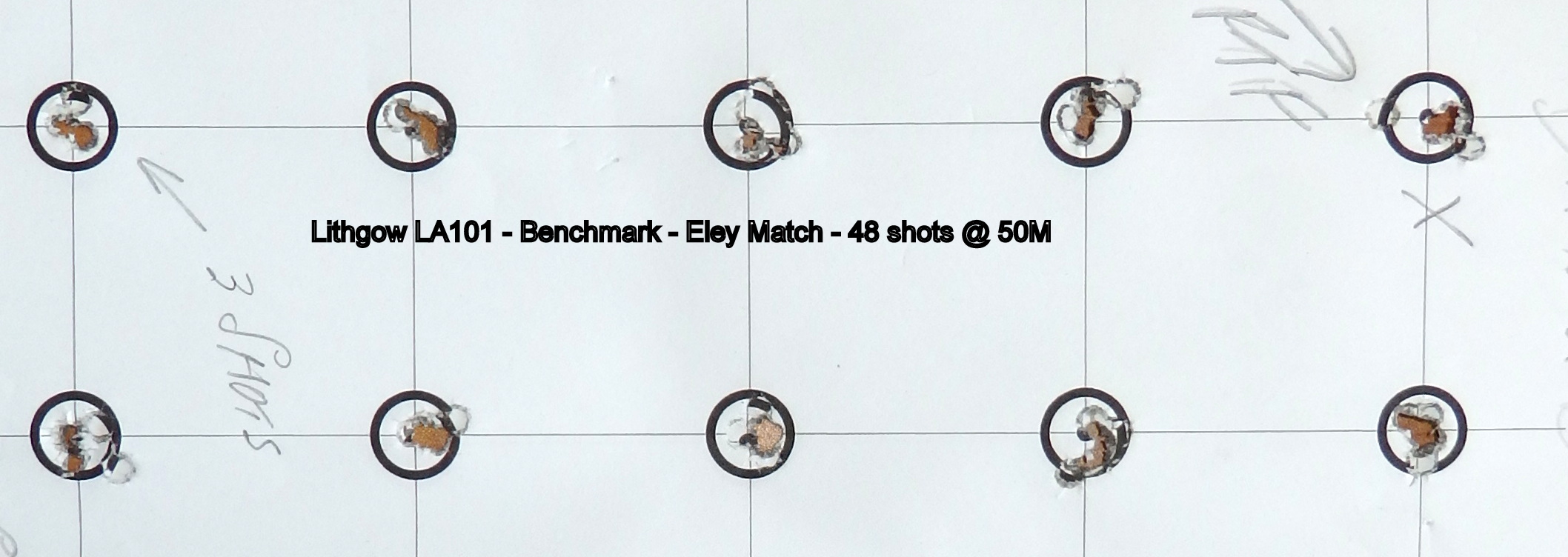

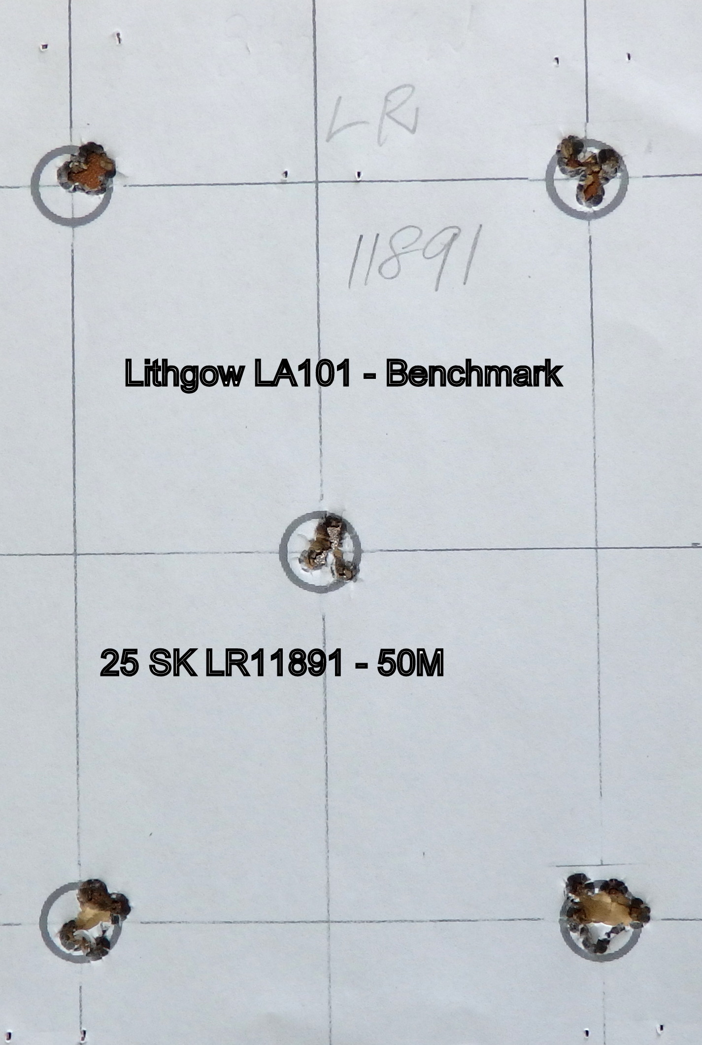

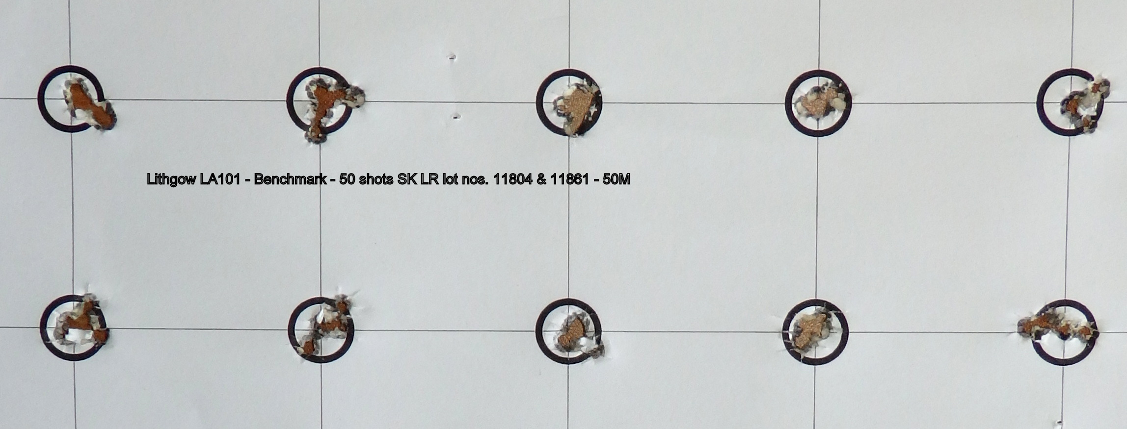

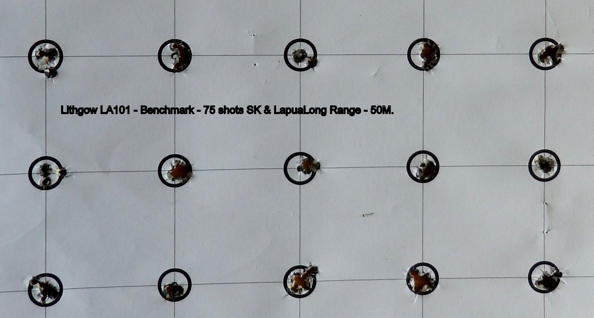

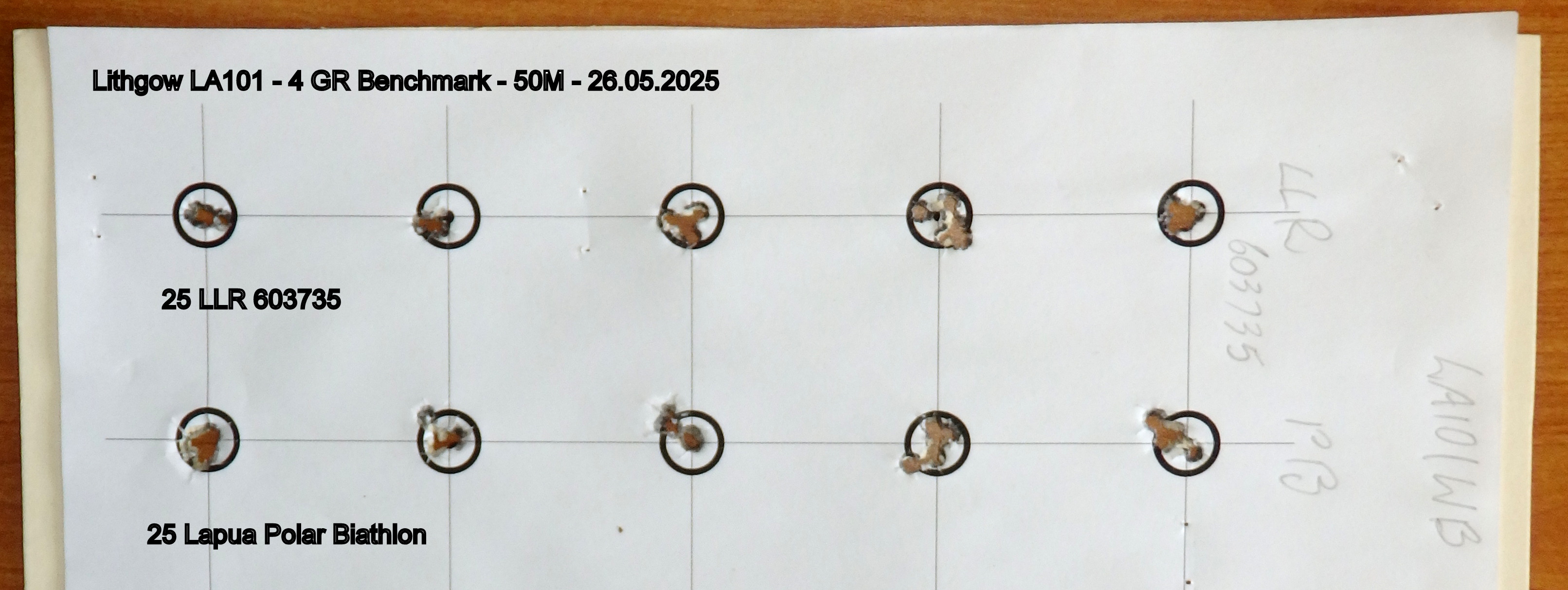

My smith finished this recently and I've just started doing some initial ammo testing.
Ammo is very scarce in my area so I just buy anything decent I come across and hope it shoots OK in one or more of my rim fire barrels.

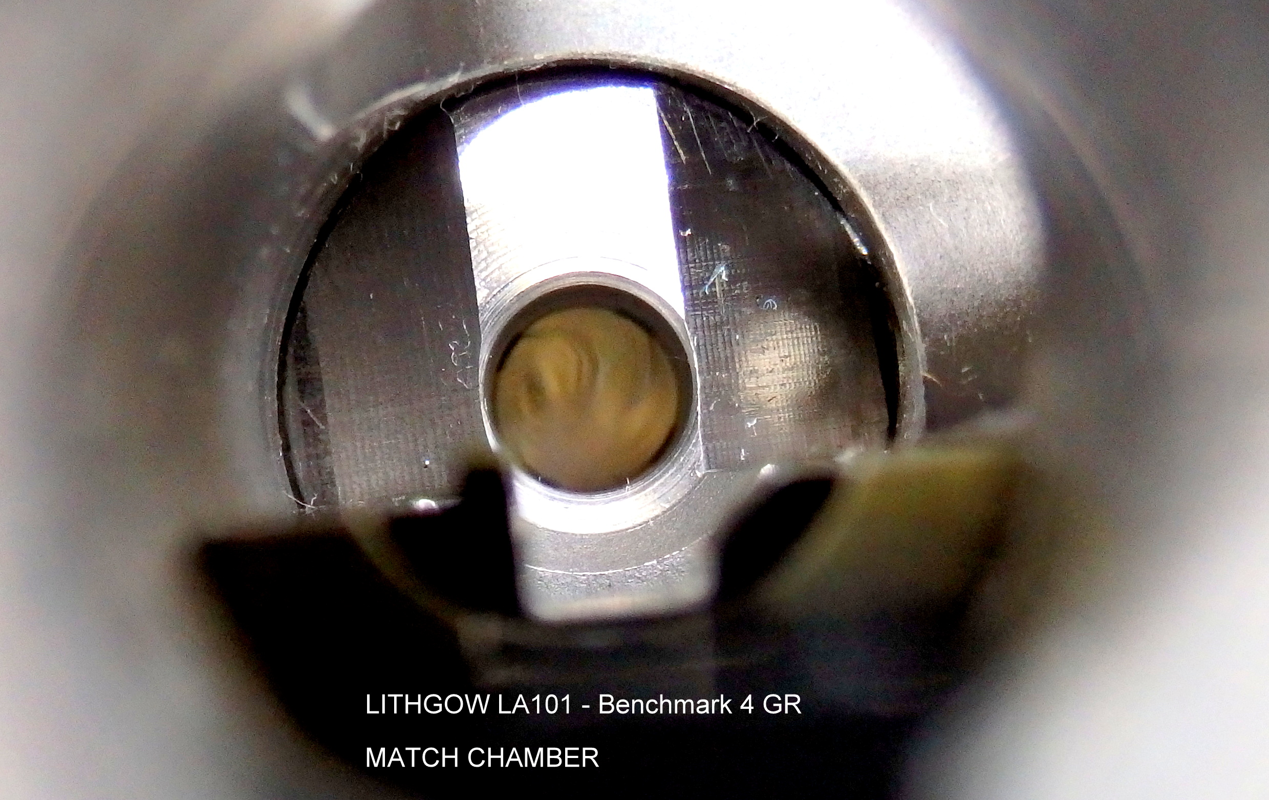

The attached targets have been shot with a variety of SK/Lapua/Eley ammo with head space set at 045 & 043. Ignition is a little inconsistent with the thinner Eley cases and I've had a few misfires but can adjust the HS to suit in a few minutes if I can only source Eley.
Overall function is faultless with all ammos and several magazines and I think this will be a nice 22 - Only have a few hundred rounds through it at this point.

I stumbled across a 4GR Benchmark with the Vudoo BR contour locally a while back. The dimensions suited the Lithgow build and it finished up at 24" straight X .910".
