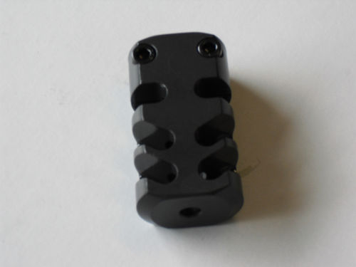

Tried all the "timed" brakes and got sick of it. Finally bought a clamp on and love it. No need for crush washers, shims and magic pixie dust. No voodoo involved during install. Just screw on and tighten Allen screws (2).
