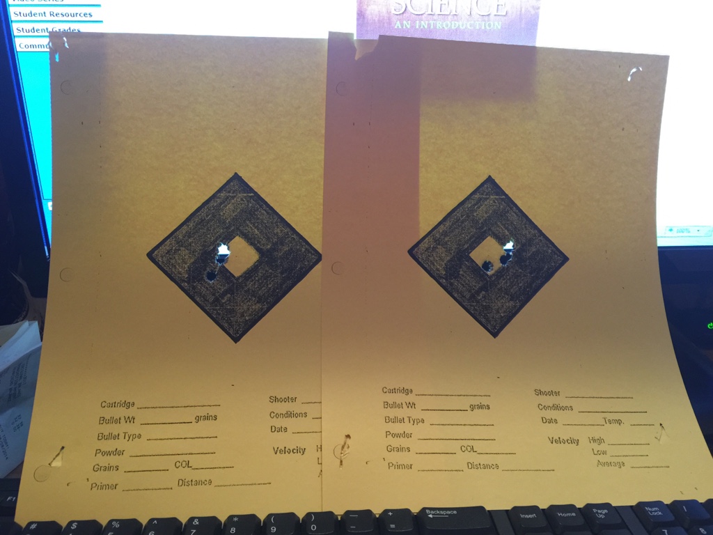

I run this bullet in my .308 with awesome results. This was just from a few weeks back with a four shot group.
43g Varget
CCI 250 primers
Hornady Brass
Seated to 2.270 to ogive
.030 off lands
