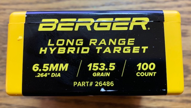

    Just looking for a good starting point for my SW4350 powder.
    Anybody with any Start/Max recommendations for this or equivalent heavy target bullet in a 6.5-CM using any 4350 powder ... feel free to share.
    I'll definitely start low, and ladder up.
    Thanks!
