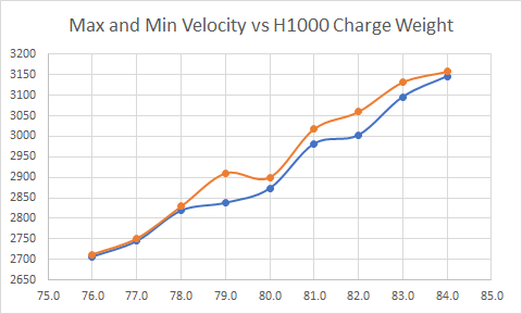

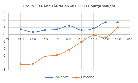

My first loads were at the same OAL as the Hornady factory loads which I believe now were touching the lands, and chambering the round probably seated the bullet a bit further. I started at 76gr H1000 and worked my way up to 84gr where I could see faint marks on the brass if I held it up to the light right, and the primers were getting a bit more cratered, i.e. a slight ridge around the firing pin impact, but not flattening.
Max and min velocities vs charge weight shown below:
100 yard 3 shot Group size and elevation above or below aim point shown below:

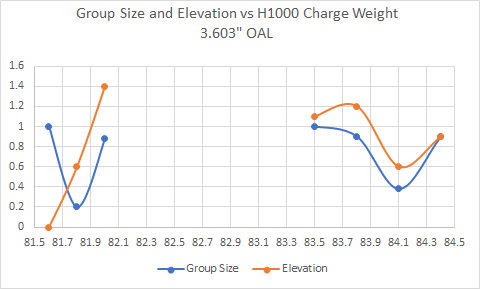

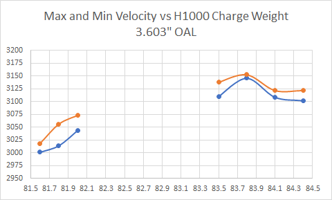

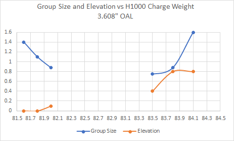

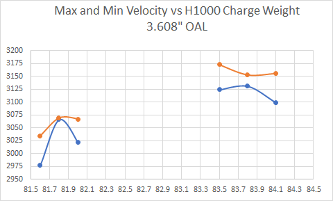

I decided to try and further refine things by trying two different seating depths between 81 and 82gr (minimal change in velocity and > 3000fps) and 83.5 and 84.1gr (3100fps+ and still relatively small dependence of velocity on powder charge). OAL touching the lands is 3.618" as near as I can tell using a modified case and Lock-And-Load tool. I am not very confident in the accuracy of this measurement as I could not get very consistent results, at least at the level of precision we're talking about here.
Results were as follows:
I was originally thinking that 84.1gr and OAL of 3.603" was going to be my load. But after graphing everything out, that same load just .005" longer quadrupled the group size and ES of velocity. Is this sort of sensitivity to seating depth normal? I was hoping to find at least some consistency in trends of powder charge variations between the different OALs, but I don't really see any.

I also wonder if this is just the result of plain old probability. If I shot the exact same load over and over in 3 shot groups and each shot had a normal bell shaped two dimensional distribution about the aim point, I would expect to have some small groups, some large groups, and a lot in between. Am I just looking at that same phenomena here, i.e. is that .2" group just "good luck" and the 1.6" group just "bad luck"?
