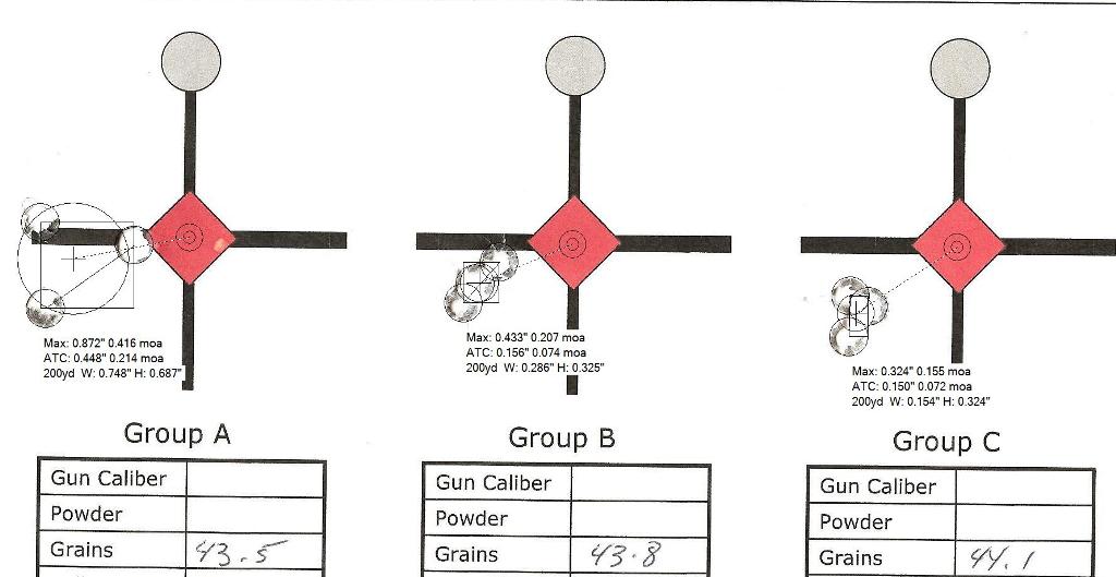

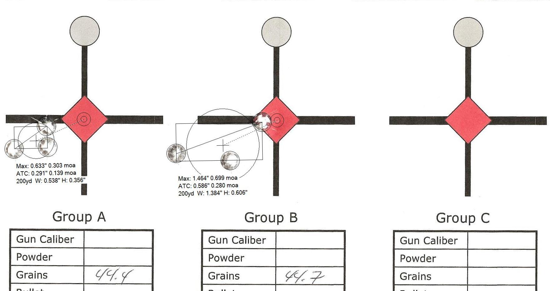

I've done the OCW test for 175 SMKs twice in my rifle, once with a 24" barrel and once with a 30" barrel.
<span style="text-decoration: underline">Both tests show a node at around 44 to 44.5 <span style="font-weight: bold">IN WINCHESTER BRASS</span>.</span>
Your Lapua has less capacity than W-W so the load will be somewhat different.
First I think your loads may be spaced too far apart. I use 0.3 gn spacing, and it works, the nodes tend to be about .6 gn wide so you may miss what you are looking for.
They are already posted in another thread so I'll link to them. Here are the targets from my latest workup with 185 Bergers at 200 yards. I know that the OCW process says to ignore group size and look at location, but if you look at these targets you see that not only do I have 3 groups that are w/i a bullet diameter of the same spot from the point of aim, the groups are also tight, more indication that it may actually be in a node. The wind was from my right, so if you consider that it takes very little wind to move that one shot 0.3in out of the group at 44.4.
Now ideally I should probably load at about 44.1 to be in the middle, but since I am trying to toss these pills out to 1000 yards I may see if I can get it to hold together closer to 44.4 for the extra MV.
If I were you I'd pull those down (or not and save the ones that you don't use for load tuning), but make up a series with 0.3 gr spacing. Use 3 round groups unless you get a flyer, and if you do, and you know it was on you, then shoot another and note the flyer, don't count it in your assessment.
Chrono is nice, it will tell you if your loads are consistent, but you don't need it for this part.

Go read this:
OCW load testing
Chrono is nice, it will tell you if your loads are consistent, but you don't need it for this part.</div></div>
