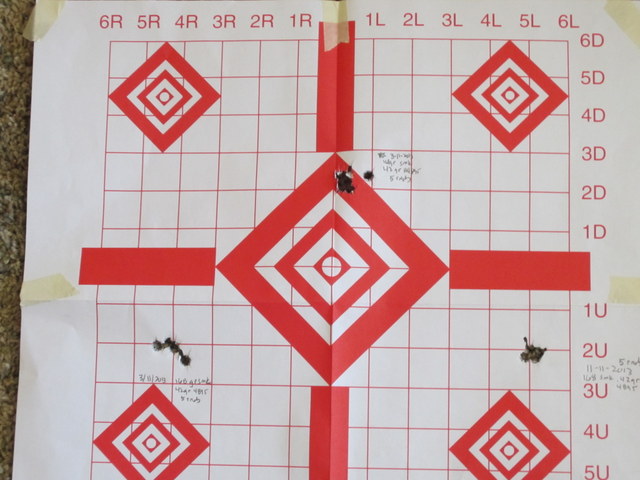

I think you'll be fine creating some loads with what you have. For me and my MilSpec, with 168's the go-to load is 42 gr of of H4895. These are 5 shot groups at 100 yds from a week ago:
