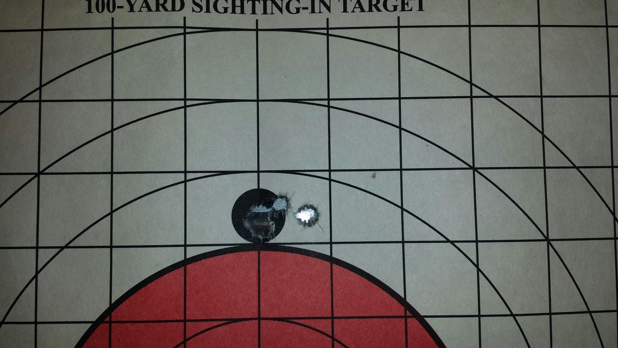

5 shot group 100 yards. Last one got away from me.
85 gn Retumo
Sierra 300gn
Federal 215
