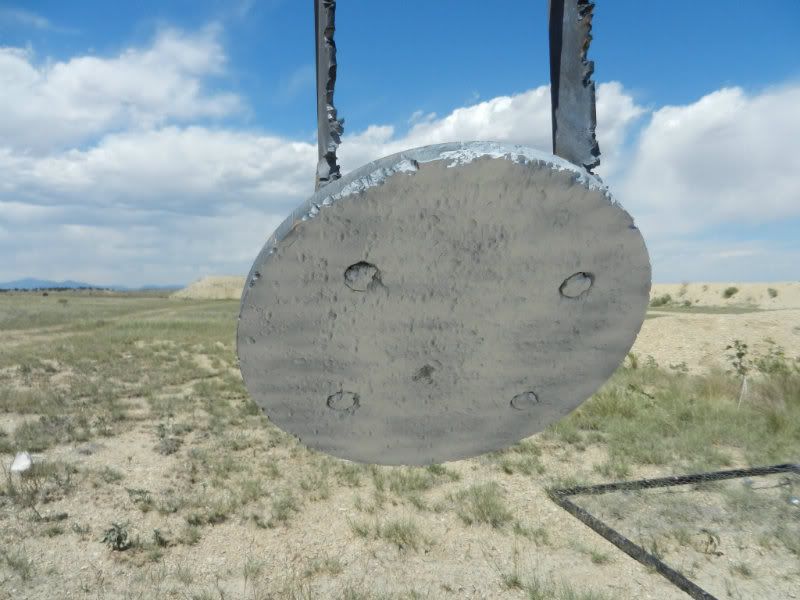

Went out today to test the new system. I intend to use it for a walking prairie dog rig, for the head shots that present themselves often while walking a town. I bought a bunch of Win. Dynapoints from K-Mart at 20% off recently, and found they shot about as good as anything at 50 out of this rig, so i was thankful for that [they really shot great out of my Buckmark Varmint--.5" at 50 for 3 shots. That was nice to see as this gun hasn't shot anything great to this point.]. I chrono'd 1 shot at 1020 mv. Just about perfect i thought. So i accessed my generic ballistics profile for 22 figuring .1 BC at 1100 mv. and at 110 yds. it required 8 MOA of up from 50 yd. zero. The BDC 2nd circle is 6 MOA so i cranked up 2 MOA and put the circle dead center on the 100-yd. steel plate below and shot--1st shot pretty good. Had a 6:00 wind at ~10 mph so no compensation needed. The next plate was 160 yds. at 17 MOA up. 2 MOA turret added to the lower post tip of the reticle [15 MOA], and held the post tip on the steel plate and next shot was close enough. I think this is gonna' be a fun shooter with the Nikon on top. The Bushnell grid boresighter showed good consistent turret clicks and maybe 40 MOA useable turret adjustment, and good return to zero. Gonna' put a set of Burris rings and play with some offset inserts to see if i can gain any more up out of the system. Would like to have 300-yd. "plinkability" [~50 MOA] with it so i'm keeping my fingers crossed--we'll see--
100 yds.-
160--
