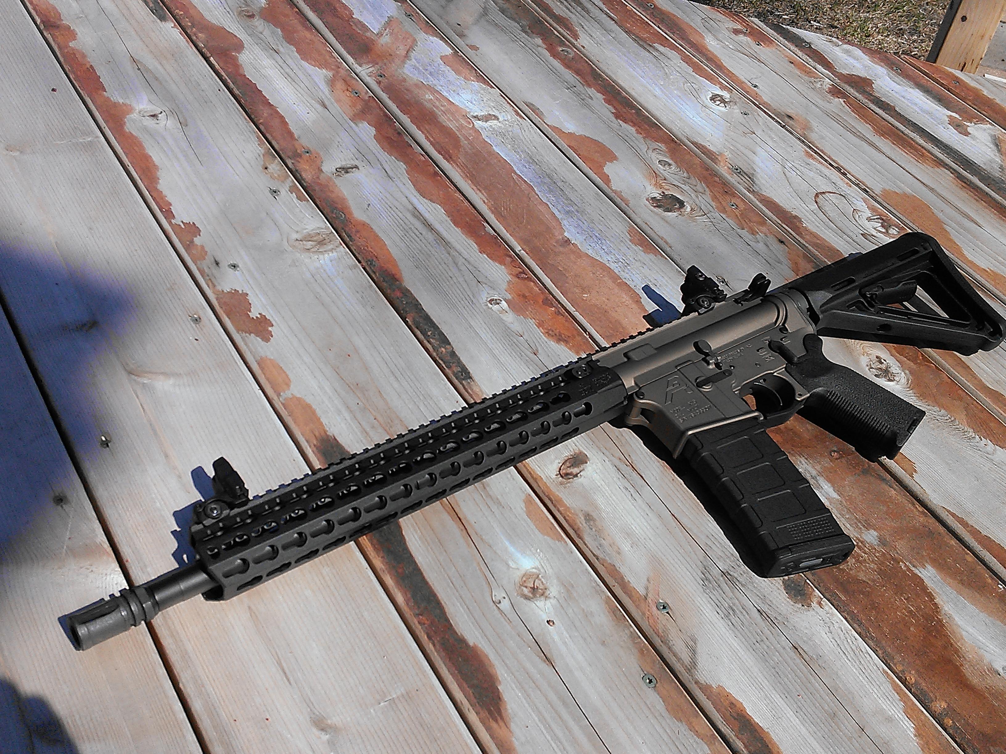

I built a dedicated .22AR and it was one of the best gun decisions I've made. I tried going the route of the GSG .22 (MP5 clone) and that thing was awful. So I decided to spend the $$ and build a kickass .22. So this is the CMMG bolt group and CMMG barrel in an AR upper and lower. Yes, to those who are very observant, that's a pmag in there. It was handy so I stuck it in to take the pick.

hey, i like that handguard profile. who makes it and what model is it? it doesnt look giant around the thin can.
