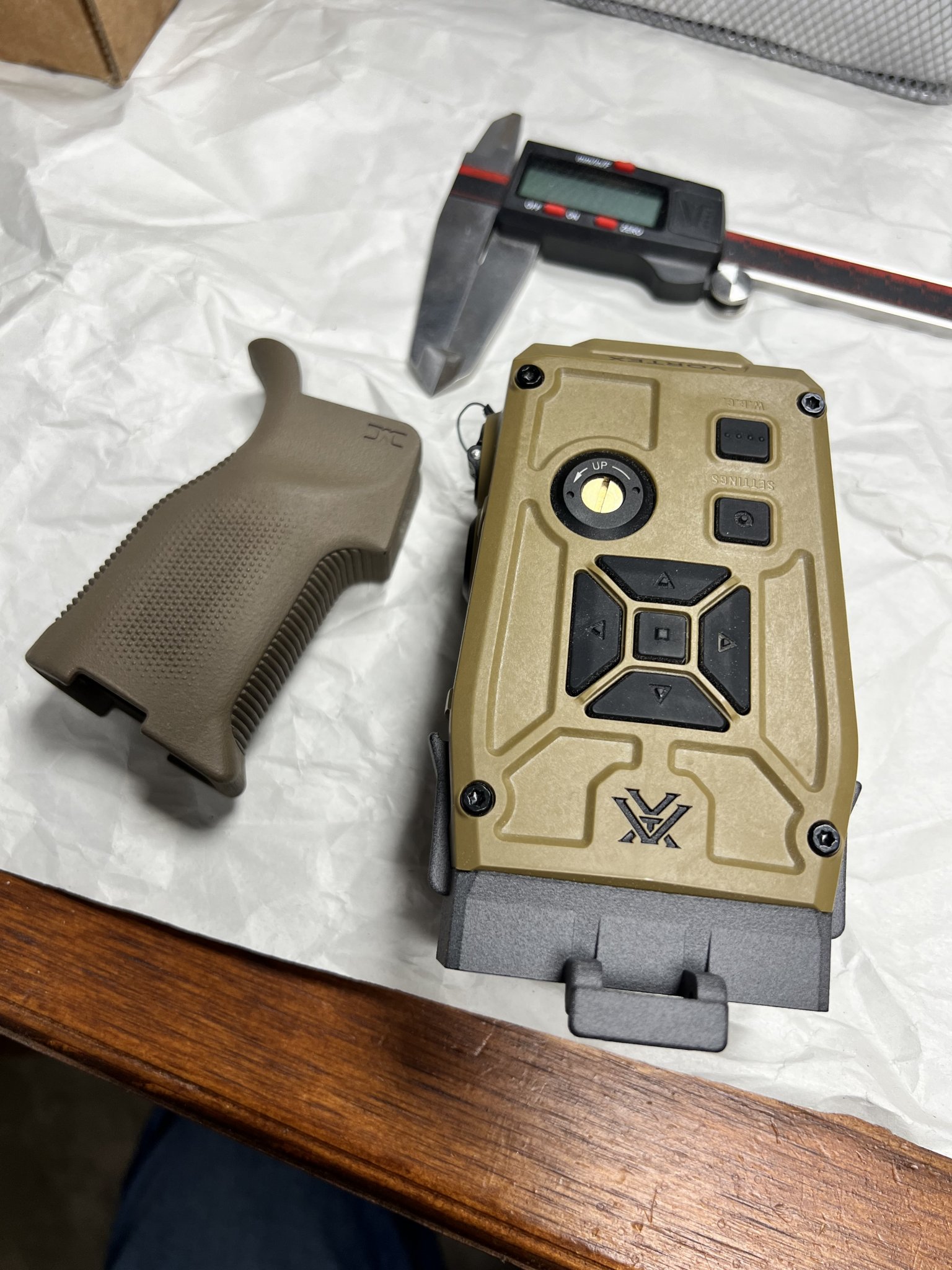

Our FDE is the "magpul" FDE. I'd say it's close but not exact. To get exact we'd likely need a custom cerakote color made. We can compare some swatches and I can put a pic of the magpul FDE up as a comparison.
Sounds good, may go with that. Appreciate the reply.
Here's an Impact vs the Magpul FDE:

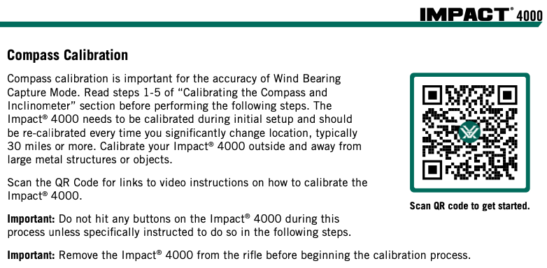

Is it the case you have to unmount this thing and re-calibrate it every time you change locations? Vortex says if you move more than 30 miles. And the calibration process looks annoying. Am I missing something? After you do that, you'd have to re-zero all over again, no?
The compass should be re-calibrated if you move 30 miles or more and it needs to be removed from the rifle.

It's recommended but real world, probably not needed. I would argue to say that it is definitely needed when traveling a significant distance from your normal place of shooting.
I have 2-3 regular places that I shoot, the closest being 5 minutes away and the farthest being 1+ hr away. I did not calibrate again and I was fine for targets up to 1000+ yards in several different directions.
However, if I was traveling a few hours or flying by plane, I'd probably calibrate.

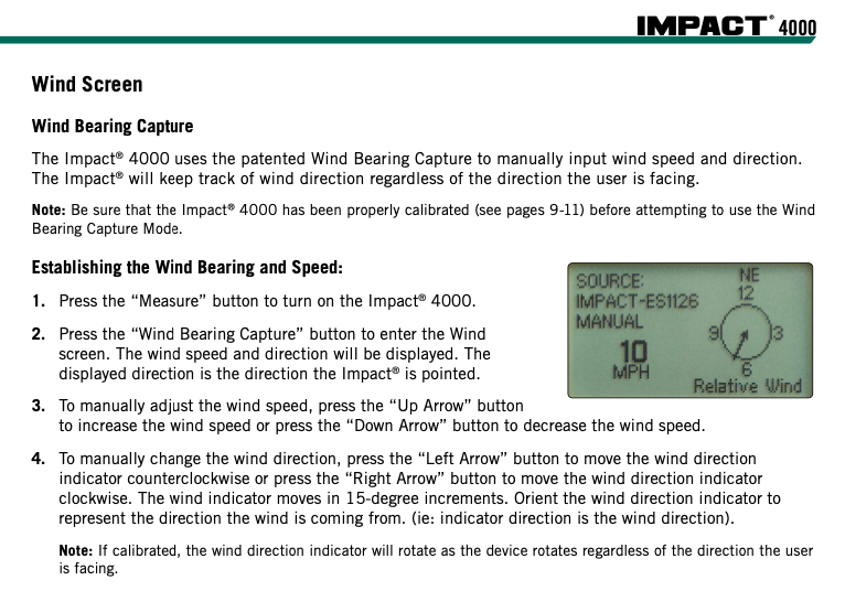

Correct me if I'm wrong, but I think the compass is mainly needed for the unit's wind calling feature. It seems like compass calibration could be skipped if a guy plans on using the Impact for range and elevation dope, and then using something like gun number for wind.
