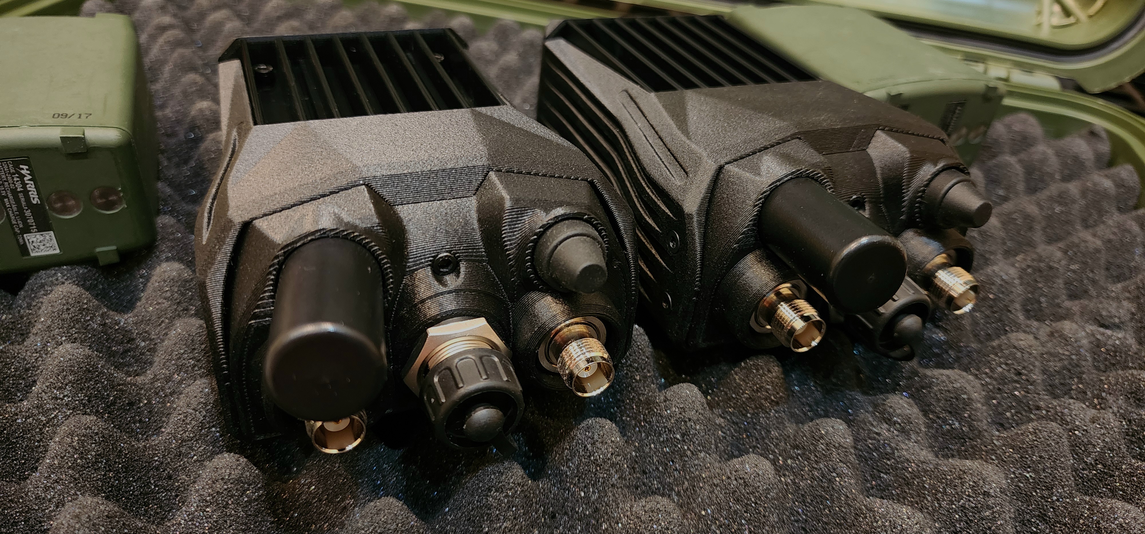

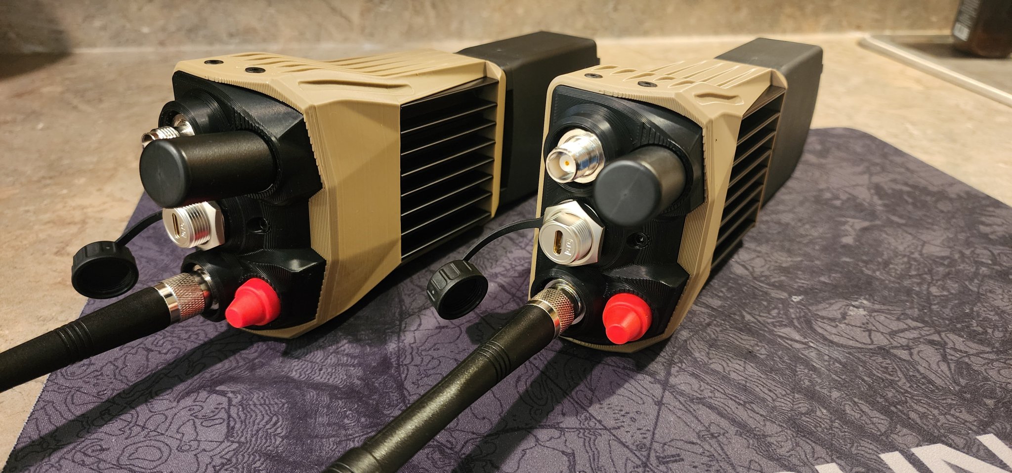

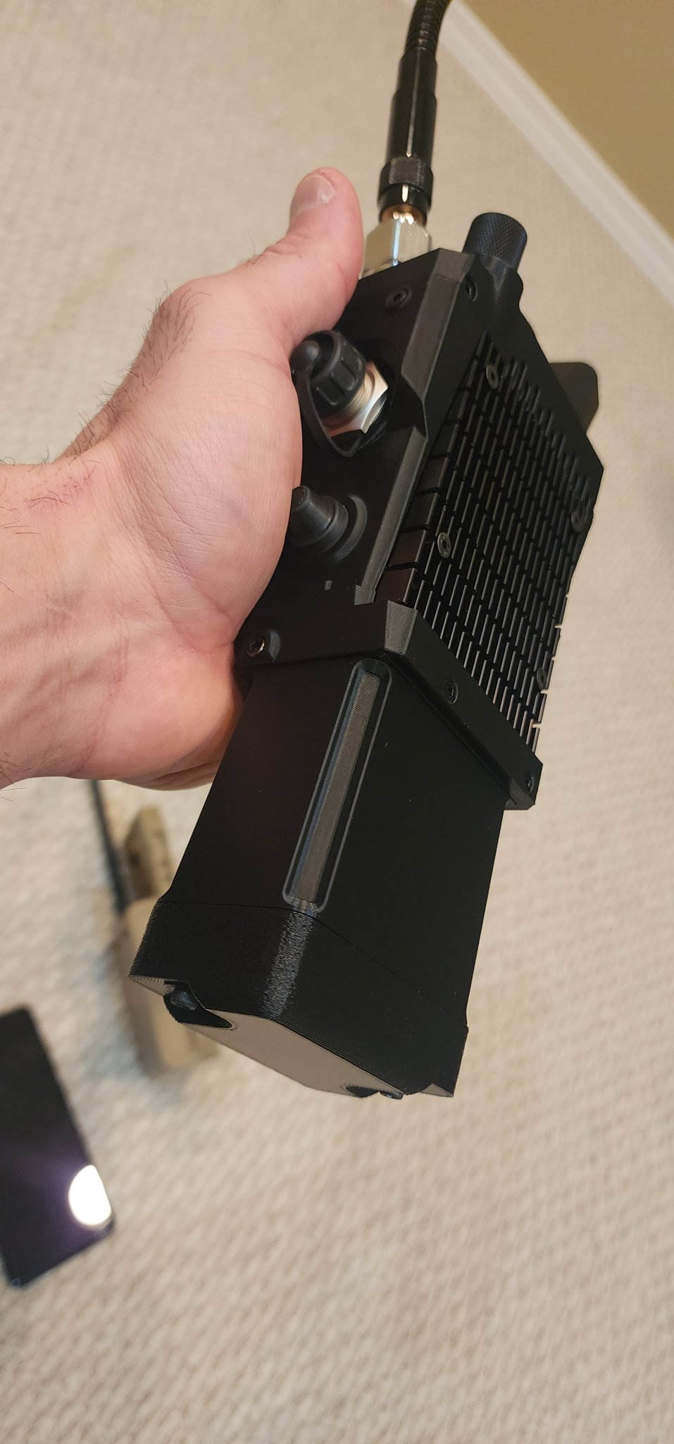

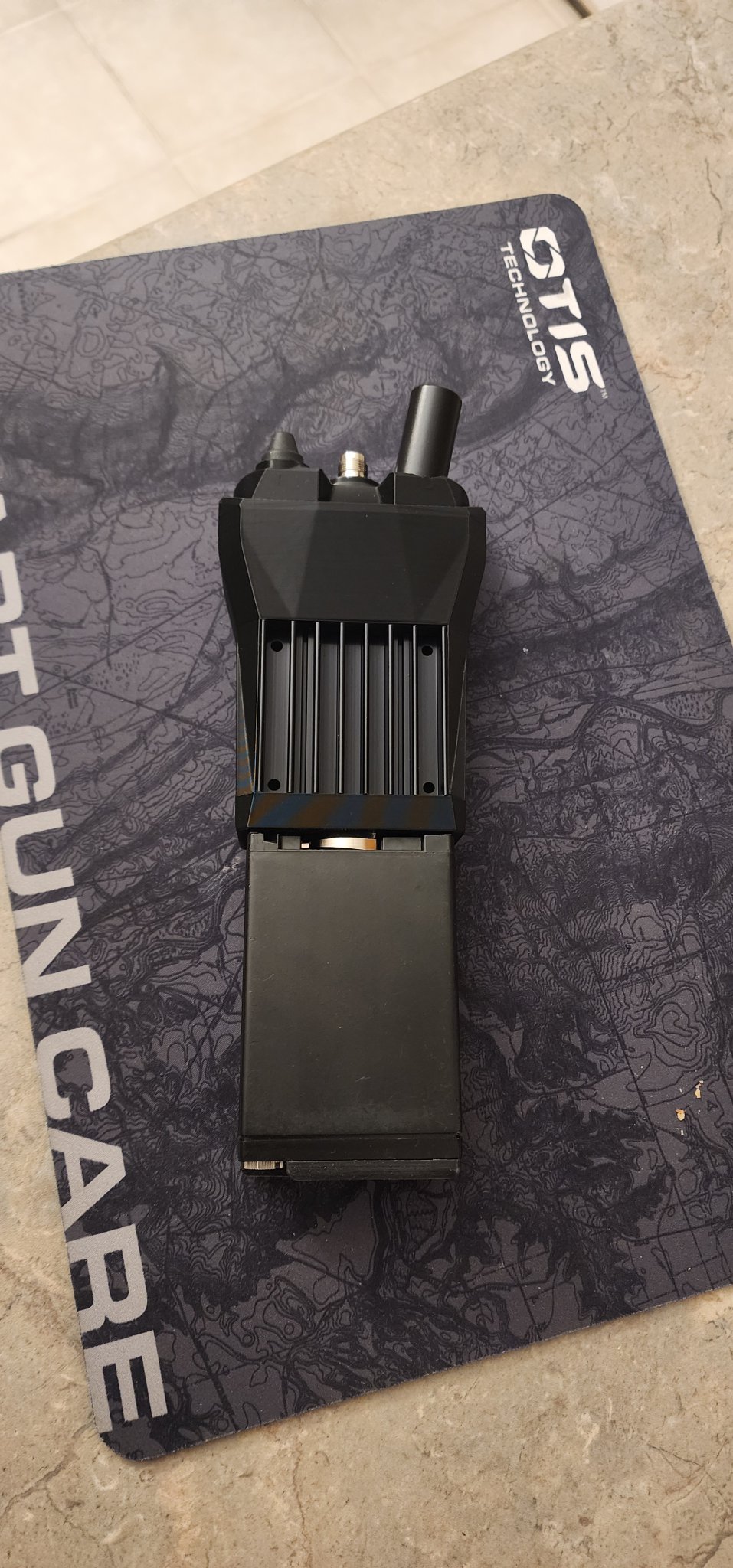

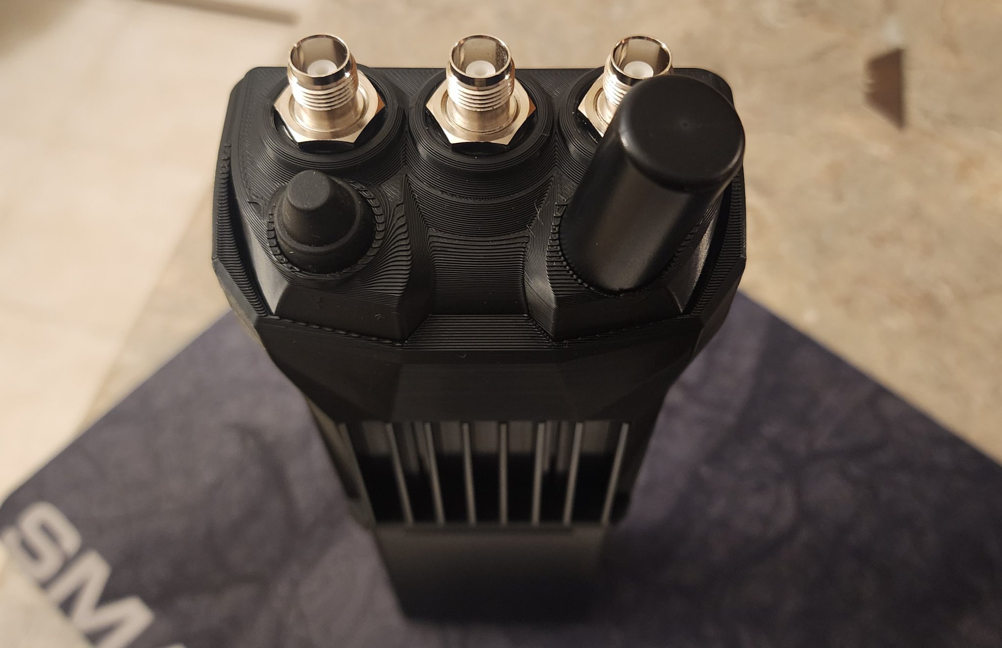

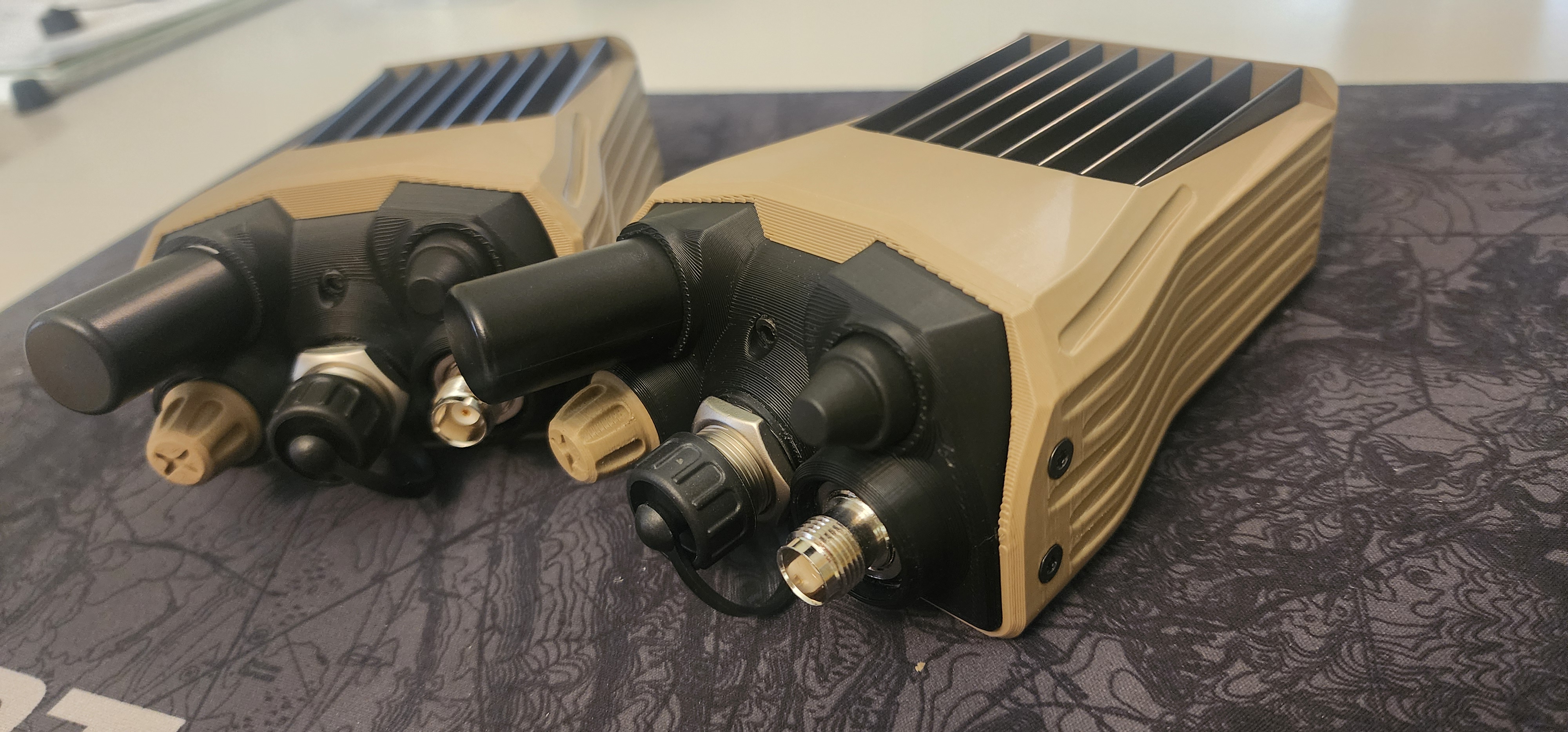

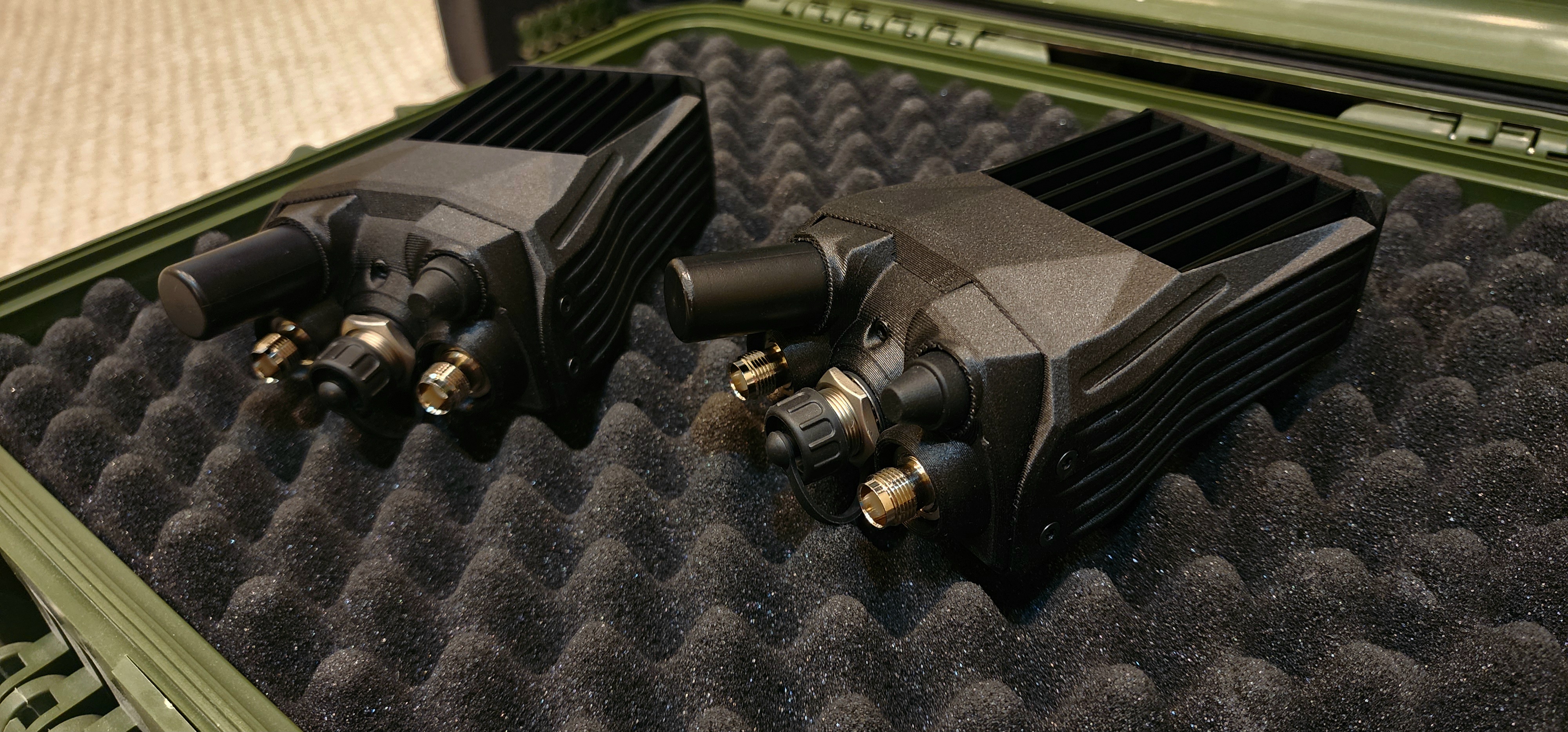

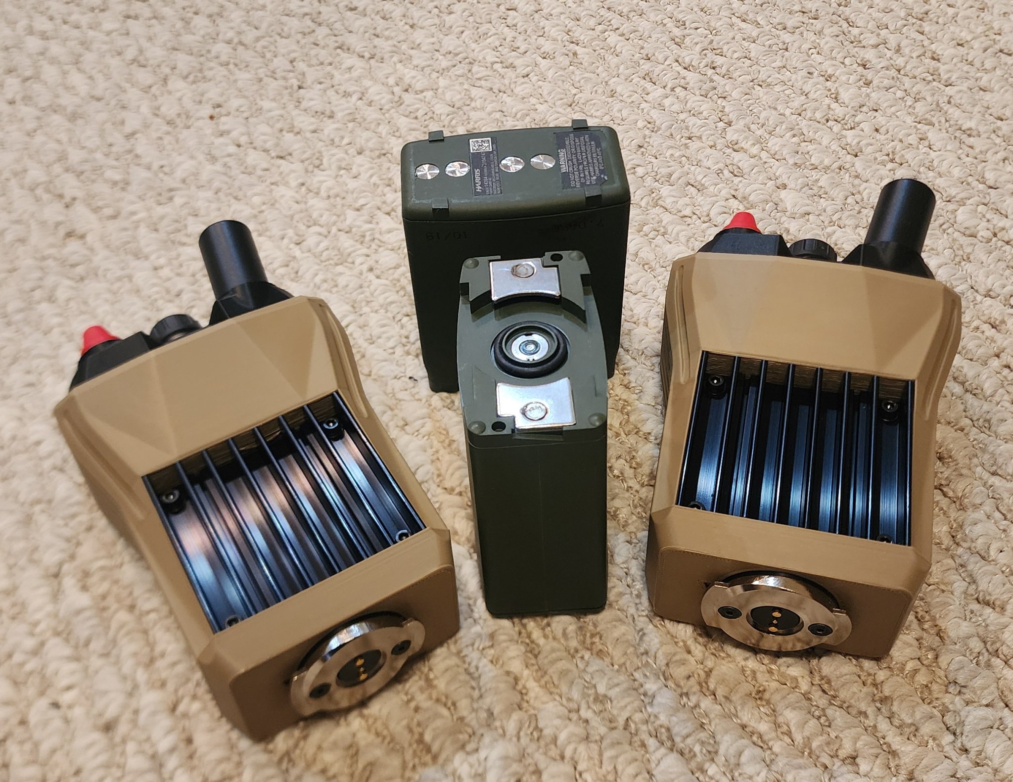

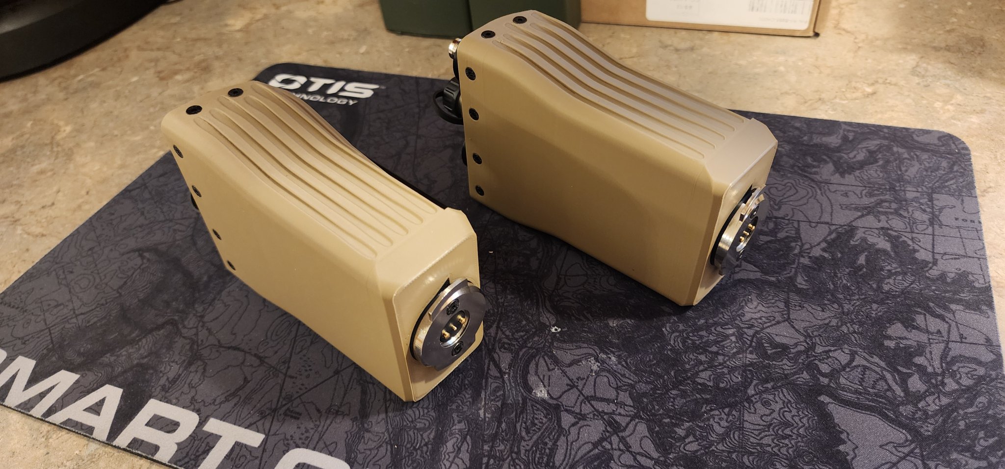

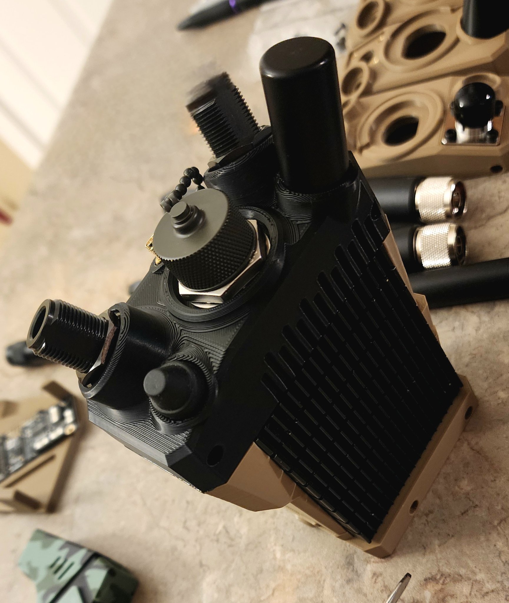

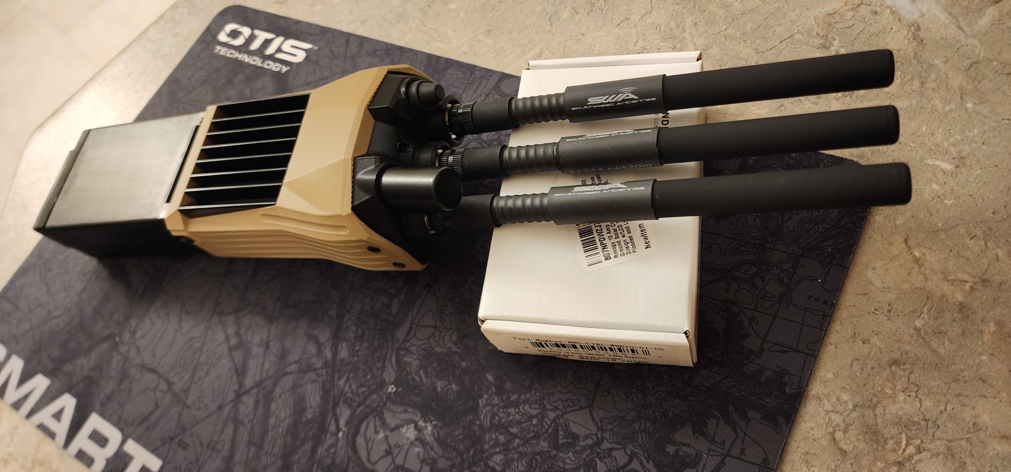

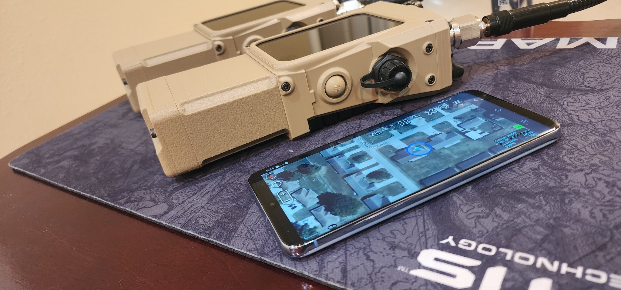

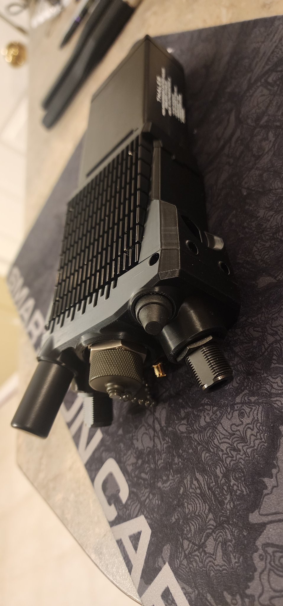

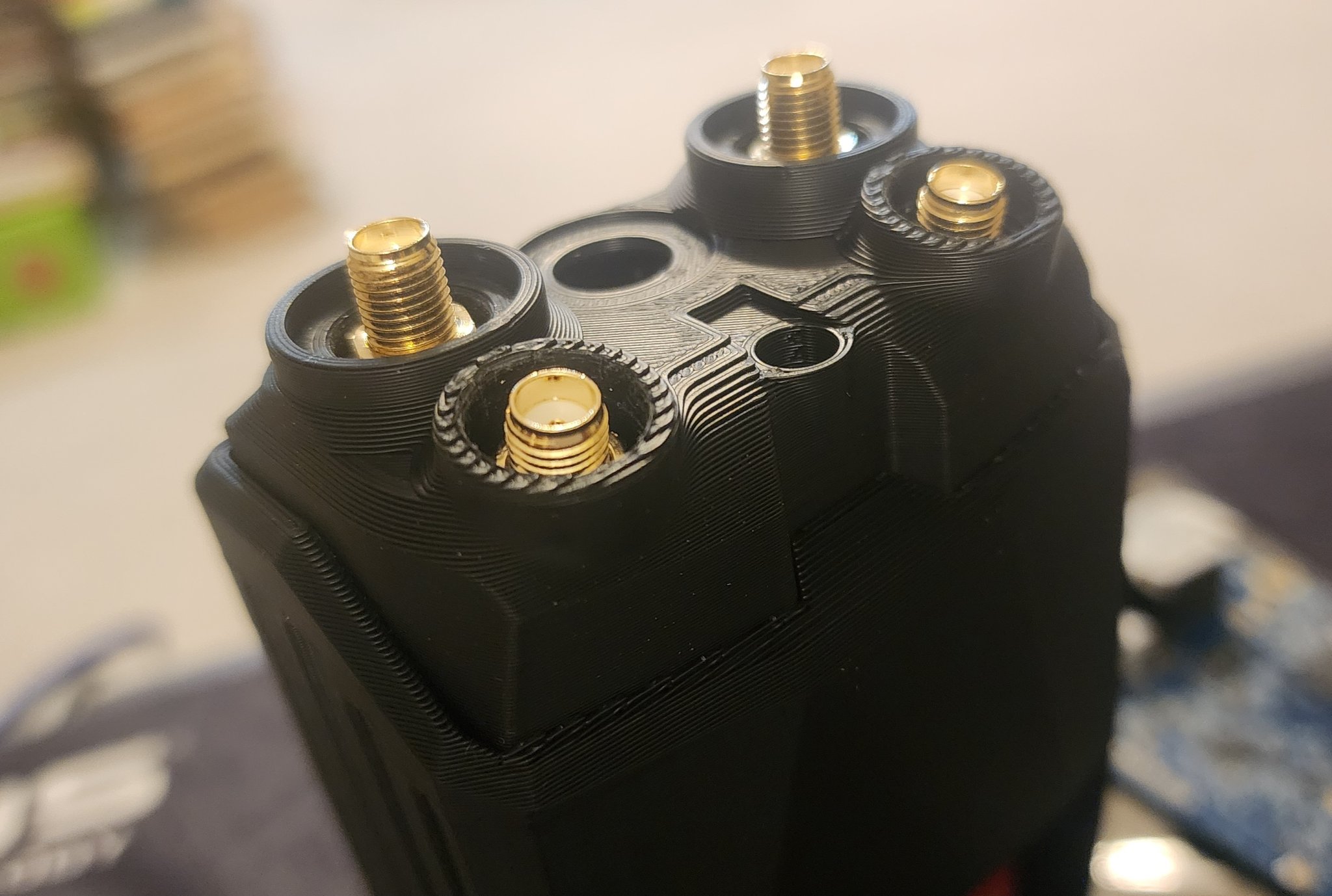

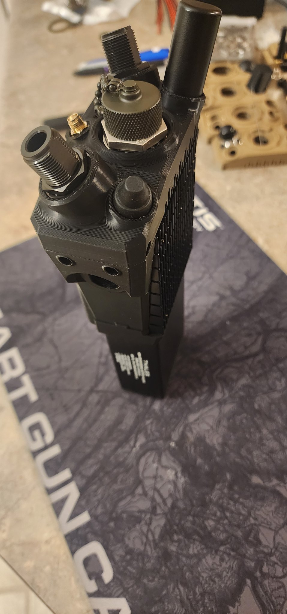

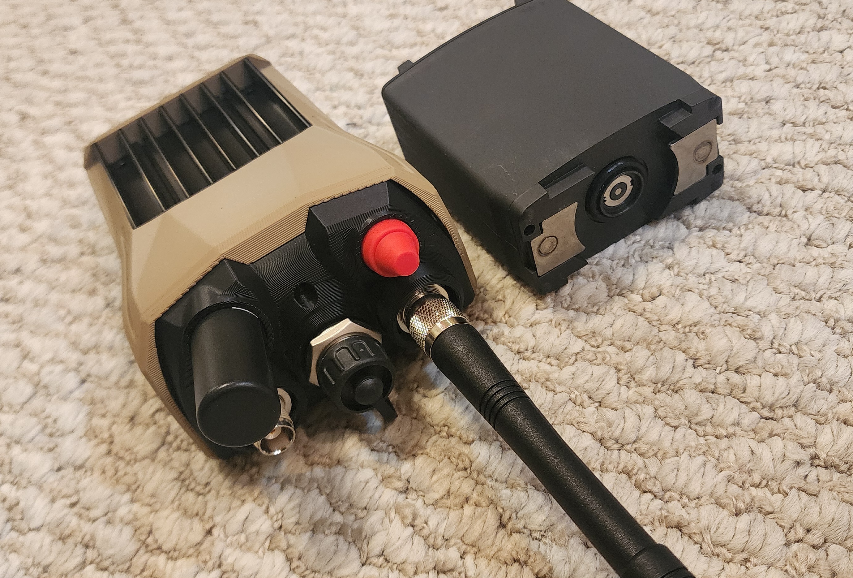

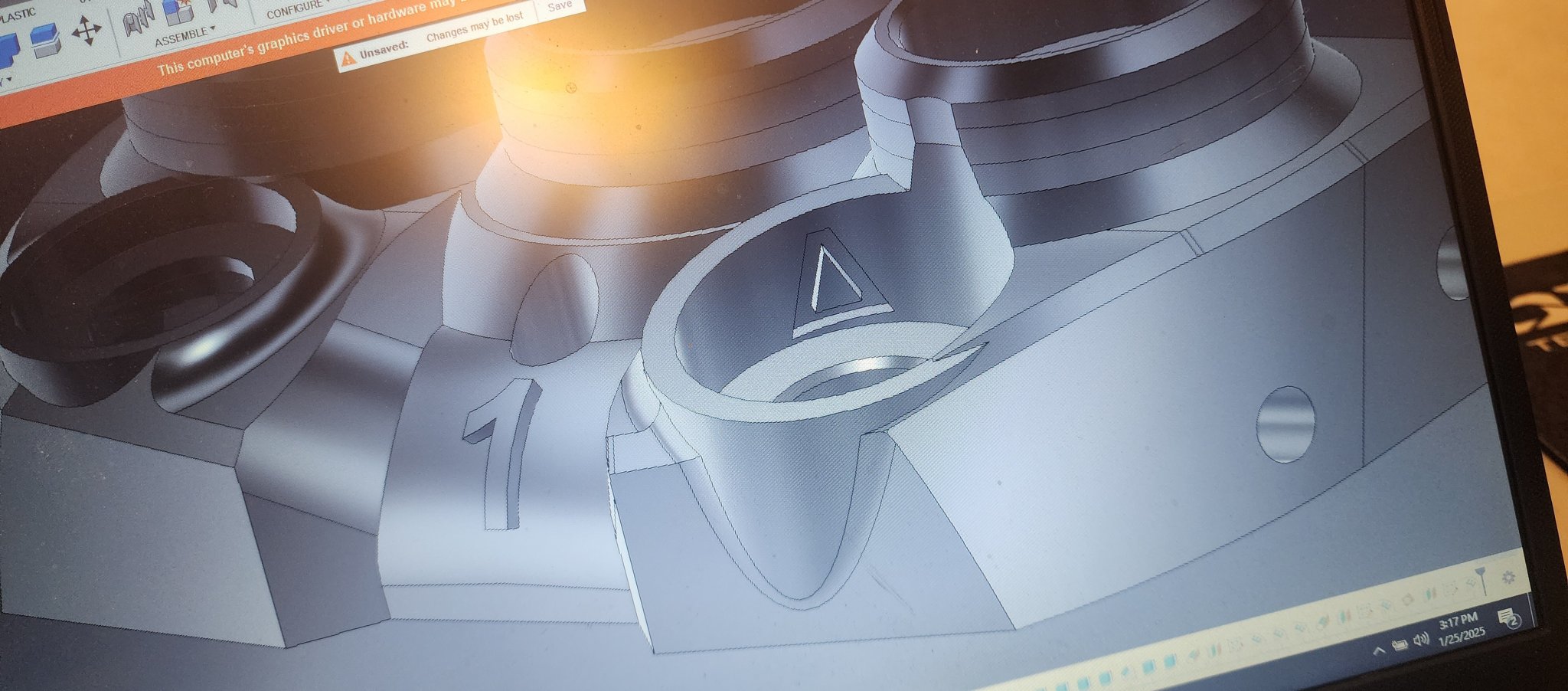

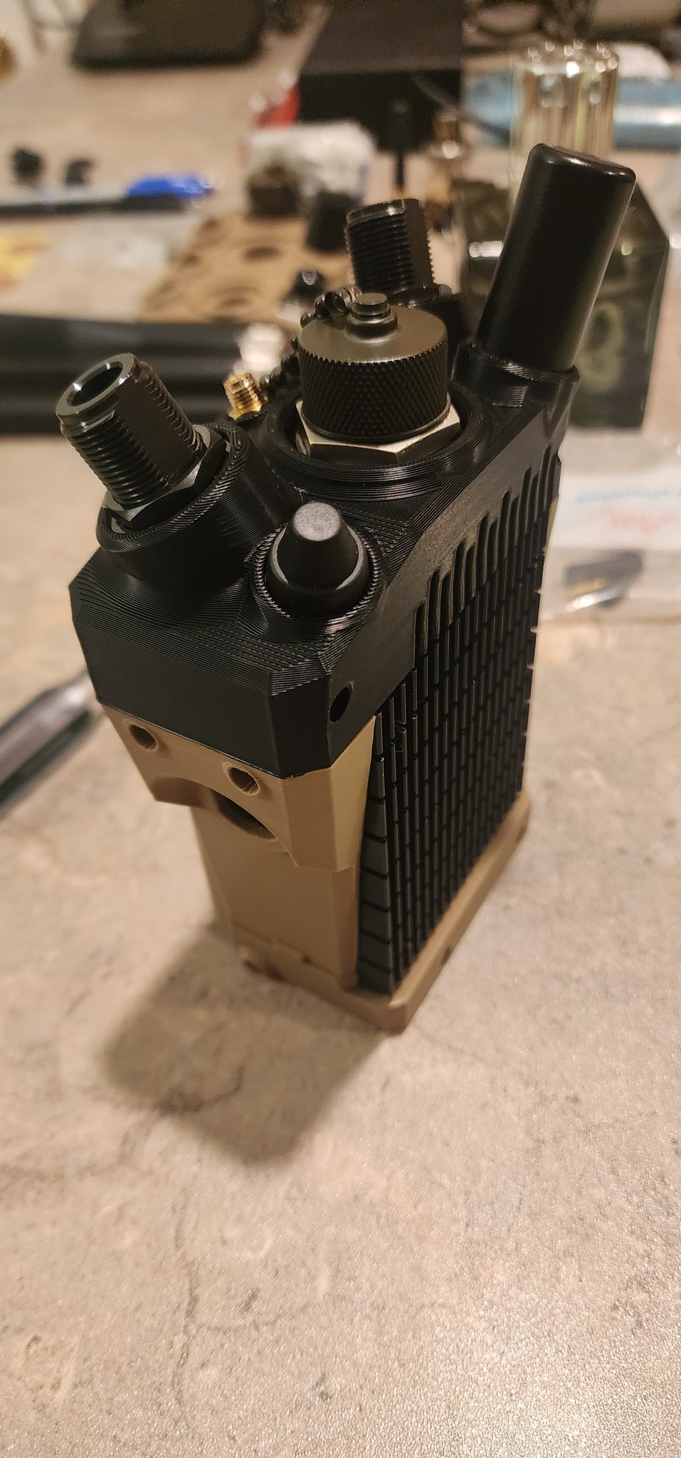

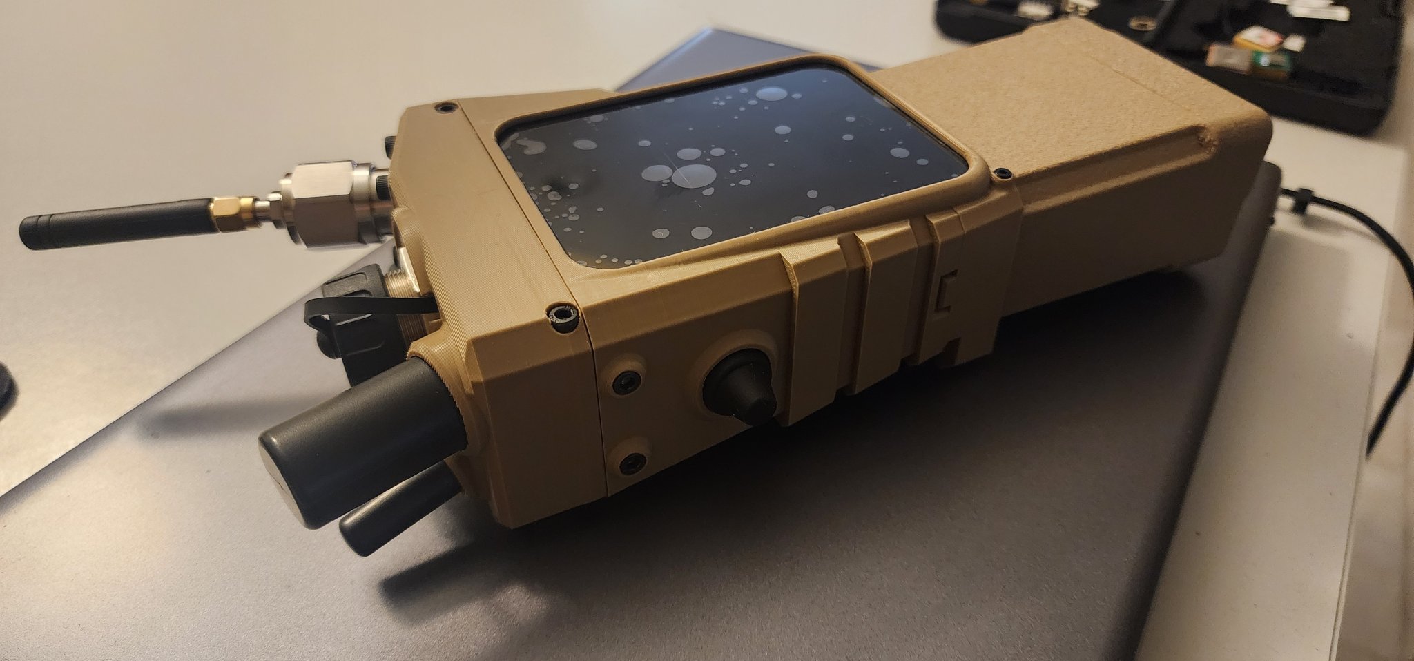

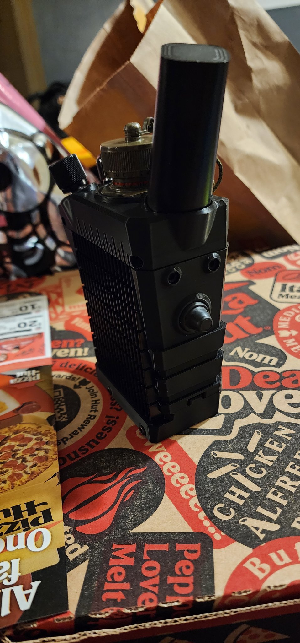

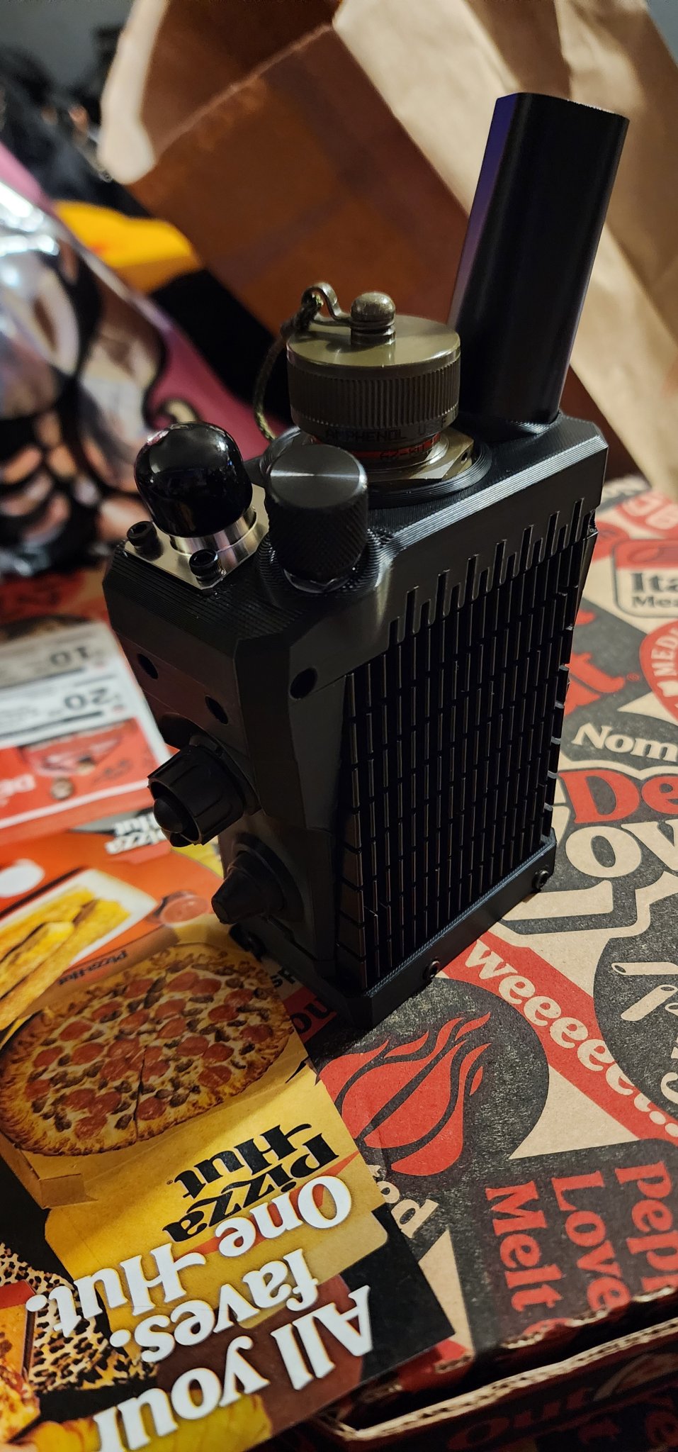

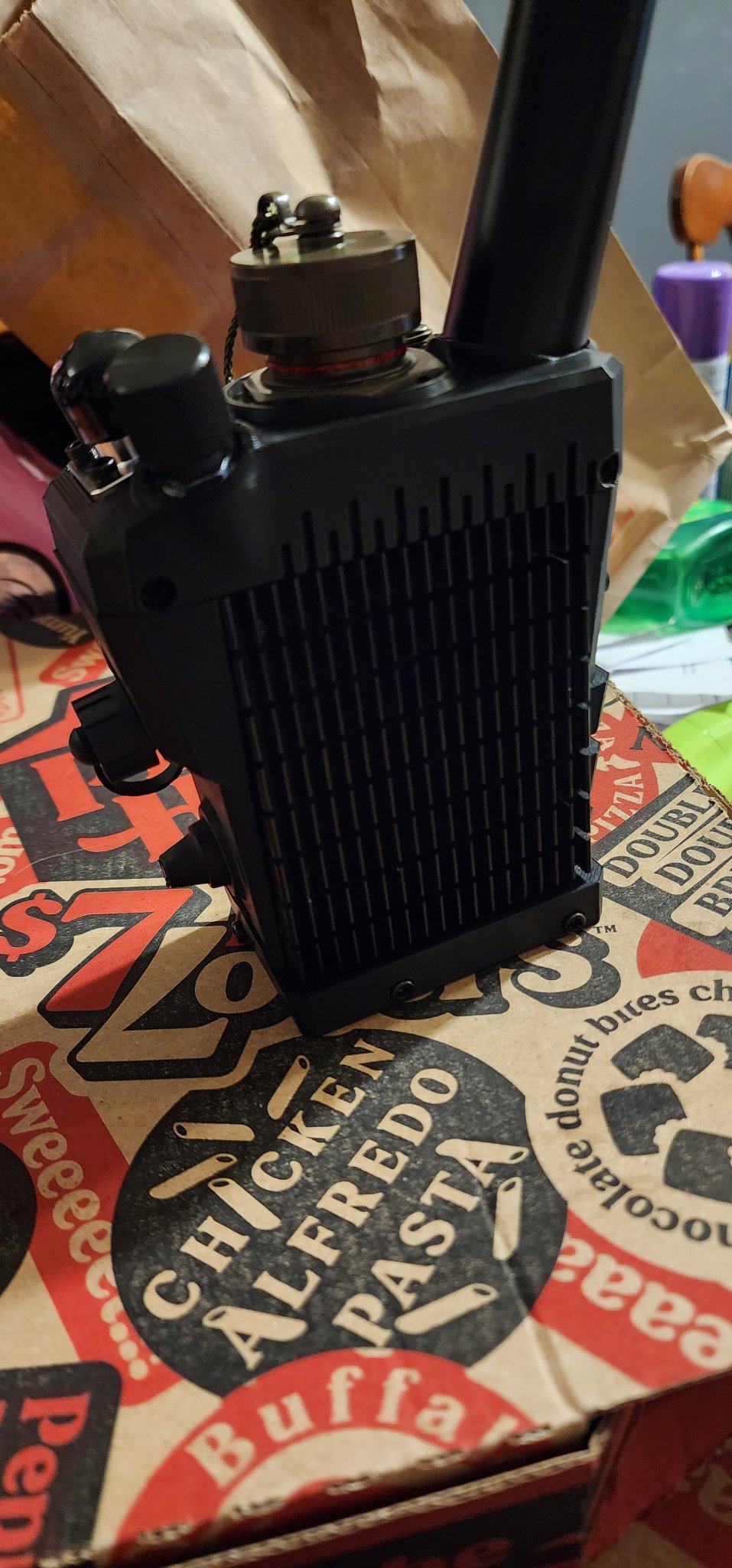

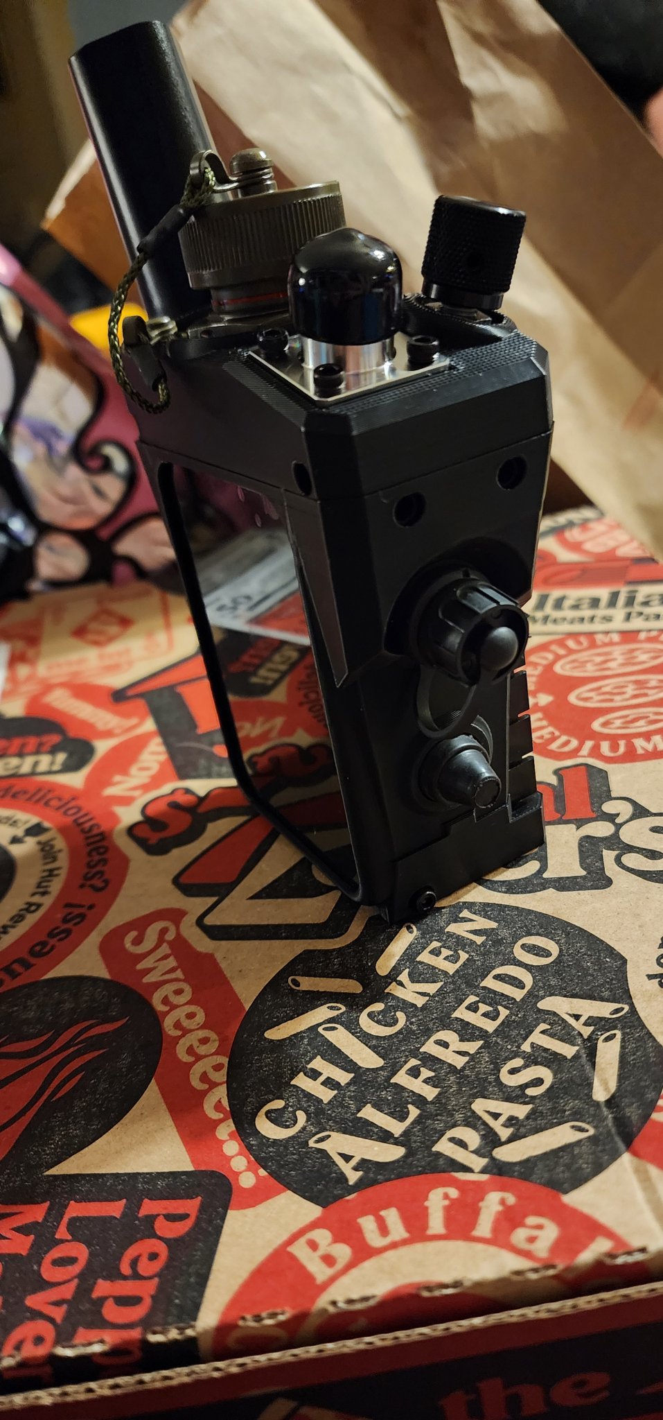

Almost finished with the mesh stand alone version. It can be controlled by any device via bluetooth; with ATAK or meshtastic. Can be used without them since the touch screen on backside.
All very high end certified Ip67-68 connectors. This is not designed with cheap chinese parts or circuit boards. Nor cheap metals or coatings that interfere with frequency. High end circuit boards only.
Mil spec Amphenol Socaplex 5v USB ratcheting connectors for smart device connection /charging.

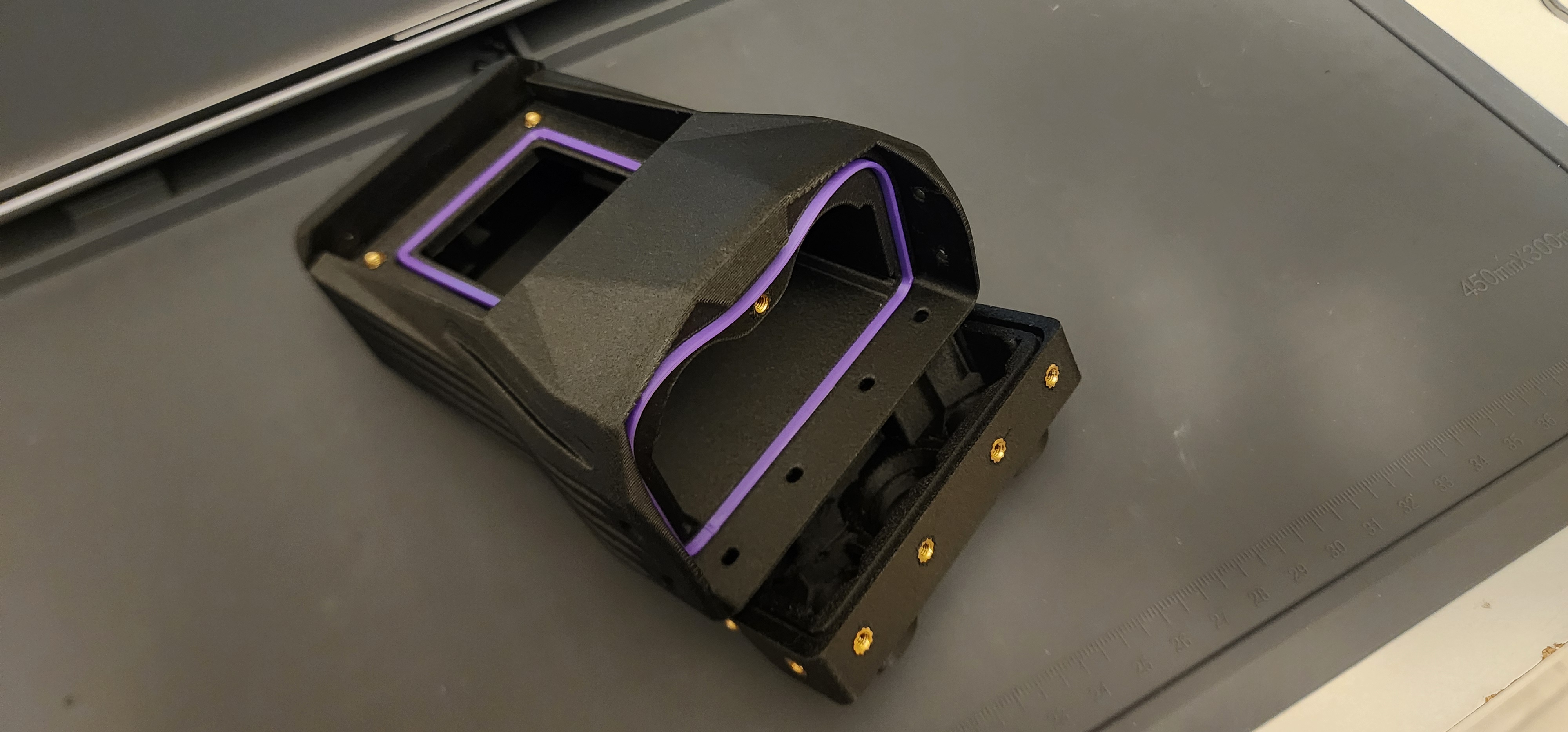

6x 18650 battery swap/ removable by thumb screws. Can run off 2-3 if you need to use them for weapons lights etc. Built in GPS. Etc. Will post more details when I finish up in a day or two.
Kept the dimensions in same range as Silvus and mpu5. So fits nicely in pouches. Main body is 4" tall, with top 6". Battery is roughly 4"
Comes with Tactical Gooseneck antenna.
Finishing up power bank/battery that bolts to bottom. Future upgrades: twist on flywheel battery conversion and 2.4ghz voice over Lora upgrade in the near future.
I have yet to price the cost of parts; to know how much these will be sold for. I could throw a $400 price on a build with cheap chinese parts.
But this build is far from that.
I'll check back with final pics and stats in a day or two. Few tweaks left to do.

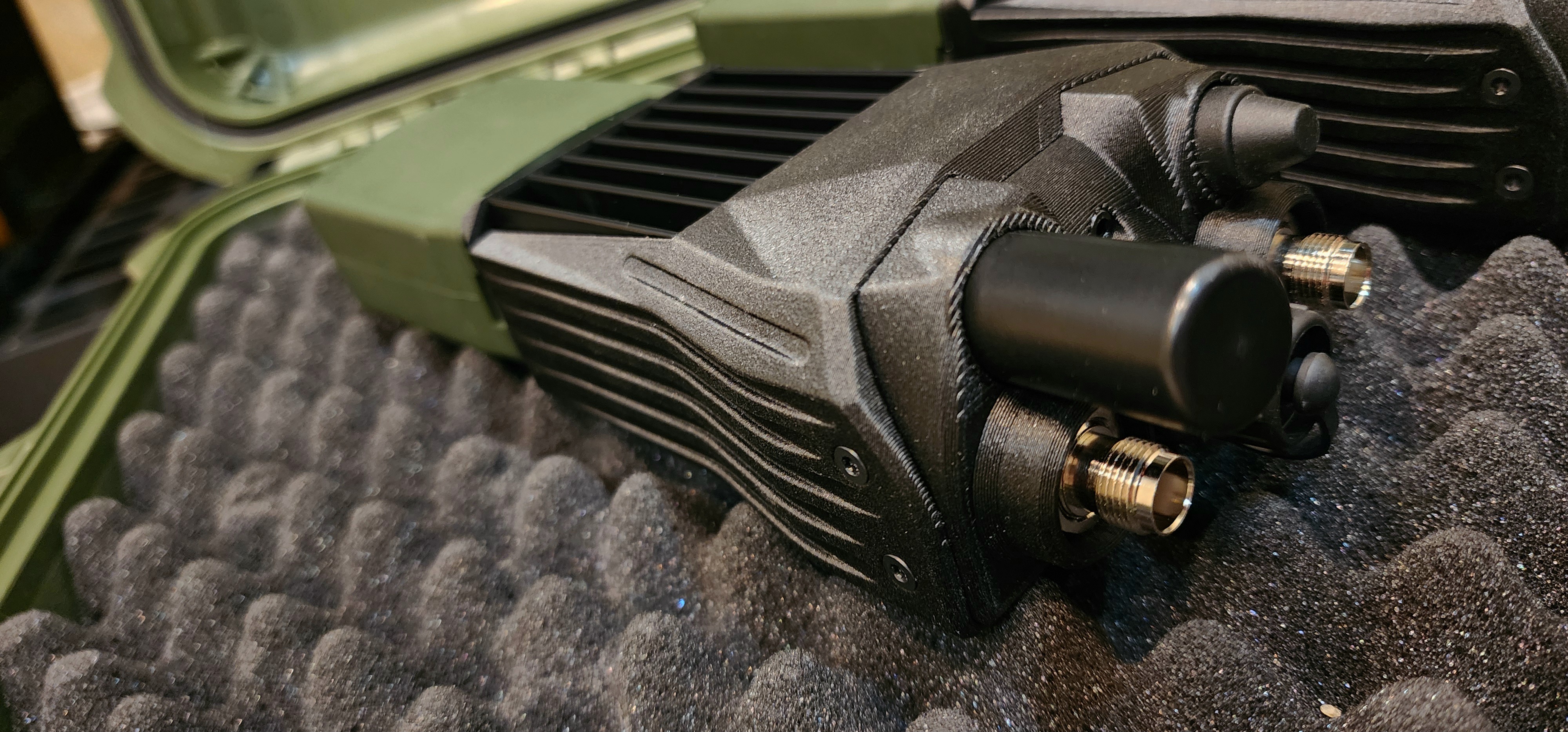

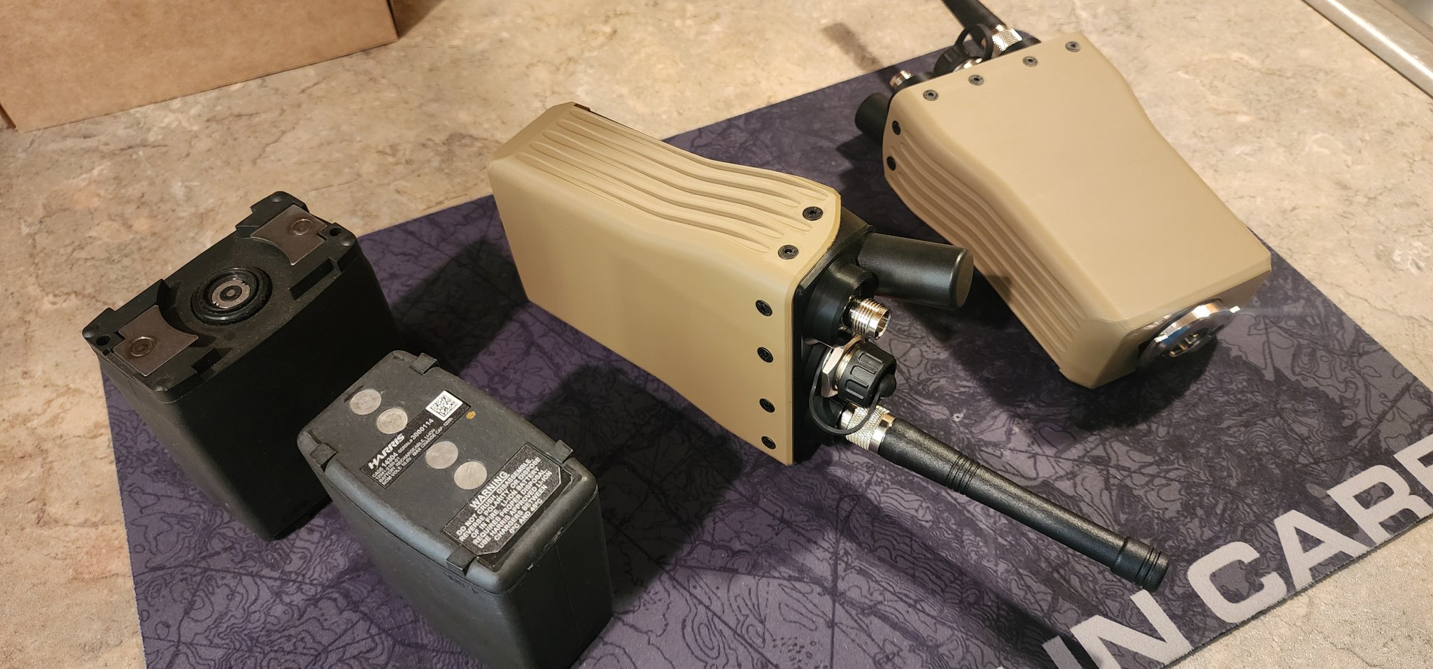

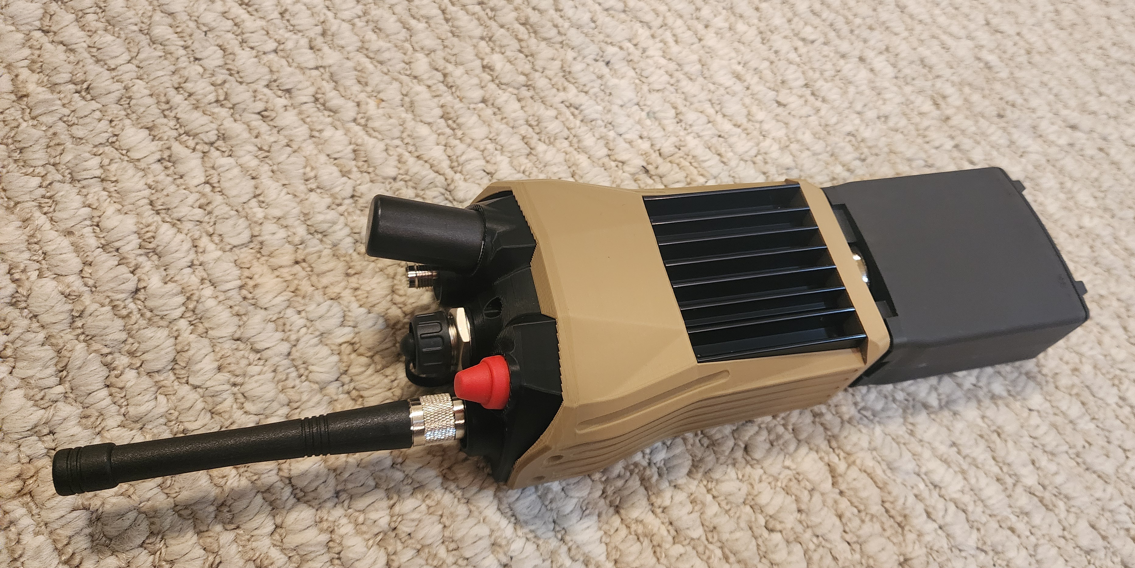

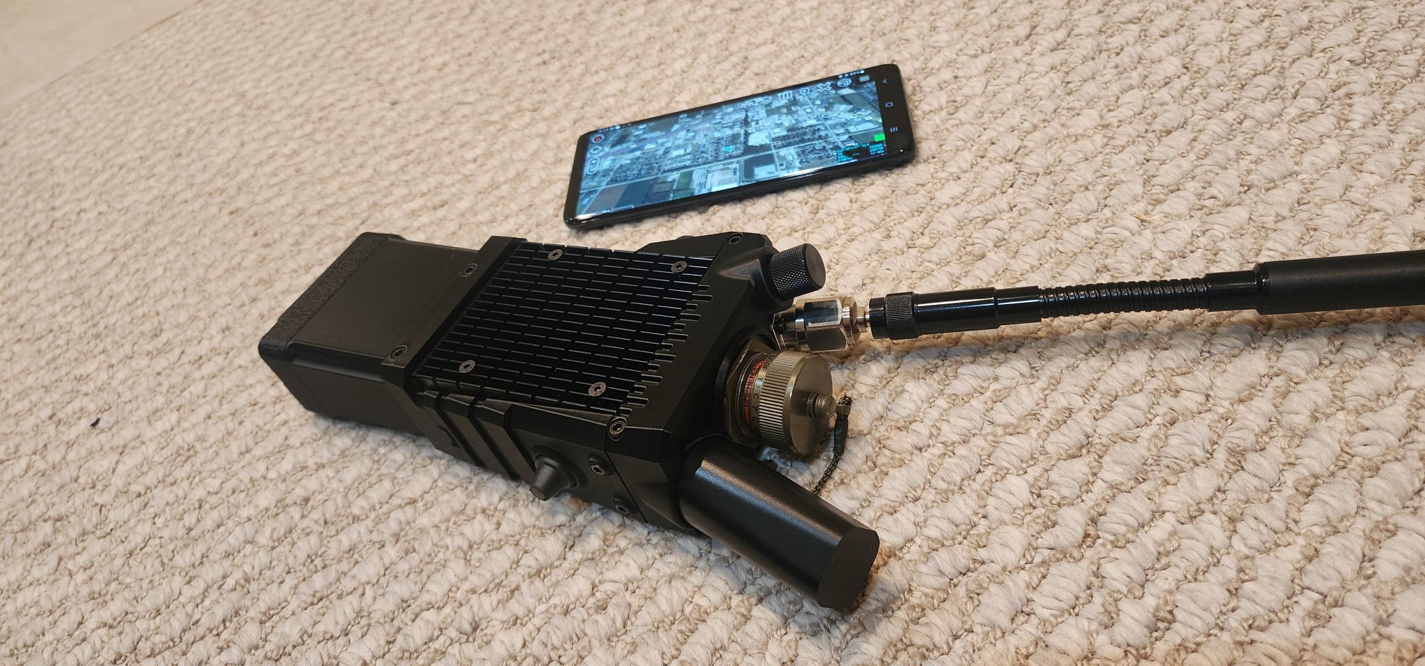

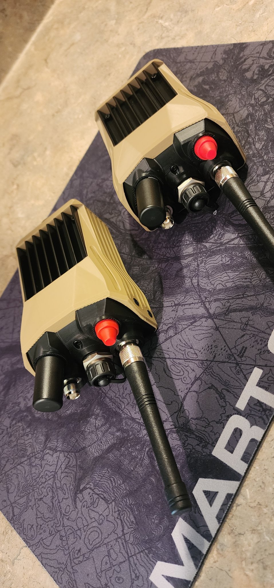

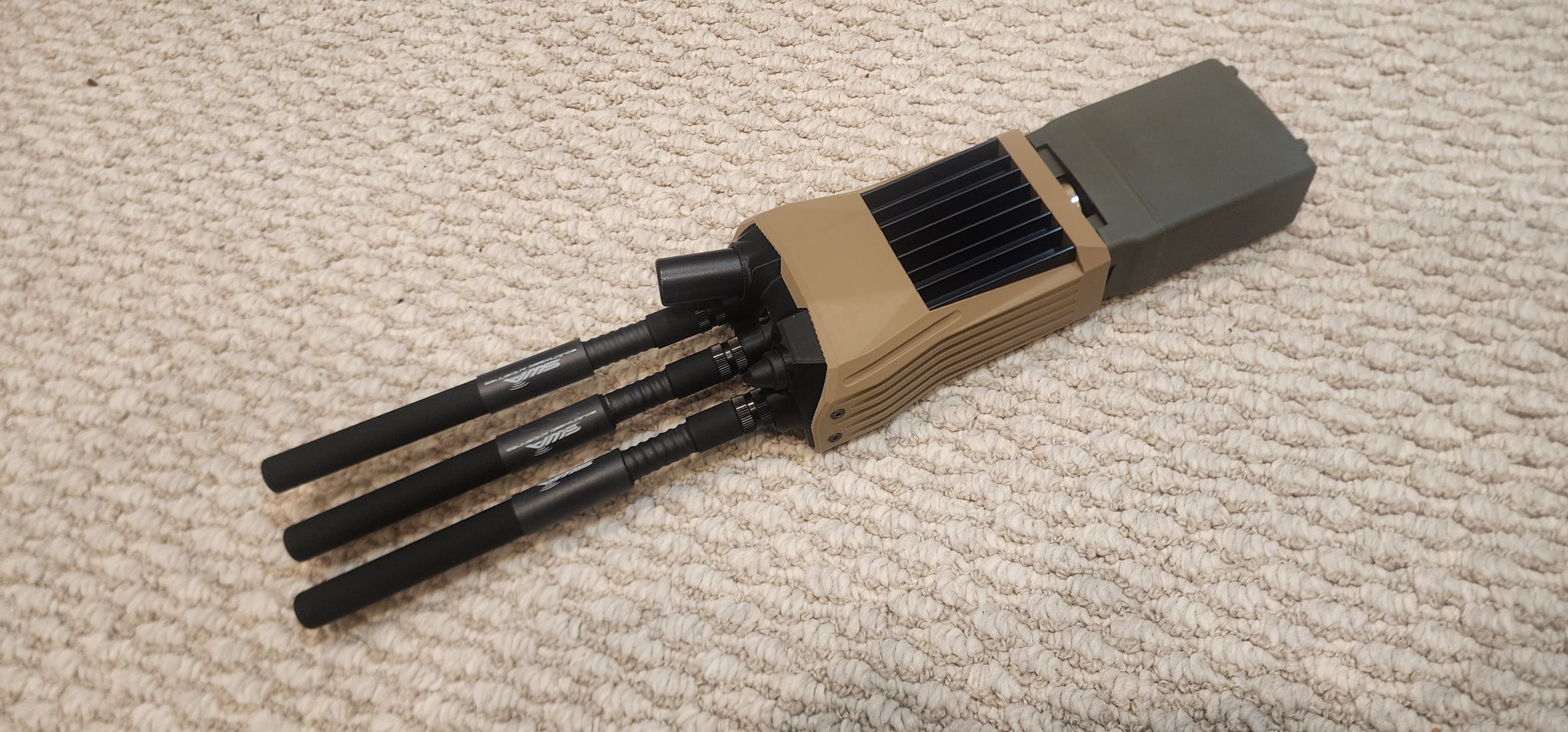

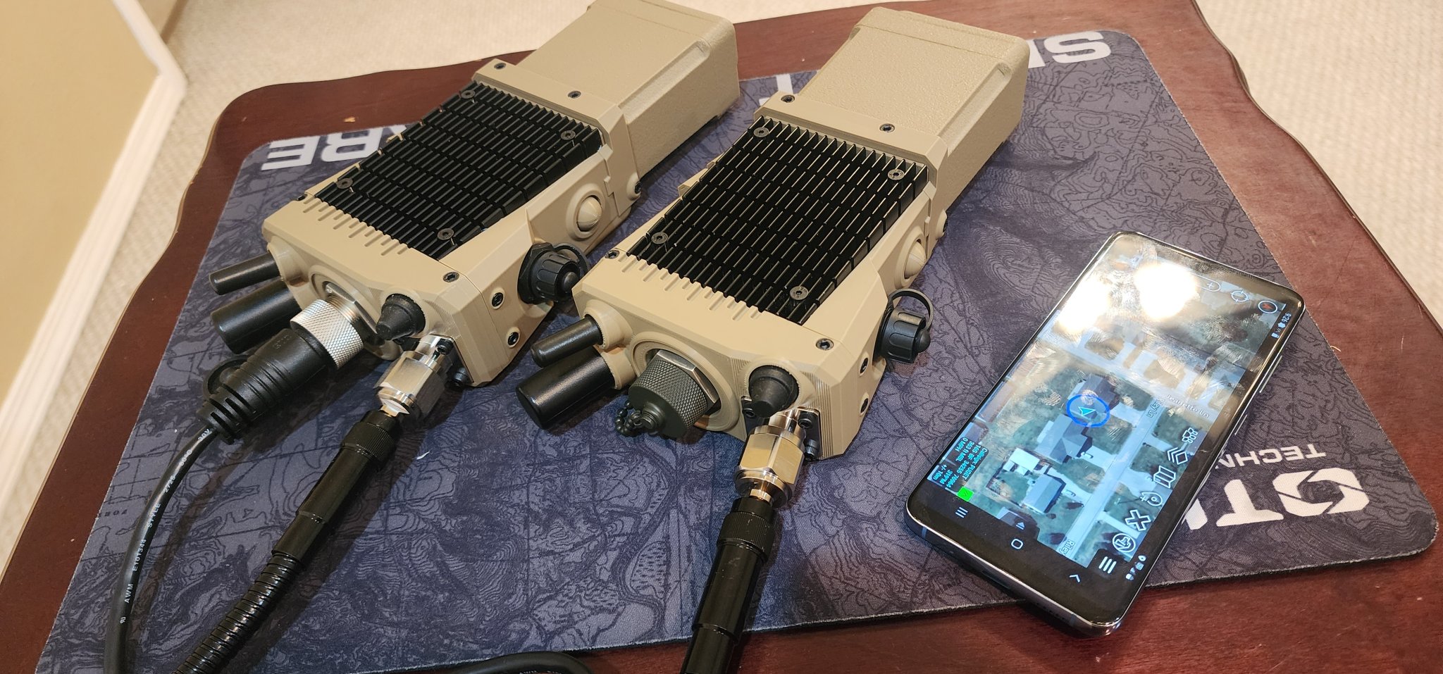

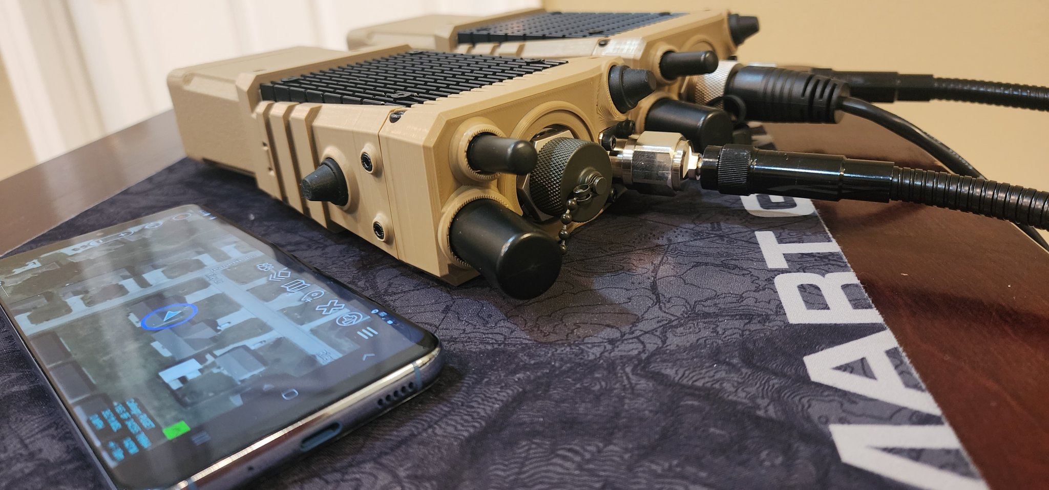

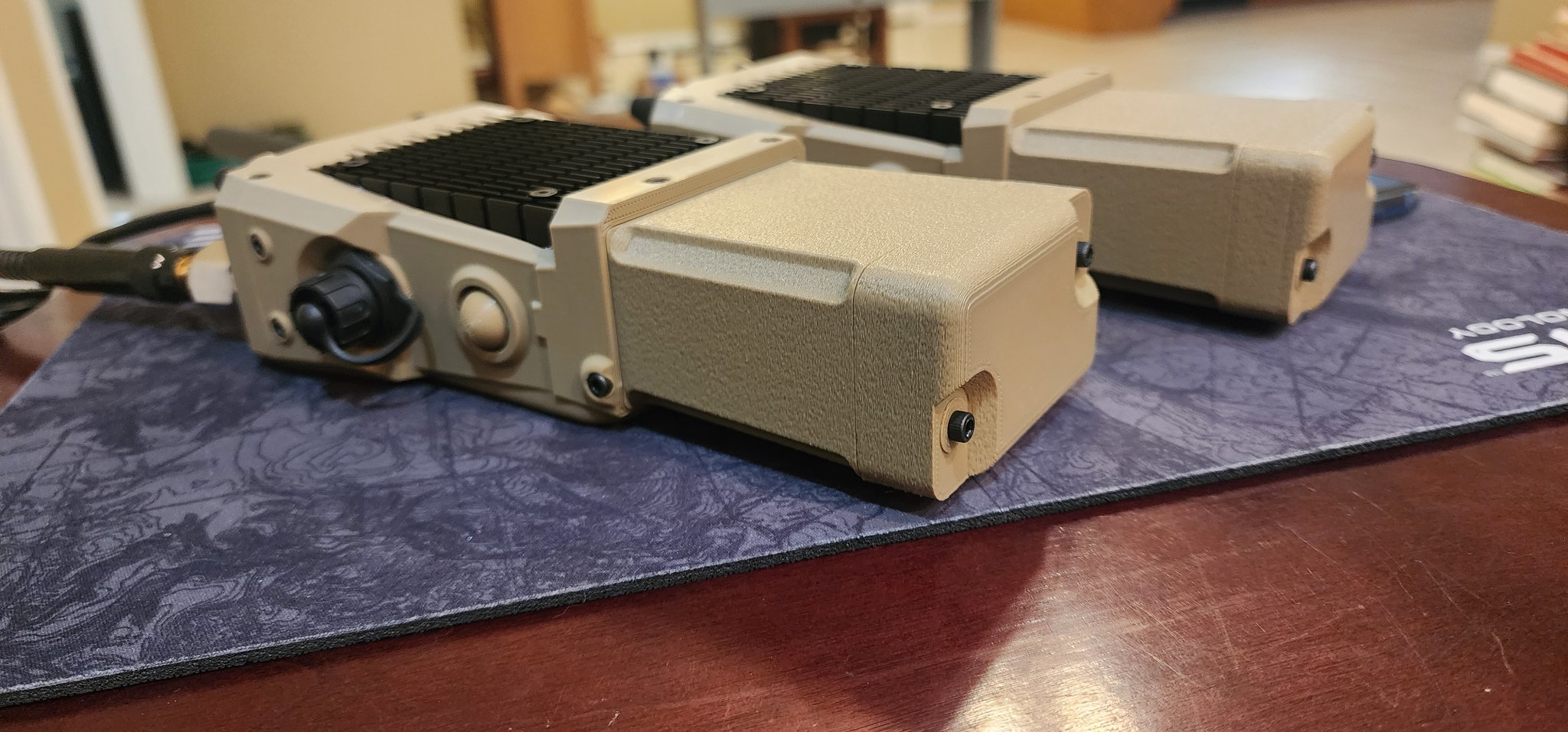

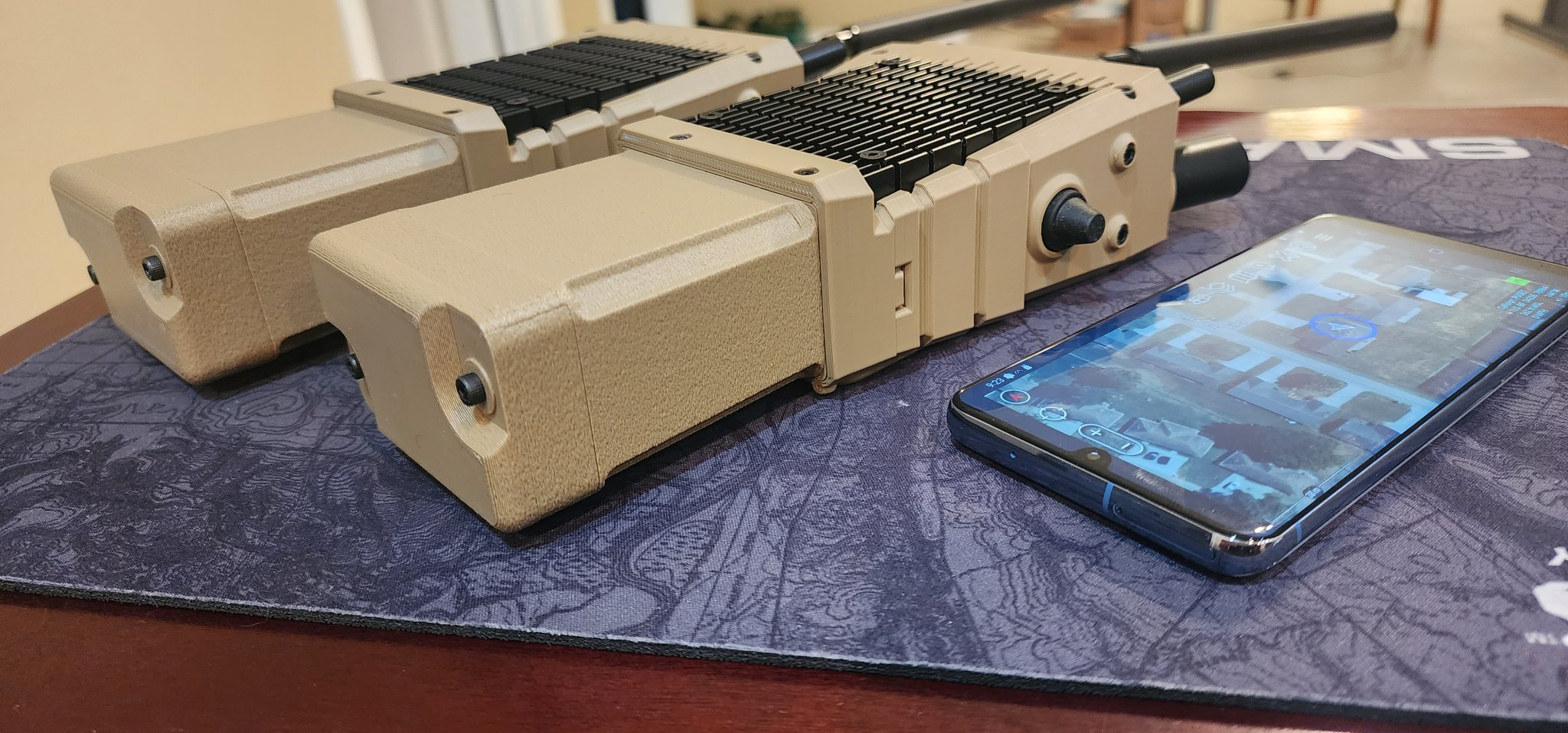

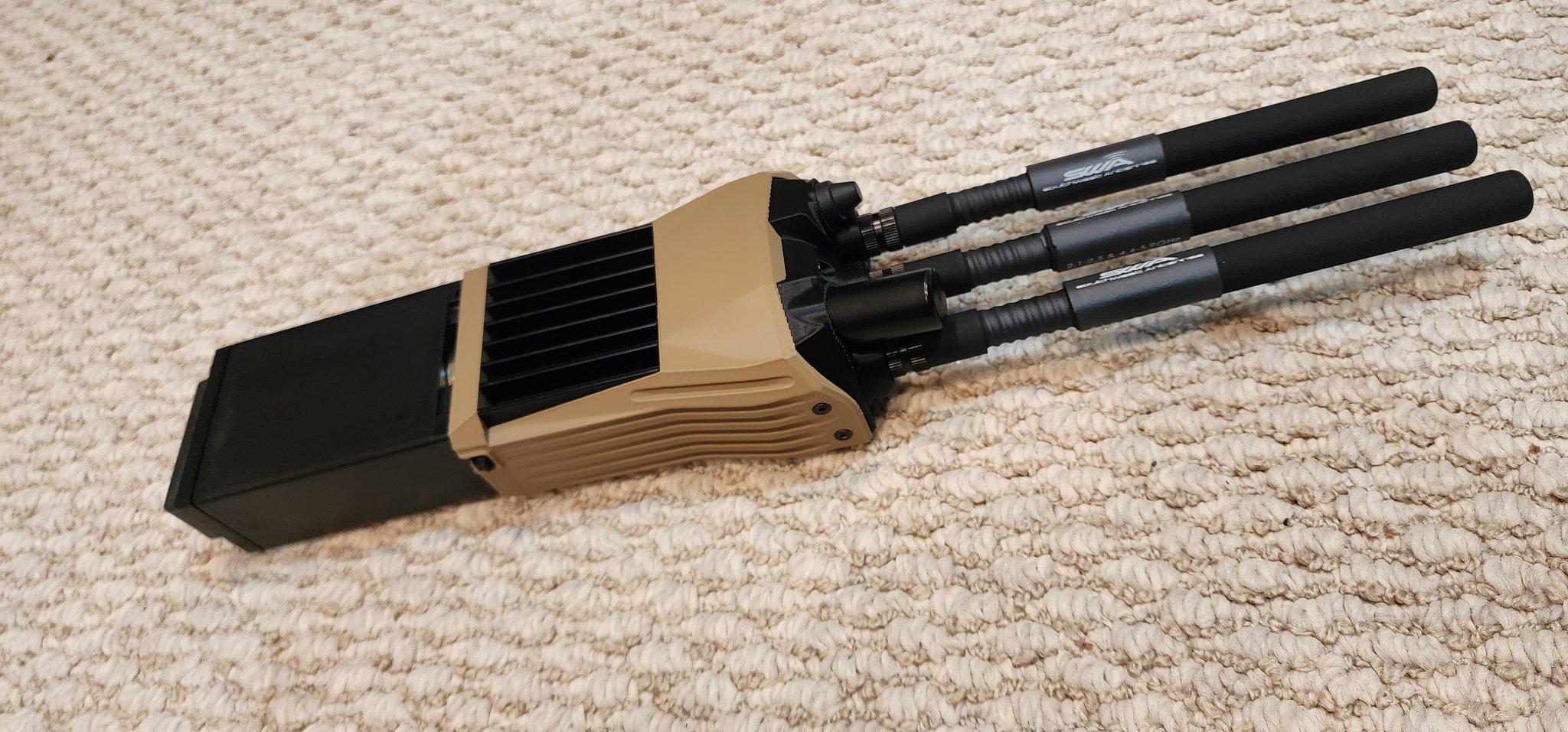

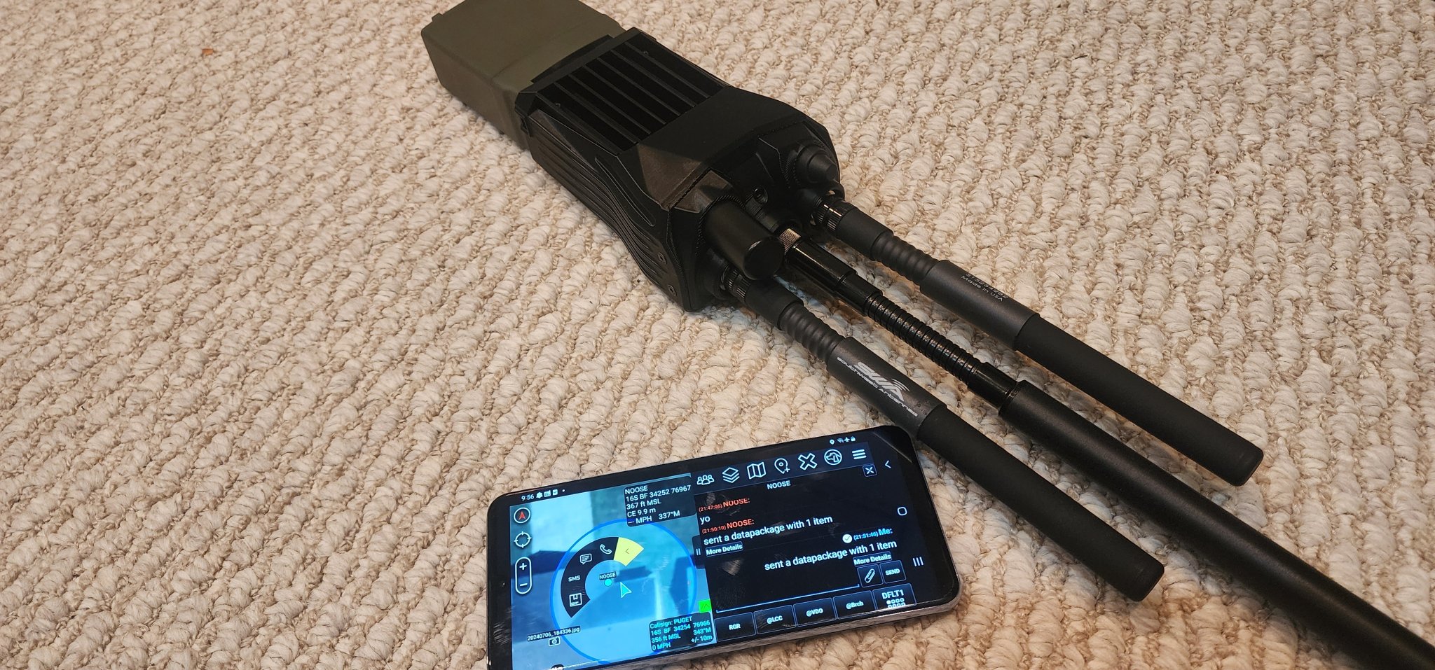

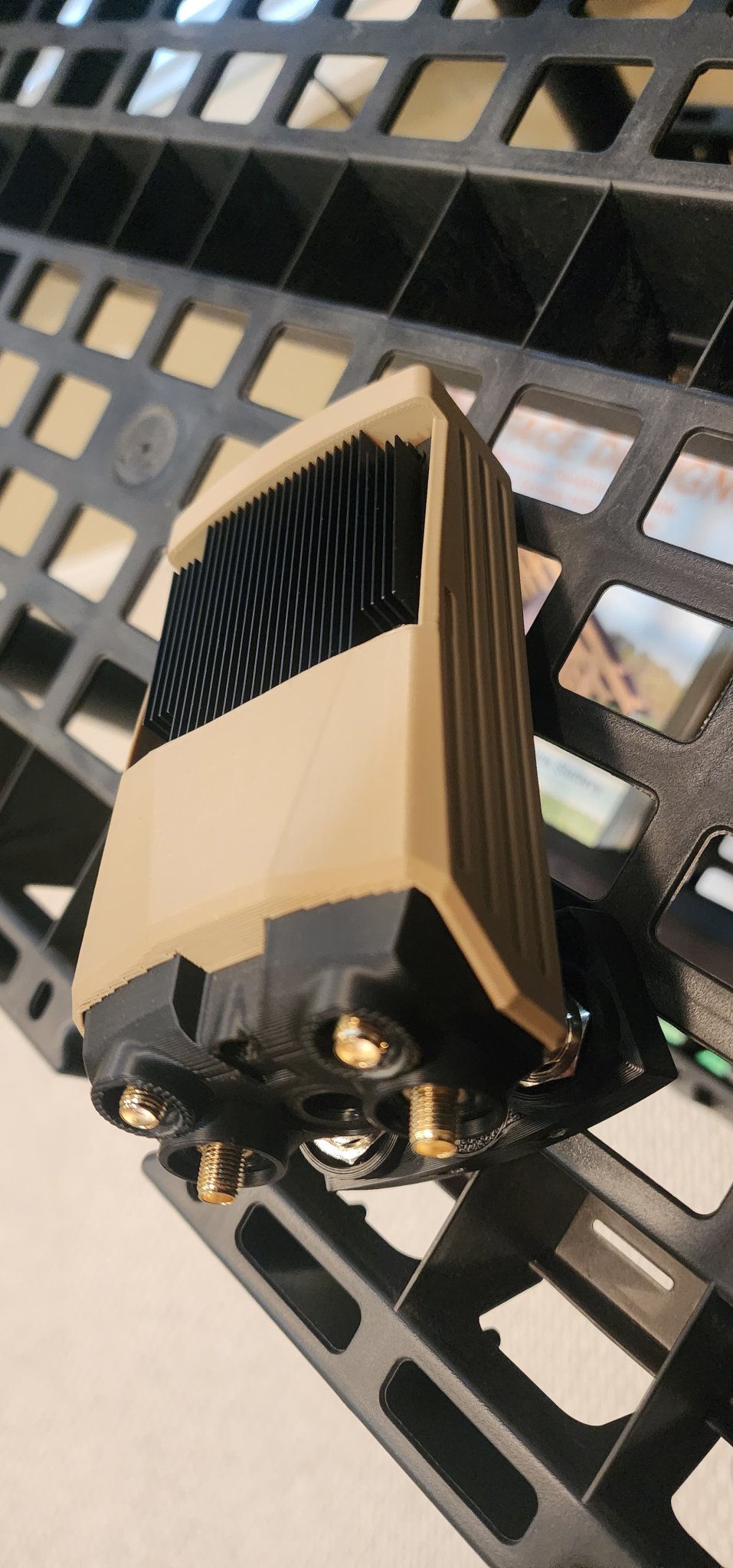

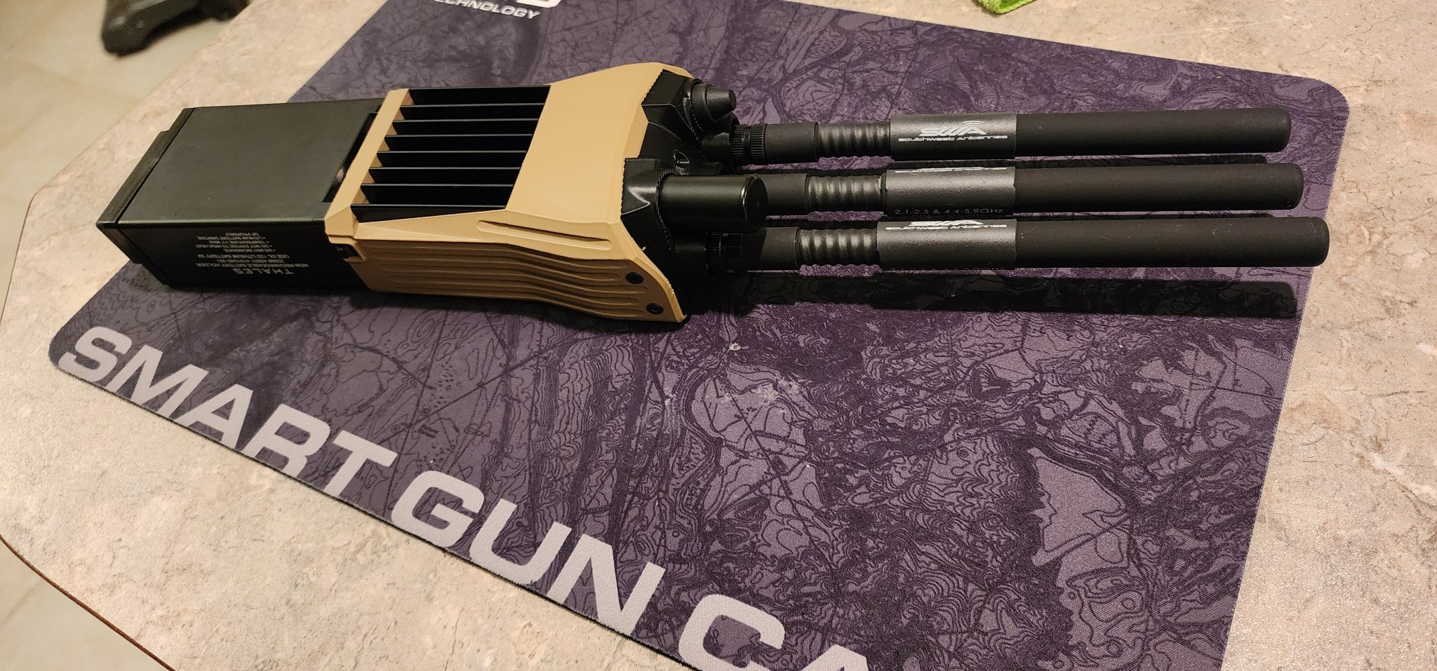

ATAK FDE version with External GPS and Bluetooth antenna. All high end certified parts and connectors.
Will soon have an upgrade for these that will have high power "encrypted" data; video, voice and text, off-grid maps.
These will push encrypted megabits not bytes being LoRa's limitations.
Streaming hd video, voice won't be over low power Lora/Meshtastic so the range and clarity will be excellent and range will not be limited. I would like to keep the Lora meshtastic setup, not necessary but for fun and redundancy. Theyll work simultaneously.
Range on the streaming video, voice, data etc will be typical range of previous devices but with 30-50 mile range do-able with clear line of and proper solar repeating nodes in place to alleviate interference from obstructions or foliage if need be. I'm working on a 100 mile setup currently. These will work in ATAK as usual. You could prob play games with each other on your smartphones during the apocalypse if you wanted.
650 per device for basic Lora Meshtastic setup as pictured. External GPS is an additional 100. The IP mesh upgrade with Streaming video, voice, chat etc will be additional $200. Obviously I could ask for way more but that's not my goal.
I have a USB connector option for the military grade Amphenol socaplex ratcheting USB setup for charging the EUD smartphone device; utilizing the 18650 power bank. But they run $200. Not necessary but an option for anyone wanting to go all out.
These radios are designed for the N type mil spec goosneck antennas but they do run around 250-$350 at a few places online. I can direct you to those sources if you want to purchase them. I can't afford to have many of those laying around at the moment.
I include a SMA gooseneck antenna and adapter that works perfectly fine. But know the option is there.
These will have an upgrade to the 18650 battery bank for quick change if you don't want to mess with swapping them out individually.
I do have them designed and setup for the expensive stuff. My goal is provide everyone with top knotch quality thats actually affordable but with the option to go all out like we do with our rifles.
These aren't cheap to make so I don't have tons of parts to have many of these on hand ready to sell. I currently have to fulfill requests until that's possible. Just shoot me a message if interested.

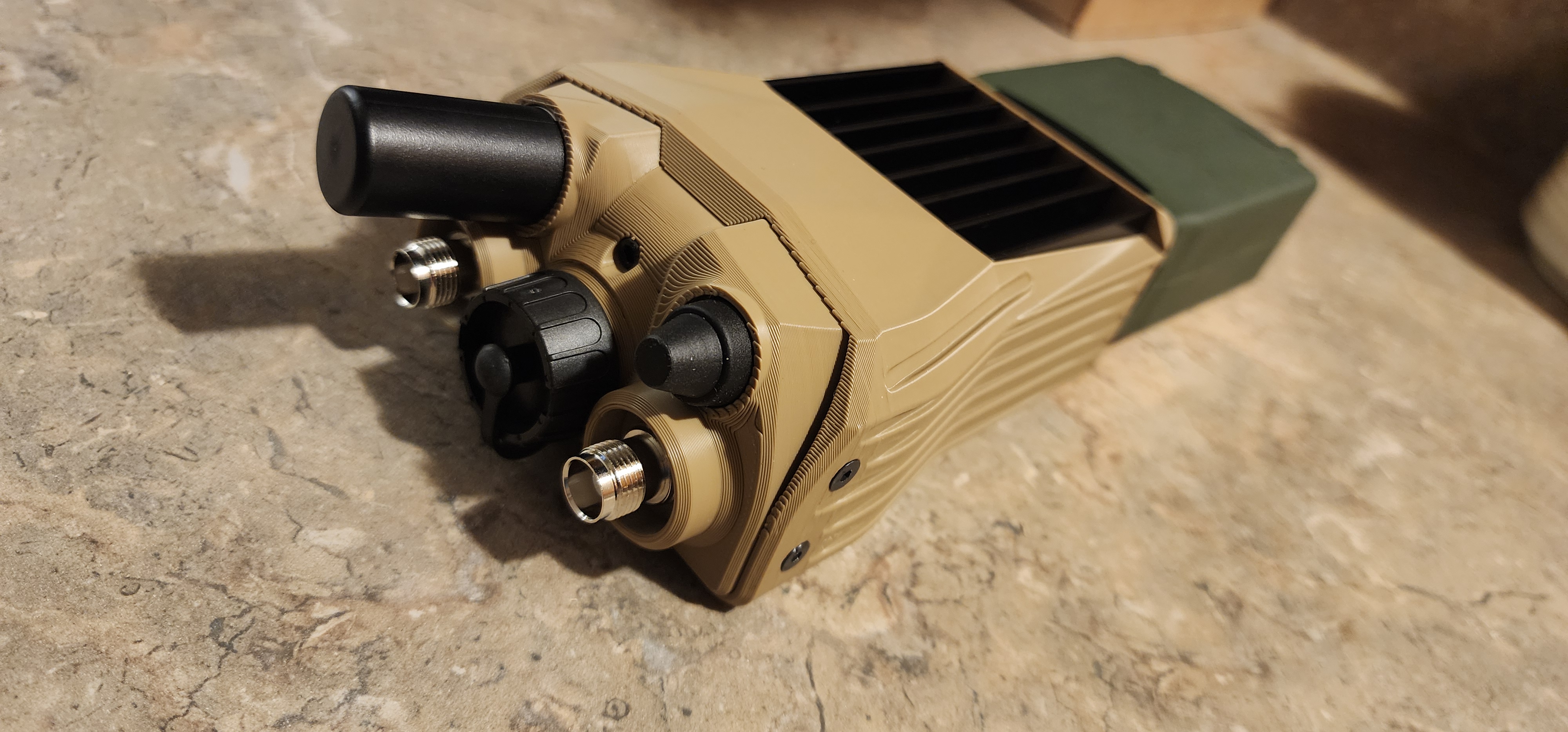

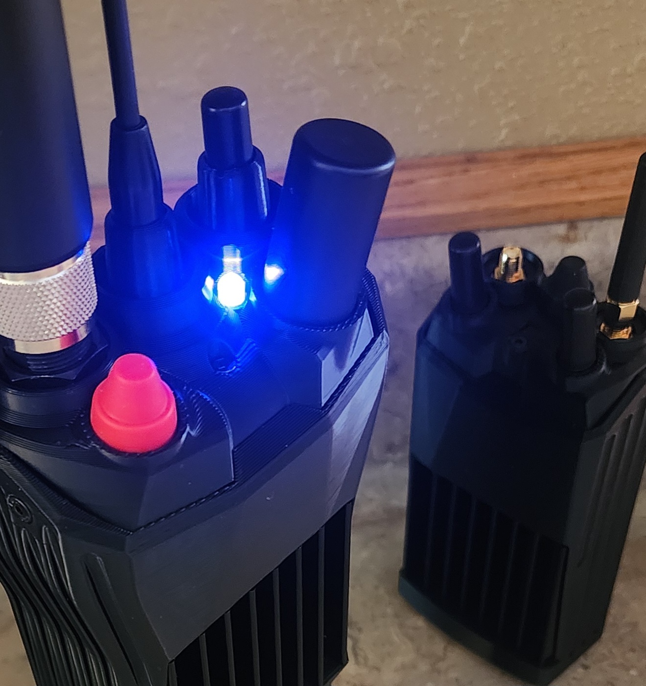

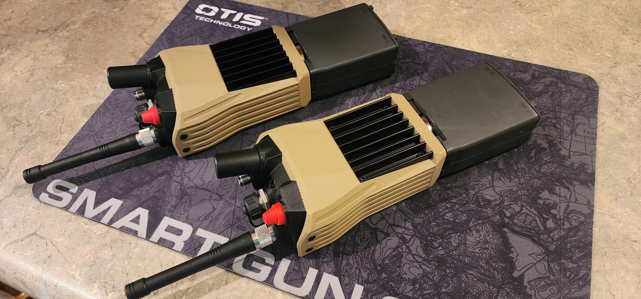

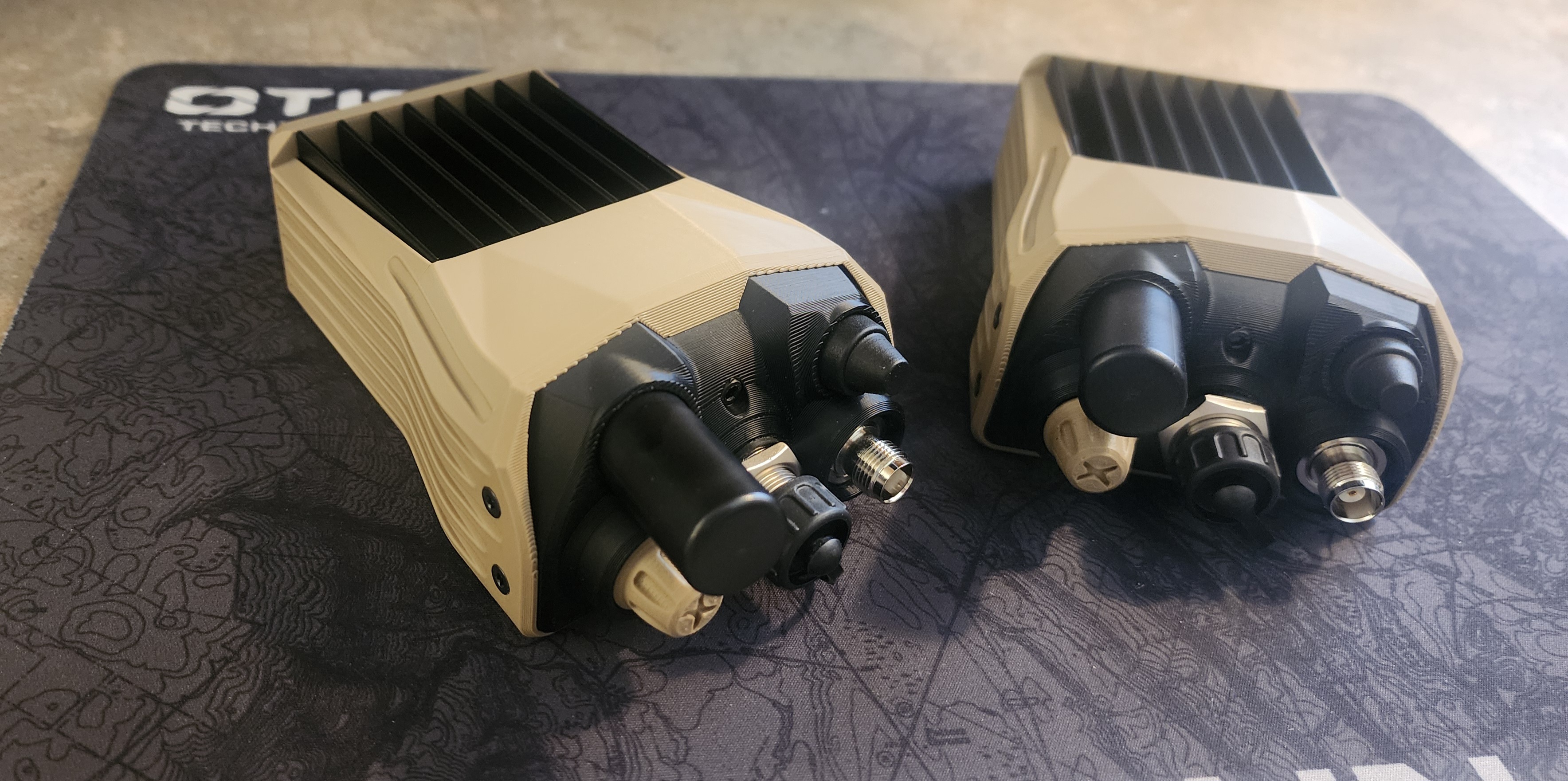

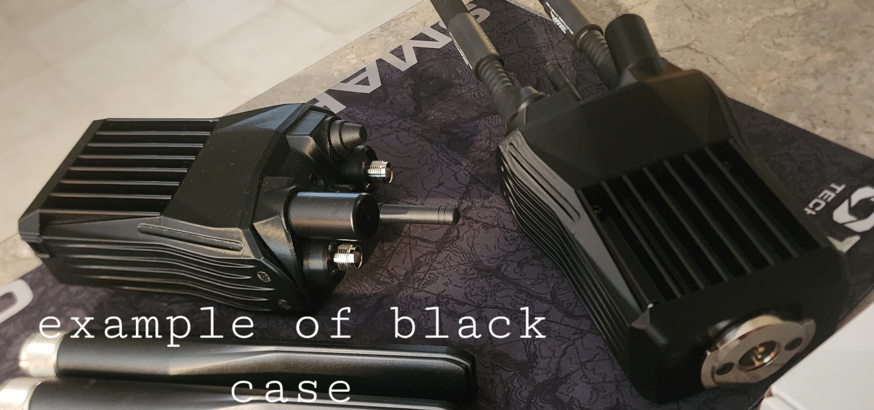

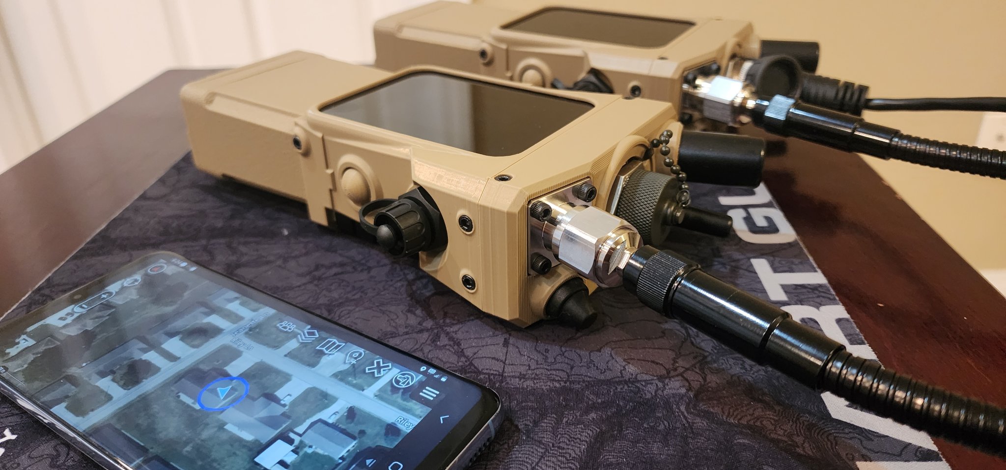

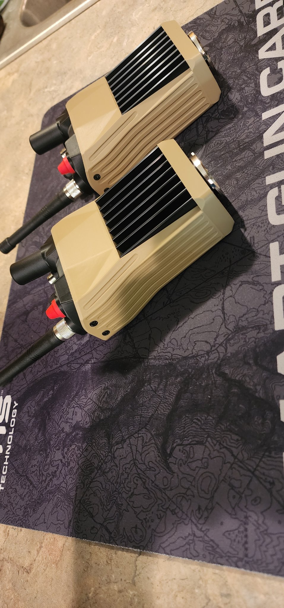

Blacked out Lora/Meshtastic version with External GPS and the Amphenol Socaplex USBFTV EUD 5v power hub, wired to power all Apple devices as well. Amphenol ip68 Switches etc. 14k mah Molicel p28a 18650 swappable power bank. Redundant Touchscreen. And Samsung S20 running meshtastic and ATAK connected to radio via Bluetooth.
Reactions: banks74
I haven't the slightest idea what any of that is or does or how it works but it's damn awesome
Thank you 😎 I appreciate your comment. This made me realize I need to sit down and think of a way to explain these; and show how simple they actually can be to use.

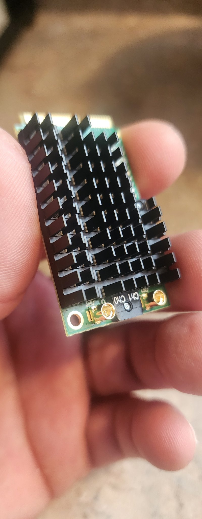

Within the next week, the new boards should arrive; which will allow these to have streaming video, voice and chat capability. Fully encrypted. Off-grid. That will probably be the easiest time to do the full blown breakdown.

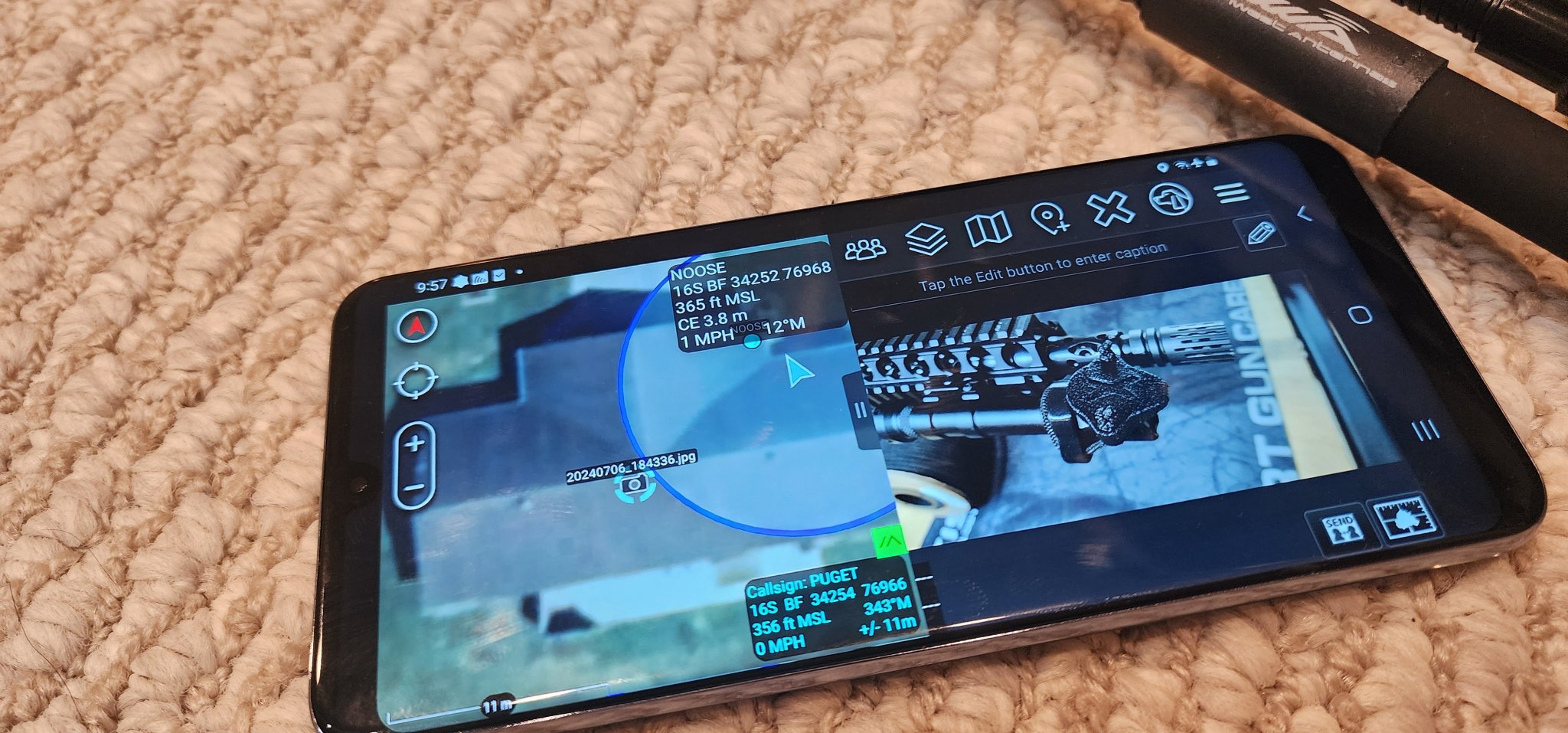

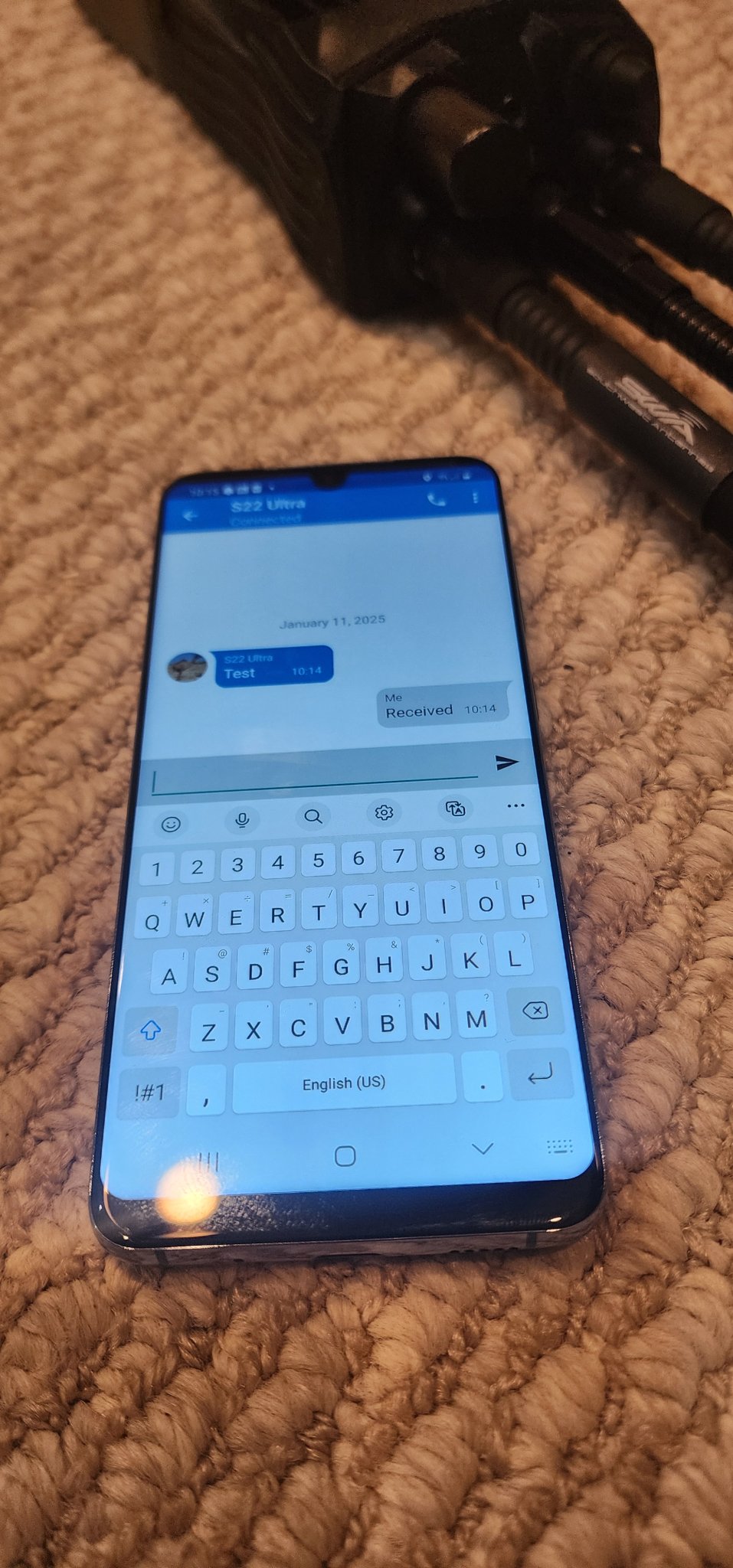

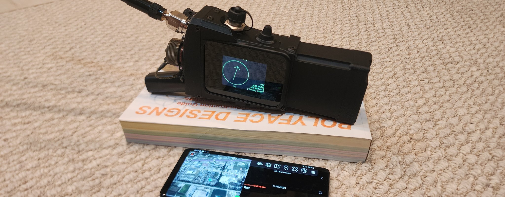

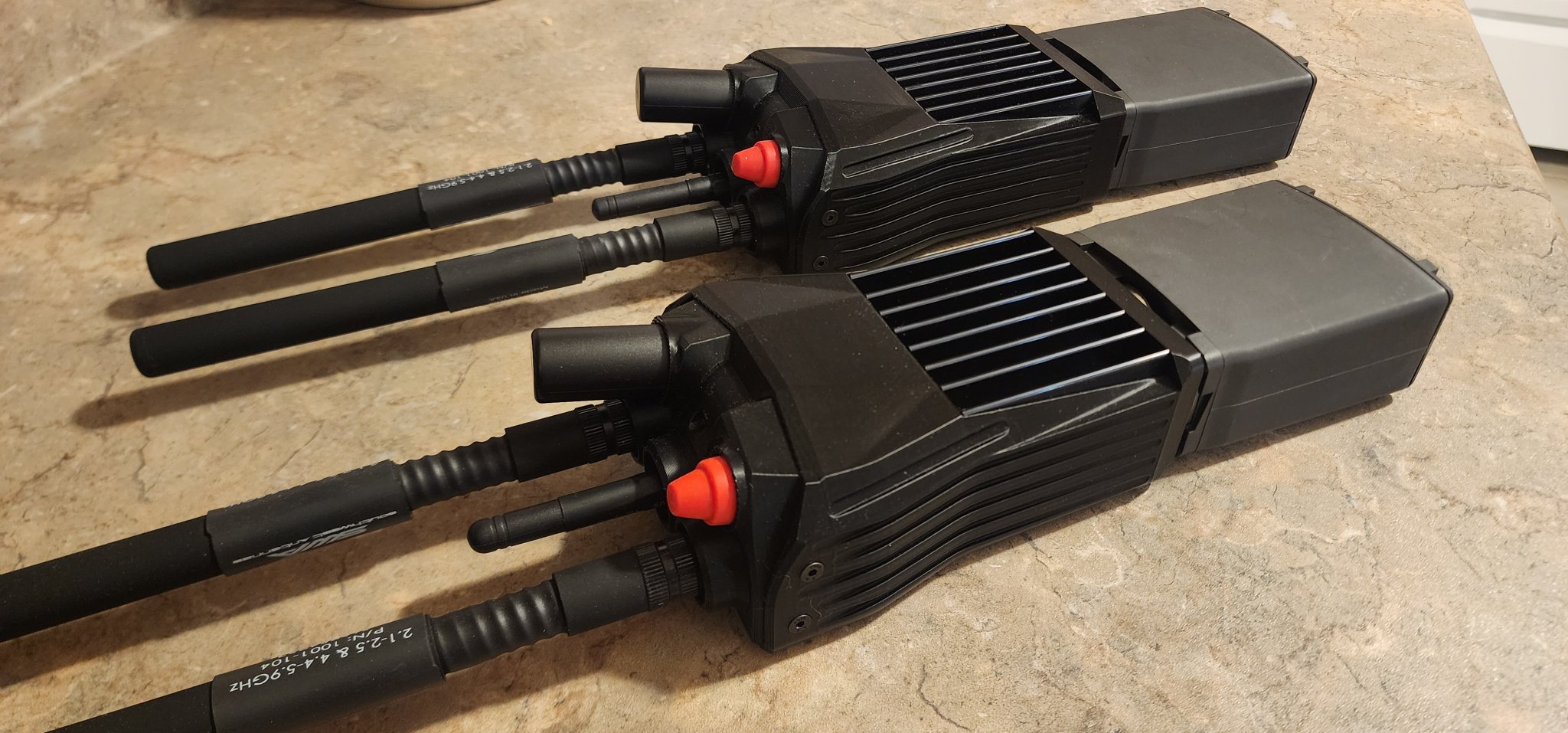

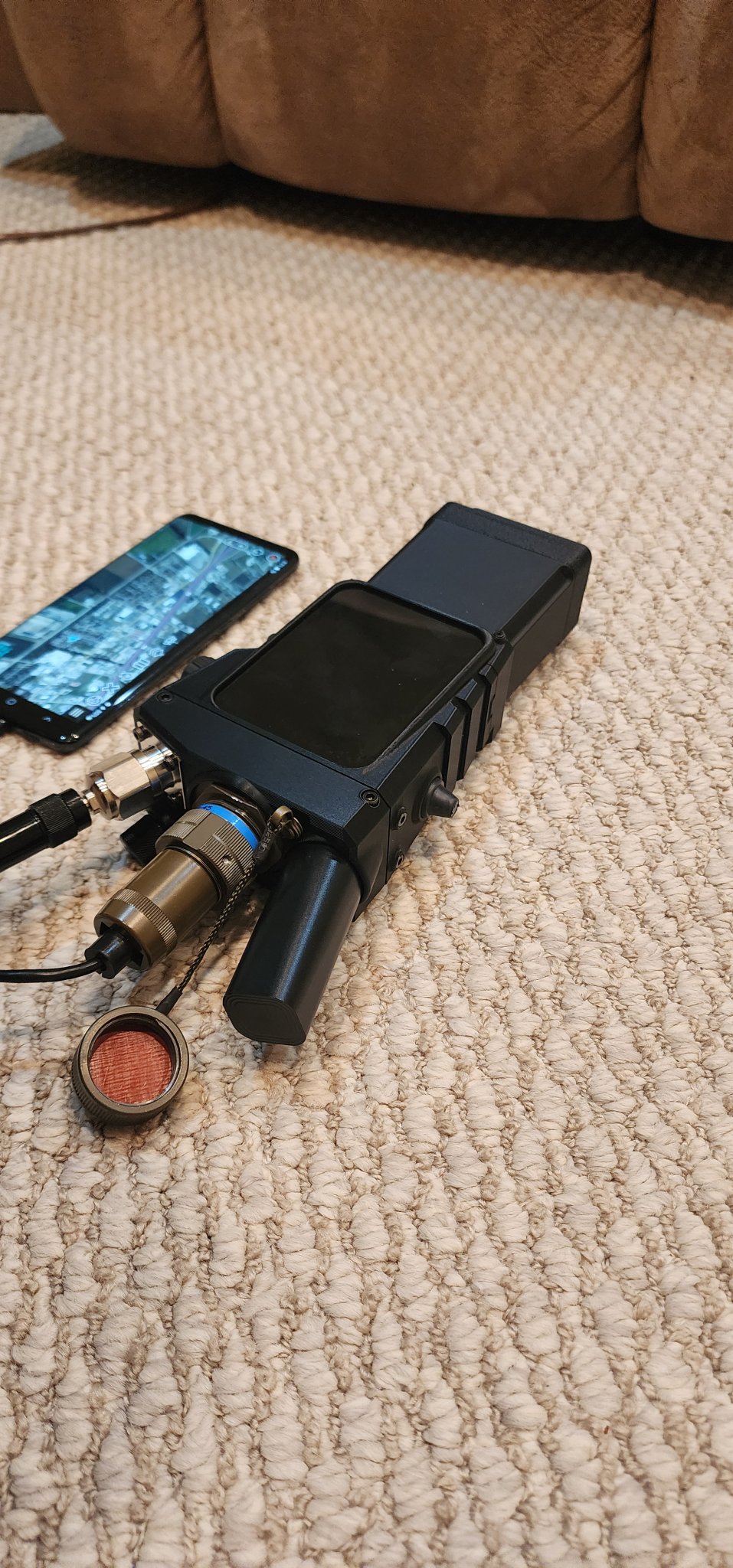

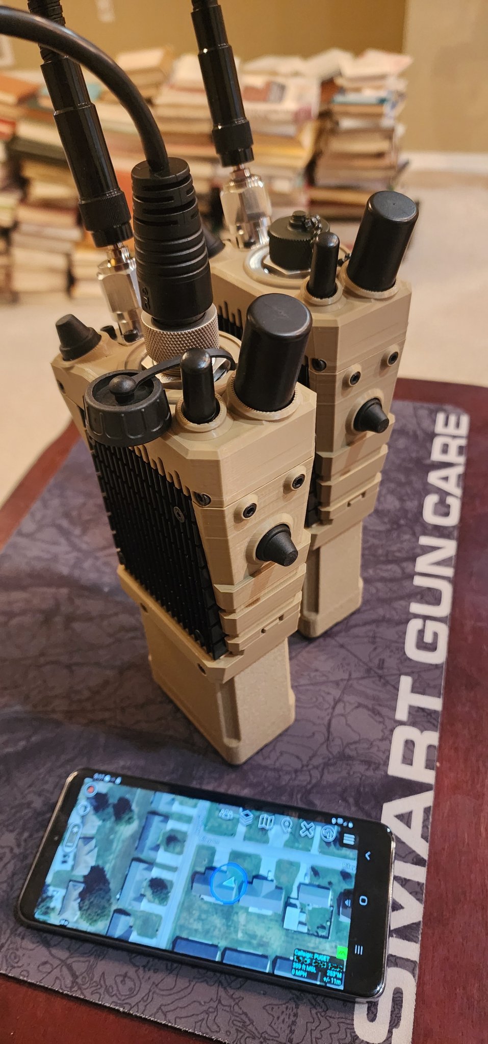

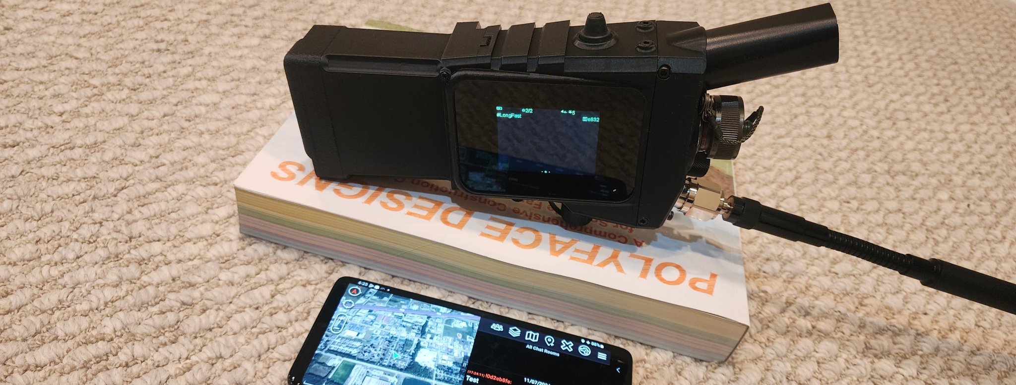

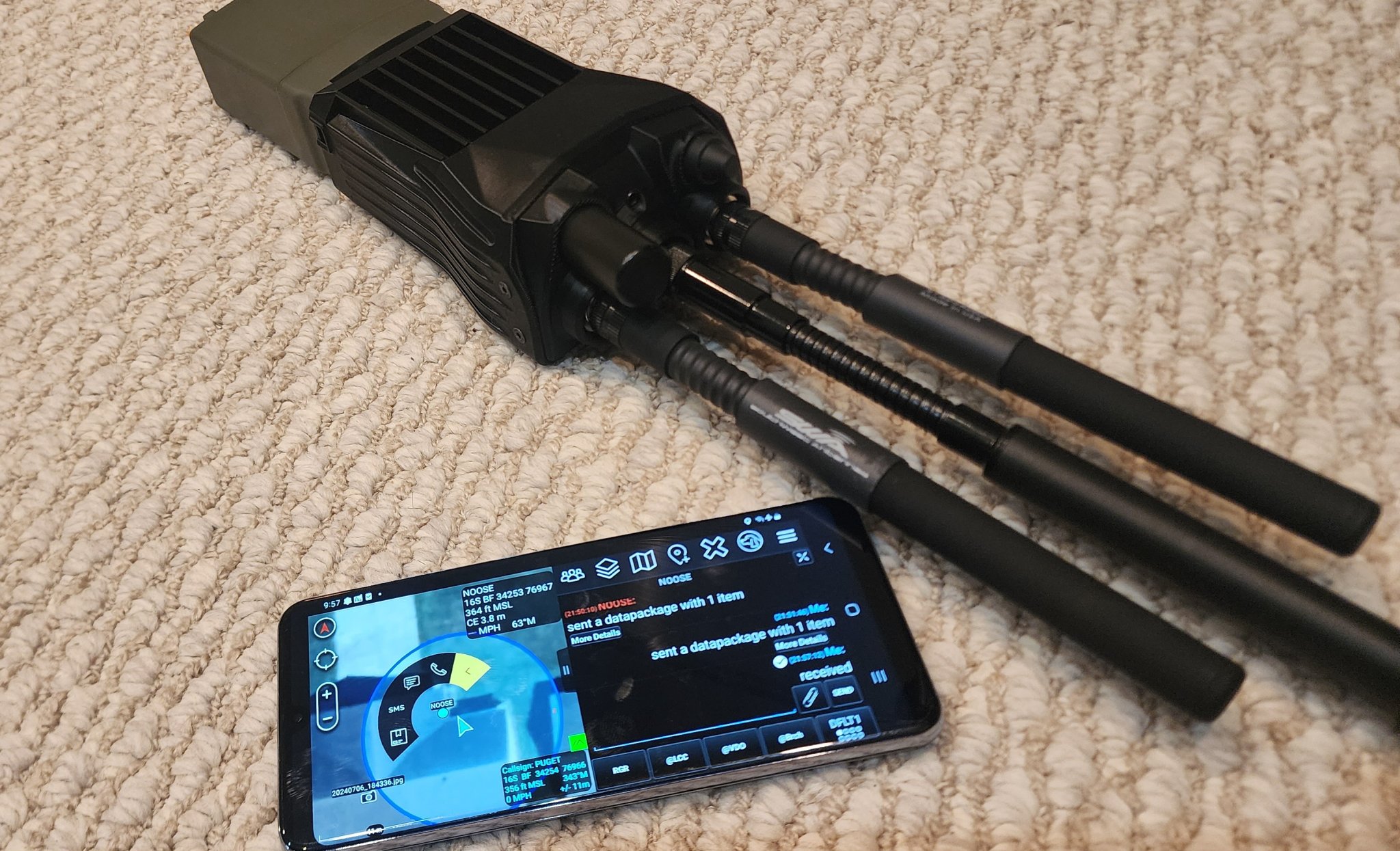

Update:

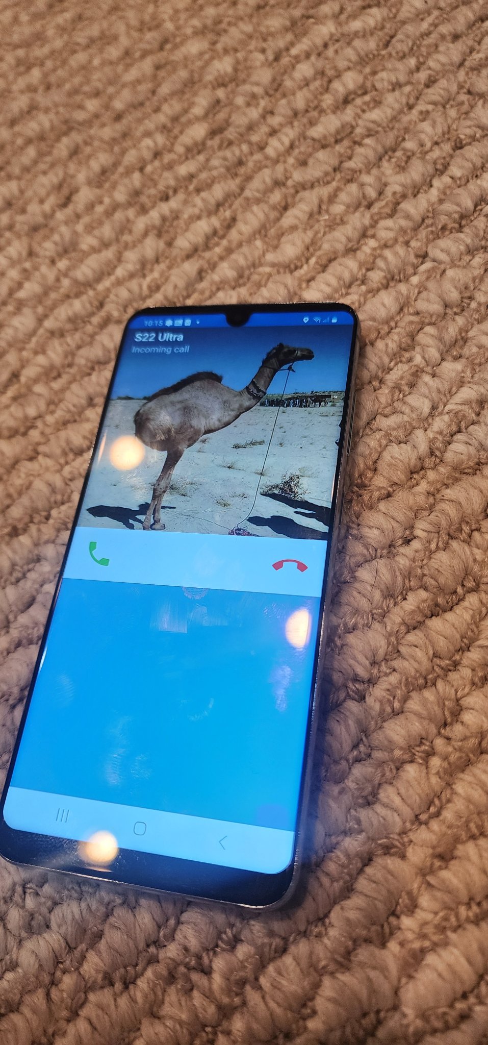

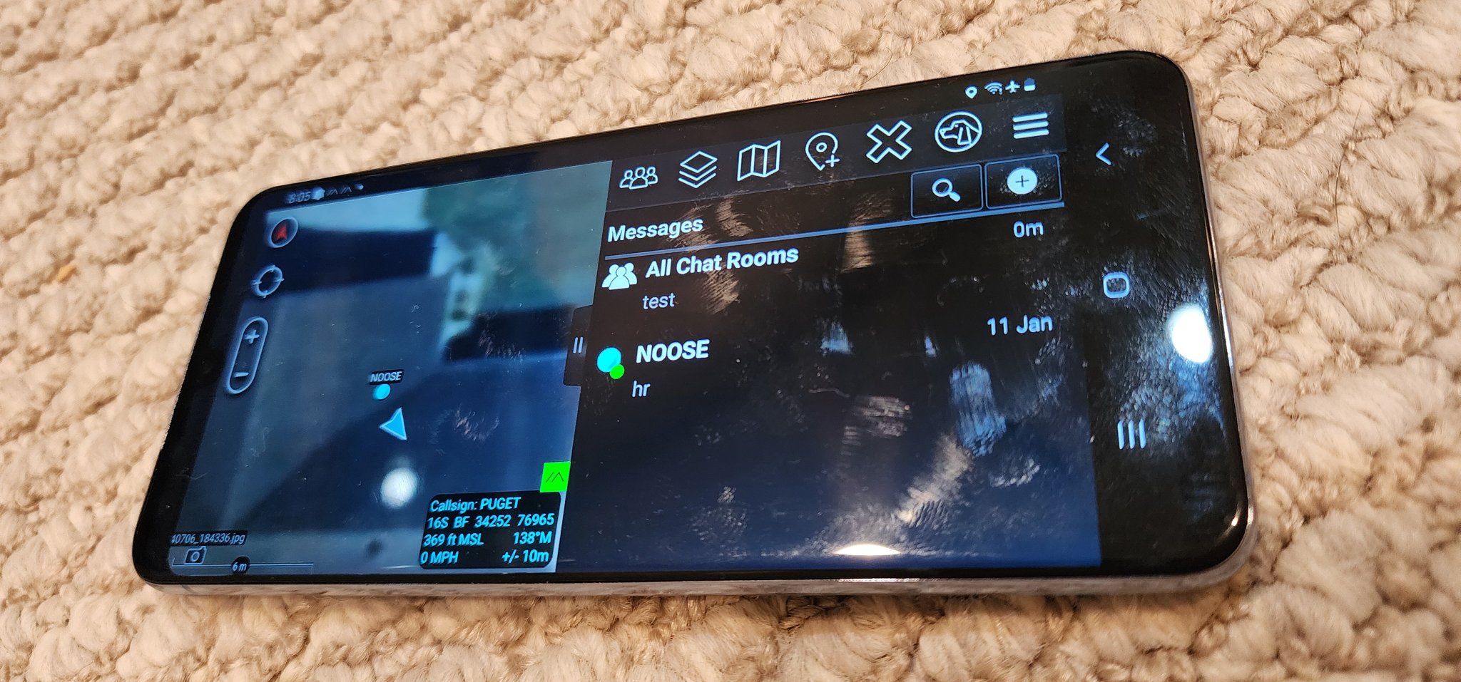

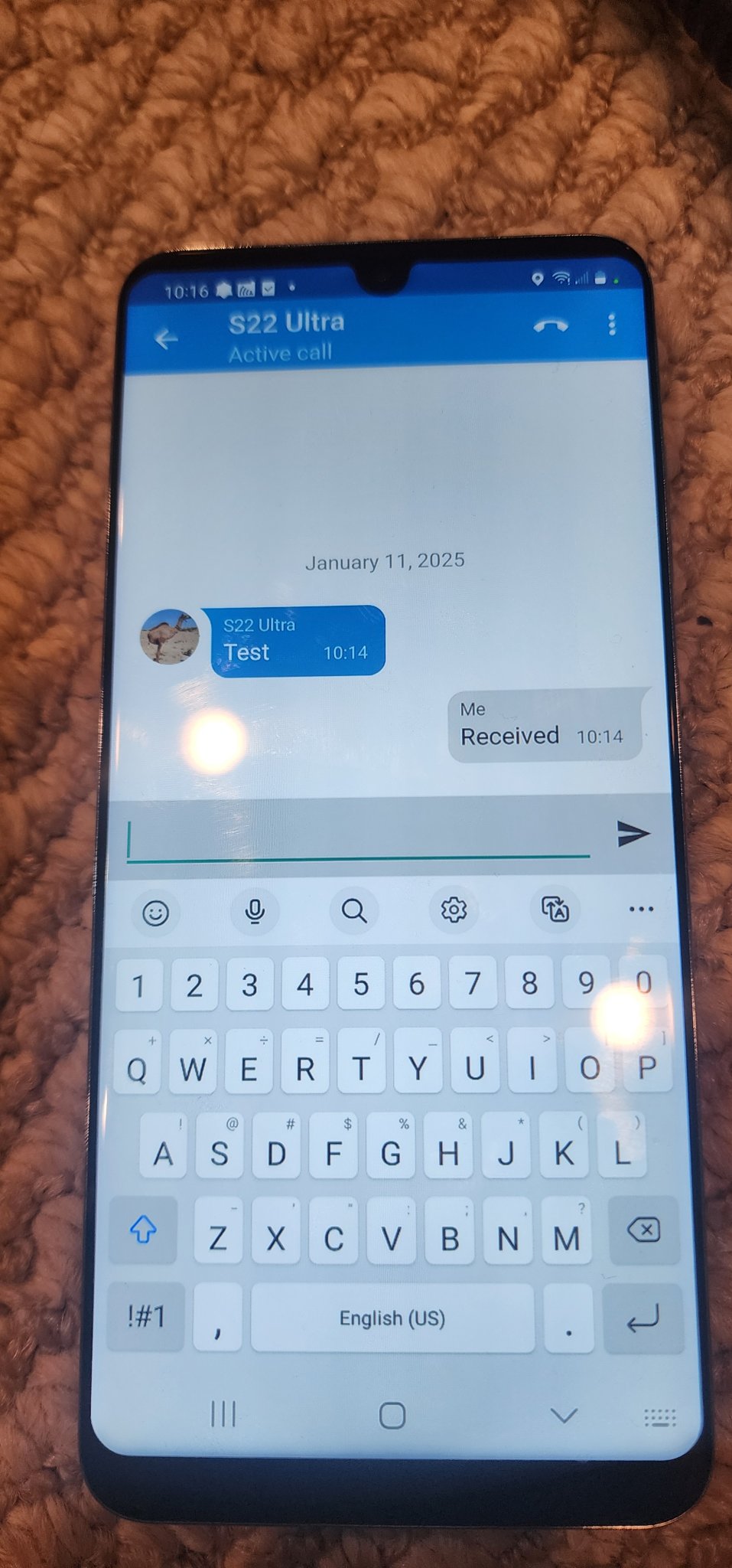

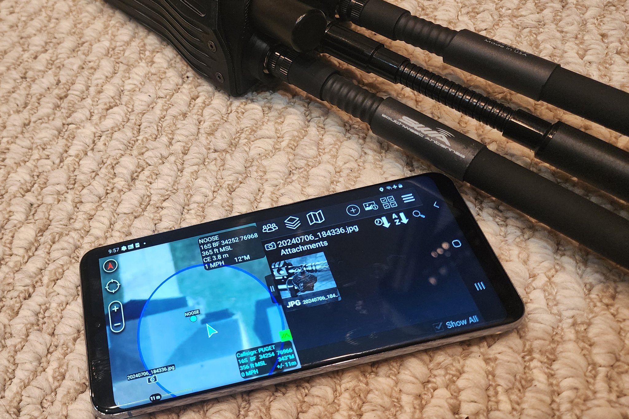

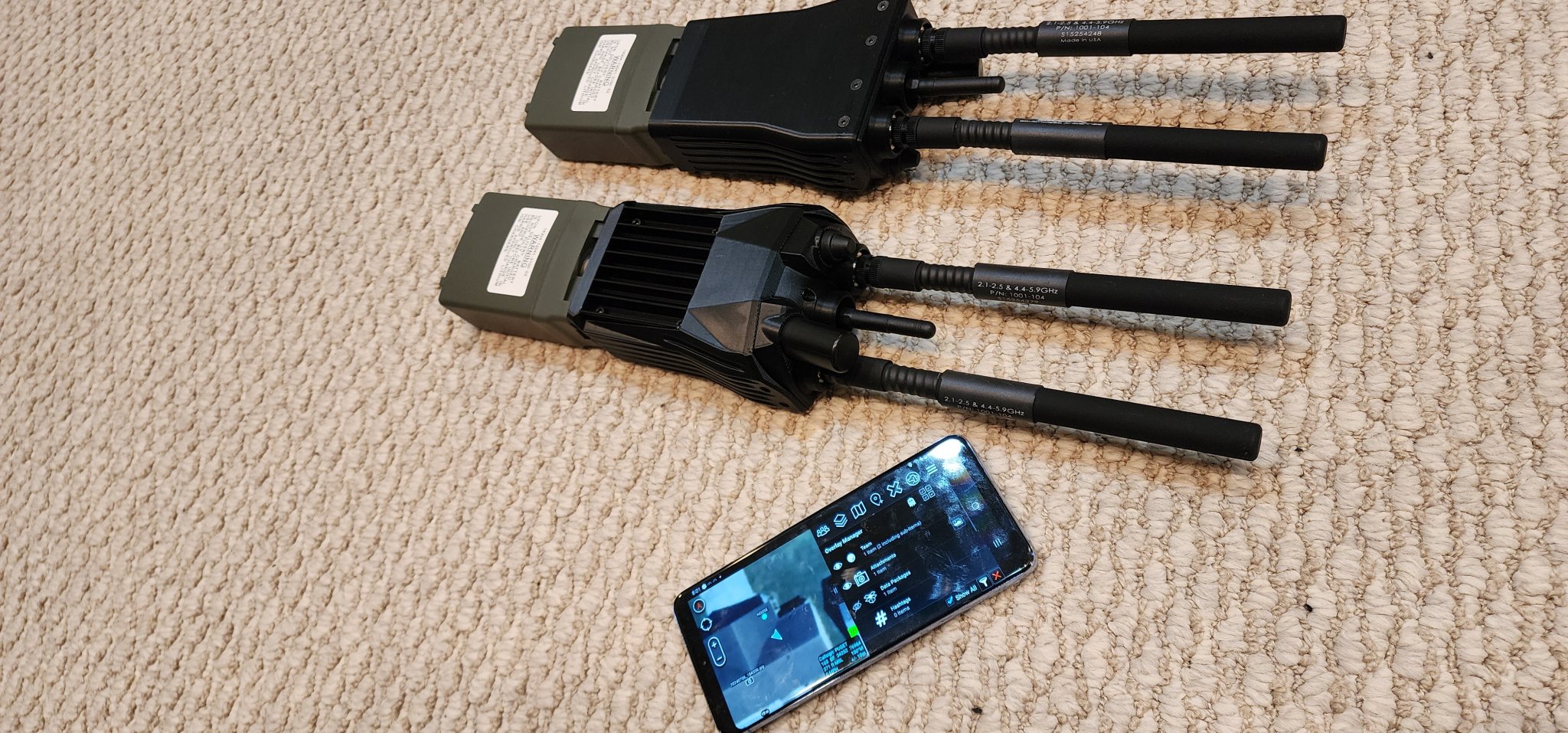

When any smart device ( ATAK app installed) is connected to the encrypted network of these mesh radios; they will automatically sync with ATAK. ATAK will sense this and give full multicast functionality. I did not have to make a single settings change in ATAK , the GPS and device becons populated and I could instantly chat, send files and high res images. There is a push to talk plugin for ATAK to setup voice comms I haven't tinkered with.
I downloaded a simple offline communication app that allows the typical hd voice calling and messaging to any device that connected to mesh radio. Video calling would work the same. Literally takes zero user experience.
You can connect IP cameras to these radios, drones supplying video feed etc.

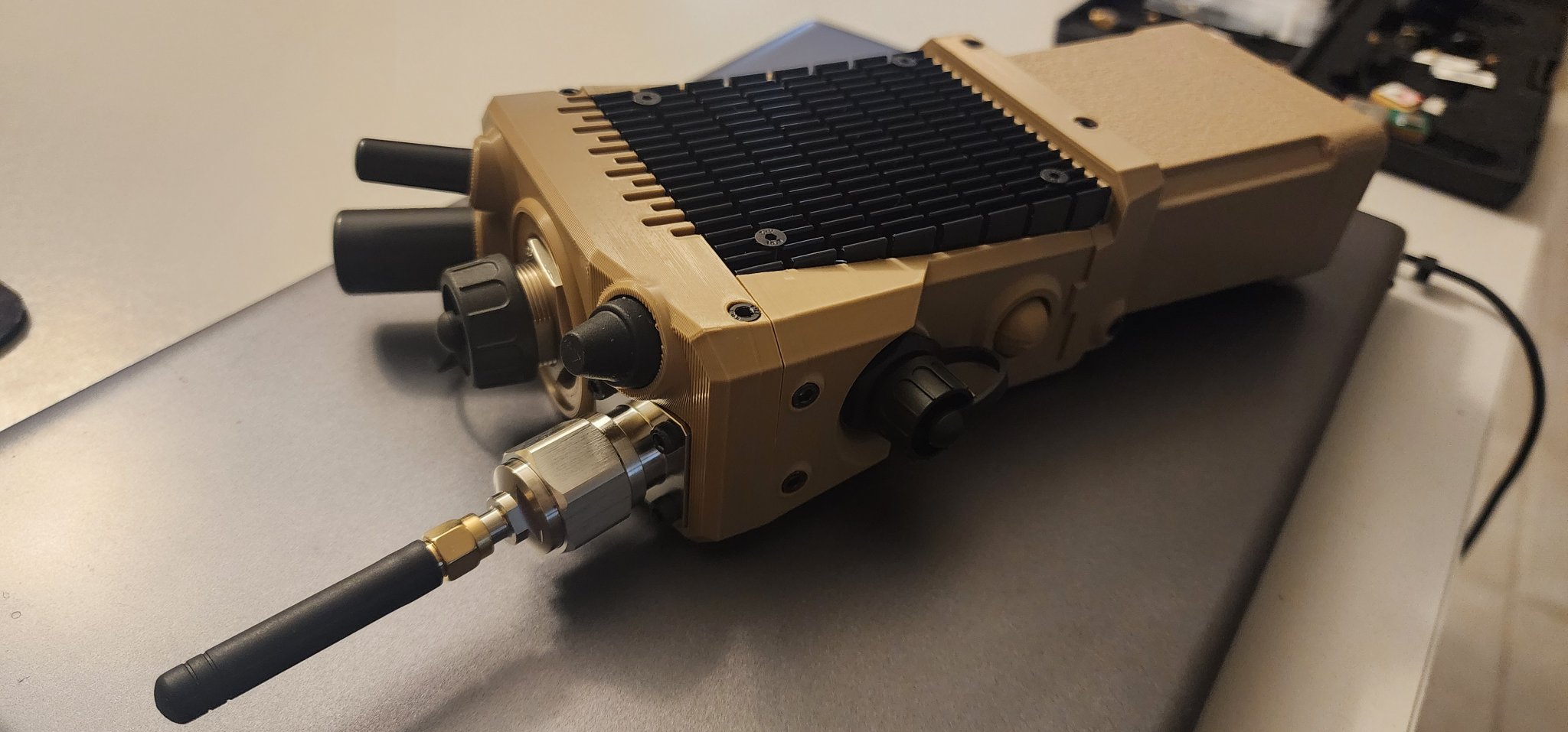

These have a built in Lora chipset /GPS/Meshtastic. Middle antenna. Same technology Ive described in all past posts of the previous Lora devices. It's a nice quality chipset for redundant low power encrypted communication.
Simple voice call and messaging app

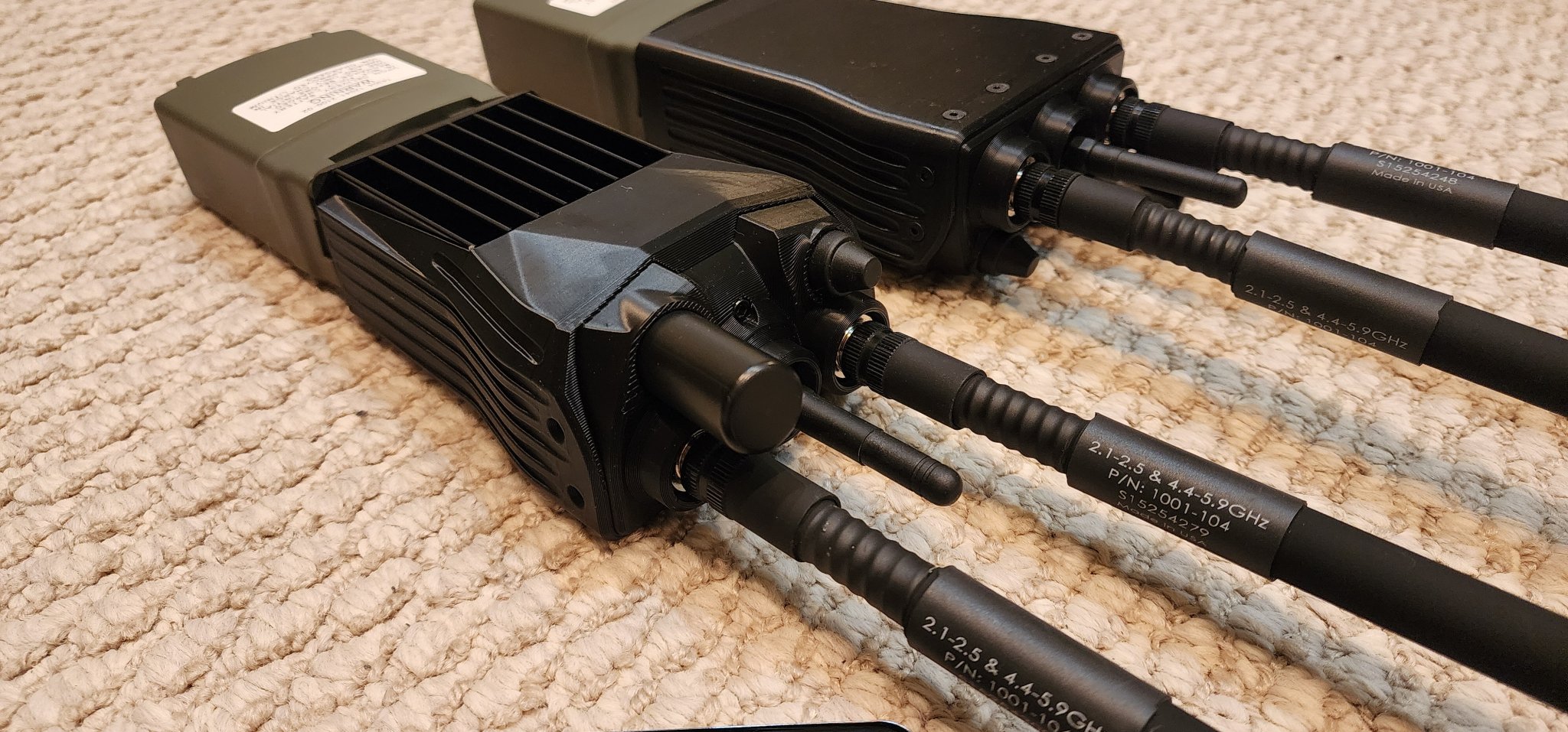

Extra info:

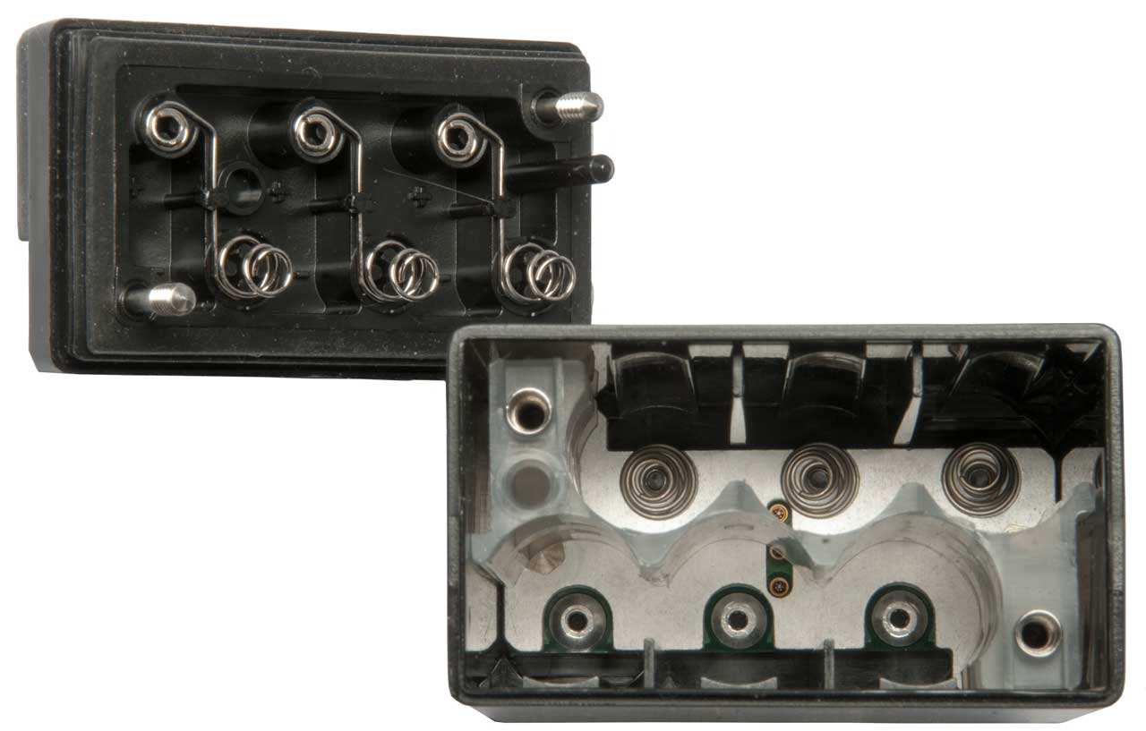

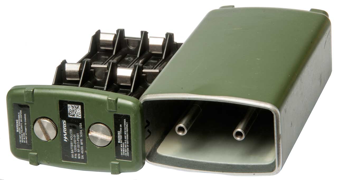

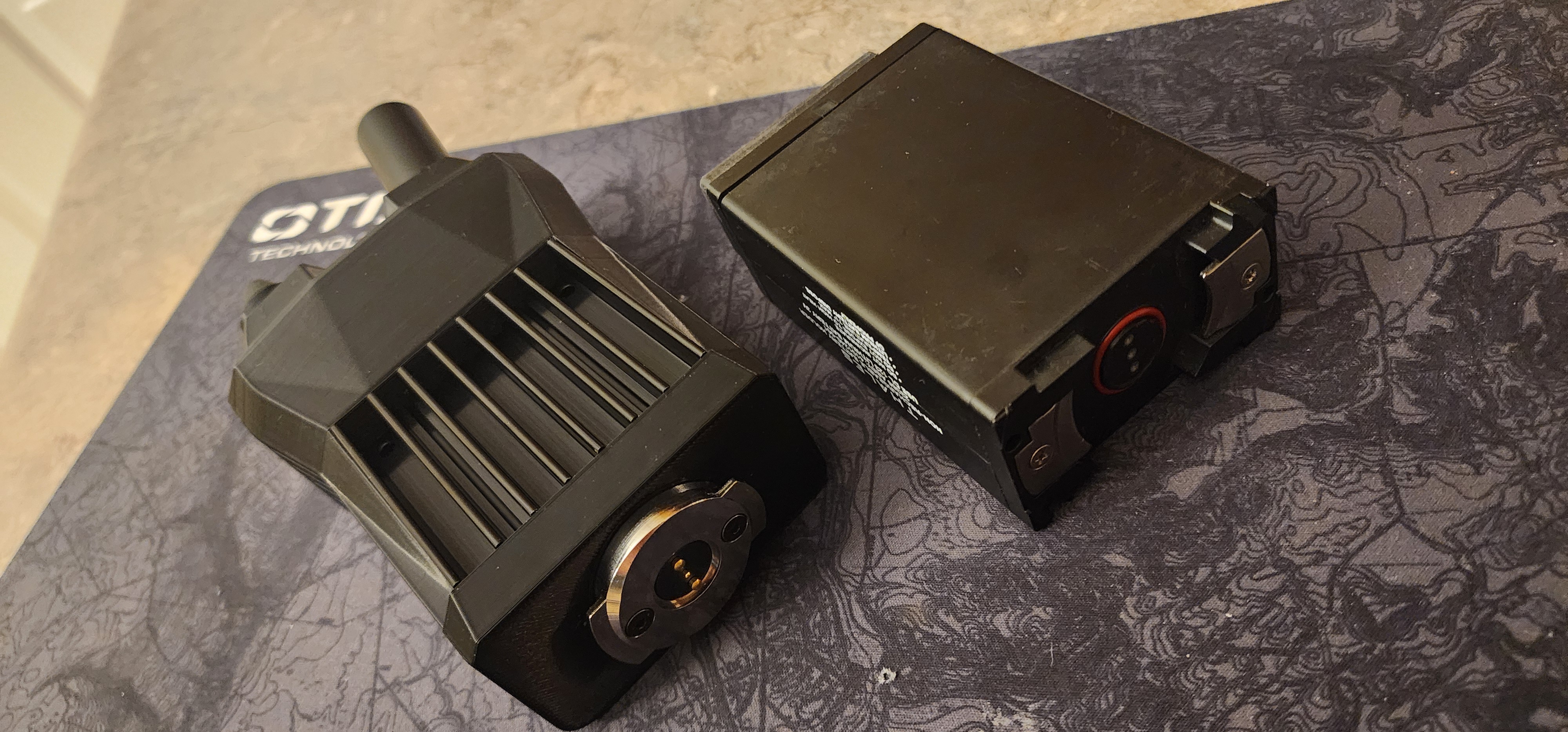

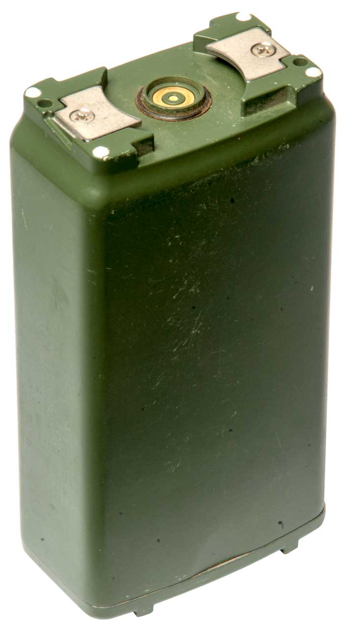

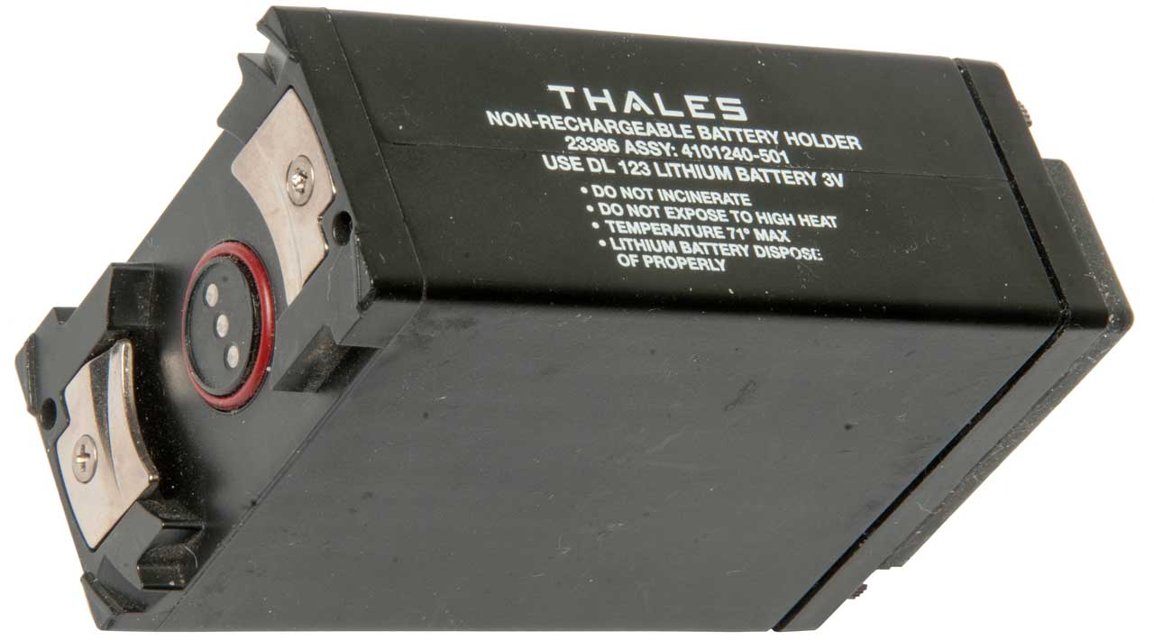

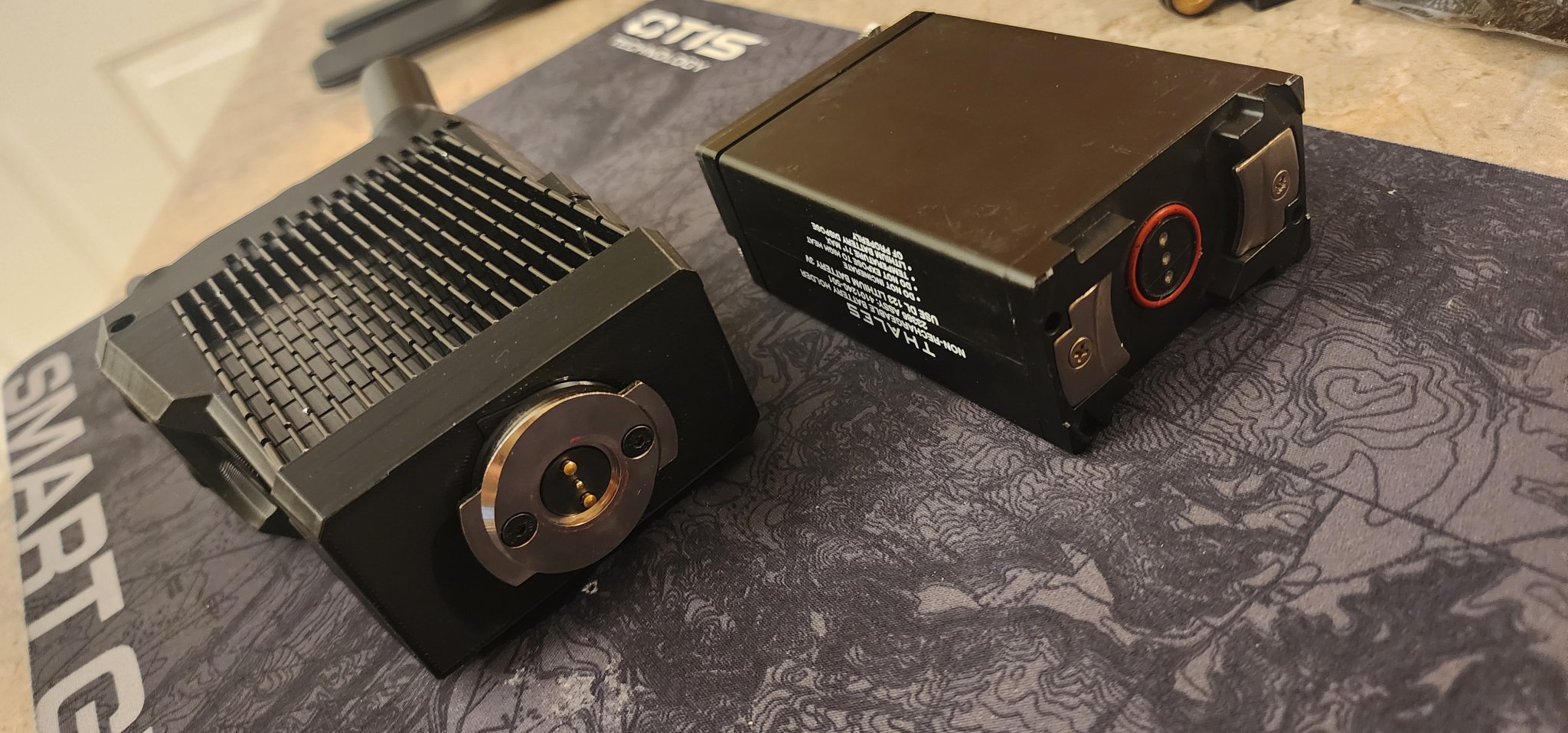

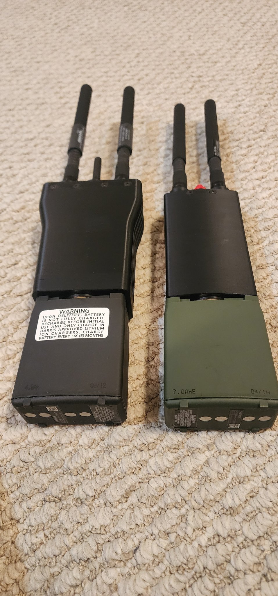

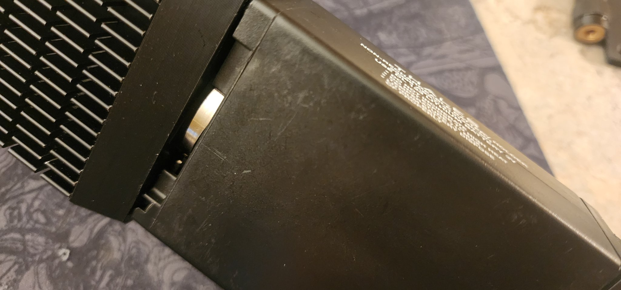

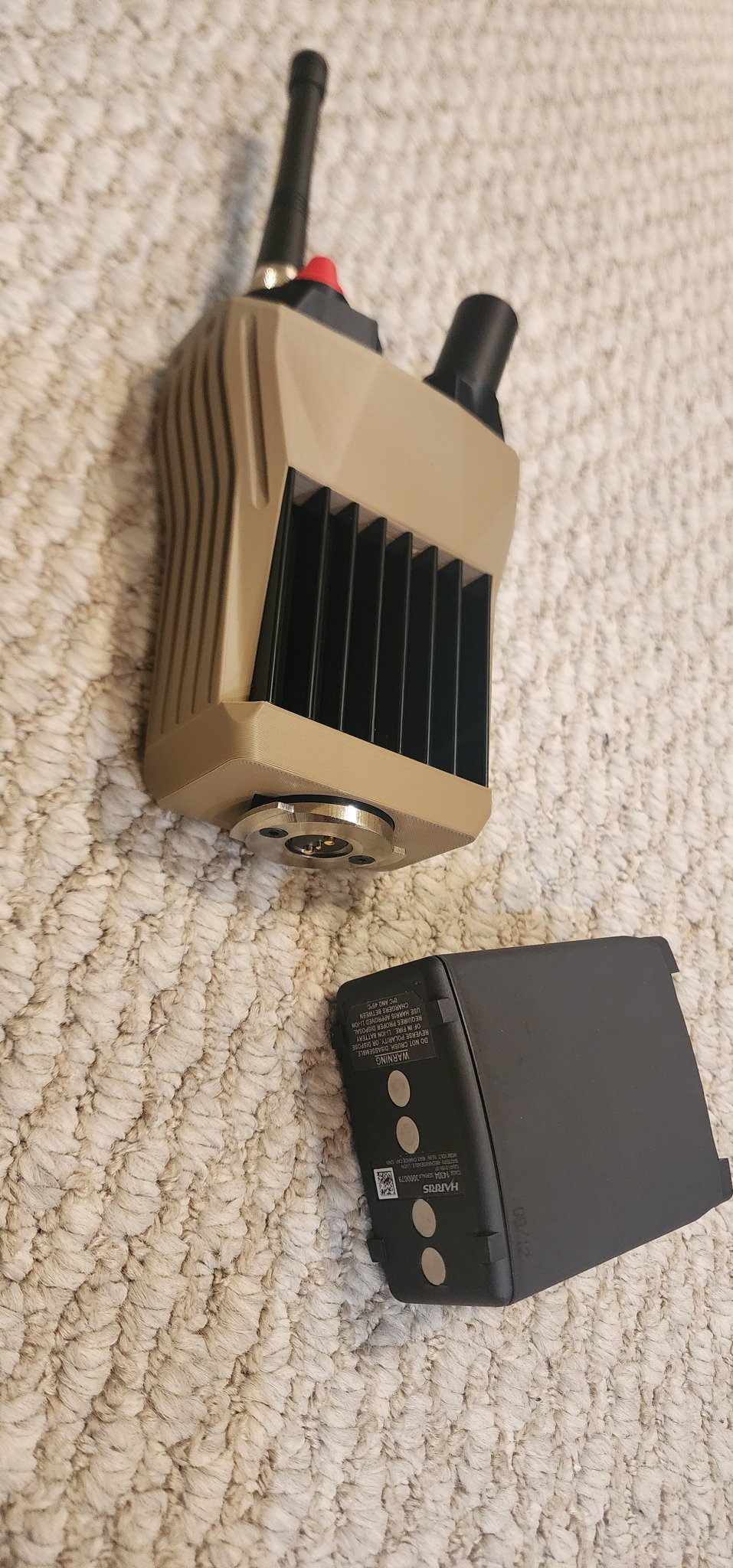

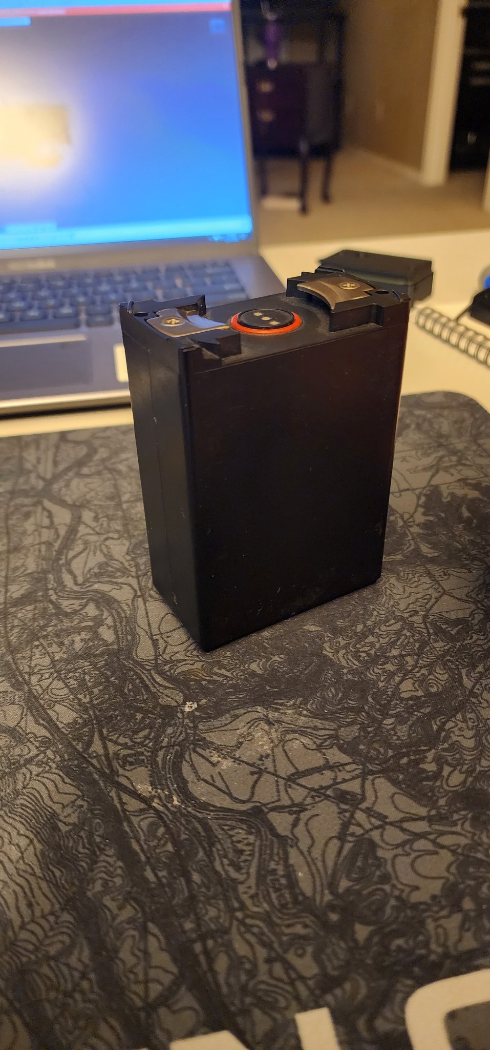

The L3 Harris Prc-152a twist on battery; supplys power to Persistent systems 3 pin battery flywheel which supply's power to 6-21v variable voltage input of the 5 Ghz MIMO IP Mesh radio. The 915 mhz Rak Lora Module with GPS piggy backs off the power supply.
You can use off the shelf prc-148 or prc 152 battery's ranging from 6-21v. I'm using Harris batteries due to the quality of internal battery management system circuitry. Rebuilding them with 6x Molicel 18650s, which I've found to be the best rated for the type of discharge curve I desire.
Off the shelf L3 Harris, Thales, Bentronics prc-148 and 152 batterys are 4-8 amp hour, $350-1400 each. It may take two batteries to have the radio work all day depending on how many hours you look to run the radios. Some batteries are charger specific so keep that in mind.
I include a L3 Harris OEM charger with the one L3 Harris battery I supply per radio.
There are prc 148/152 batteries that have swappable Cr123 or AA options which is interesting. These radios can be powered by those as well.

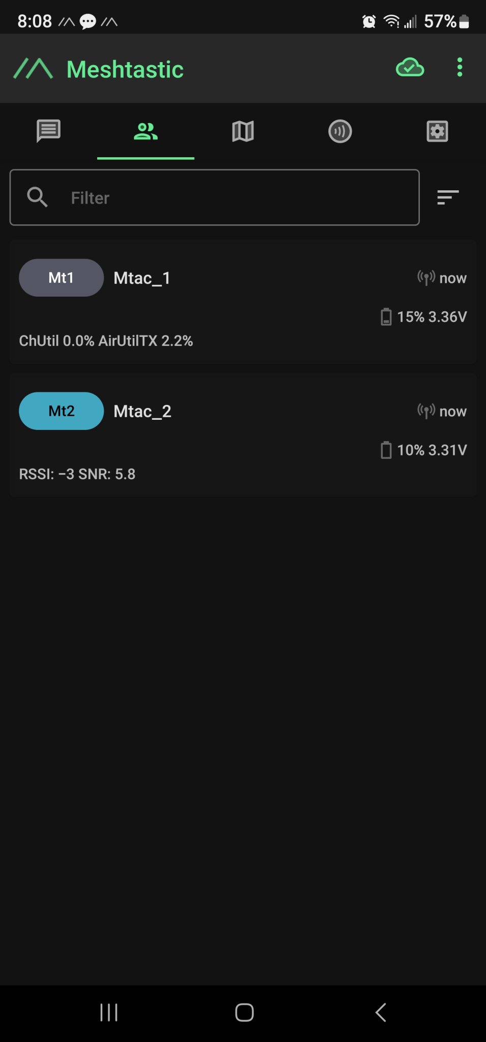

Device networks pre-setup and auto configured. Simple power button, wait 60 seconds and connect smart device to the Mesh devices wireless encrypted Network.
Using Jami Android/iOS app to be downloaded for encrypted voice, video, file and messaging chat.
Use ATAK Android/iOS app for offline high res map or multicast abilities etc.
Use Meshtastic Android/iOS app for simple extended encrypted GPS/ Lora messaging ability.

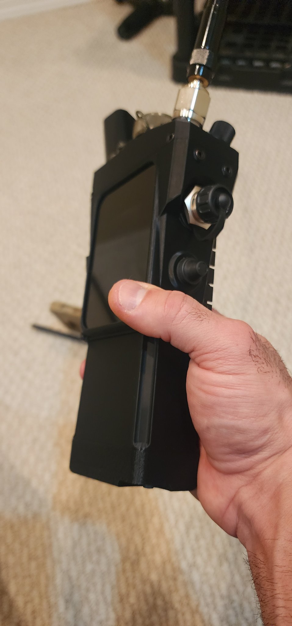

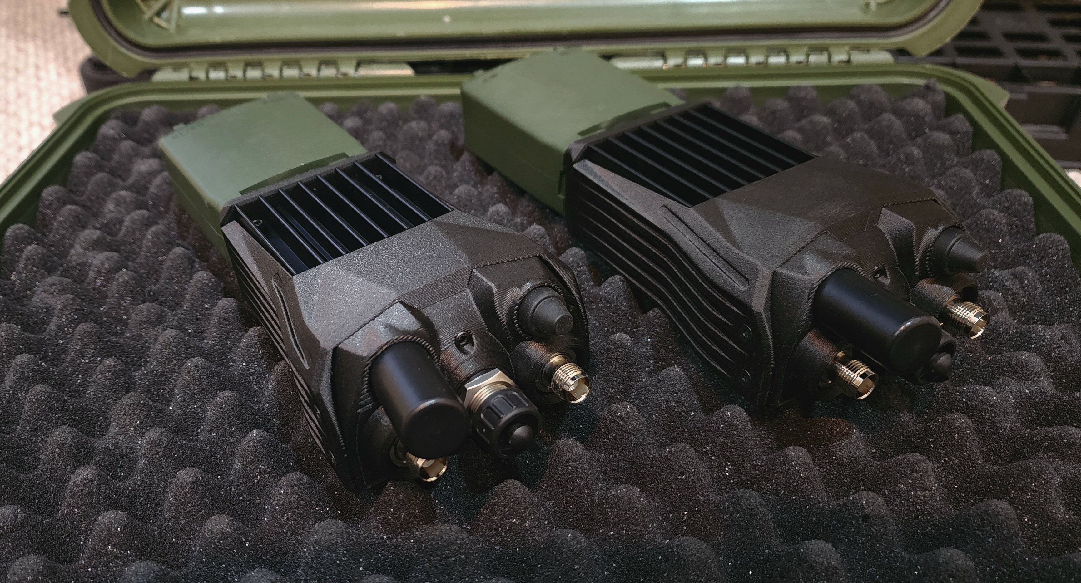

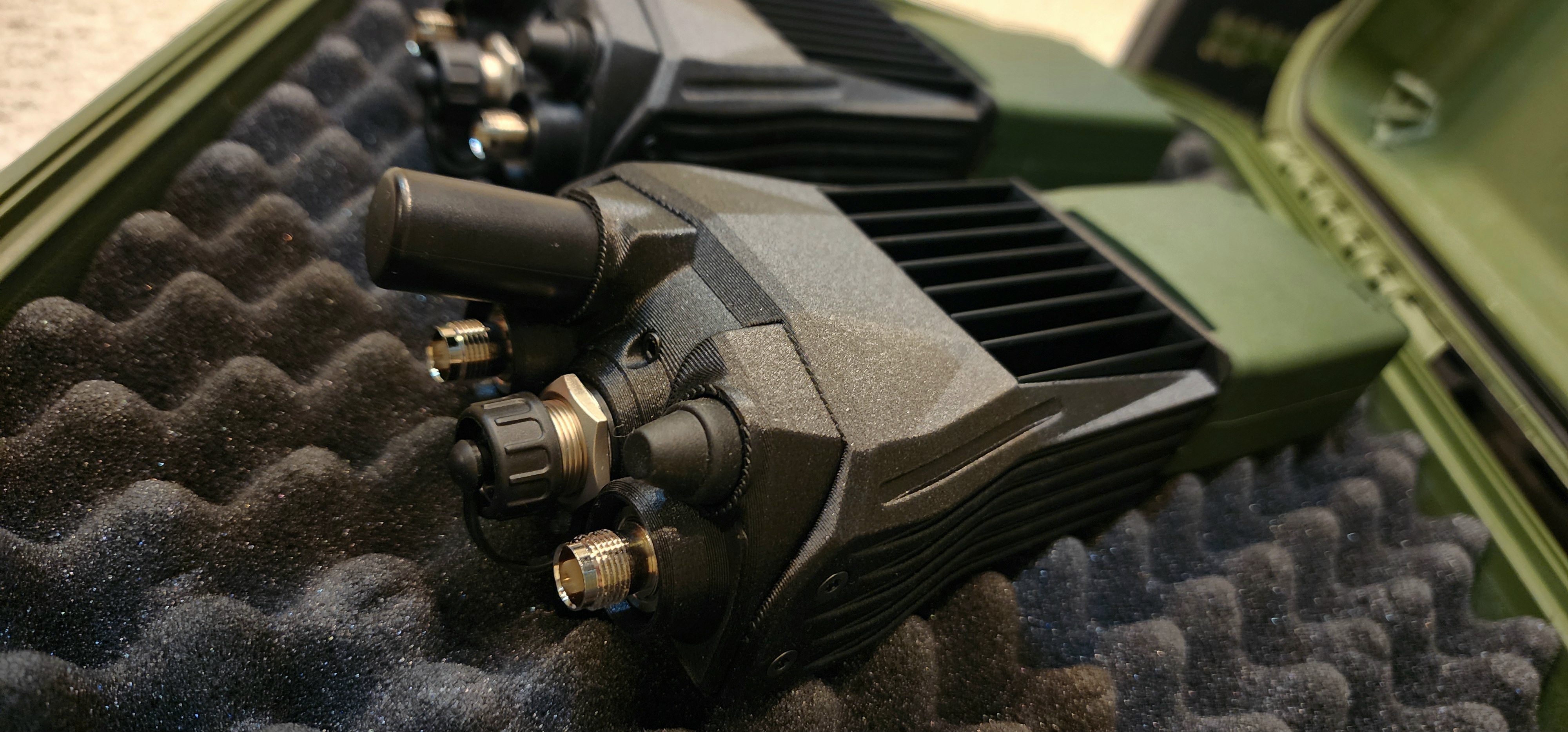

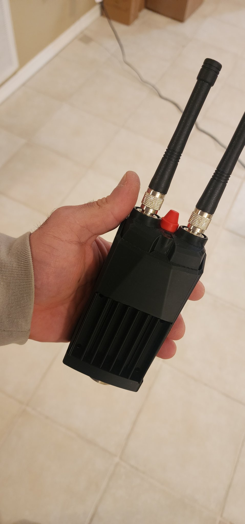

If interested, i have two extra Lora 915mhz Mesh Radios built and available.
They have a toughened touch screen built in for redundancy.
Swappable 5x 18650 Molicel powerbank for any Android or iOS device via 5v USB 3.0 output.
14k mAh Battery capacity, should last many weeks. Micro USB charge port input.
All high quality certified connectors, i.e Amphenol etc, USA made tinned copper wiring and power management. No cheap AliExpress parts. Designed to be used with mil grade ism band Type N antennas, if there is future desire to upgrade.
External Bluetooth, Lora gooseneck and GPS antennas.
They have encrypted messaging and GNSS/GPS tracking, connect to any smart device via Bluetooth, for use with the Meshtastic app and/or ATAK app for Situational awareness with offline high-res maps.
Units are $550 each, 2 available. Sold
Shipped UPS insured.
PayPal or venmo
Reactions: Brym427

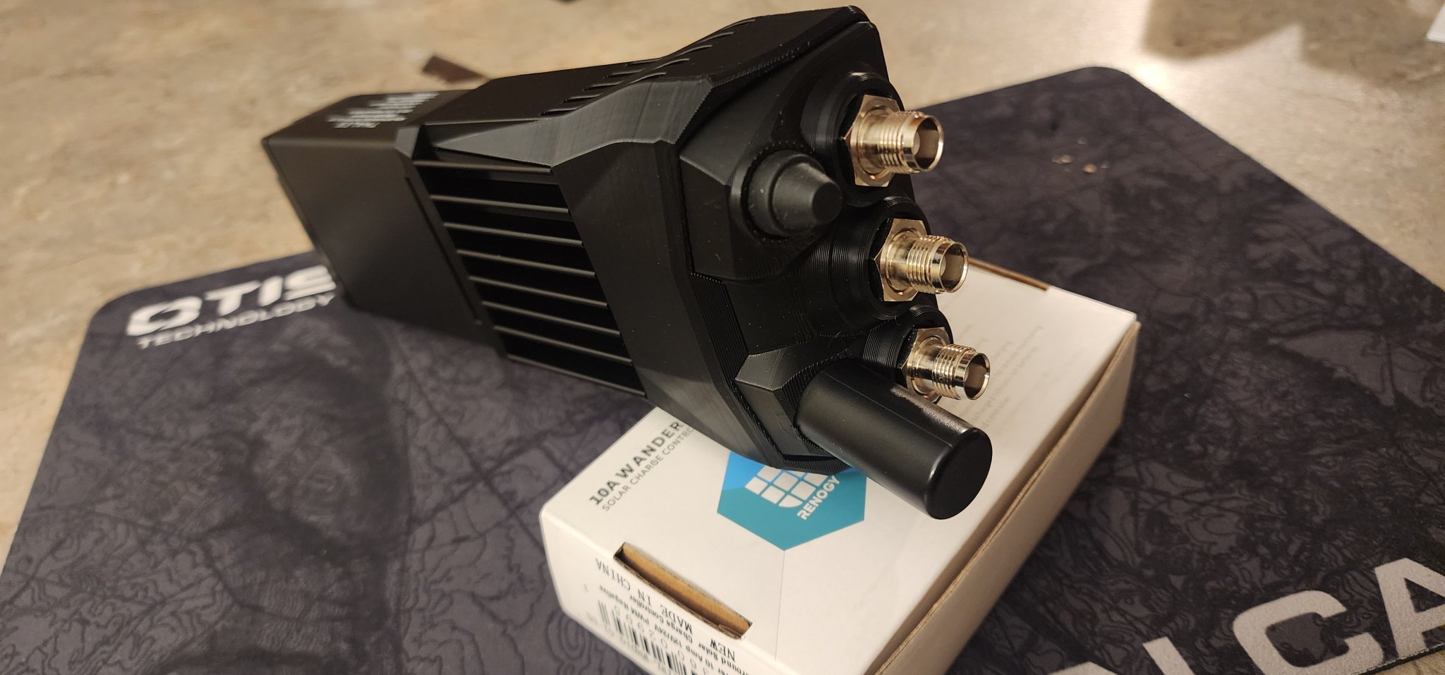

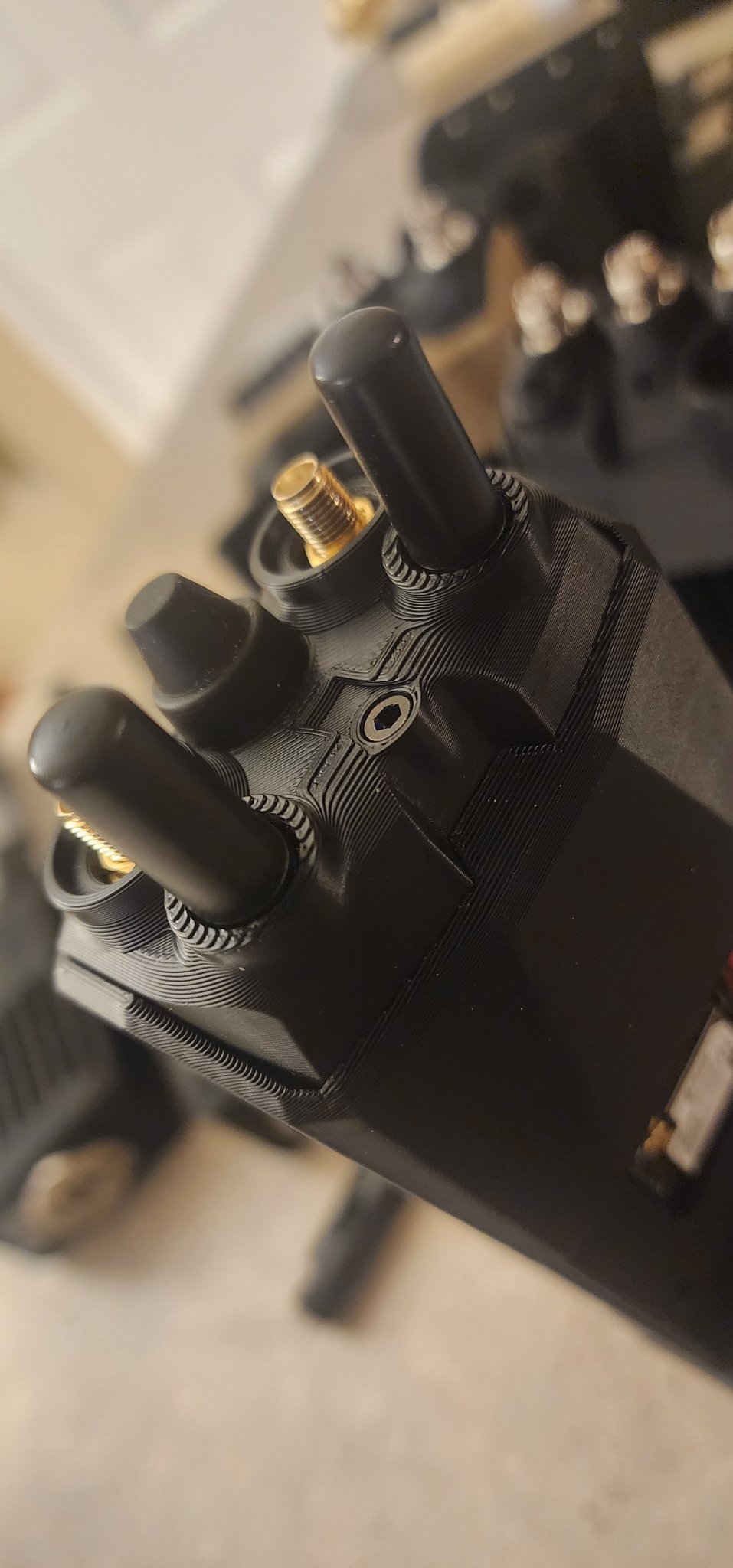

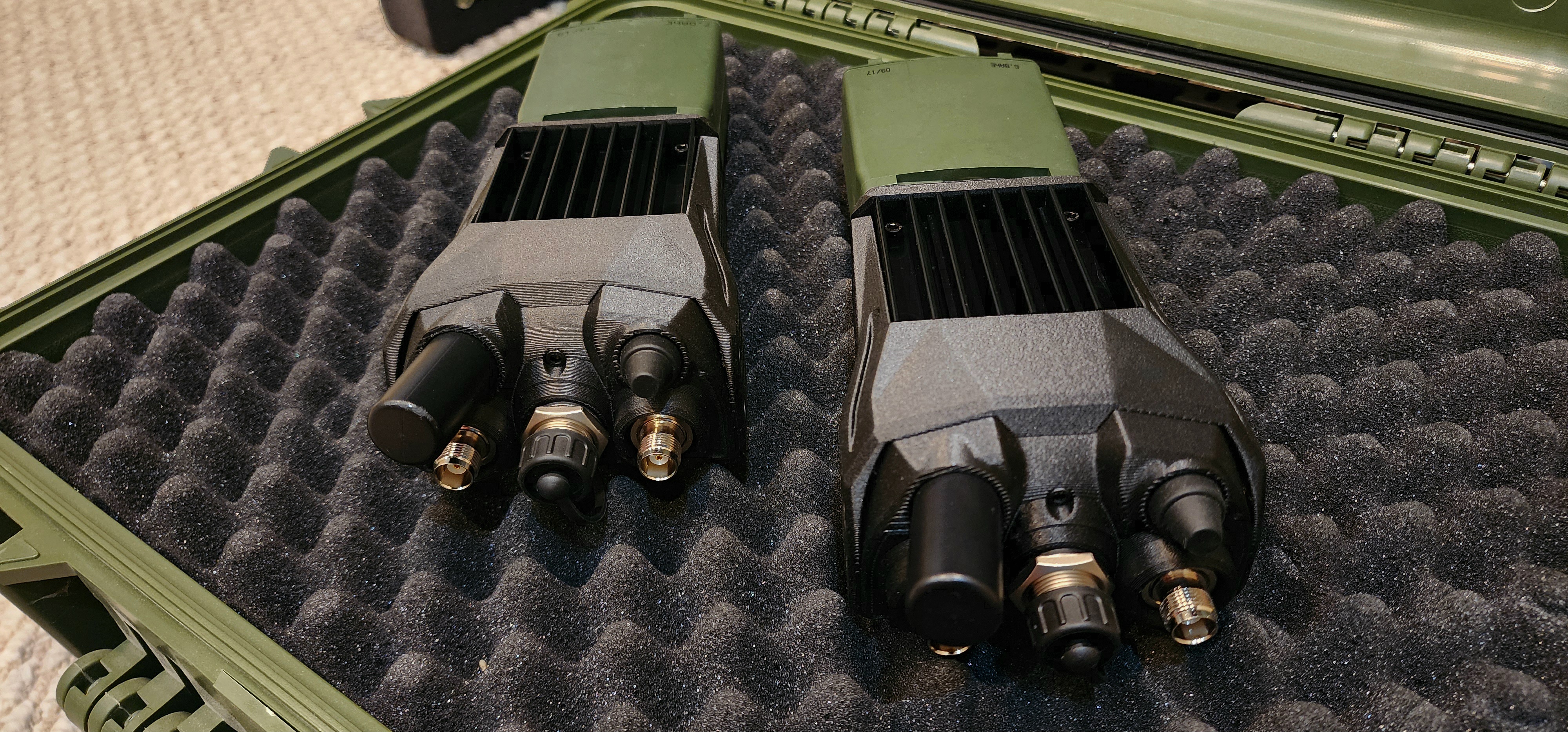

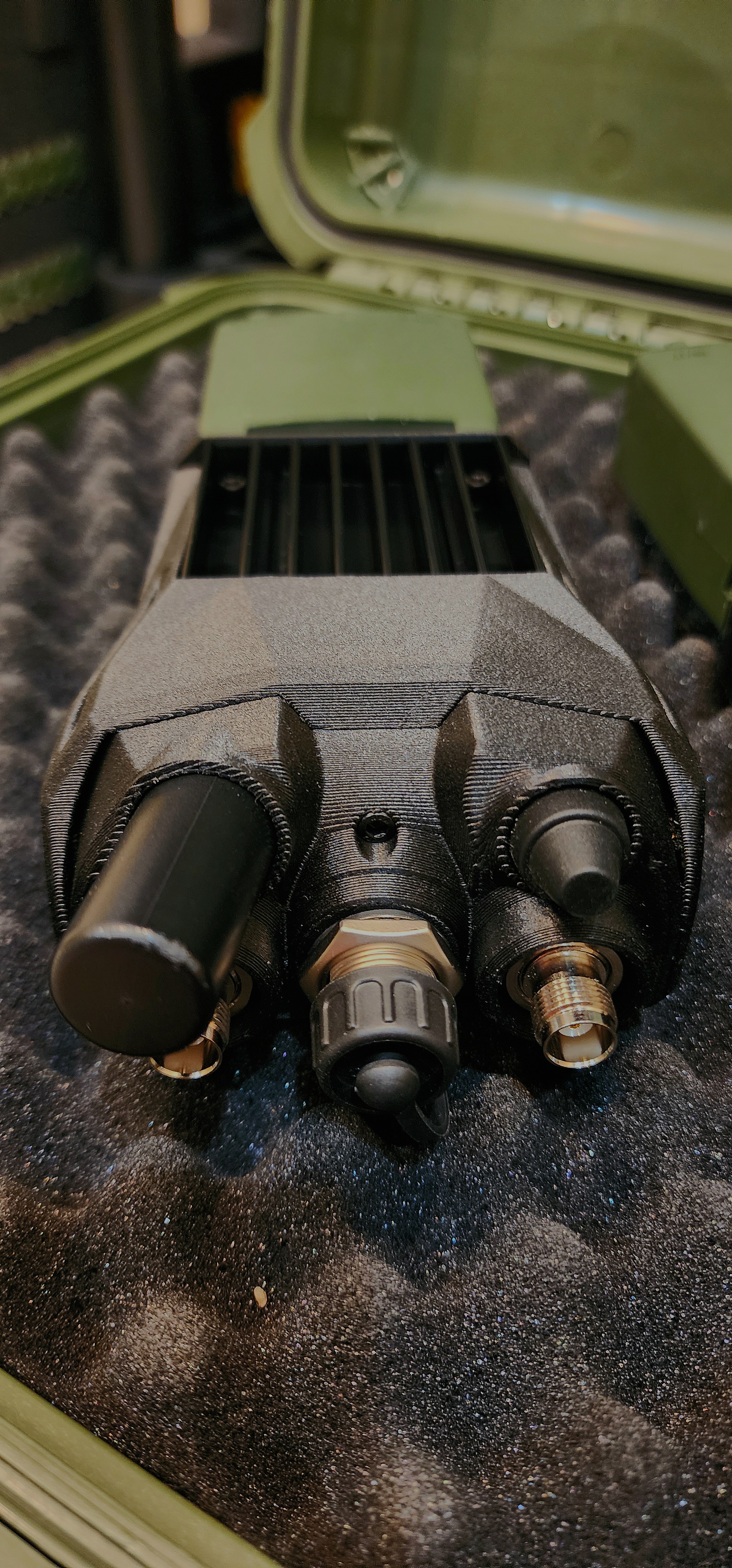

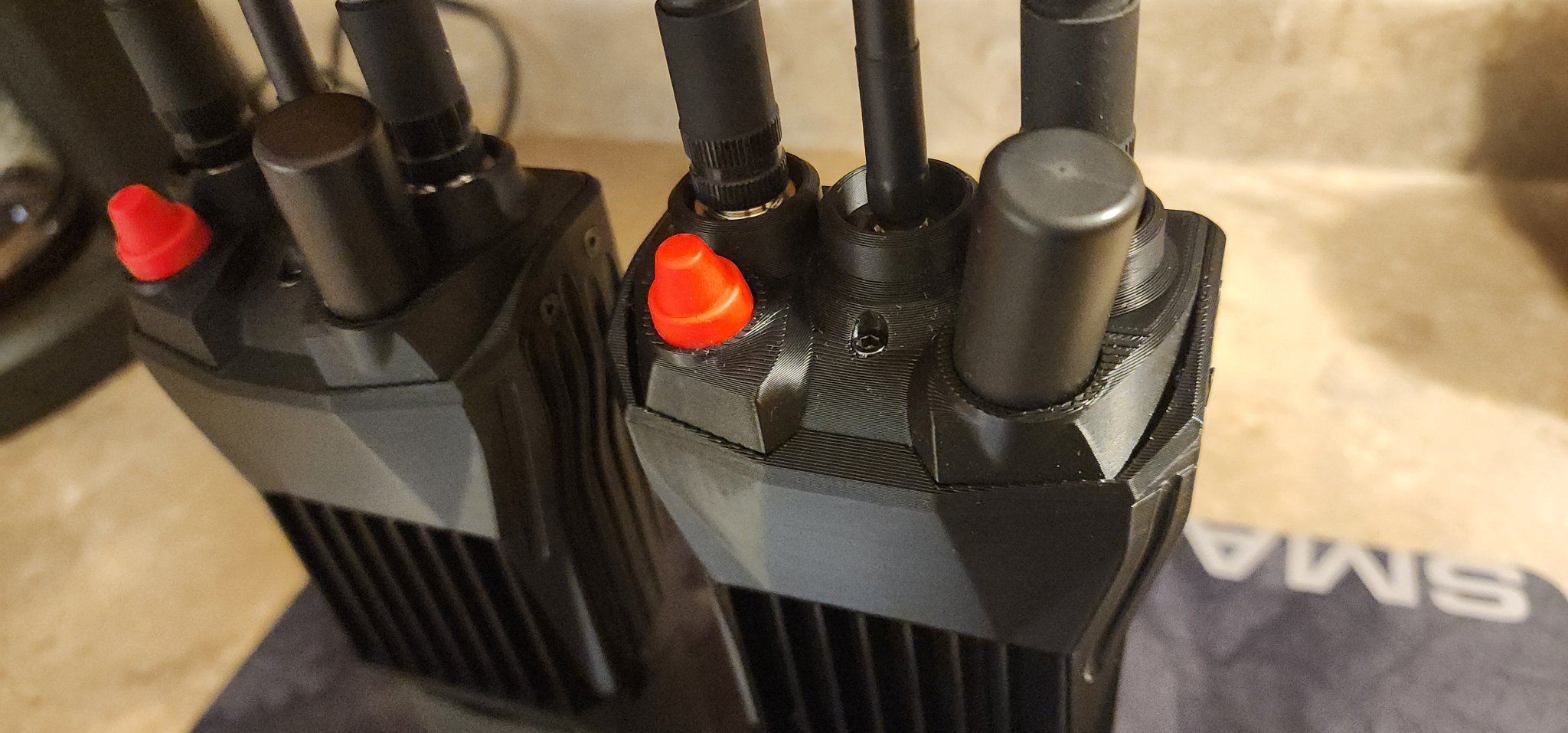

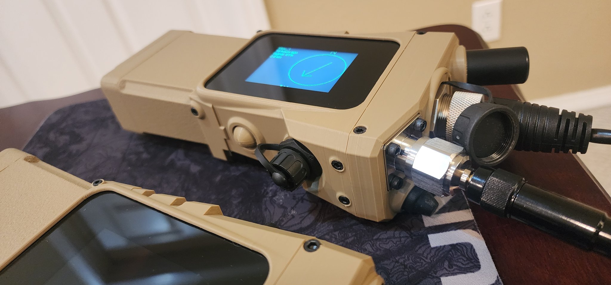

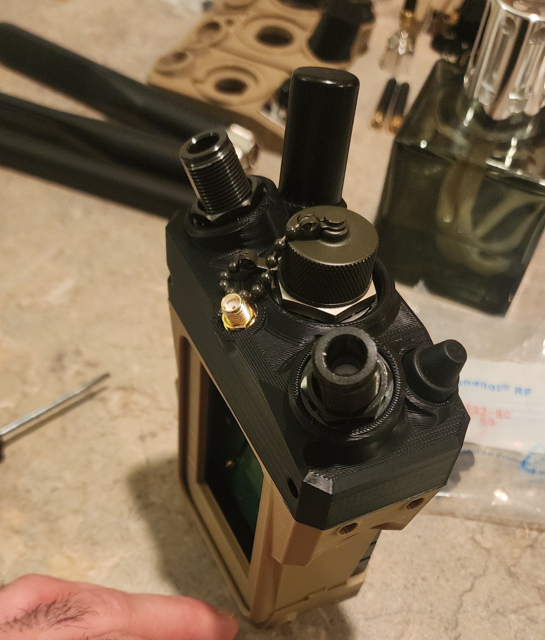

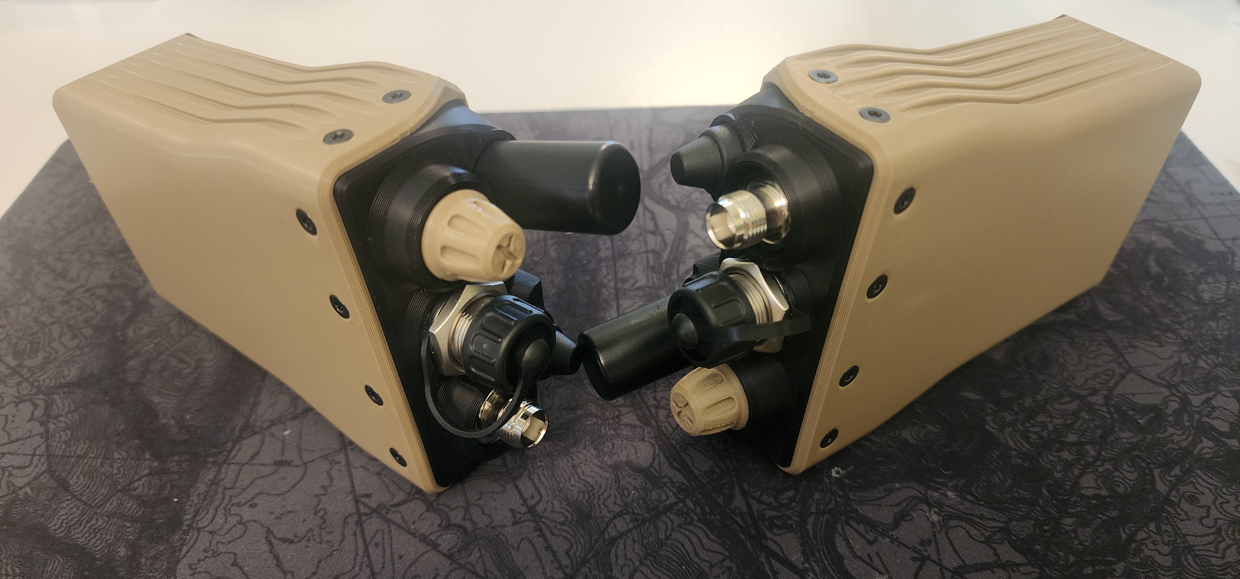

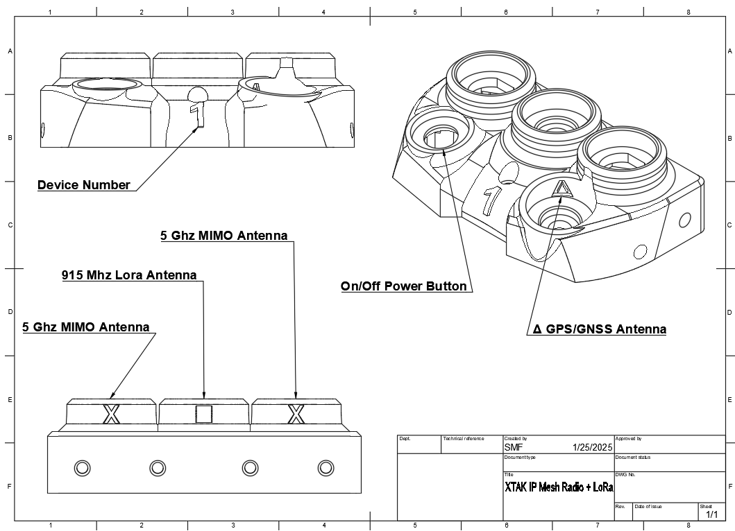

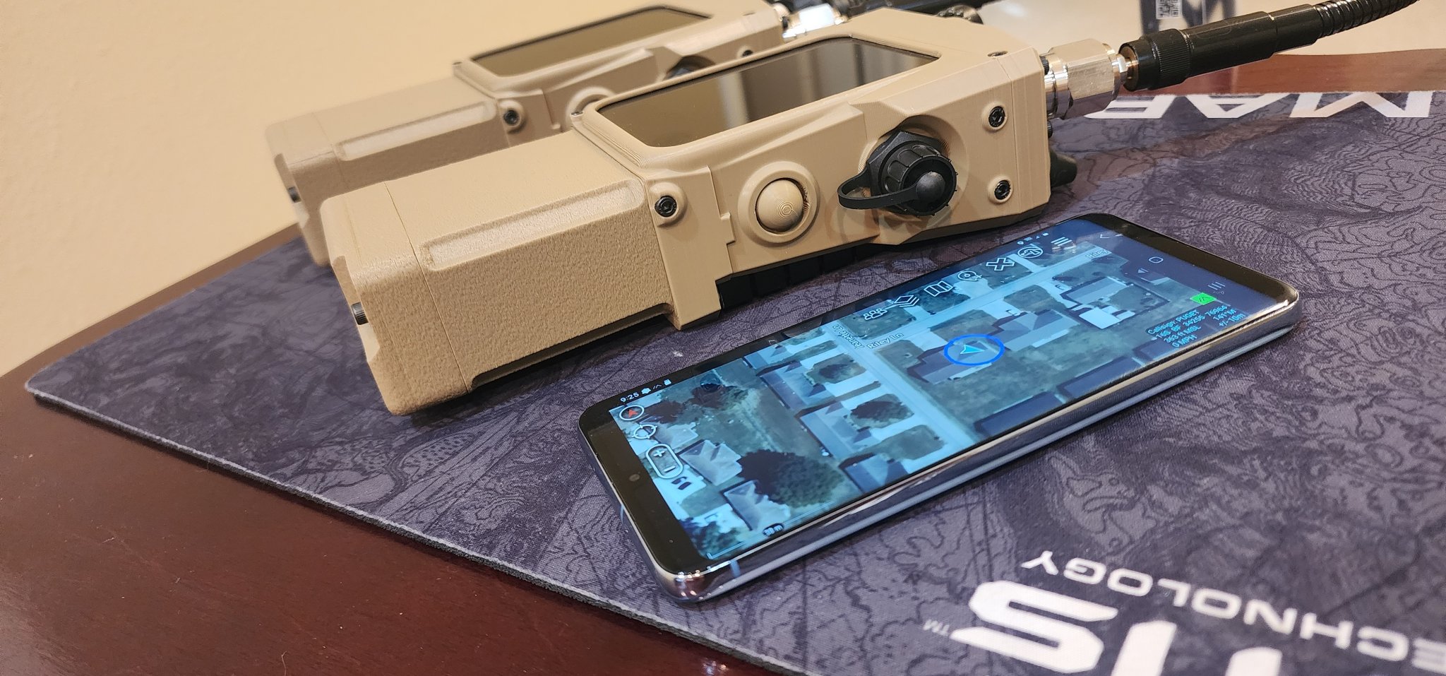

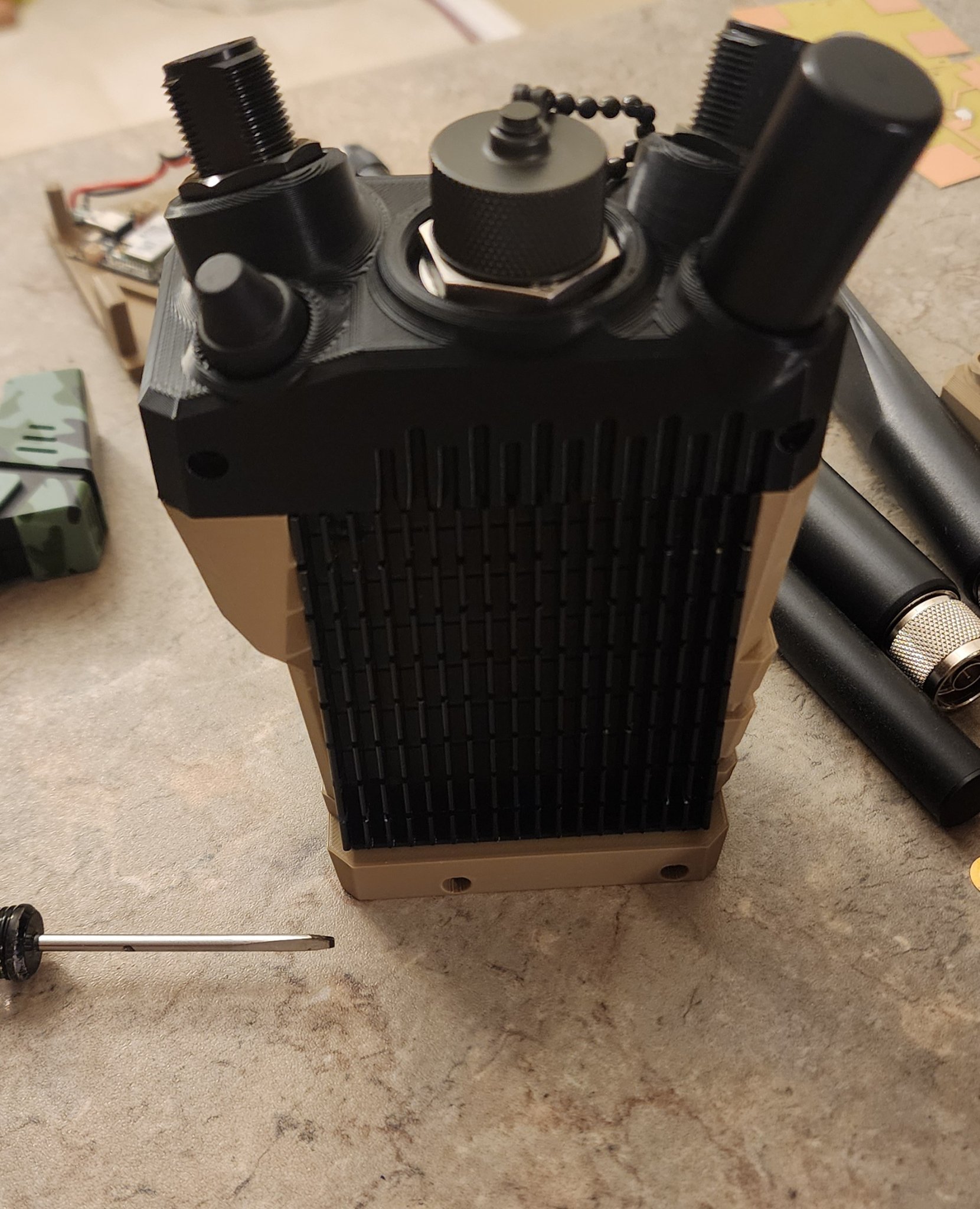

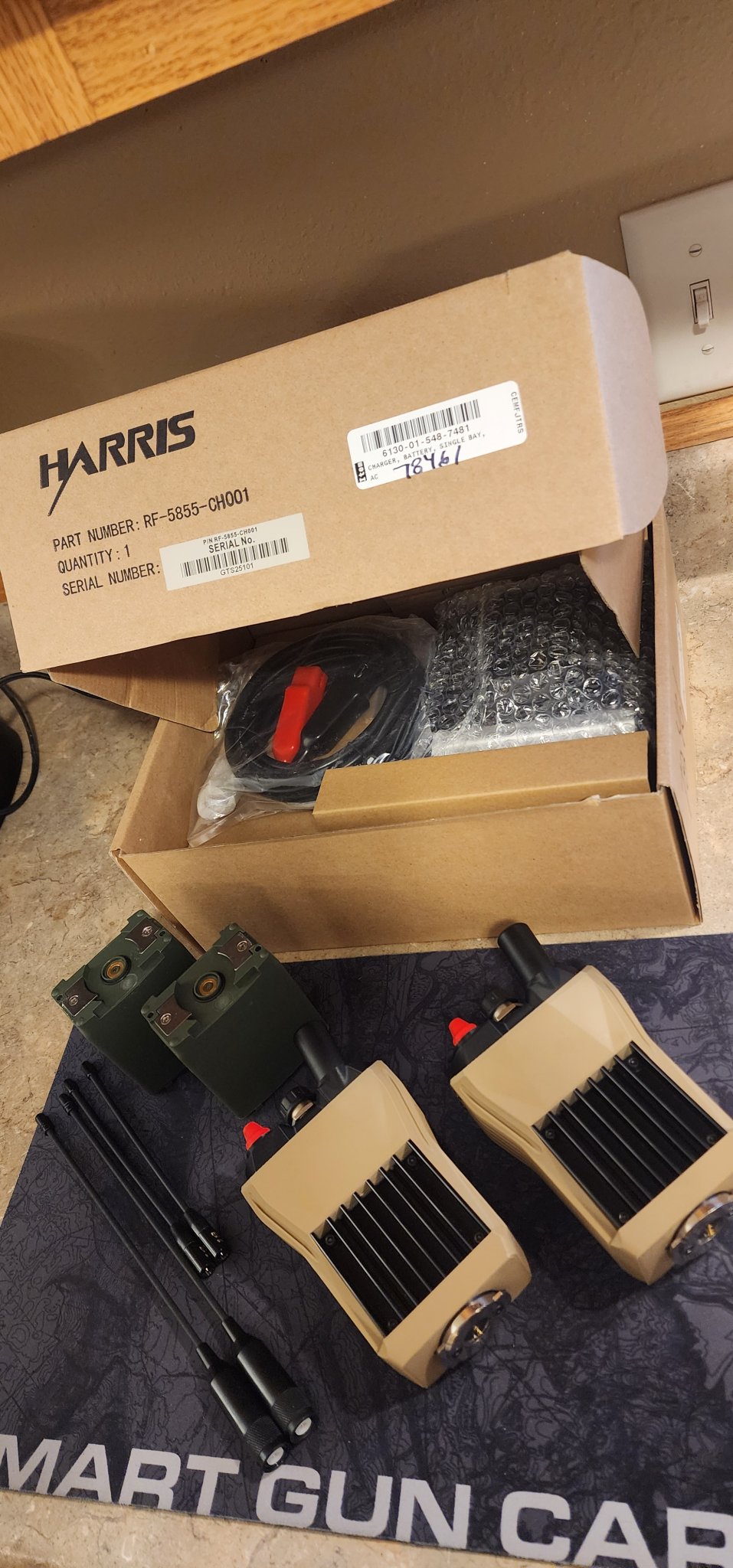

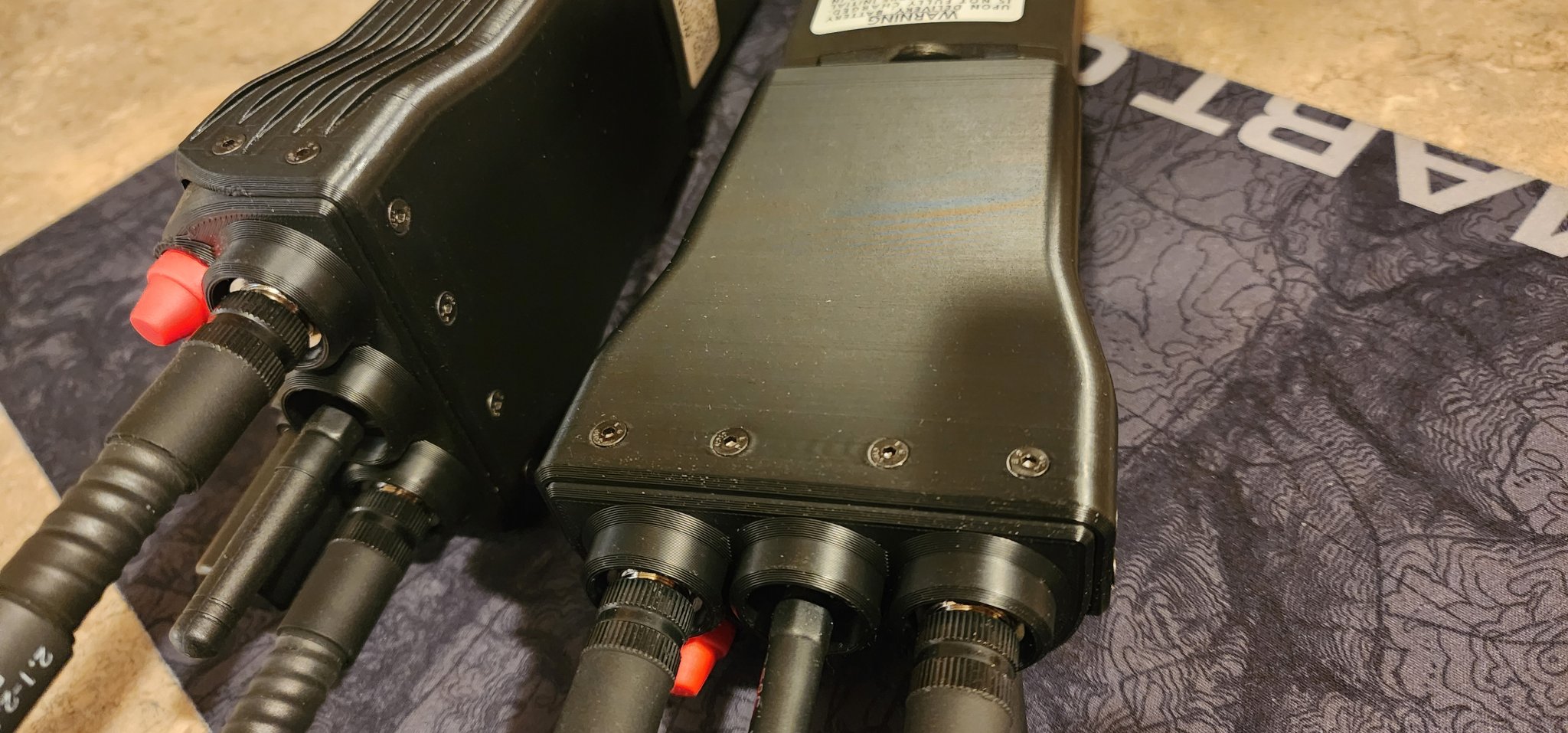

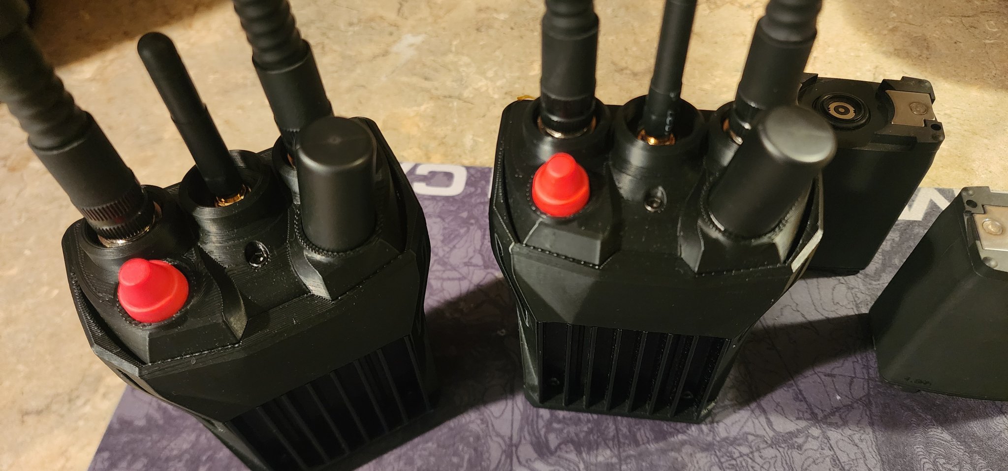

I have two 915mhz LoRa units available. These are presetup and configured. For use with the ATAK app or/and Meshtastic app. This model has AES 256 encrypted messaging and GPS.
These are built to be upgradable to the high bandwidth encrypted hd voice, video IP mesh radio + LoRa radio if desired in the future.
Left Amphenol TNC port is the 915mhz LoRa Antenna
Right Amphenol TNC port is for future 2.4/5ghz IP mesh radio Antenna.
Center port is IP67 certified waterproof USB-C Serial port for programming / firmware updates.
External Sma Stub GPS Antenna
Red button with the rubber boot is for on/off power.
Industrial grade Lora hardware, Variable voltage regulator.
Persistent systems MPU5 battery flywheel hub assembly; can be used with any off the shelf PRC 148/152 battery 5.5 -21v.
These come with two Genuine Harris PRC 152 battery's and One New Genuine Harris Charger.
Plug and play ready to go.
550 each, shipped via UPS insured.
PayPal or Venmo.

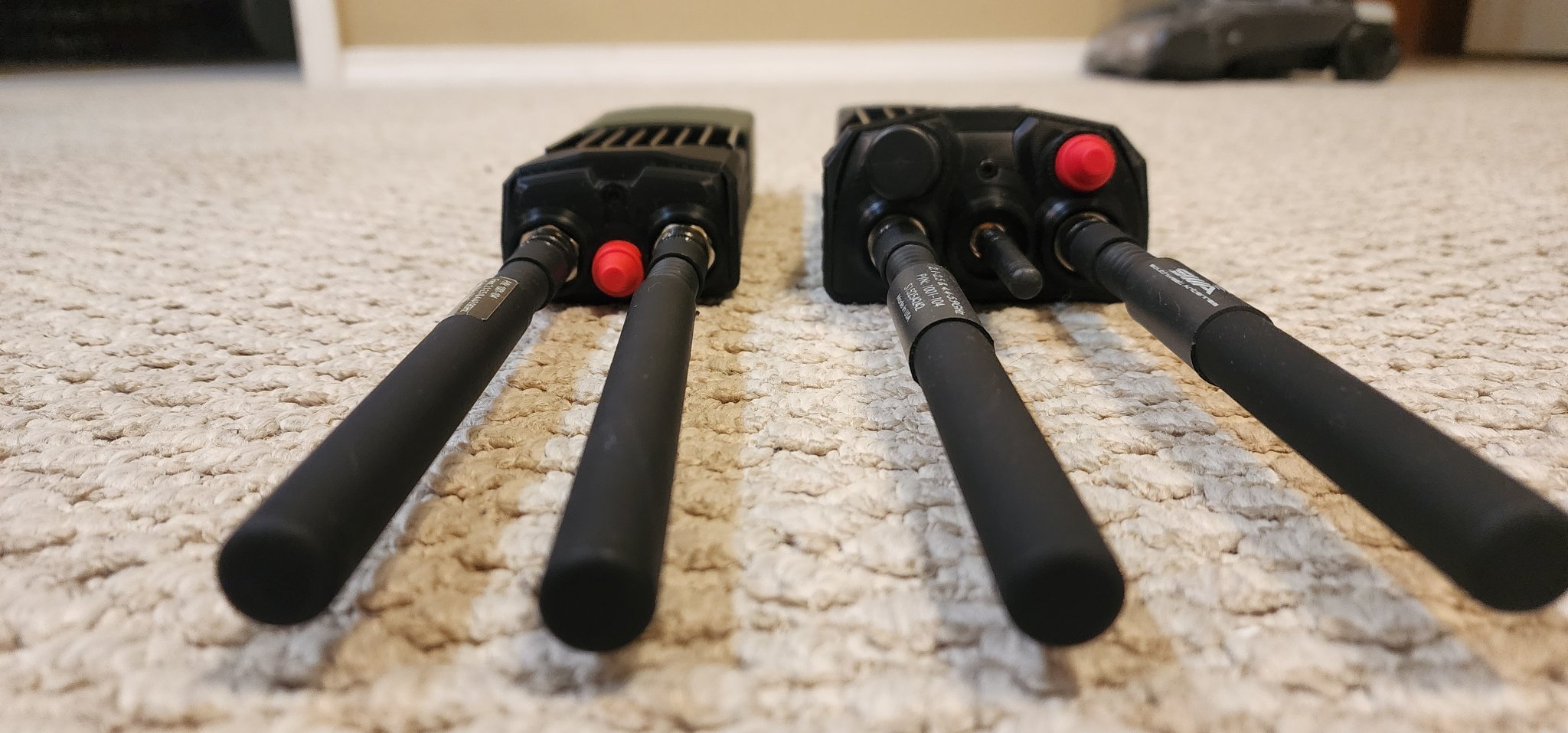

But, this guy might be talking to someone hundreds or thousands of miles away.
Or maybe it’s a directional antenna and he is doing a foxhunt?
It still looks funny though. Haha
Foxhunt or local POTA and home base testing of equipment.
Based on what I can see on the antennas, it could be either seeking a problem signal generator/annoying actor or simply POTA in his local area VHF/UHF.
And/or testing the range of his equipment back to his station a known distance away for various reasons.

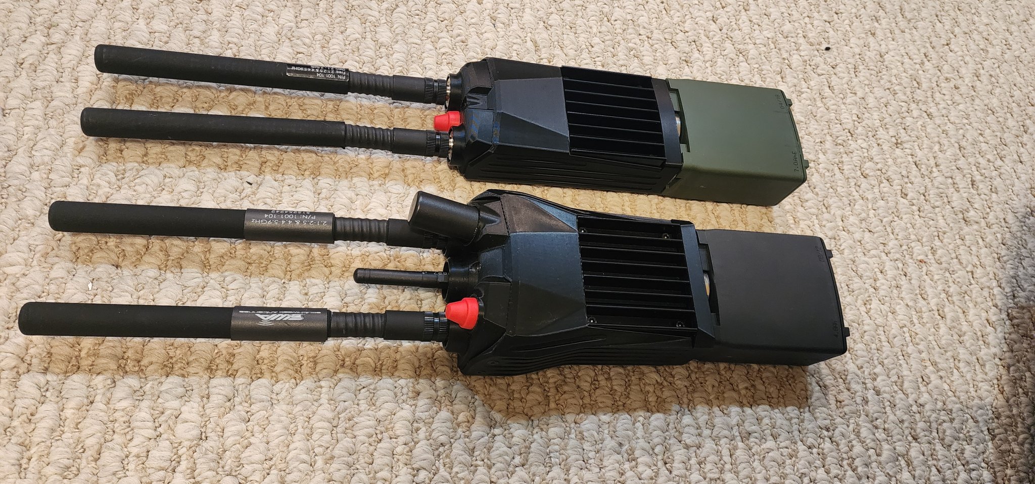

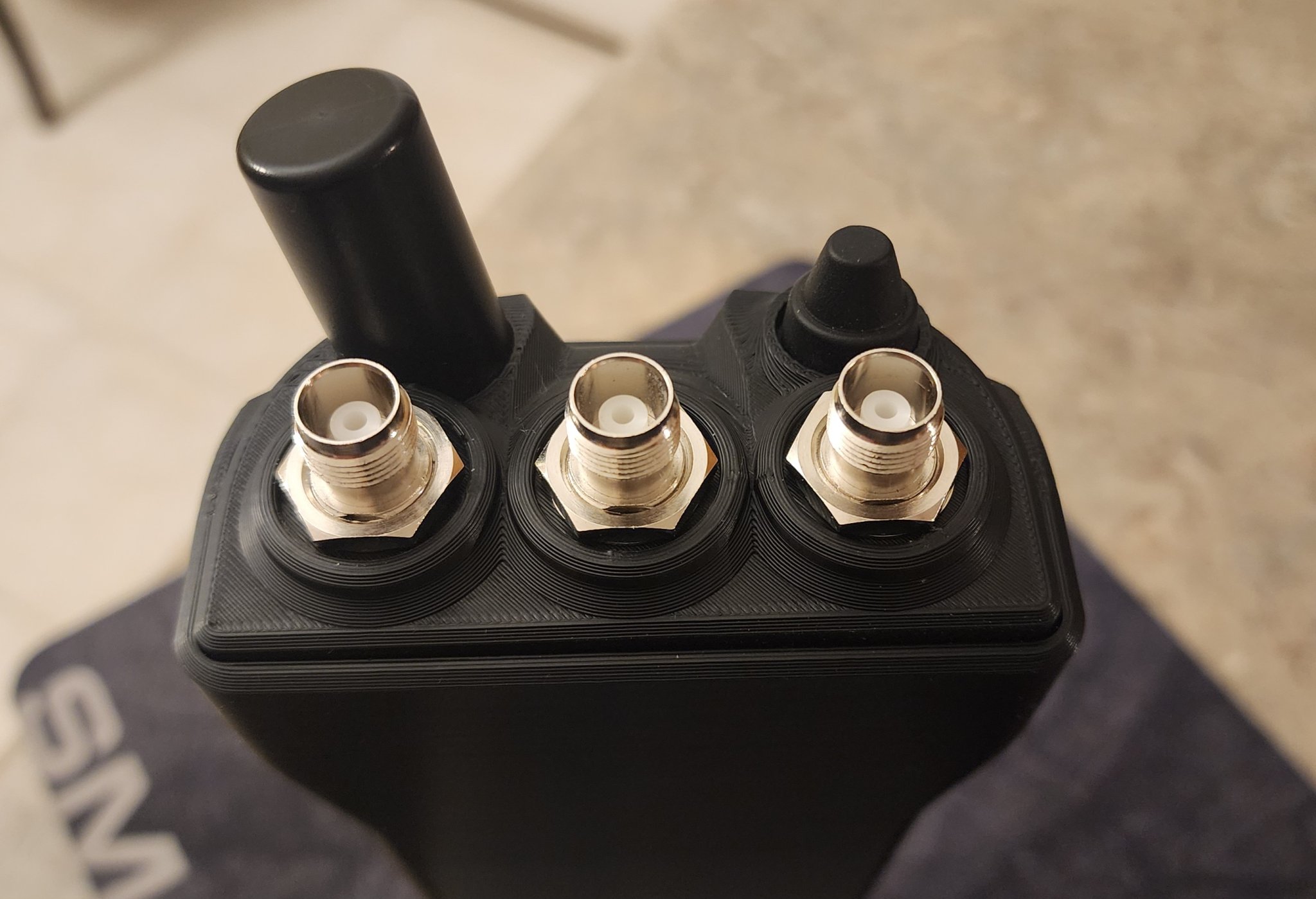

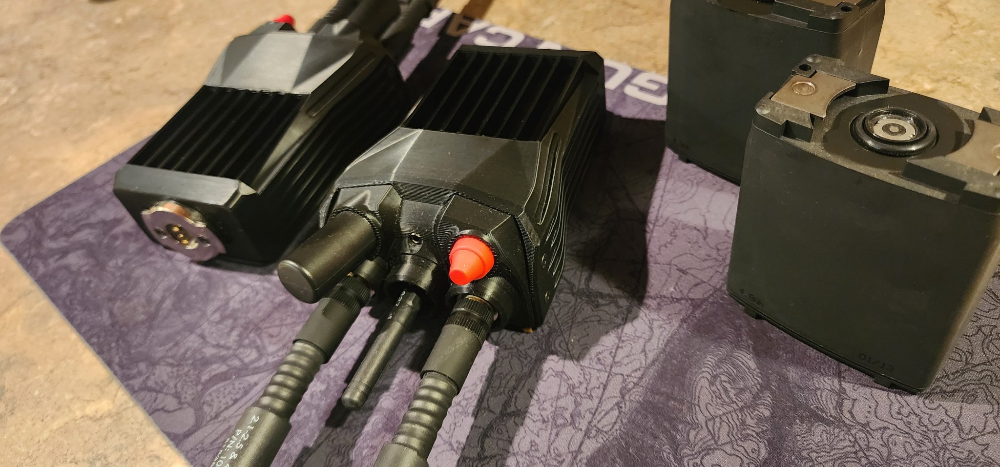

Center port is IP67 certified waterproof USB-C EUD hardwire/ Serial port for programming / firmware updates.

This week I crafted an idea. Same hardware configuration in LoRa/GPS version. And SISO for the encrypted IP mesh/LoRa/GPS version; just small form factor, same power output. Have had a few inquiries pertaining to this, so I whipped one out. Believe it or not the small form factor is built like a TANK. At least Twice the density as the original form factor. Tough as nails. Will post the FDE version tomorrow.
Side note: A Mobile Starlink setup can be easily integrated into the network of the IP mesh radio version as well. Seamlessly
I have two more LoRa Mesh Radios available for $450 each. Originally $550. This version has Encrypted Messaging and GPS tracking. I can also swap these over to a black case.
PayPal, Venmo: +$10 Shipped UPS insured.

I have two 915mhz LoRa Mesh radio units remaining. These also have a built-in 5ghz encrypted mesh radio; high definition voice, video streaming, data capable. These will be upgradable. $850 per unit
Southwest antennas cost $200 each. These require 4. There are more affordable antennas I can recommend or sell these if necessary.
Harris prc152 batteries and Harris Charger included.
Shoot me a message if interested.
PayPal, Venmo. $850 each

I have two 915mhz LoRa Mesh radio units available. With an ability to upgrade to add a 5ghz MIMO radio board for an additional $300 per mesh unit. (Enables high bandwidth multicast voice, video, data capabilities).
The LoRa only version allows you to have an off-grid device for encrypted messaging and GPS, which connects to your smartphone, tablet, computer via Bluetooth or USB.
They create their own standalone mesh network without the need of cellular or Internet. Typically utilized in the ATAK app for Situational awareness, individual/group chat, high res satellite imagery offline maps, team GPS beacon tracking and map markers. You can also use the meshtastic app if you want less complexity for the encrypted GPS tracking and messaging feature.
Presetup and configured, plug and play. Built with high-end certified parts; no cheap Chinese AliExpress nor amazon parts.
Designed to be used with upgradable mil grade ism band LoRa 915mhz antenna. I can provide the link to purchase these antennas from digikey for roughly <$30.
If you choose to get the 5ghz MIMO upgrade which requires 2 antennas per radio, (antennas are not included due to the $200 cost per antenna.) I will sell the four 5ghz Southwest antennas I have at a discount for $150 each. Southwest Part # : 1001-104
I will include the certified GPS and Bluetooth antenna with the devices. For the Lora only unit, The center port is a IP67 certified waterproof USB-C Serial port for hardwire connection/programming / firmware updates. With the 5ghz MIMO upgrade, the center port will be a 915mhz LoRa Antenna. External Stub GPS Antenna connector in front. Red button with the rubber boot is for power on/off.
Industrial grade LoRa hardware, Variable voltage regulator. Persistent systems MPU5 battery flywheel hub assembly; can be used with any off the shelf PRC 148/152 battery 5-21v. Each unit come with one Genuine Harris PRC 152 battery. One New Genuine Harris PRC 148/152 Charger comes with a pair of units.
IP67, Rugged and Super durable

The new release for meshtastic plugin for ATAK now has voice capabilities with their codec 2 development.

Here are some pics of the Lora w/ GPS Version. These are voice codec2 capable. GPS and LoRa, Antennas are included, preconfigured out of box, all ready to go. Center USBC port is for hardwiring EUD/Smartphone, or programming radio. L3 Harris 7ah PRC152 Batteries are +50. I do have more pics/vids and details on the site I made MorosX.com

Made a dust cap for the TNC/SMA port. These will be included. Photos below. I can send a few out free to whom ever did not get any. Just shoot me a message.

If/when there is no cellular or internet for telephony communication, these encrypted Lora units do work independently off-grid. One Harris battery last week's if not a month powering the device.
Any smartphone/device that is connected to these LoRa units; will still be able to send and recieved encrypted messages, encrypted GPS location/tracking using the Meshtastic and/or ATAK App. I use extremely high end shielded coax, GPS/GNSS aquires within seconds -indoors.

Update: Blacked out Nylon Carbon Fiber Case photos updated in post above.
This will now be used in all future "Full Blacked out" Cases on Current Lora Version and future IP Mesh Version.
As a little weekend SH perk, I'll include free L3 Harris PRC152 batteries; for anyone who snags the new blacked out Lora version.
The new material is an awesome dull matte carbon fiber black, beyond rugged, and grips when held; material does not pickup light, nor reflective like the photos. 10x better than photos. I probably have my camera setup on a wrong setting.
