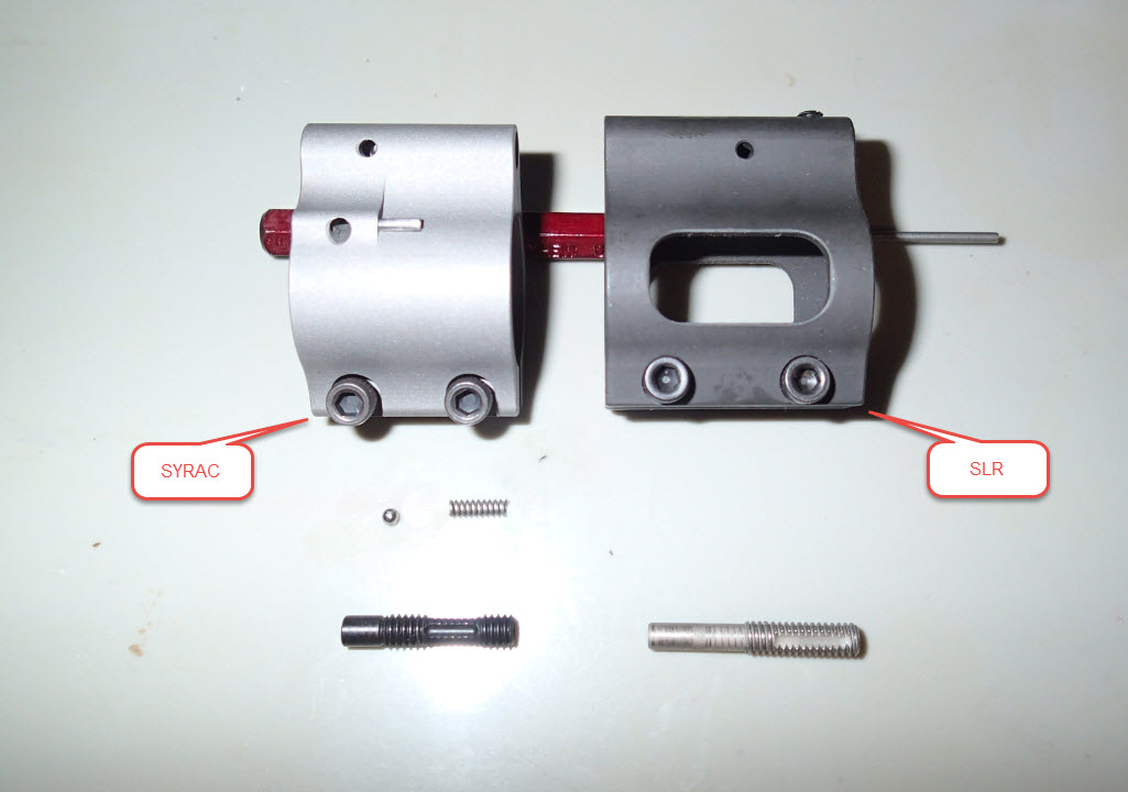

The clarify my previous statement regarding cup tip screws, neither the Syrac or SLR model uses a cup tip screw. They both use a machined screw. Of the versions I have, the latest generation Syrac has the highest adjustment screw machining quality. I've spent the last few months in my garage lab and at the range running 5 different adjustable gas blocks through a series of evaluations to see if one or more does what I don't think any of them can do.
