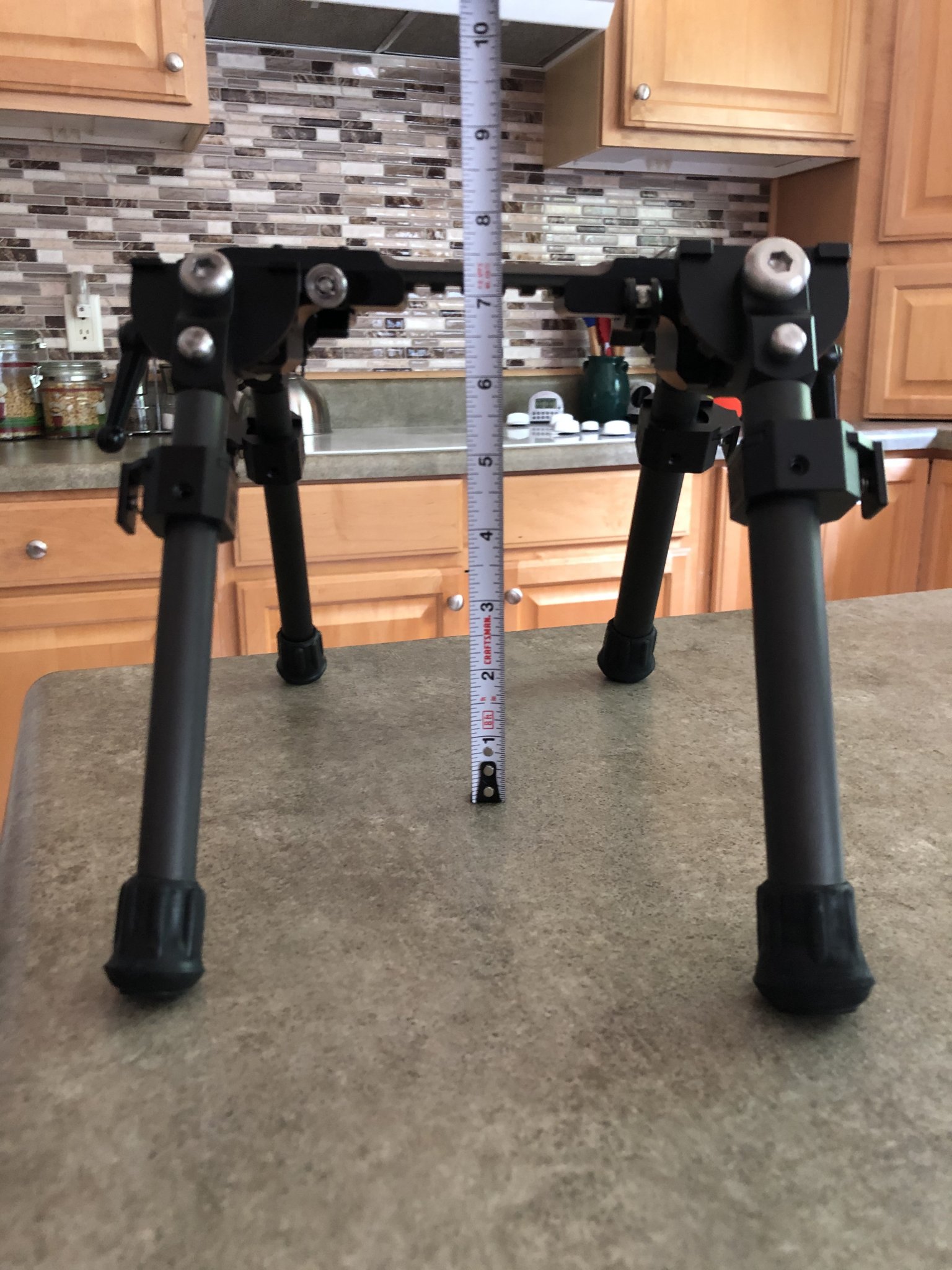

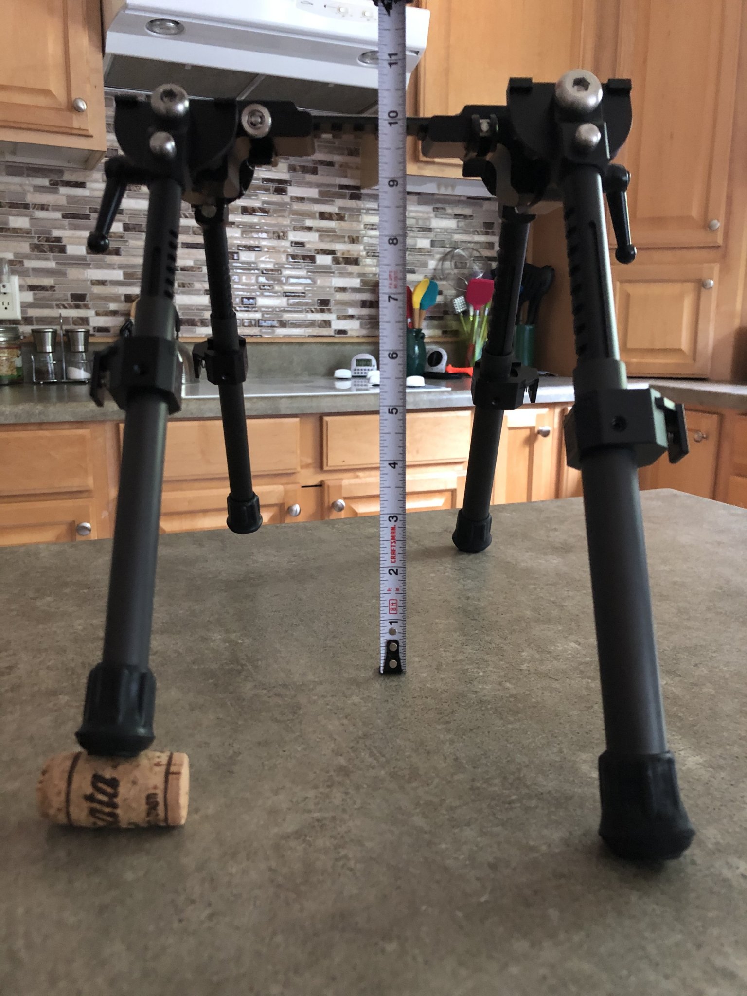

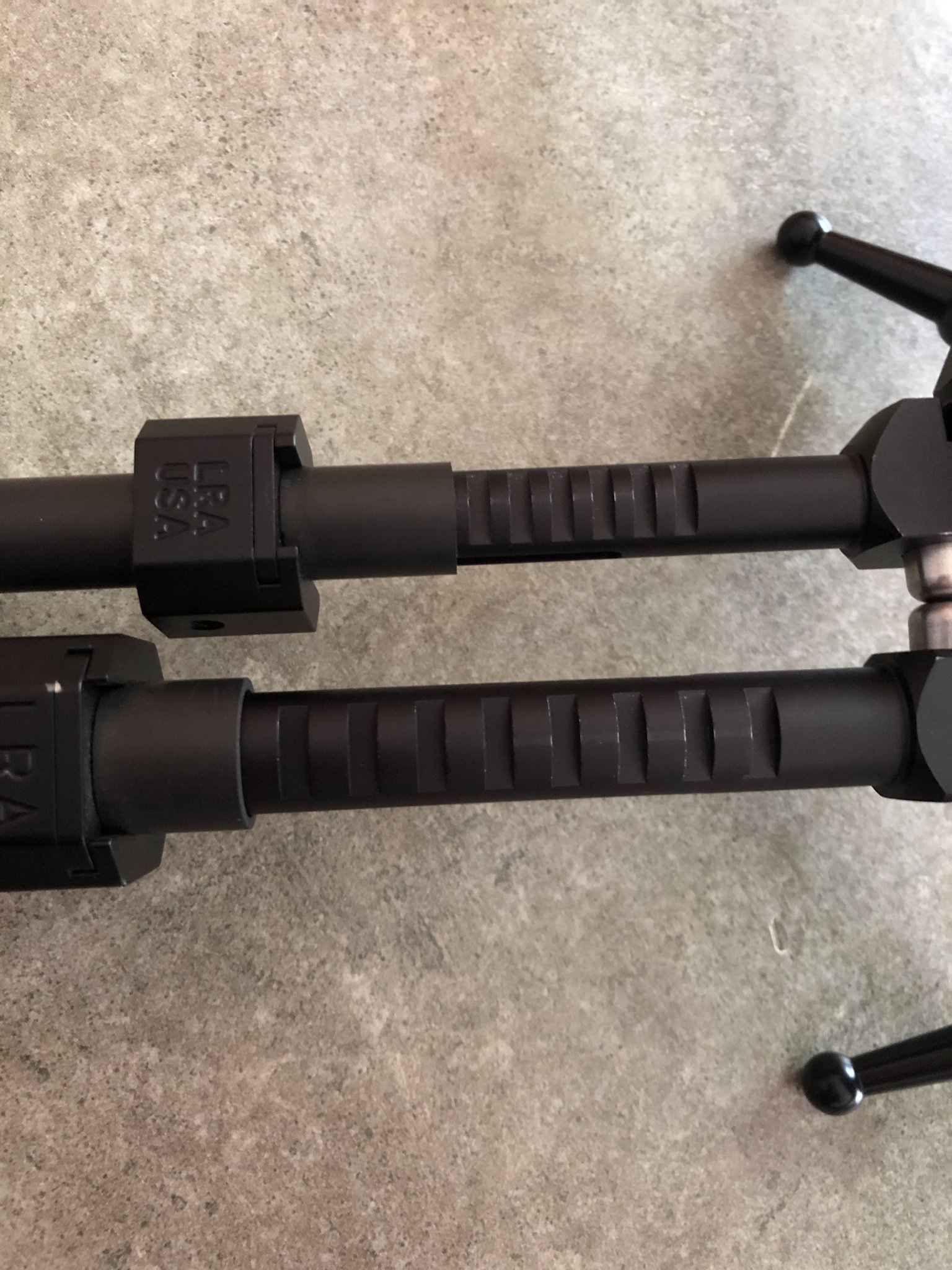

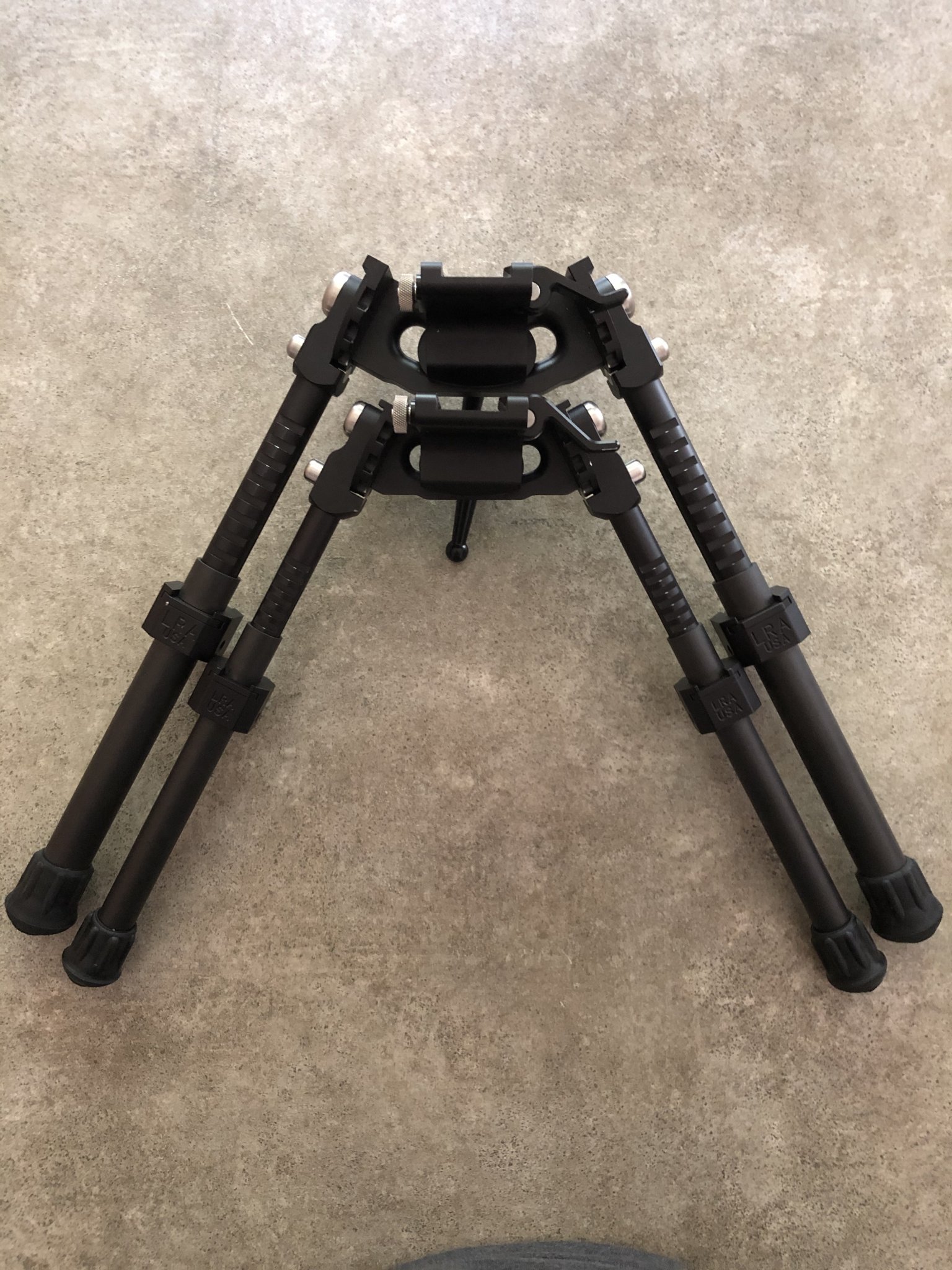

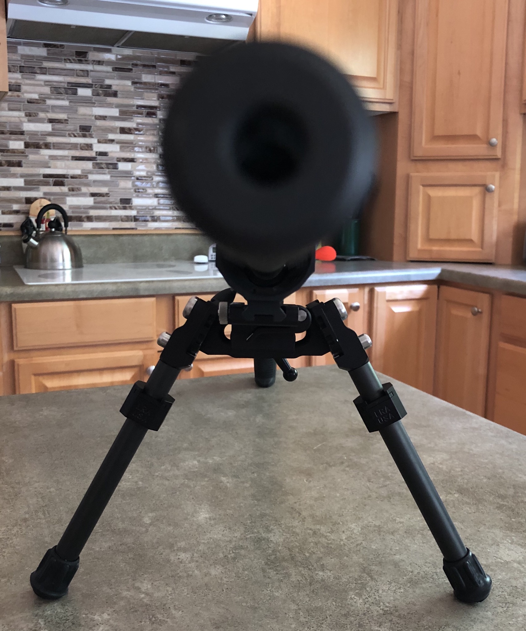

    I have the LRA Ultralight and the Light Tactical. Both of them perform as equally as stable whether under my .308 Savage or my 6.5 RPR. Fully collapsed they are both 7”. The Light Tactical will extend to about 9-3/4”. The Ultralight is an inch shorter at 8-3/4”. For what it’s worth, I’ve never run out of height on the Ultralight for prone shooting. The Ultralght also has finer leg notch increments. The Ultralight does have a narrower crane than the Light Tactical, but the barrel diameter on my RPR still remains within the triangle geometry of the legs. On my conventional stocked Savage, the Ultralight leg intersection apex is just barely above the centerline of the bore. Barrel rifling torque is equally controlled with either bipod. The riffle in the attached pics is the Ruger RPR.

    The Ultralight seems to be more at home underneath an AR style handguard since it has a narrower crane. The wider crane of the Light Tactical plays well with conventional or chassis type stocks that typically have the barrel centerline located higher above the attachment point. If you have to add a picatinny to ARCA adapter to one of these bipods, the wider crane of the Light Tactical would help make sure your barrel centerline remains within the triangle geometry of the legs.
    Wow, thanks, that is a big help. I really do appreciate the pictures. It is quit a bit smaller, rather more compact, than the Light Tactical. The Light Tactical is great under a DTA HTI .50BMG but I think it's a bit overkill on a Mk20.
