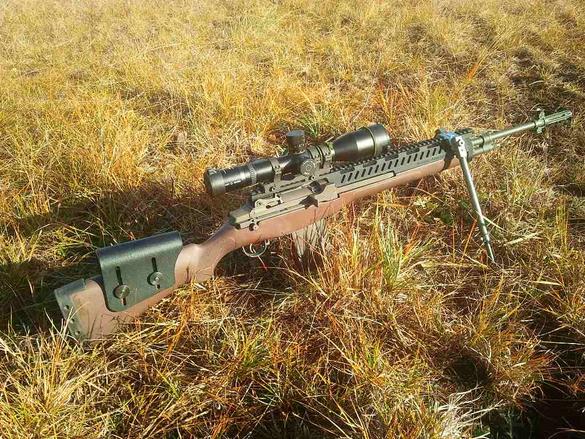

True M14? If the platform has appeal to you, then go for it. I have shot mine out to 800 meters and it can keep it between 1 and 2 moa, depending on the shooter, with good batch M80. I also use 168 grain SMK-s (Sellier&Bellot's 168 gr Match, it uses SMK) and Lapua's 170 grain Lockbase. With the latter it is about 1 moa at 500-600 meters.
I have a low serial number Springfield (4 digit serial), and it has served me well so far.
