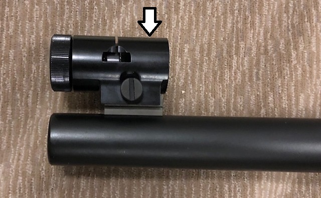

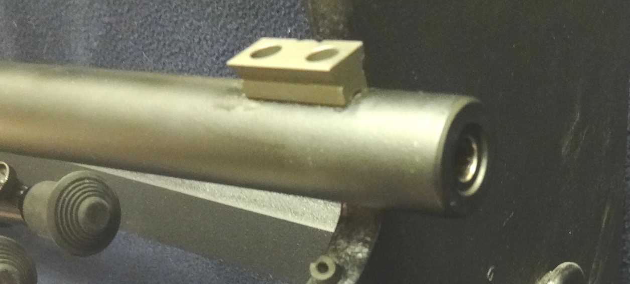

I have a question about how to install the OK Weber front sight base for the globe sight on a M24 rifle.
After studying numerous pictures on the M24 front sight base, (most pictures don't have the globe front sight mounted), I've notice Remington mount the front sight base with the notch to the left, that means when the globe sight installed, the screw-on cap will be facing the front. I think typically, the front globe sight on target rifle, the globe sight screw-on cap should be facing the rear. Keep in mind that some globe sight will have a magnifier. So which way is the correct way to install the front sight base? The notch should be on the left, or right? The screw on cap facing the front or rear?

This picture shows the Redfield sight, the Redfield sight base has notches on both sides, the bigger notch on the left, and smaller notch on the right. OK Weber front sight base only has one notch, Remington put it on the left that put the screw-on cap in the front, which I am not sure if it's correct. (The Army never updated the manual).

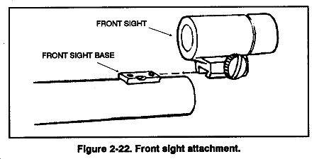

    I never really thought about this. My M24R has the OK Weber sights. The front base has the indent on the left side (see attached). The globe sight screw-on cap would be facing outward (with the nut on the left side). The threaded part of the globe sight is facing the shooter, which per post #10 is the wrong orientation since any magnifiers are to be installed on the target side of the reticle...but of course the US Army didn't provide or issue any magnifiers, just the different reticles. In both manuals that I have, it shows the screw-in cap holding the reticle is screwed in from the target-side of the barrel, so I think it must have been a purposeful decision, even if its the opposite of what one sees on civilian target rifles. (M24s typically lived a very different lifestyle than a pampered target rifle...)
    Well, did you call OK Weber? I guess they would probably be best on answering the question about which way their front sight base is supposed to be installed... Hopefully the wild fires out west haven't impacted that company.
    On EDIT: Last two B&W pics are from Peter Senich's book, The One-Round War (1996). That M24 probably has the Redfield sight system, not OK Weber, IMO.

    The older Redfield globe, the screw in cap was screwed in from the target side, and no magnifier option for this globe, and the locking screw is on the right. Base had two notches, big notch on the left, and small notch on the right. That was the Redfield.
    Then came the OK Weber, the base only had one notch. Remington put it on the left from all the pictures that I've seen. That put the screw in cap on the target side, and locking screw on the left, which is not quite right in according with the globe sight orientation of the target rifle.
    I did call OK Weber, and the nice lady that I spoke with didn't remember, they only supplied the parts to Remington, how they put them on was their business. However, she said the screw in cap should be on the shooter's side. She referred me to a master gunsmith that supposed to make all these sights, and he said the globe screw in cap should be on the shooter side, locking screw on the right, magnifier on the target side, like what post #10 said. He didn't know why Remington did what they did.
    It would be nice to have Remington or the U.S. Army to clarify this.

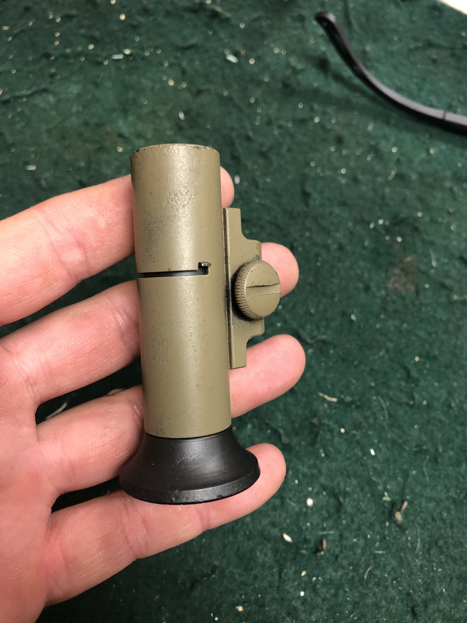

    Is this a M24 sight? I've never seen one like that.
    That tan sight is the old Redfield Olympic front globe sight. The Olympic is long and has a pronounced flange on the rear which limits what can be seen around the outside of the front sight. It was typically used on small bore (22LR) rifles, esp the old Winchester 52D and Remington 40X in 22LR back in the 1950s-60s.
    The M24 front sight was the Redfield International, which is much shorter in length, but bigger in diameter and hence more open in comparison. Its considered a "big bore" front sight, and I think dates to the late 1970-1980s era.
